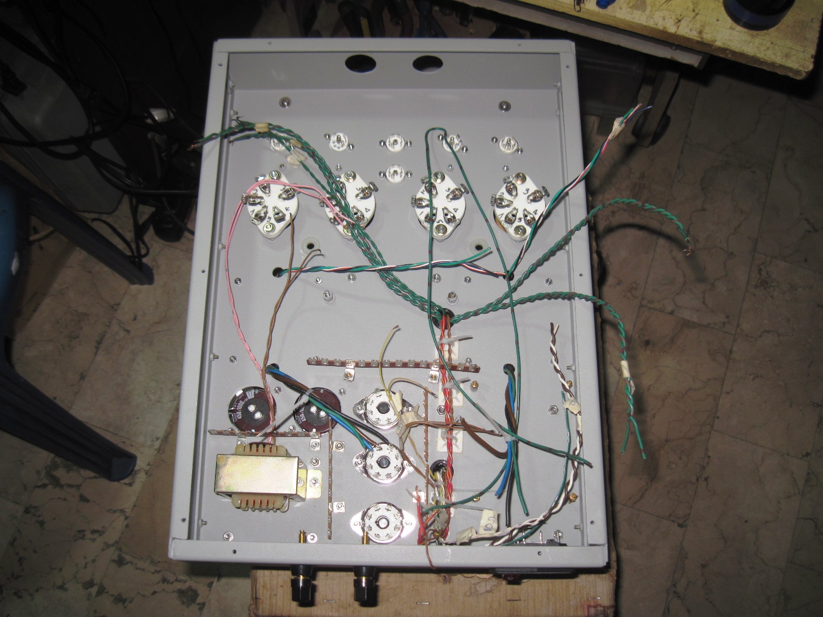

the OPT i used did not have ultralinear taps unfortunately....
i will proceed building and testing the psu using dummy loads and see
if the psu comes up to speed...
84 watts total plates,300v plate/70 mA cathodes and about 2x 16 watts on the CCS.
will check what adjustments to the psu needed to be done...
yes Jerry, and i am mulling separate CCS for each cathodes of the 1624....

the reason for putting a choke in the output stage is to bias the output tubes to take it to the correct operating point...
several ways to get there..
Yes, it can be done either by placing choke on top or at the bottom. If choke drops a lot of voltage, you have to watch for heat dissipation. Even large choke with copper dissipation of 10 W will run hot.
Also, because copper resistance strongly increases with temperature, a long warm-up time will be needed for bias to stabilize.
yes, the coils will be dissipating 10 watts...
i am not using a cathode choke with this build...
