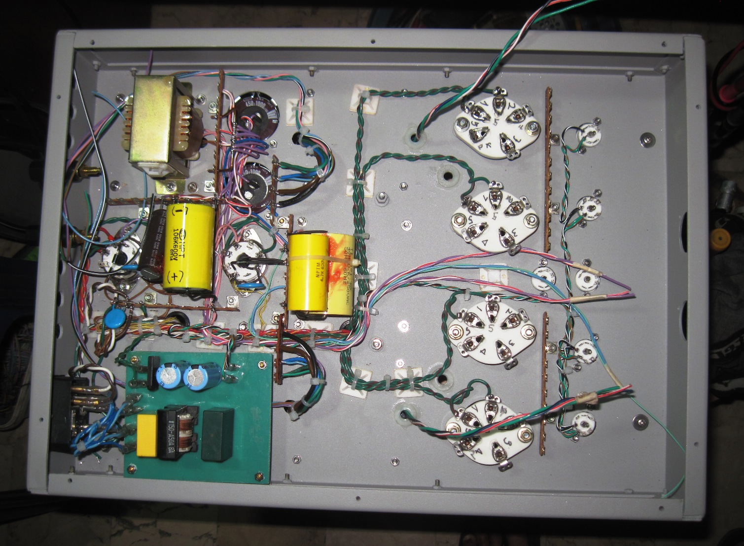

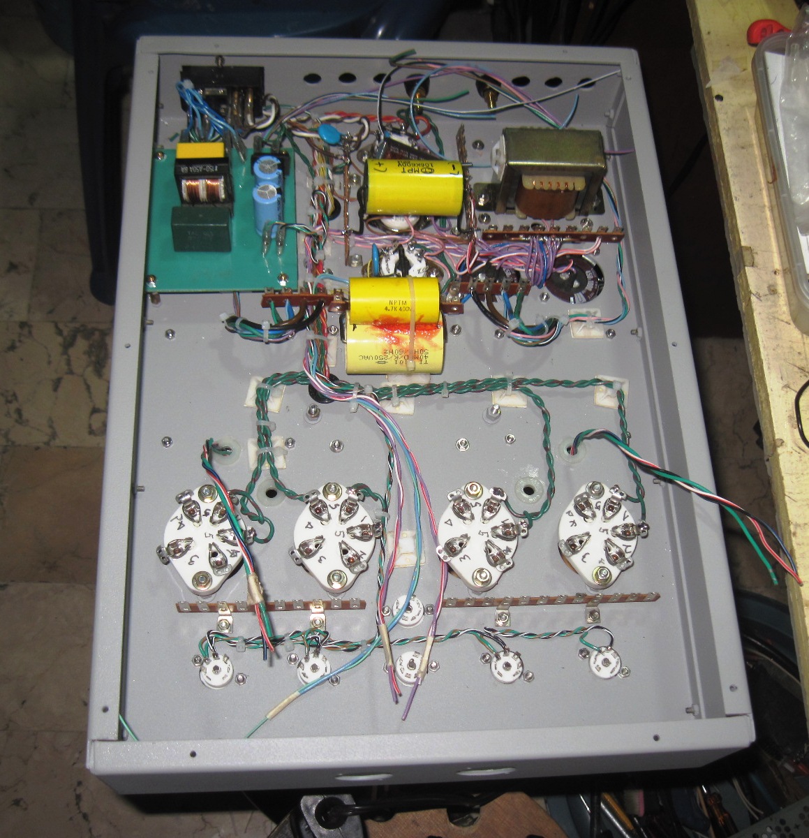

i have made up my mind, i am using a cathode resistor bias on the 1624's....
paralleled 2 x 1k ohm resistors by passed by a 470uf/250v ecaps...
i will mount them on pcb's.....
for the input ltp's i have not decided yet on the 6BC5 or the 6GK5's. why those?
i have lots of them to choose from...
