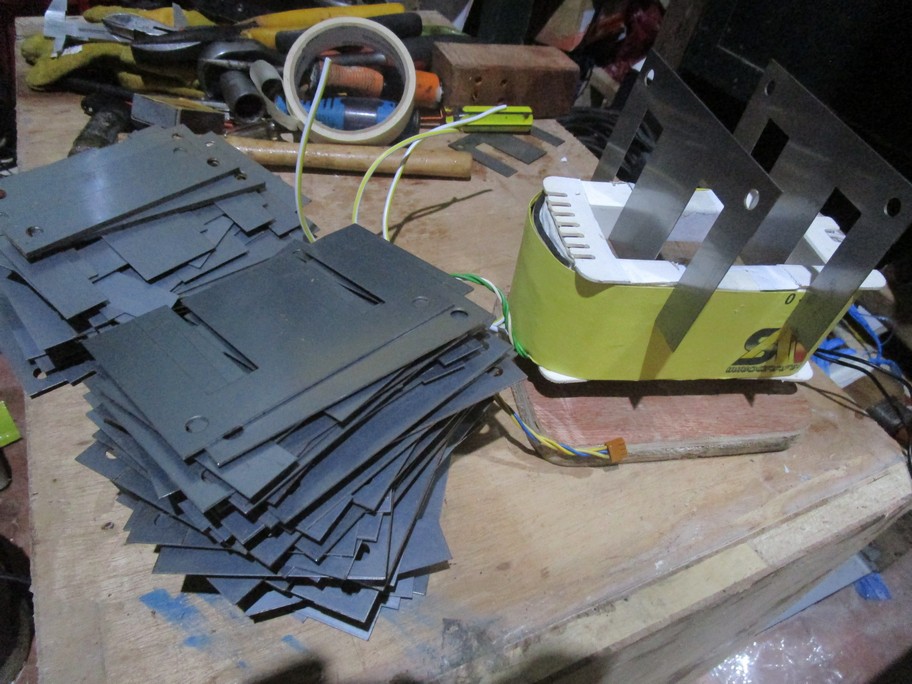

190Turns around the core with a 3" ID will require a large overlap in the winding where it passes through the ID. Roughly 138Turns will fill the ID with ONE layer.....................

190Turns of 1.63mm diameter wire will not fit as one layer in a toroid with 3" Internal Diameter (ID).
Once one layer has been wound on, the primary winding will need to begin a second layer over the start of the first layer.
This overlap will have near mains voltage between the windings.
I recommend adding insulation between the layers of primary winding.
Does that explain it any better?
why even explain?, we diy'ers know from actual experience...
there are techniques that will make those turns fit, the overlapping is done on the inside diameter, and on the outside perimeter side by side...
if you can imagine it, you can do it...

Just like I did it, in my toroidal transformer look at below image
Toroidal transformer 2.jpg - Google Drive

yes sir but i have scanned partially just a few have found maybe later...
1.5CL x 4" #18primary #14 Secondary 55-0-55. some of my work has no picture taken coz i need to borrow cam. 🙂

good job sanbadgujar, i tend to respect more people with something to show for it...

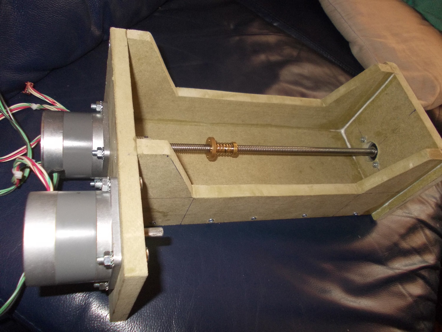

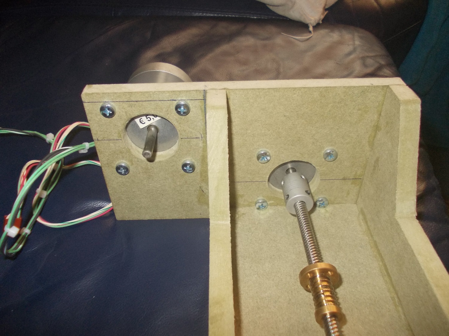

I do not to want to hyjack but I am busy with a winder who do go make small signal transformers for mine amp design. So I want to show only.
still wait for some parts.
please post pics of your work here too, thanks...

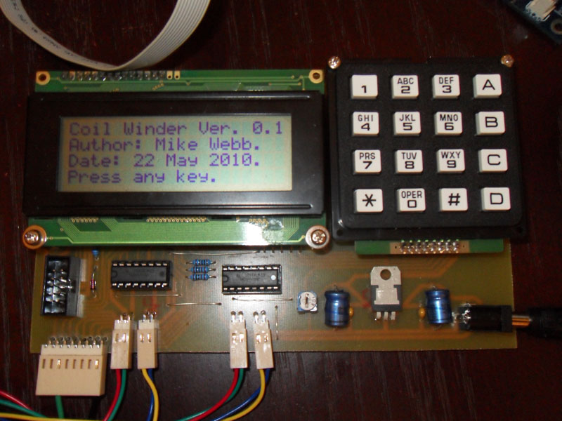

Is the winding controller setting the speed of both motors?
Yes The winder do use one motor for winding and one for guiding the wire, because I go to wind a signal transformer who is very small and thin wire I go use this, busy now with biulding it, maybe it is even usable with bigger stepper for winding to make output trafo,s.
I use a core special for signal transformers, it get to 5 Henry multilayer, this can only with that winder, the program and electronics I do not now yet if it works oke, there are also versions on usb and pc.
with the guid motor I can use very thin wire, pause it etc.
