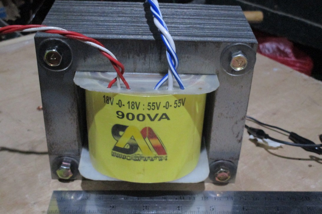

now i will try some comment from others on last traffo i built suggesting only 1:1.5 core ratio. then 2"CL x 3" and use #17 for primary and #14 secondary 900VA @1.5 t/v for my SR200 stereo.

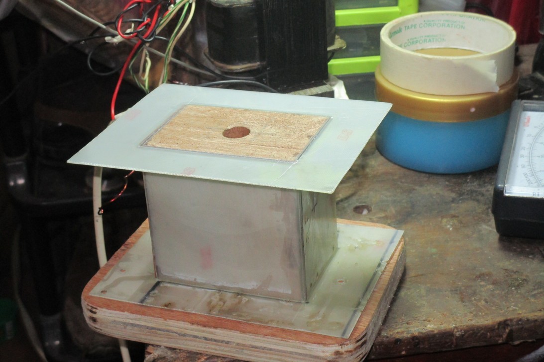

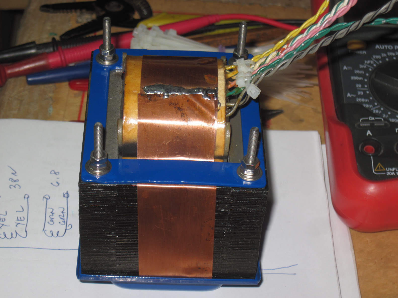

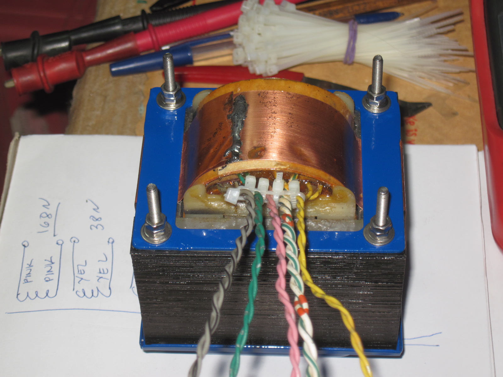

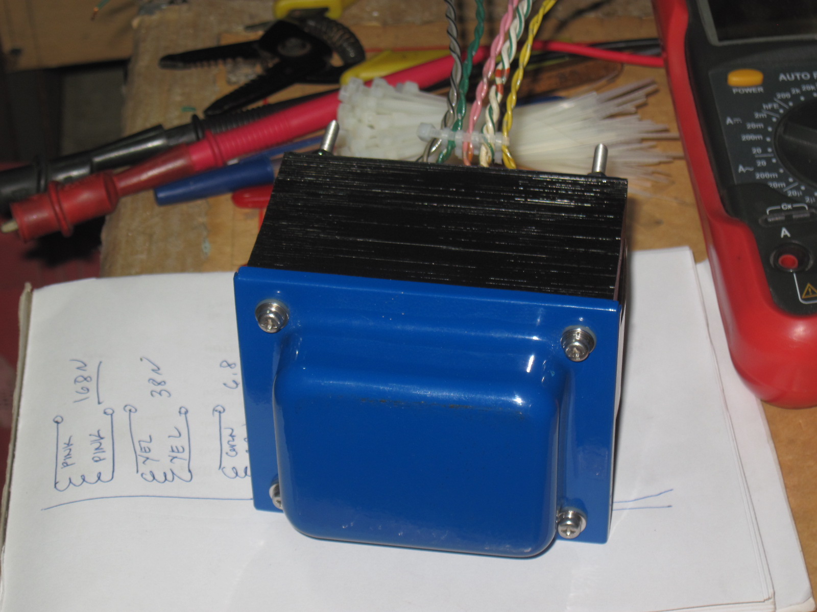

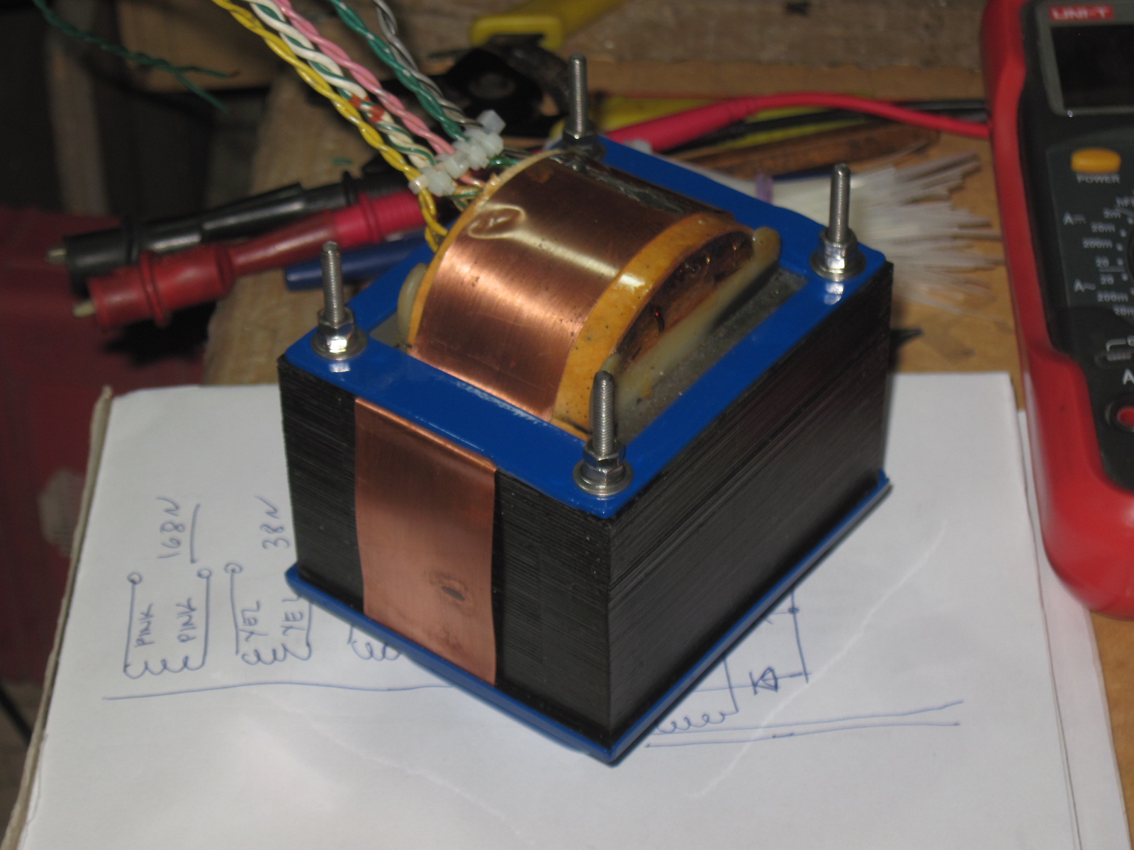

sir tony here's my last built trafo after asked some ideas to you,

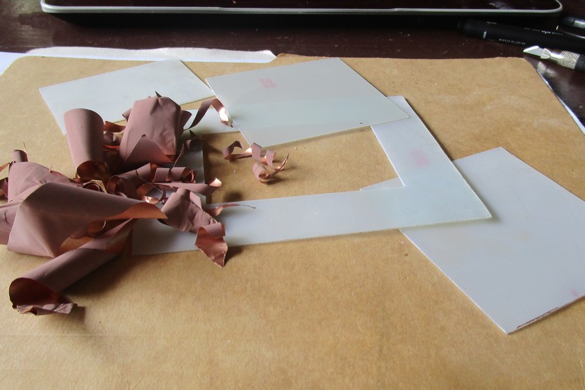

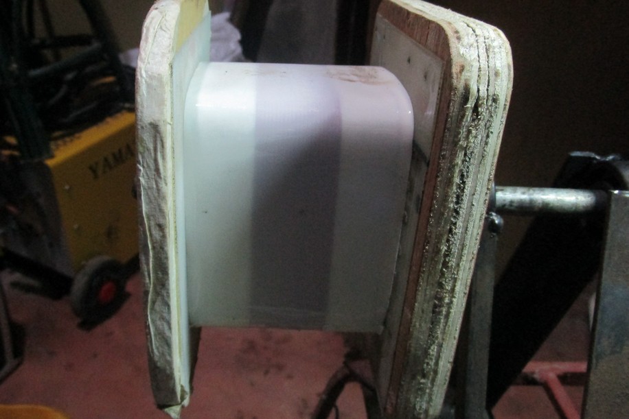

i used 1mm pcb's as bobbin accdg to the supplier its fibre made.
also mylar in separating pri and secondary
thanks
regards
thanks
regards
thanks
regards
looks good......

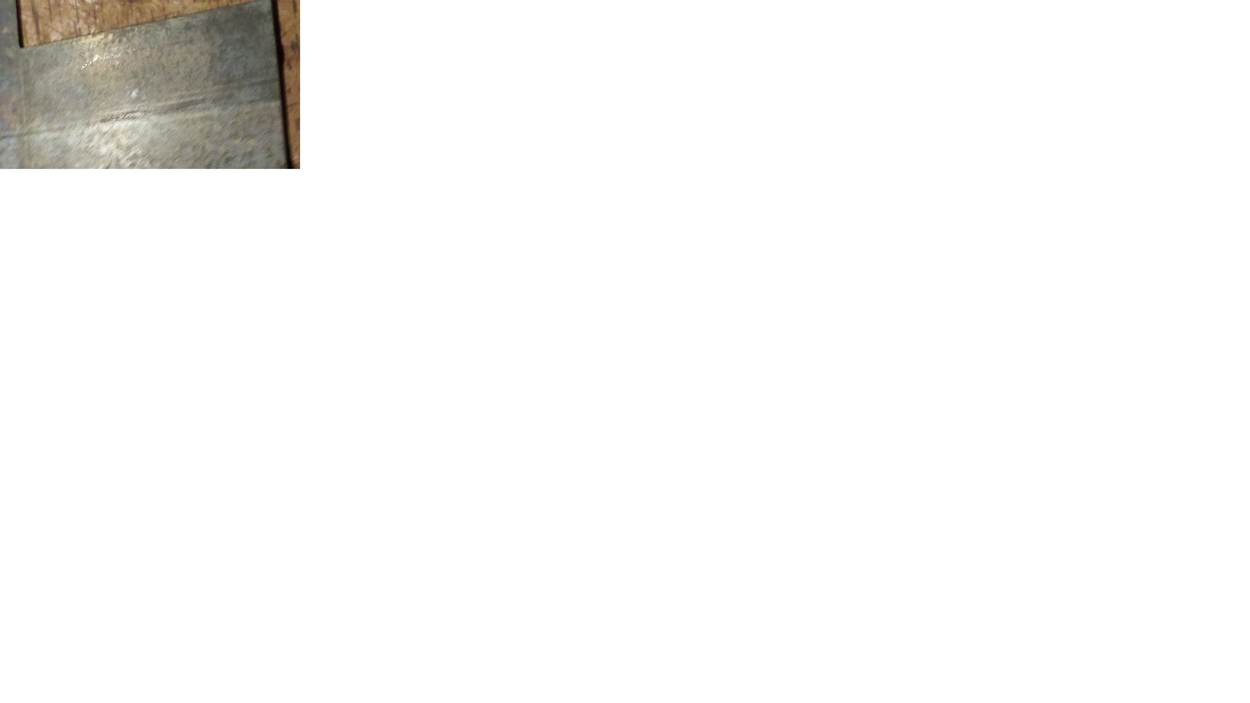

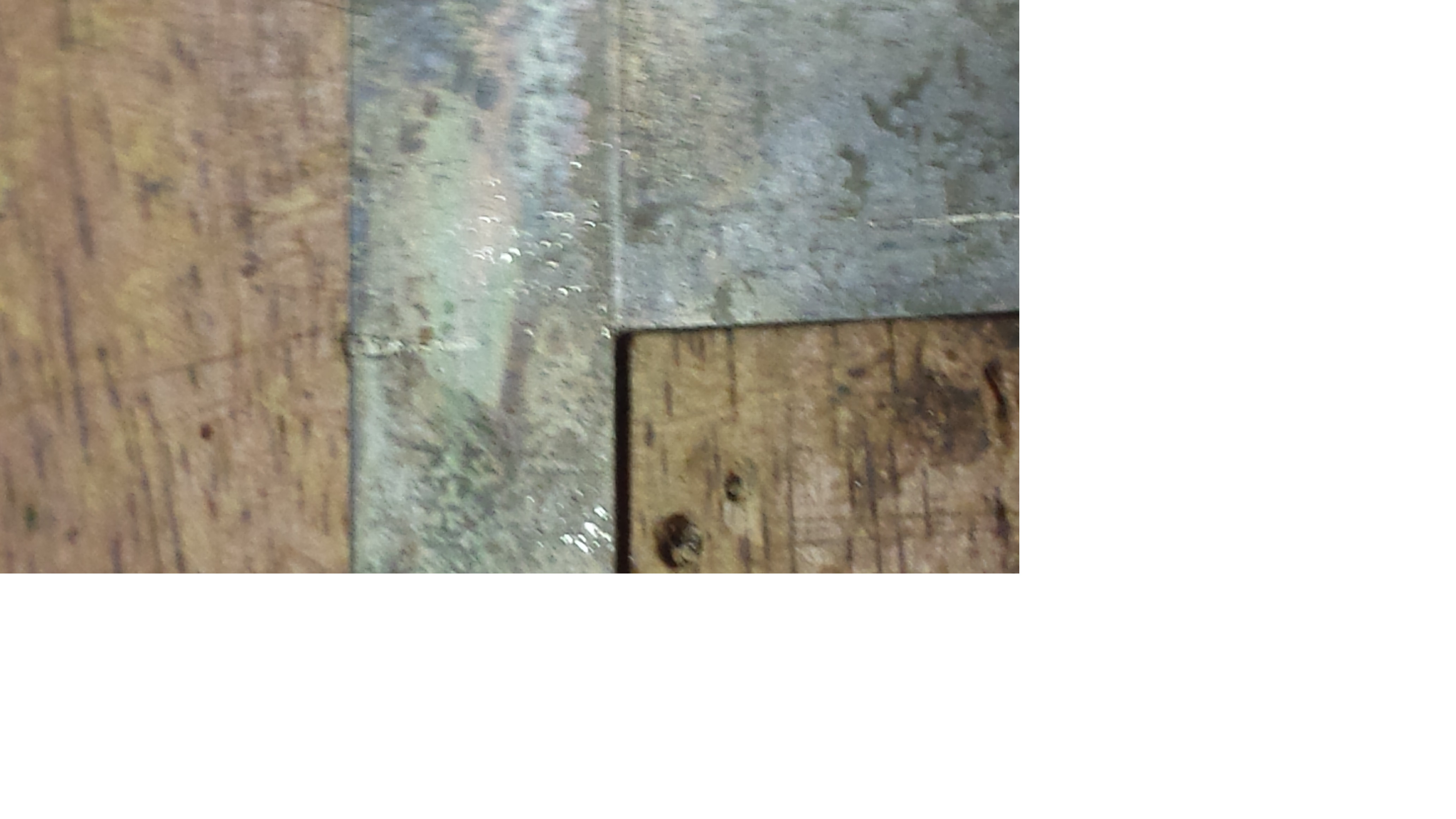

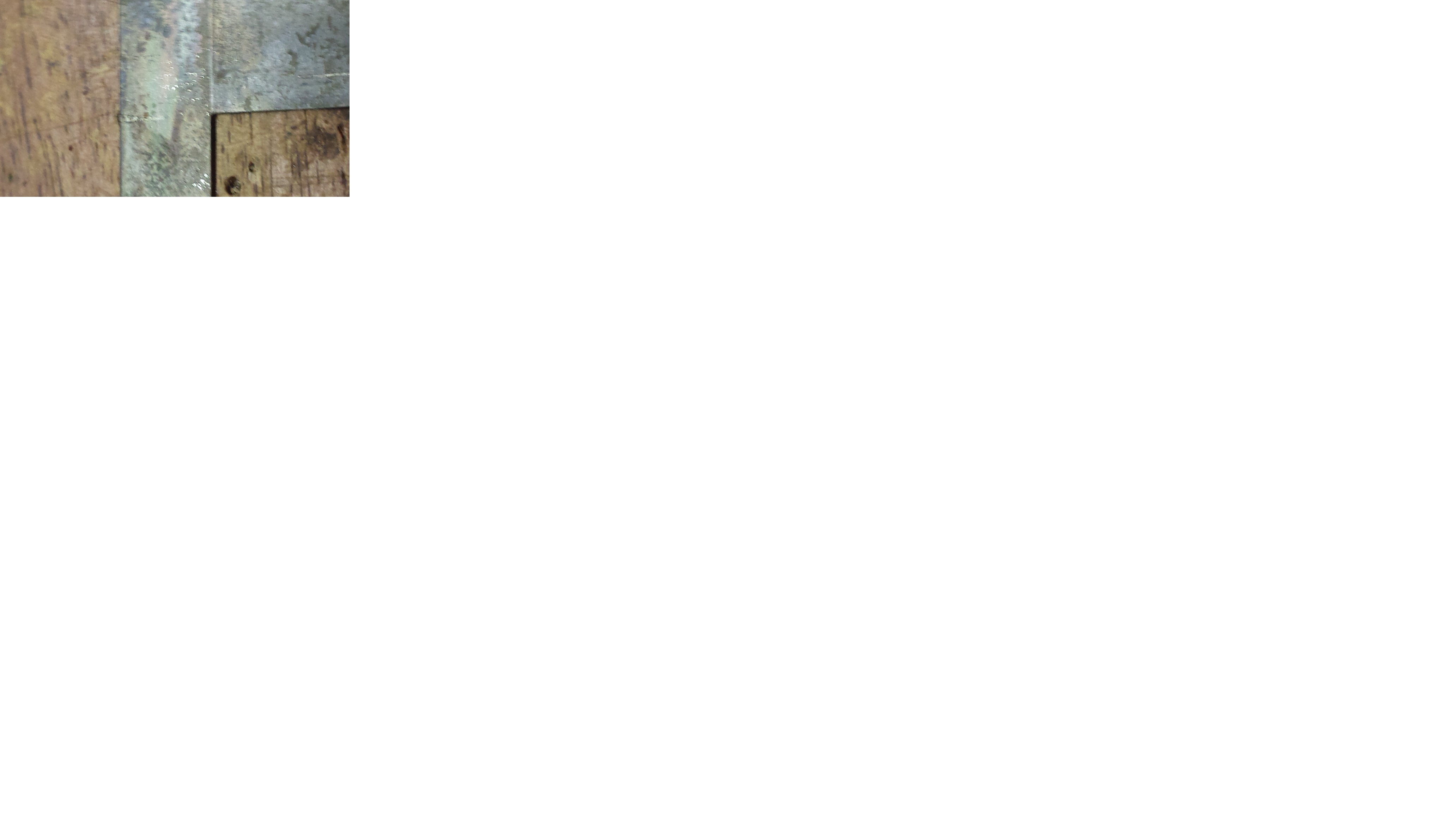

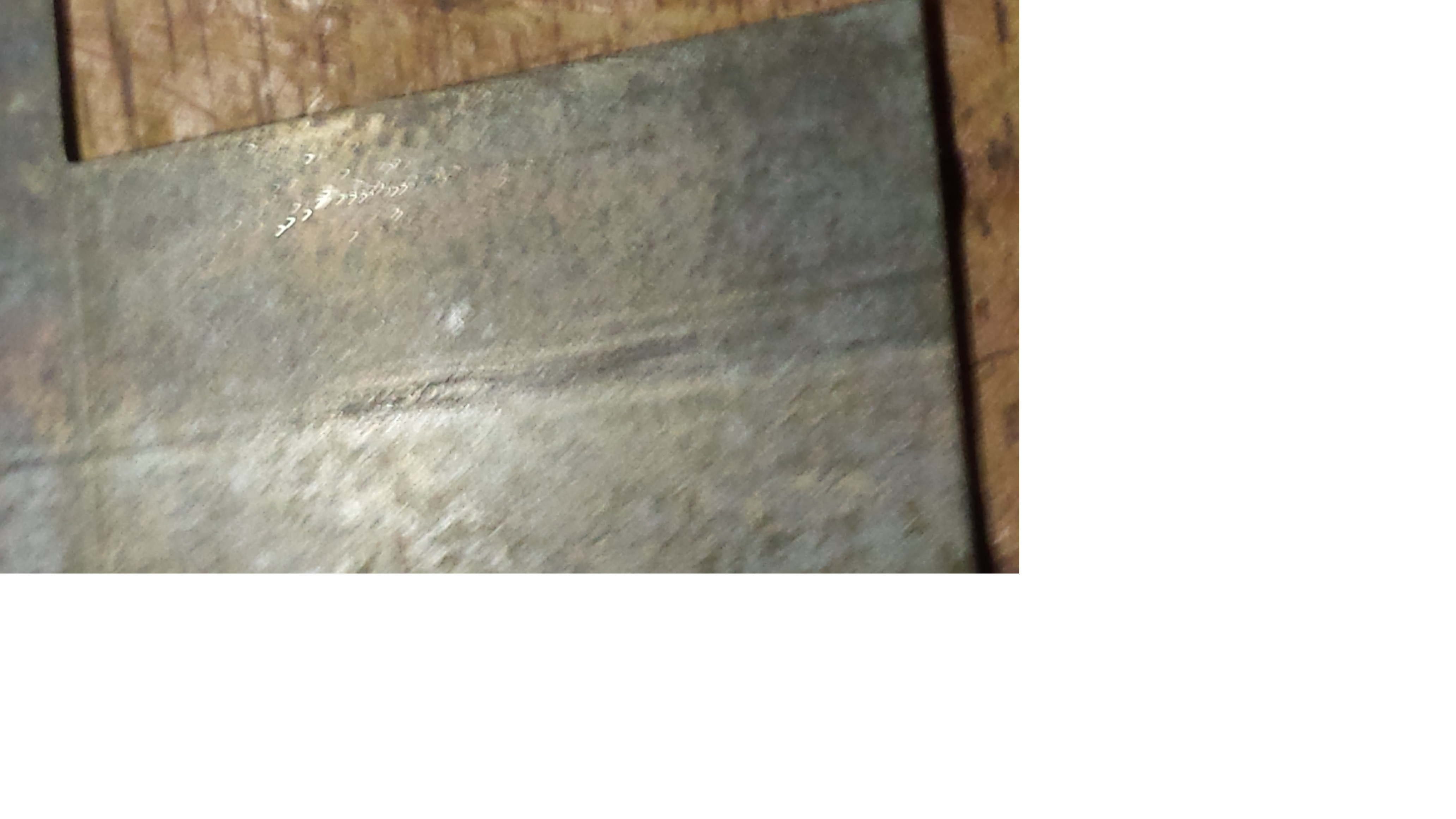

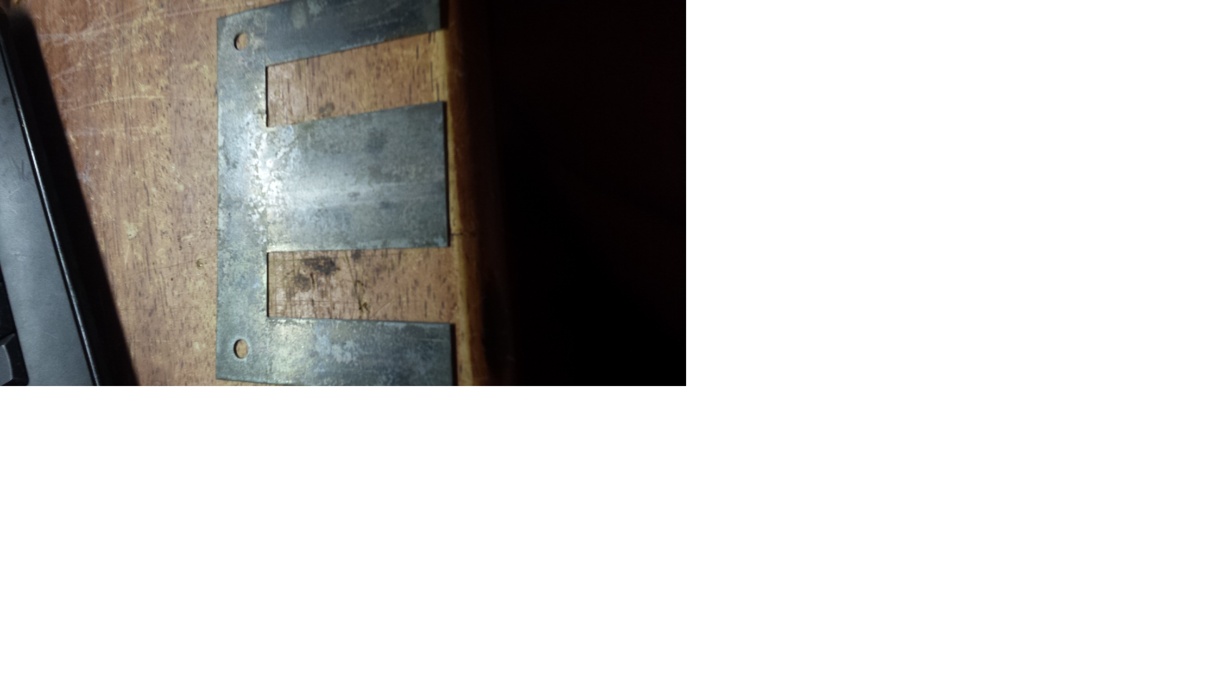

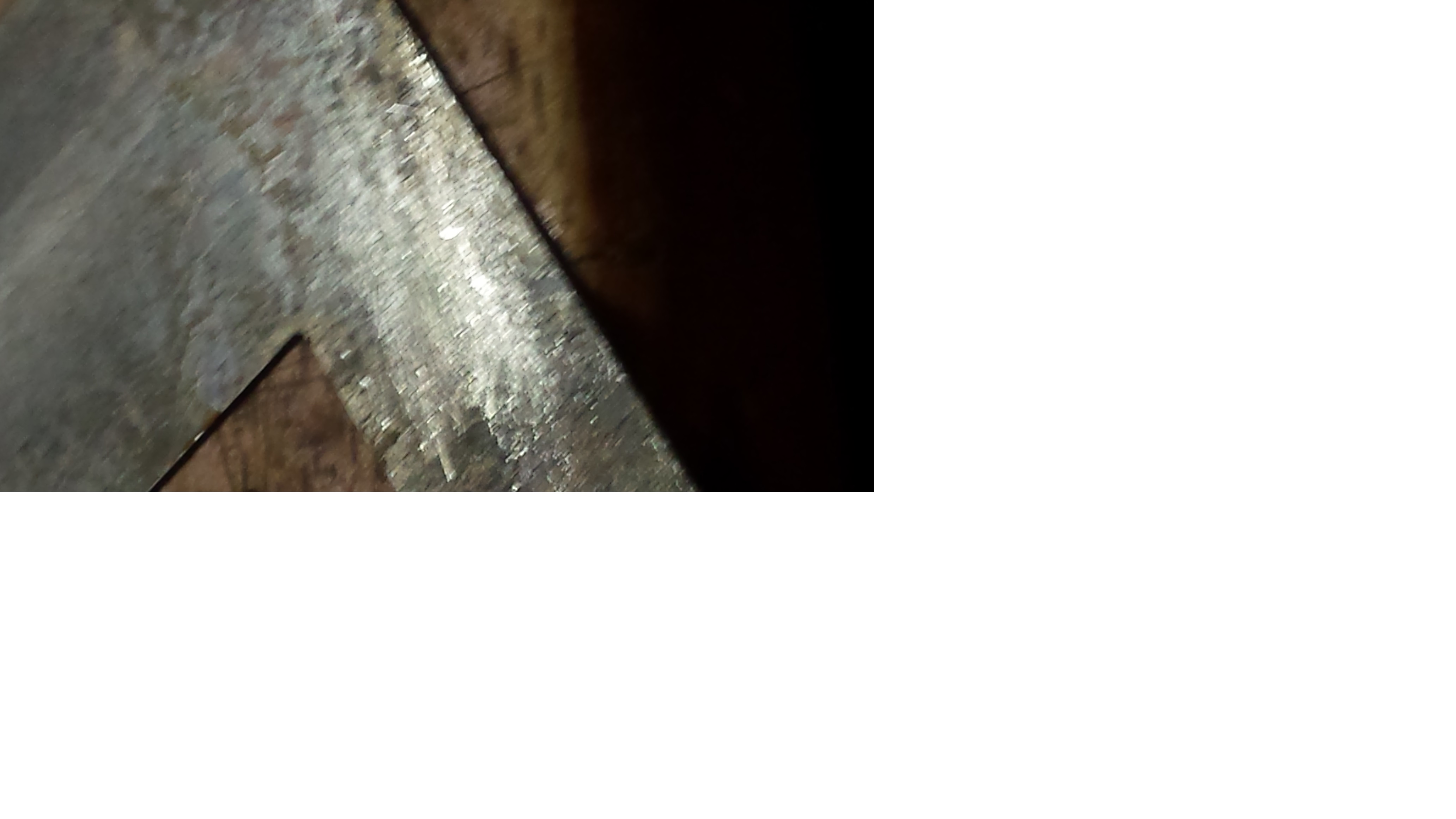

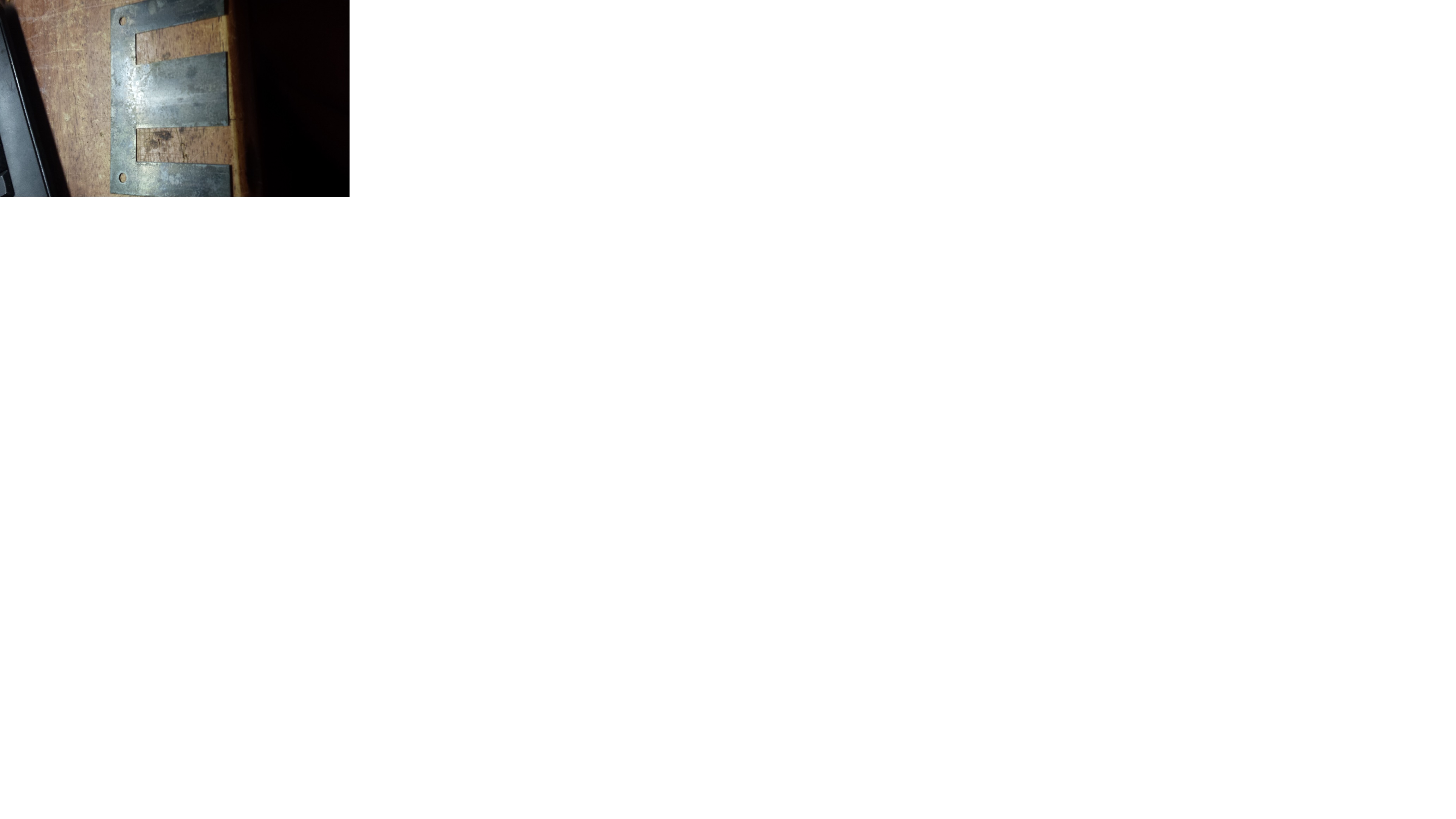

The lams that I asked about
Here are the pics of the lams. I included a pic where I scraped off some of the coating to show the metal underneath.
The thickness is .08mm. My caliper is kind of cruddy, but it's usually fairly close.
pictures are too small for my old eyes... can you post bigger?
my lams are either 0.35 or 0.5 mm thick, what you have are even thinner a good clue to quality...
lams
Sorry about that.... I will have to post them one at a time due to the file size limit. I had to reduce the size of them to get them to upload. I've made them about 70 percent of the original size....
I remeasured the lam thickness.... it is .5mm. Like I said, the caliper is pretty iffy. I really need to get a better caliper....
0.5mm thickness means that they are not premium grade, but i can be wrong,
looks mo me those are typically not the types....
