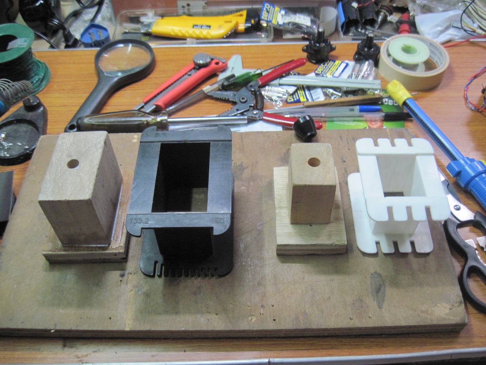

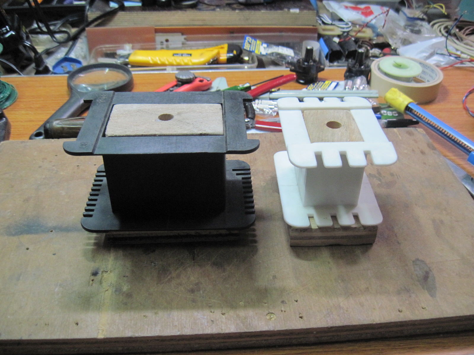

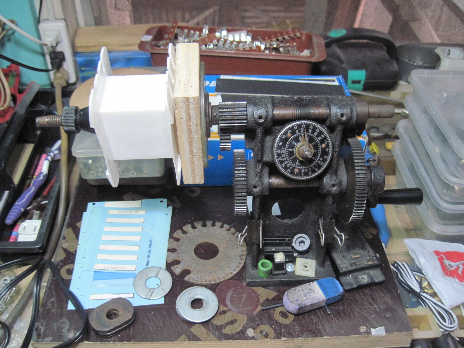

wooden mandrels:
i have bobbins for 1 3/4 and 1 1/2 inch cores, so to facilitate winding, i made some wooden mandrels...

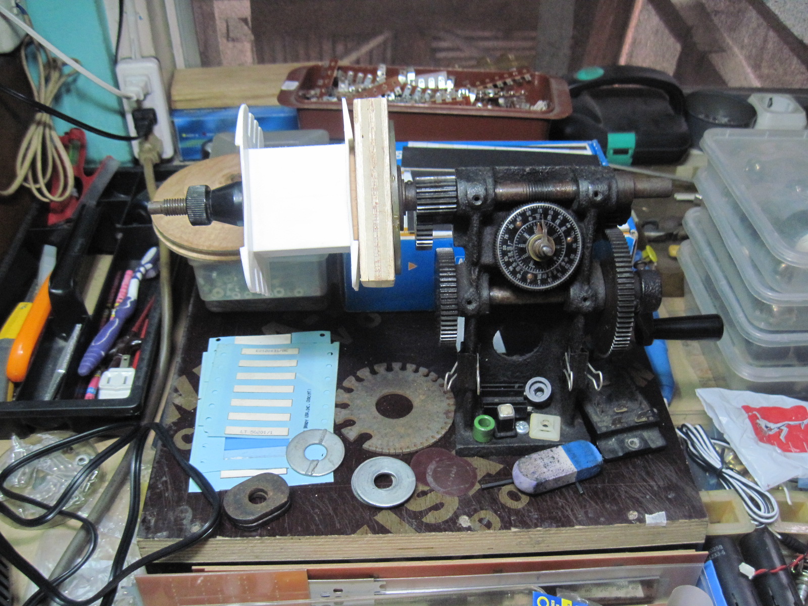

Wow very impressive transformers! Thanks for the great photos. I find this idea of making your own transformers very intriguing. That winding device looks very interesting.. I see there is a counter to keep track of the number of turns. I would really love to see a video of the winding process in action!

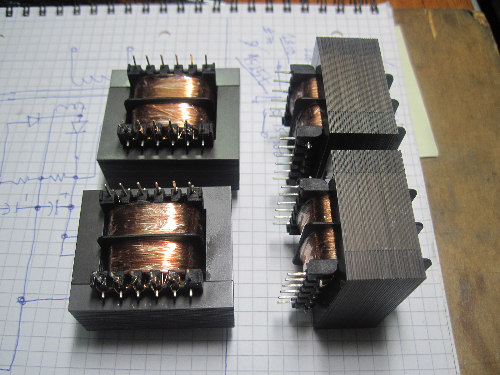

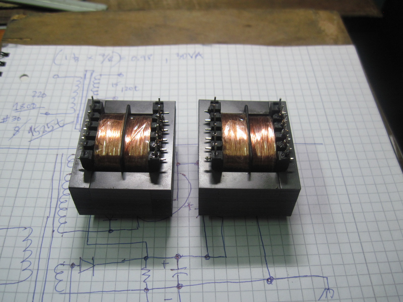

Hi all,
these are 2 OPT's for a tube amp i am building, it has a 1.75in center leg stacked to 3.125inches, using Edrel's Z11(M6) cores.....
finally put to use, to give you an idea, the core is about 15kg at P500 per kilogram and copper at about 2.5kgs at about P700 per kilo......
bobbins used also supplied by Edrel and is nylon type.....
the use of wooden mandrels allowed me to wind the coils in sections, winding one coil after the other to avoid errors and ensure identical traffo build...

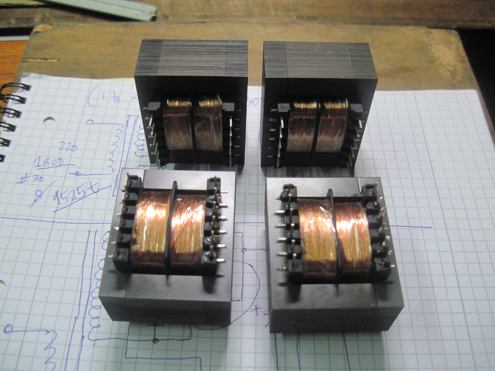

materials used includes:
Kapton tape, polypropylene plastic inter-layer insulation, 1/8 inch masking tapes to provide additional creapage distance:

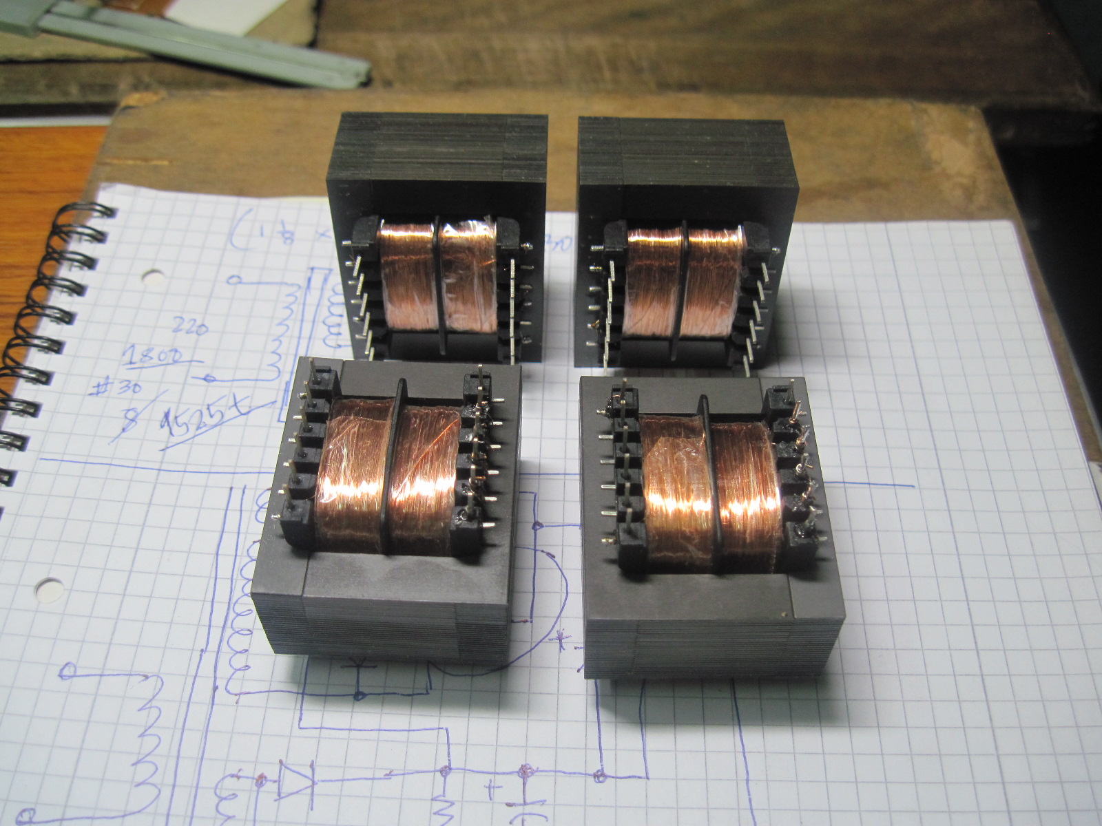

one of 4 primary coils and 1 of 4 secondary coils done:
winding the rest of the coils
stacking the E and I's to complete the build up:
