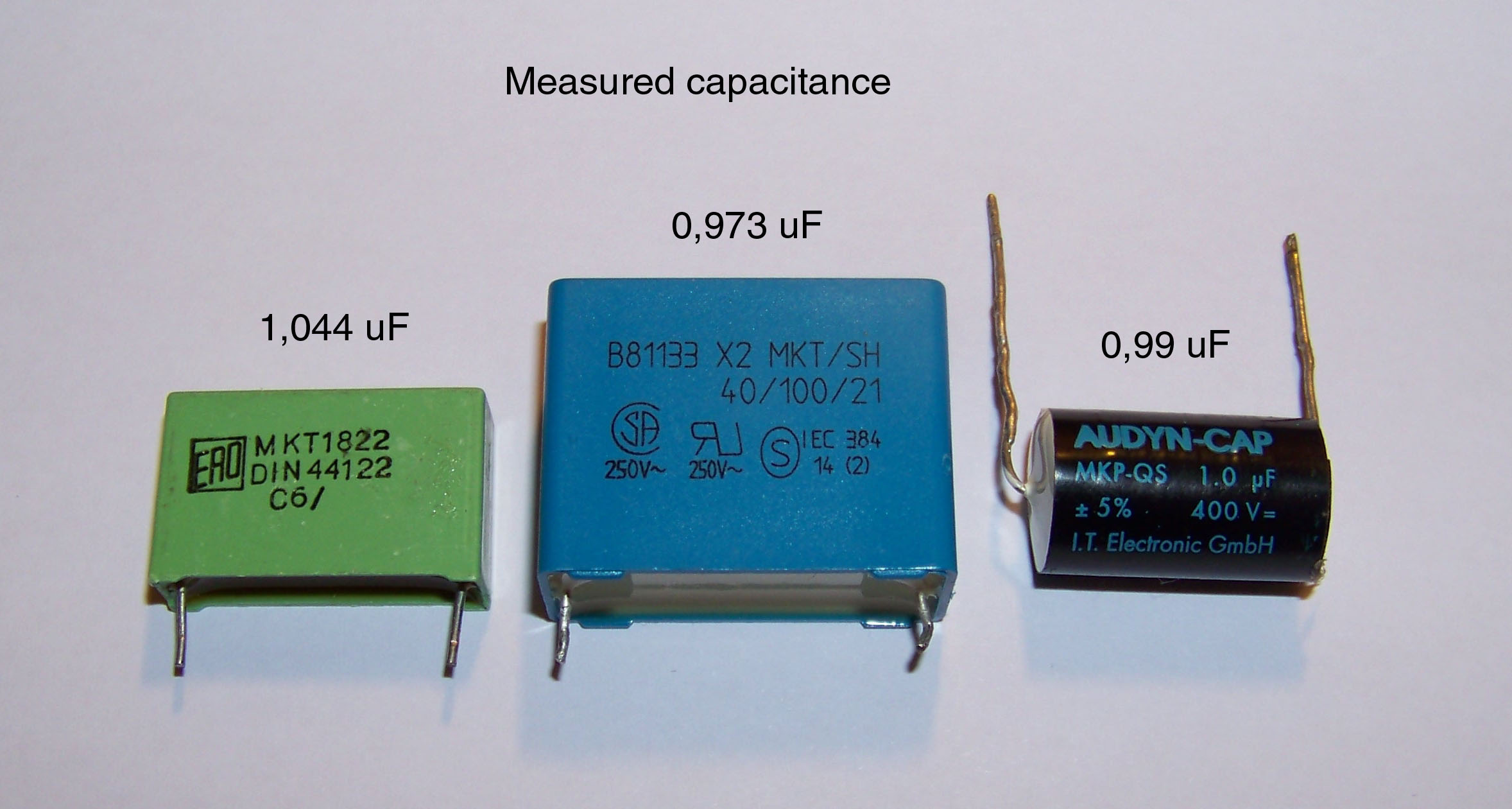

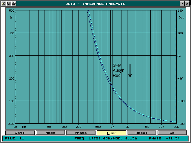

Tweeter with only one cap in series.
How long before the ESR kicks in ..... 🙂
Can you do Capacitance measurements with Clio, uf vs frequency .....
I can using a WT2. A new thread was created in another forum where I shared PET vs PP film caps ESR. Worth a look.
Effect of Film dielectric type on capacitor ESR
