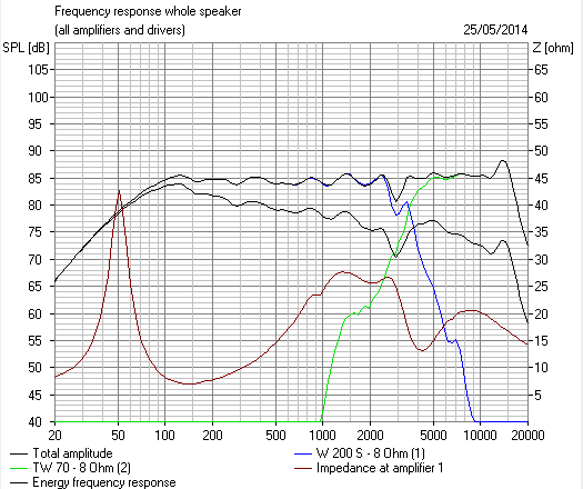

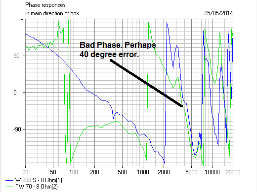

Like Lojzek, I use Boxsim for most simulations. I have often redesigned bass crossovers with less or more resistance in the shunt arm. Well, it's often been a disaster on listening, despite a cleaner-looking woofer rolloff.
Phase alignment within 5-10 degrees is really crucial for a good sounding speaker. And it's very sensitive to small changes.

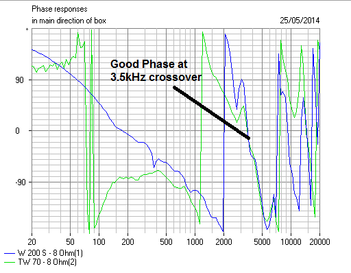

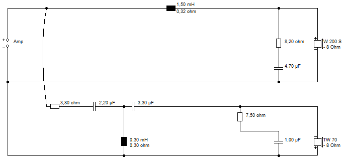

Nothing wrong with sims as 5th element points out. I changed the shunt here to 15R and 3.3uF which looked good on paper. But It sounded terrible. It had lost the magic. It was the phase that was the problem.
Here's the 8" bass plus cone tweeter crossover that worked, and I really should have included it in the previous post since it's no secret. Just your regular KEF type negative polarity filter. It's slightly sensitive to Capacitor ESR, very sensitive to driver alignment within 1 cm and a bit sensitive to your listening position, which I generally work out to be horizontal.
