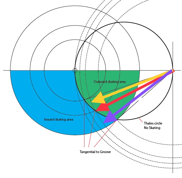

If you have an underhang arm, the arm may have three possible locations as in the diagram, yellow, red, and purple arrows. If the arm is in the yellow arrow position, and it is above the Thales circle. The arm skates towards the outside. If the arm is precisely on the Thales circle, the arm doesn't skate. If the arm is below the Thales circle, the arm skates towards the inside.
In addition, do you need null points? Null points make sense only if the arm has an overhang.
Underhang will not get rid of skating at all. Skating is caused by friction between the groove and the stylus. Neither overhang nor underhang is the reason to cause skating. A pivot arm will skate toward the inside of the record if it has an overhang. A pivot arm may skate toward the inside or outside of the record if it has an underhang.

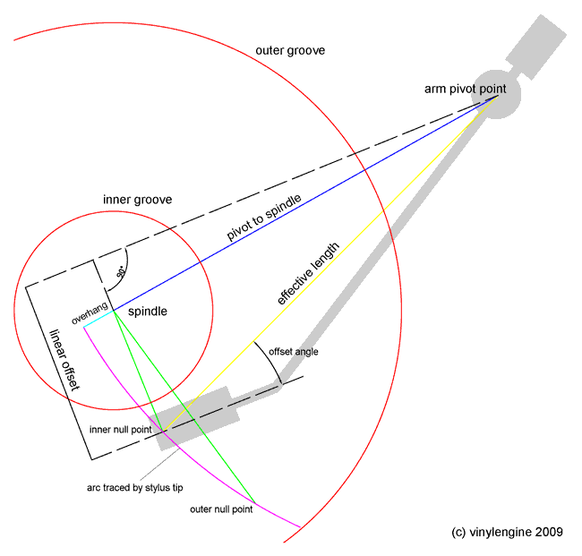

I admire you have the guts to declare the classical 2-null point theory as nonsense without fully understanding the classical theory.So to me, and it makes sense, the bottom line would be to insure that 90 degree angle at the end of the record is the way to go, and forget all the hype and misinformation blurted around the internet by so-called experts.
And forget that 2-point nonsense too.

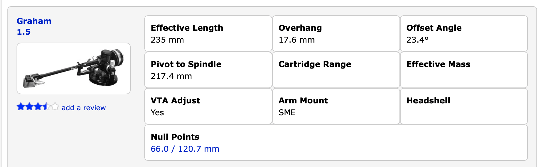

Let's take Graham arm as an example.
Your so-called one null point alignment IS the inner null point of classical two null points alignment. In the classical two null points theory, the stylus is perpendicular to the spindle at both null points. THIS IS YOUR SO-CALLED 90-DEGREE AT 2.5". There are 4 popular alignment methods, i.e. Lofgren A, Lofgren B, Stevenson, and Uni-D. Different methods put different degrees of emphasis on the inner groove. The inner null for Steveson is 60 mm which is even shorter than yours, 2.5" (63 mm). The inner null for Lofgren A is 66 mm which is longer than yours, 63 mm. Therefore, your null point is a custom inner null point. You may choose whatever null points you like to fit your taste. I simply don't see any of your innovation here.
In order to accurately align the cartridge, you need to meet two conditions. Aligning on just one inner null is not enough. Please see the following diagram.
1, Adjust the cartridge so the tip of the cartridge away locates on the arc line, the magenta line in the diagram, and one of the null points.
2, Adjust the cartridge on both inner and outer null points. There are green lines in the diagram.
If you only adjust the cartridge on the inner null point, it is not enough to ensure accurate alignment.

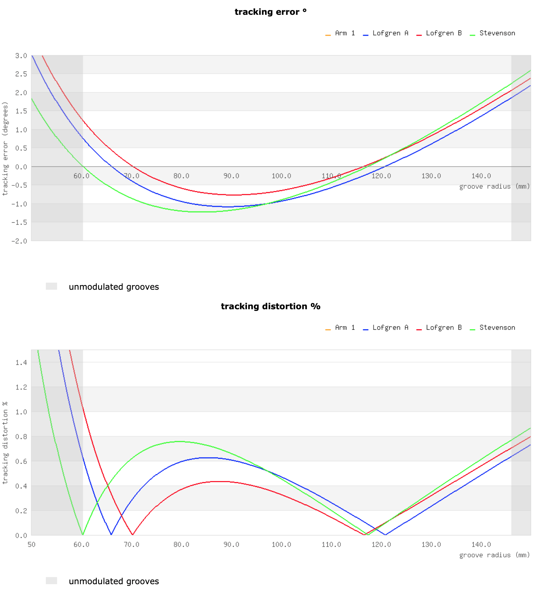

The original RIAA specification sets the minimum inner diameter of the grooved area 4 3/4". That is 60.325 mm, but it is hardly ever recorded so much material on a disc*. In reality it is varying between 65 to 70 mm, sometimes more. If you set the inner null at 60.325 mm, there will be offset on most records' real inner grooves. However, if you set the inner null at e.g. 66 mm, you will be some offset on some rare records' 60-ish mm inner grooves, but very little offset at most records more common inner groove radius.
* That is about 7.15 mm distance of the inner groove from the runout groove. I think I have one such disc in my collection, I have to measure it.
A few mm here or there is trivial indeed. This is why I don't understand those fierce debates about the optimum null radii: 120.65 mm OR is good, but 120.0 mm is BAD BAD BAD. Same for IR. Records don't have a fixed IR.
Again, the bottom line is that those last few grooves, at whatever they are located at (66, 60,MM etc) need the best 90 degree alignment possible.
So when aligning the stylus and its cantilever for that 90 degree tangent at that point, it's really absurd to worry about any outer grooves.
I hardly need a lecture from anyone that believes that I "don't understand" good turntable setup and use.
