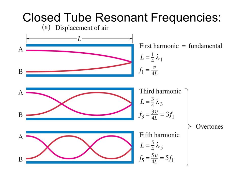

I also wonder about the modes they show* as I am sure I saw an analysis somewhere on pipe modes that showed that the dominant mode has two maxima along the tube (hence why audiomods put two reinforcing washers in their RB300. As usual I didn't save the link.
*They claim on their graph a main mode of 280Hz but a hoofing great peak at 4x that frequency. I assume they mean 'first mode' in which case the 4th harmonic does matter as per audiomods

Re-reading the articles by Morgan Jones on the making of his tonearms he also needs the 4th mode of the armtube as the potentially problematic one. He had found that a strip of electrical tape around the tonearm at the resonant Maxima was enough to damp things.
As to where these maxima are it appears to be 5th harmonic. as the tube is effectively 'closed' by the bearings. This leads to the question, if you have a townsend style damping trough at the front is that enough to make the armtube appear as a closed pipe? I suspect it might.
