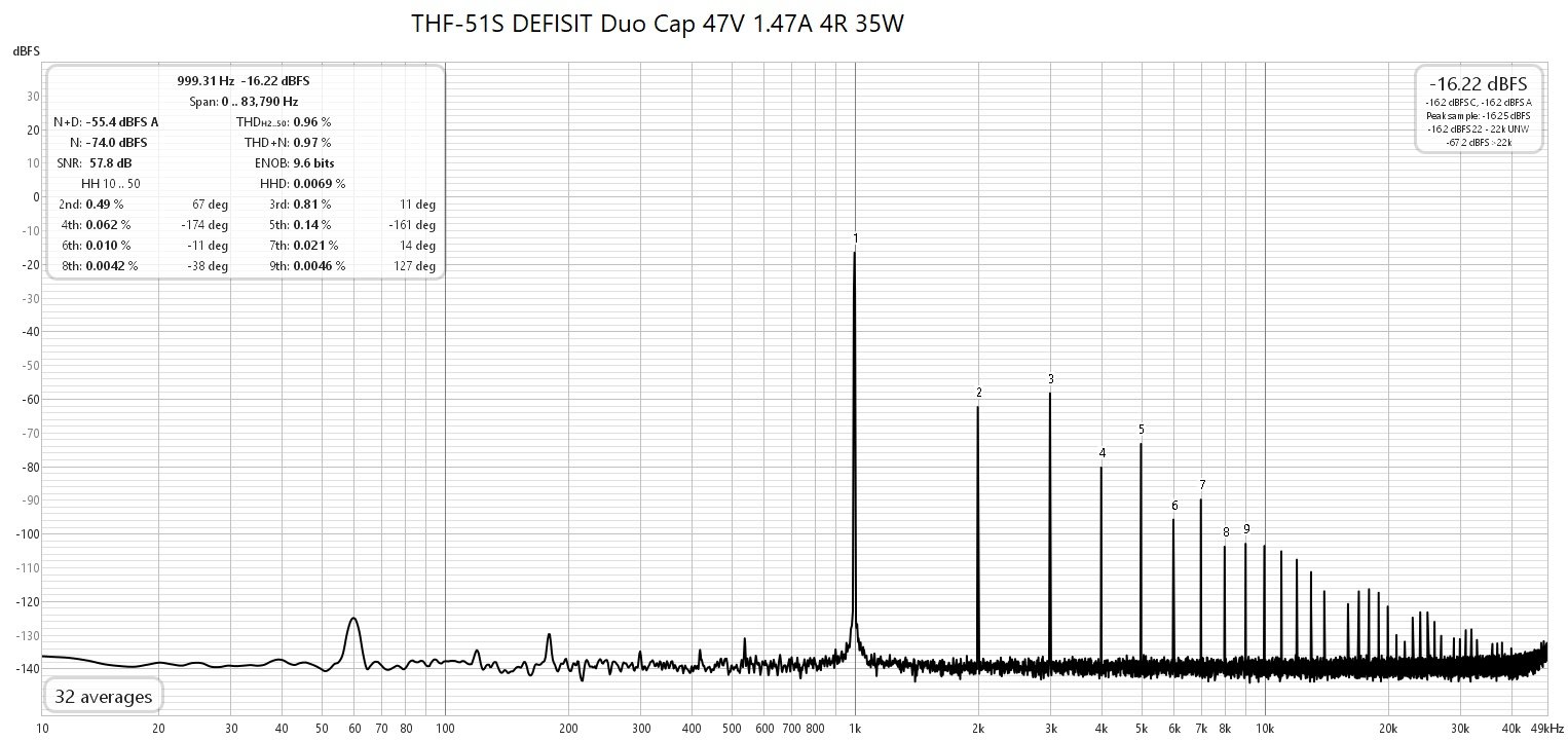

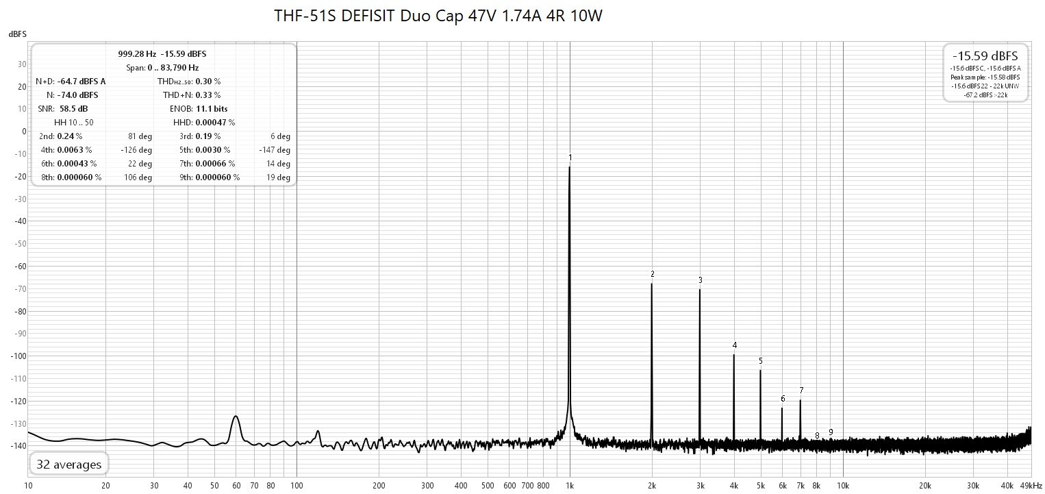

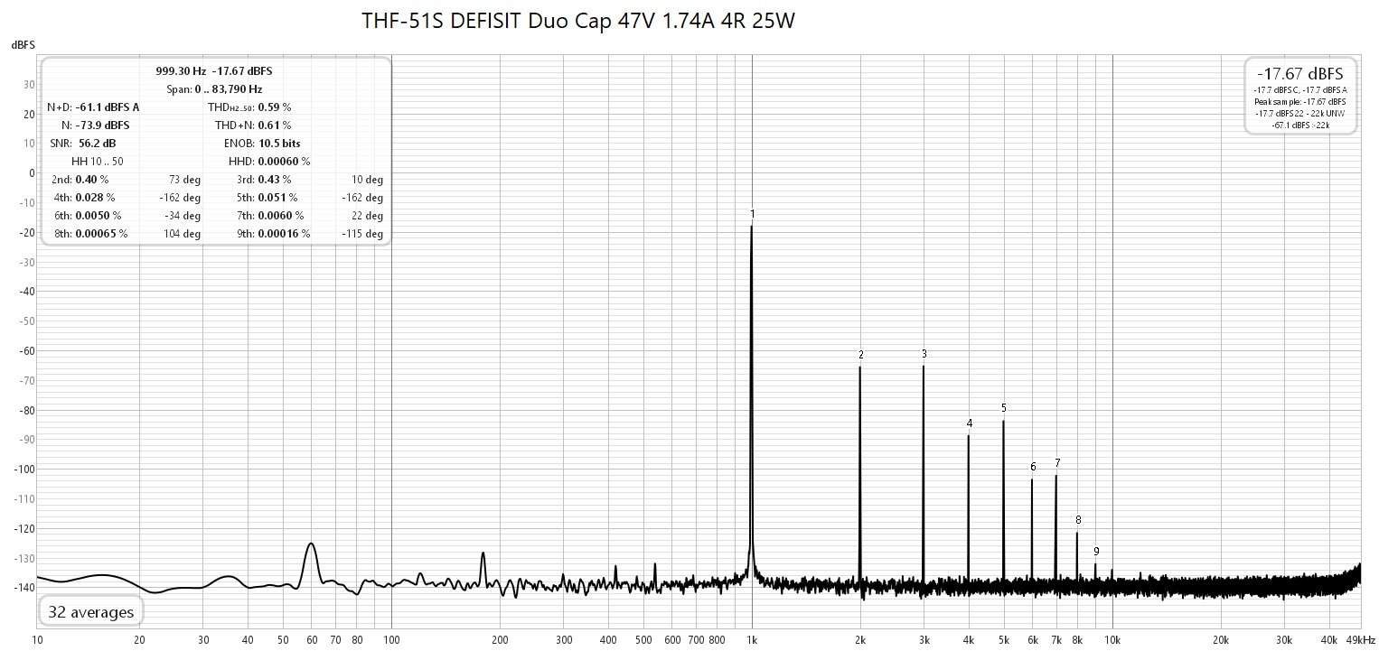

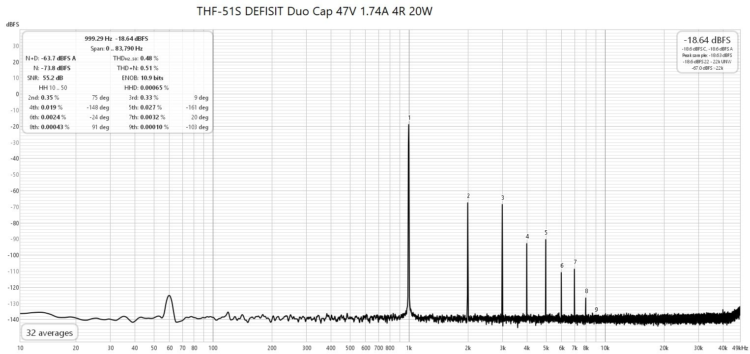

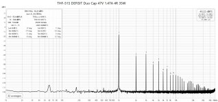

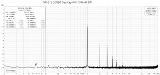

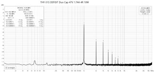

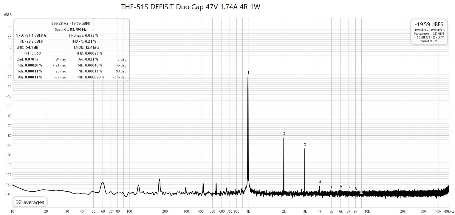

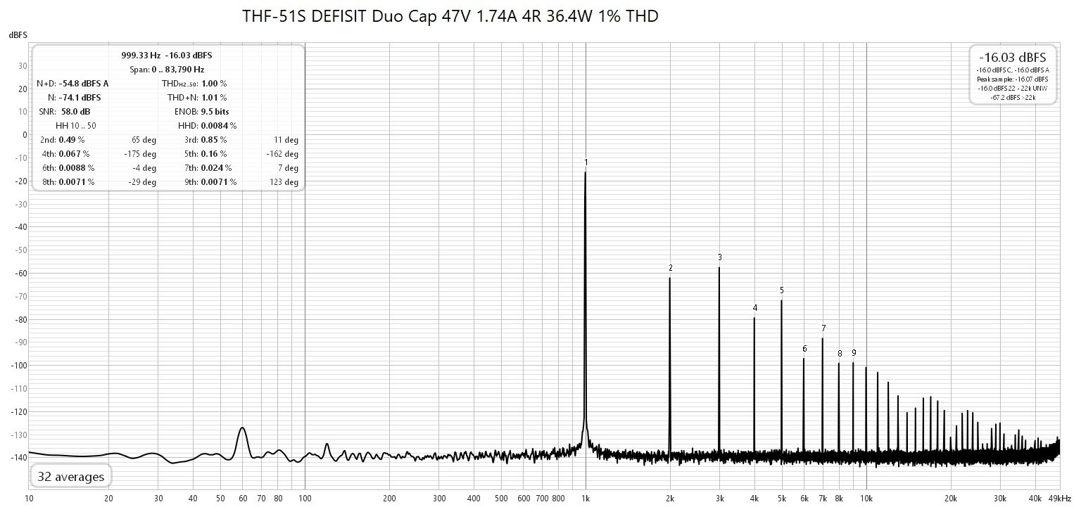

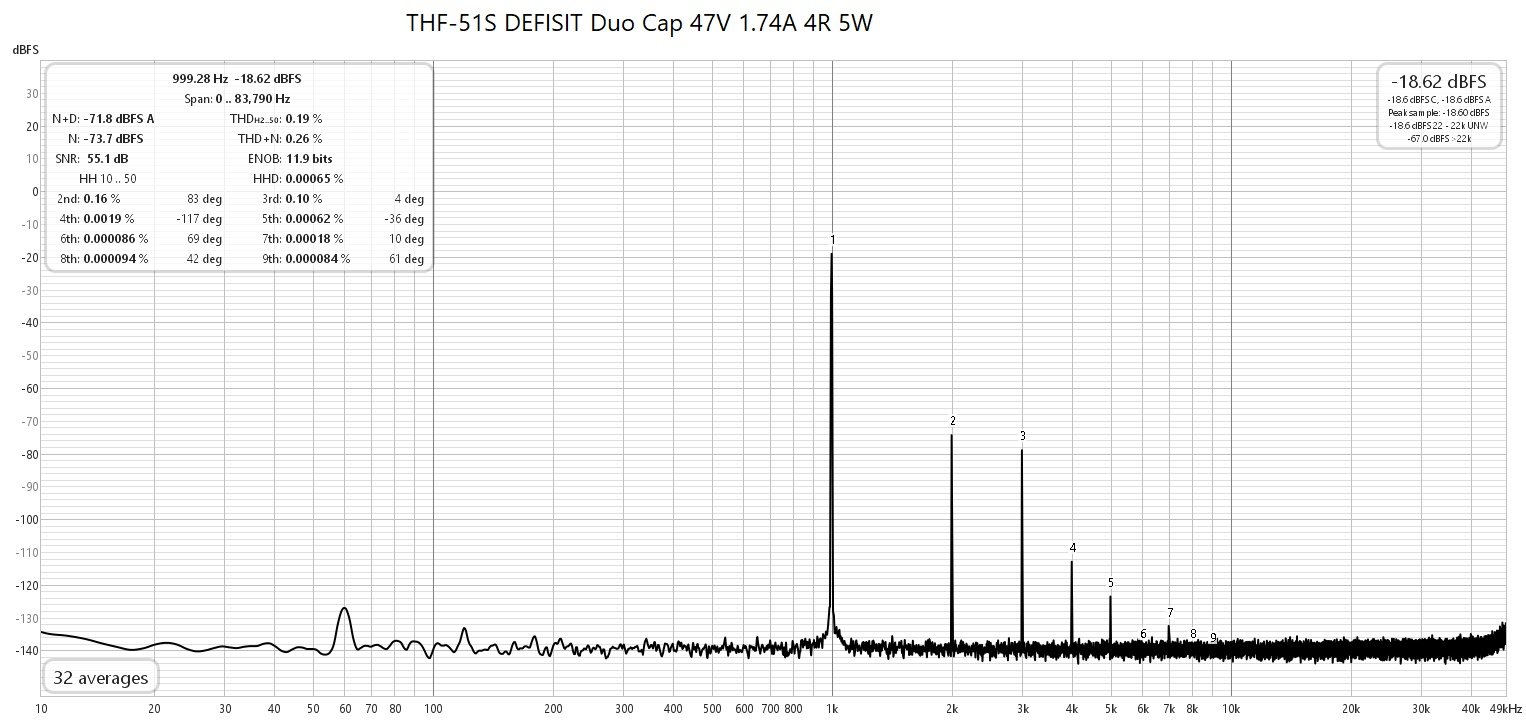

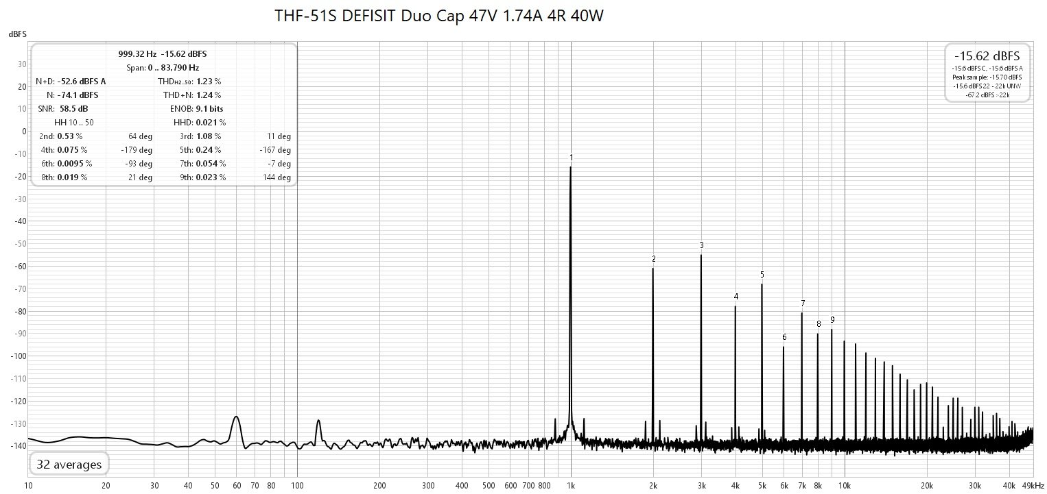

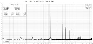

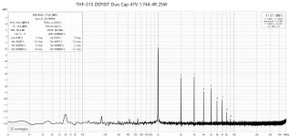

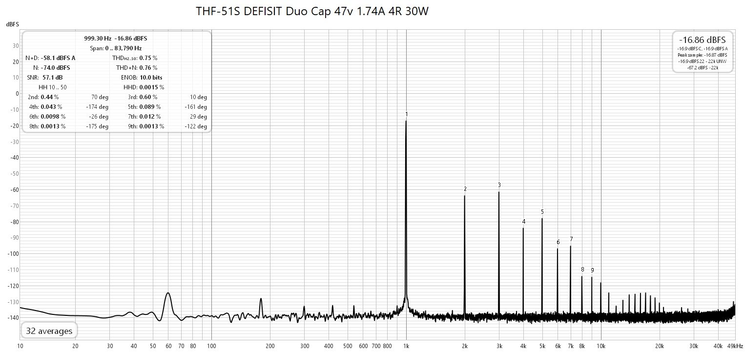

And the 4 Ohm load:

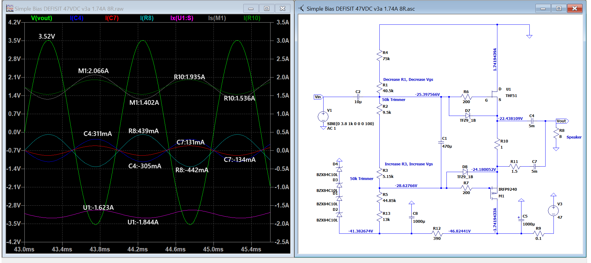

Here are some numbers (resistance values and Vrms measured across the resistance) from my measurement of the as-built right channel, 47VDC power supply and Iq=1.74A:
1. Output load=220R in parallel with 8.2R= 7.9R
Irms=2.49Vrms/7.9R= 0.315A= 315mA, LTSpice Irms=0.707x3.52Vp/8R= 0.311A= 311mA, also Irms=0.707x(439mA+442mA)/2= 311mA
2. Source resistors=5x0.2R=1.0R
Irms=131mVrms/1.0R= 131mV, LTSpice Irms=0.707x(1.935A-1.536A)/2= 141mA
3. Mosfet output resistors=3x0.5R=1.5R
Irms=137mVrms/1.5R= 91mA, LTSpice Irms=(C7 Irms)=0.707x(131mA+137mA)/2= 95mA
4. Mosfet Measured Current = 91mA+131mA= 222mA (output resistor current + source resistors current), LTSpice Mosfet current=0.707x(2.066A-1.401A)/2= 0.235A = 235mA
5. SIT Measured Current = 315mA-222mA= 93mA (Total current - Mosfet current), LTSpice SIT current = 0.707x(1.844A-1.623A)/2= 0.078A = 78mA
6. Mosfet direct to capacitor/Total output at load = 91mA/315mA= 29%, LTSpice =95mA/311mA = 31%
Overall I would say that the LTSpice results were reasonably close to the real life measurements.

Hi Ben, when I calculate in your way the current through the resistor to the second cap divided by the current in the load you have the 29% MosFet contribution, you calculated the same.
When I calculate the contribution in the way Nelson suggested we have (131mV + 91mV) divided by 315mV = 70% Mosfet contribution.
I hope I took all values correct.
So what is the truth.
When I give the way Nelson suggested priority we all must use about 3R between the sources to get the 30%

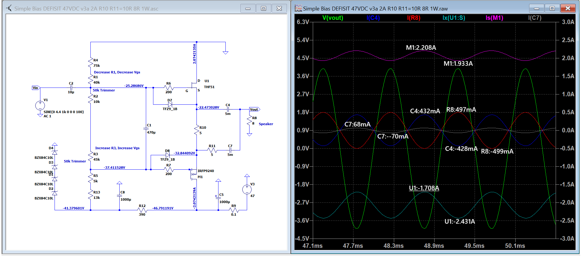

As for R11, if that is open, simulation showed that the circuit behaved as push-pull, with equal current from SIT and mosfet, with the mosfet current going through R11 and out through C4.
I think it is a matter of finding the right combination of resistors. I just tried R10=R11=5R and the results were very promising.
Here are the simulation results:
C4 = 432mA+428mA = 860mAp-p
C7 = 68mAa=70mA = 138mAp-p
R8 = 497mA+499mA = 995mAp-p
U1 source = 2431mA-1708mA = 723mAp-p
M1 source = 2208mA-1933mA = 275mAp-p
U1 source + M1 source = 998mAp-p
(M1 source)/(U1 source + M1 source) = 275/998 = 27.6%

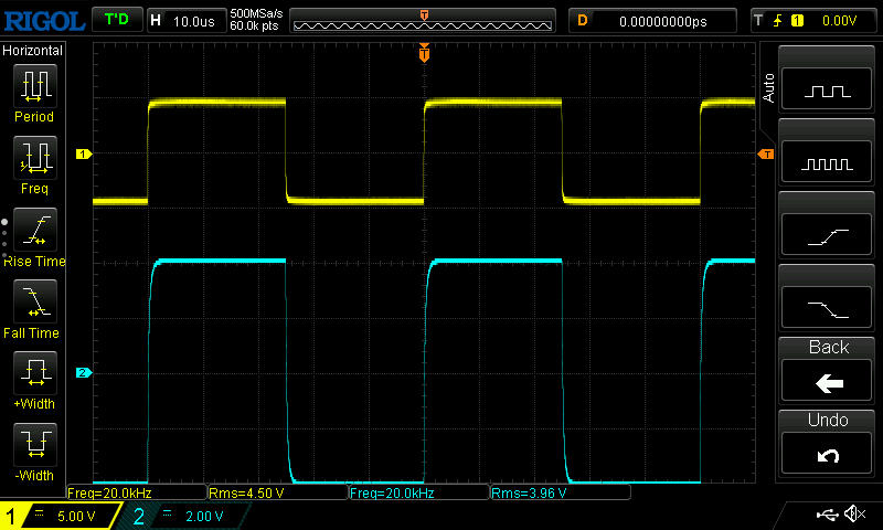

Here are some more real life test results. I ran some square waves through the amplifier. My old HP 3310A was the source. The amplifier output showed a small amount of high frequency roll-off, but nothing dramatic. The HP wasn't perfect either. The yellow trace was the HP, and the blue trace was the amplifier output. Load was 8 Ohm.
