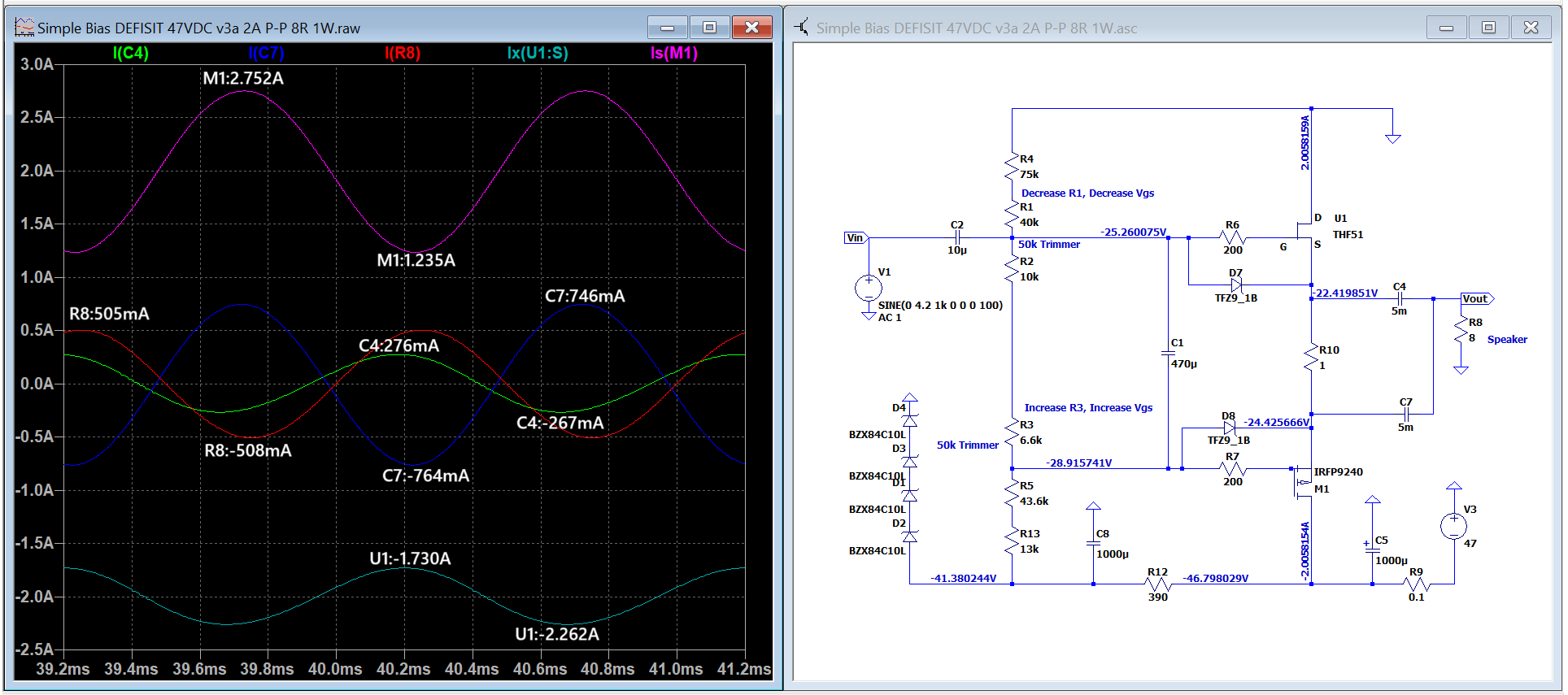

Here are a couple of LTSpice simulations. I did many simulations, but these two are what I based my design on. I chose -47VDC for one sim since I intended to build it using one of my existing amplifier chassis and power supply. I chose the -63VDC for the other since that is a reasonable voltage that will take advantage of the power capability of the THF-51S and still keep the power supply voltage reasonable for capacitor voltage and heat sink heat dissipation.
As shown in the simulation results (47VDC power supply and 2.0A Iq), the measured current through C4 connected to the SIT drain was 361mA peak, the measured current through C7 connected to the mosfet drain was 150mA, for a total of 511mA. As a check the current measured through the speaker, R8, was 509mA - close enough. So the contribution of the mosfet was 150mA/511mA = 29%.
I have not included the LTSpice screen shots of power output but the 8 Ohm power output was nearly 23W at 1% THD and 4 Ohm power output was nearly 40W at 1% THD.
63VDC PS 2A 8R 1Watt:
63VDC PS 2A AC signal current through C4, C7, and 8R Speaker:
47VDC PS 2A 8R 1Watt:
47VDC PS 2A AC signal current through C4, C7, and 8R Speaker:

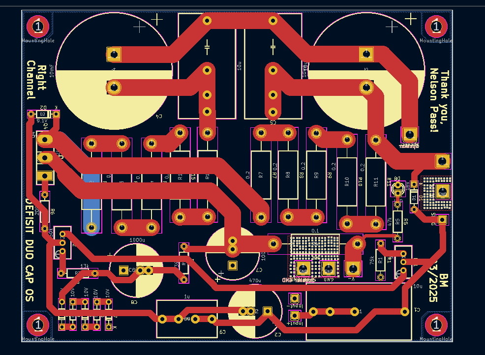

As mentioned I decided to build the 47VDC version. The chassis and power supply is from my BAF2015 Amplifier - A SIT Mu Follower Revisited With Feedback (https://www.diyaudio.com/community/...t-mu-follower-revisited-with-feedback.408193/). The power supply is CLC, comprising 2x22mF - Hammond 156B - 2x22mF, and an Antek AS-3218 transformer per channel for full dual mono construction.
I put together a PCB design and sent it off to JLCPCB for fabrication. In addition to stuffing the PCB once I received it, I also changed the CLC filter from V+ supply to V- supply.
Initial power-up and subsequent Iq and SIT Vds adjustments went smoothly, and Iq and SIT Vds were stable.

Wonderful Ben. That heatsink is not huge; what are its dimensions? Any listening tests so far? Enjoy!!!!
The board is 100mm x 130mm and the heat sink is 150mm x 400mm, so it is not a small heat sink. In the past I have had 90W on it with no overheating issues.

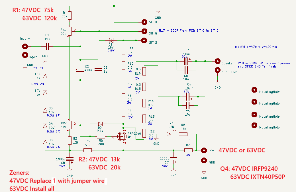

Here is my KiCad schematic and right channel PCB layout.
The PCB has a ground plane on the back, and I was able to place all of the circuit traces on the front side except for one short trace.
As mentioned previously, the power supply outputs 47VDC under load.
The only difference between the schematic is that for R12 to R16, I replaced the five 0.3R 3W resistors with three 0.5R 3W resistors and two jumper wires. There is no DC through those resistors and only signal AC, so no constant heat dissipation. In normal operation they feel only slightly warm.
KiCad is fun, LTSpice is fun. I look at them as nerds' computer games.
I have never used auto routing. I prefer to place and route on my own based on my understanding of current flows and loops. So far the boards that I have designed have performed to my expectations. 🤓
I guess you wanted to say at source pins..connected to the mosfet drain
If you plot the source current of sit and source current of mos, how do the ratio of each looks when compared to current through load?
Whoops, my mistake. The capacitors are obviously connected to the source pins.

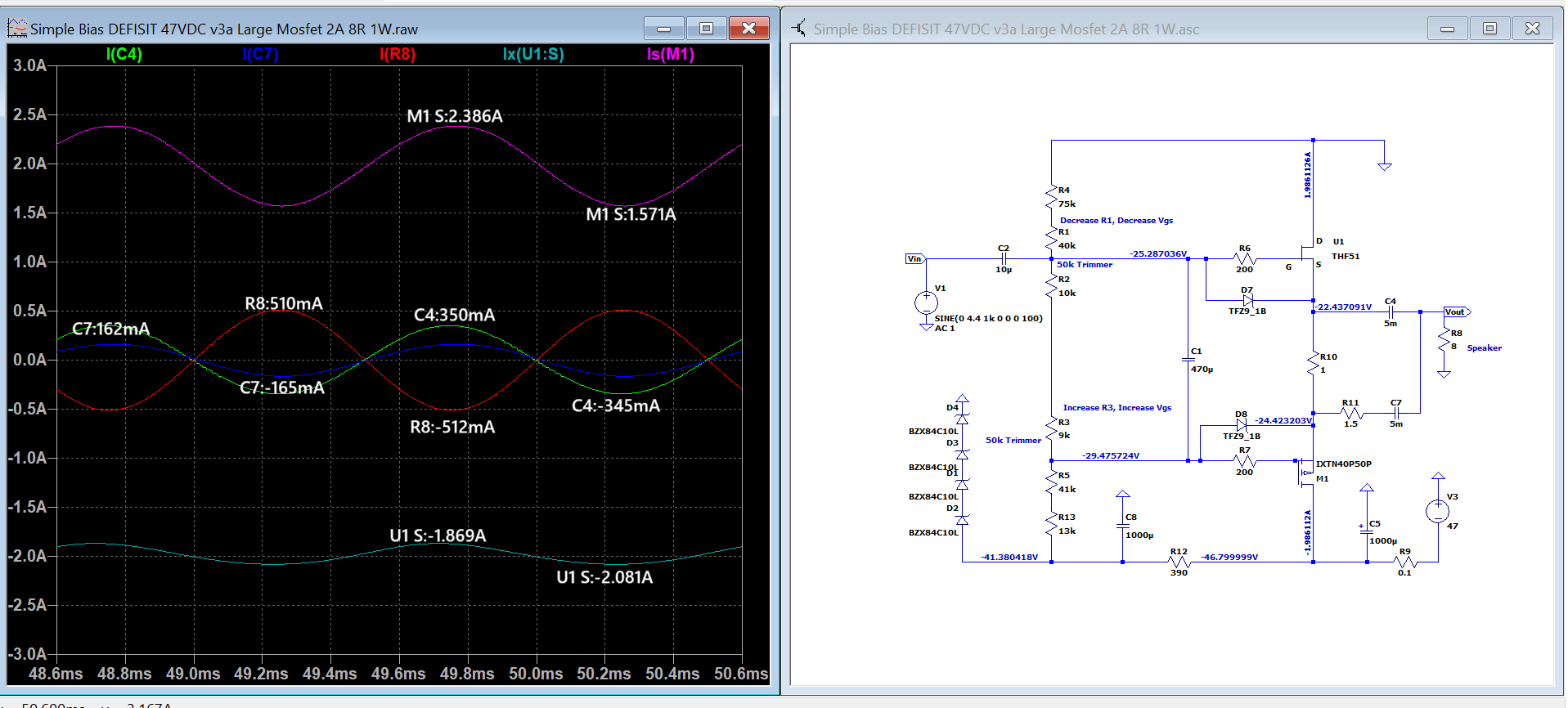

I have also looked at the signal current at the source pin of the mosfet. The current is much higher than the signal current at the SIT pin.
C4: Ip-p=350mA+345mA=695mA
C7: Ip-p=162mA+165mA=327mA
R8 (speaker) Ip-p=510ma+512mA=1022mA
U1 (SIT): Ip-p=2081mA-1869mA=212mA
M1 (Mosfet): Ip-p=2386mA-1571mA=815mA
The numbers show that there is no signal loss. The resistor in series with the capacitor controls the current through C7, and the remainder of the current goes through C4.
The numbers show the current at the mosfet source is much higher than the current at the SIT source - 21% at the SIT and 79% at the mosfet.
So according to the simulation numbers and my interpretation of the numbers, the mosfet signal current at its source partially flows through C7 and the remainder flows through C4. C4 has current from the SIT and mosfet.

Another "experiment" - no resistor in series with C7:
C4 Ip-p=276mA+267mA=543mA
C7 Ip-p=746mA+764mA=1510mA
R8(Speaker) Ip-p=505mA+508mA=1013mA
U1 (SIT) Ip-p=2262mA-1730mA=532mA
M1(Mosfet) Ip-p=2752mA-1235mA=1517mA
Looking at the numbers, the currents through C4 and C7 are now out of phase, as are the currents at the SIT and mosfet sources.
The numbers do not add up exactly as the peaks do not line up exactly.
The current at the speaker is now the difference of the two currents.

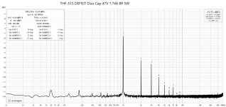

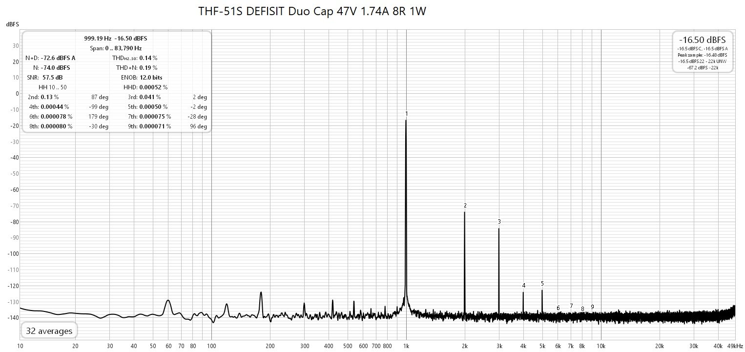

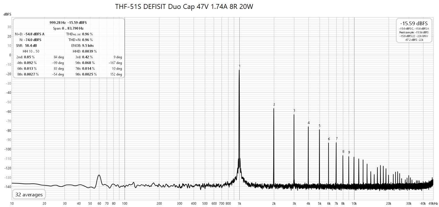

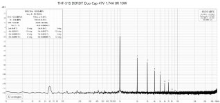

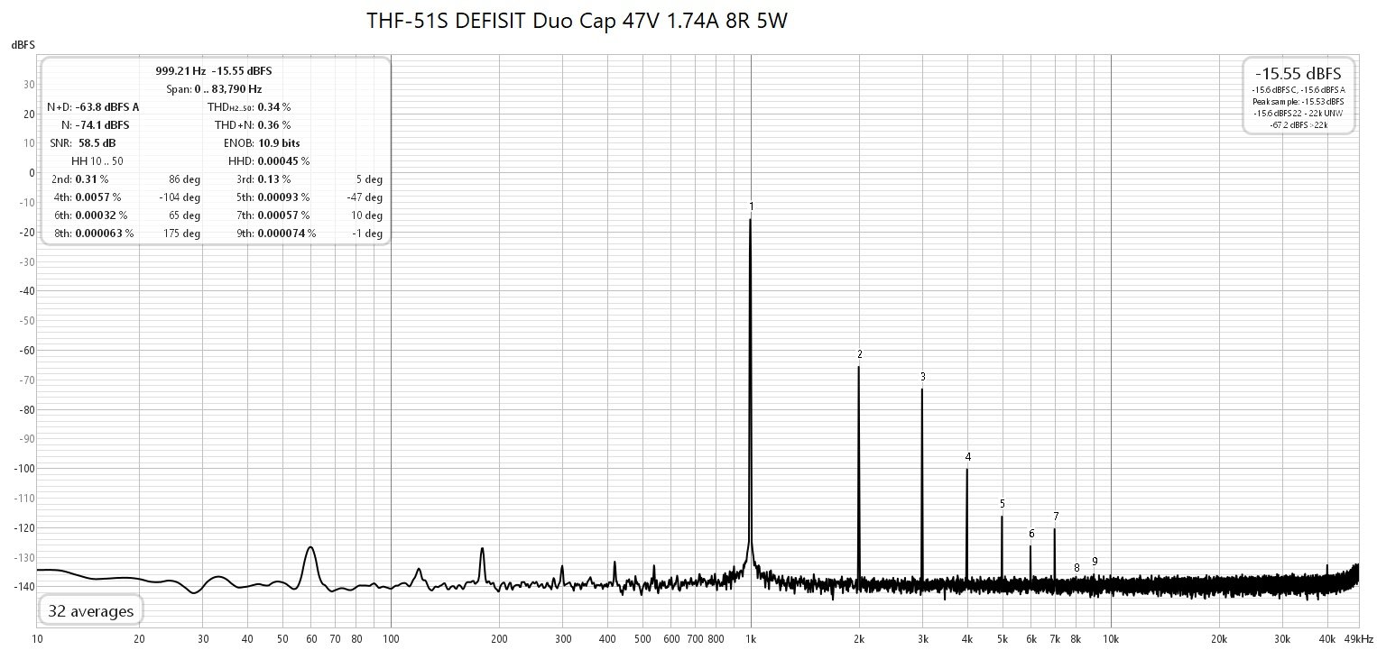

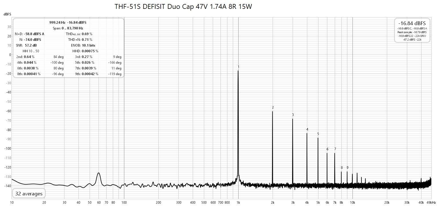

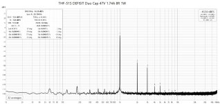

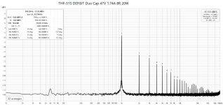

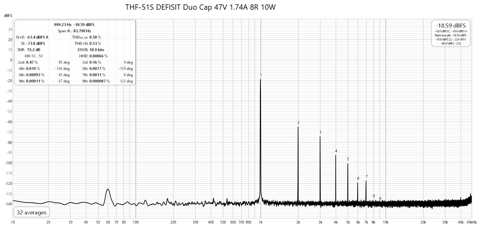

Enough of LTSpice. Here are some real world distortion measurements. They were done with Iq=1.74A. Why? It was at that level when I decided to listen to it, and then test it. So not technical reason. 🤓
8 Ohm load, and I stopped at 1% THD.
