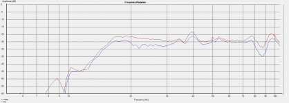

I've been playing around with Equalizer APO for a few days to get room modes under control. Main culprit is 39 Hz boom. Also needed boosts at 24, 45 and 87 Hz (the last null being impossible to get totally rid of).
Overall, I'm pretty pleased with that driver; it blends in with the mains seamlessly, has good efficiency and very life-like sound with no audible distortion even below 20 Hz. The end result is this (no smoothing applied to graph):

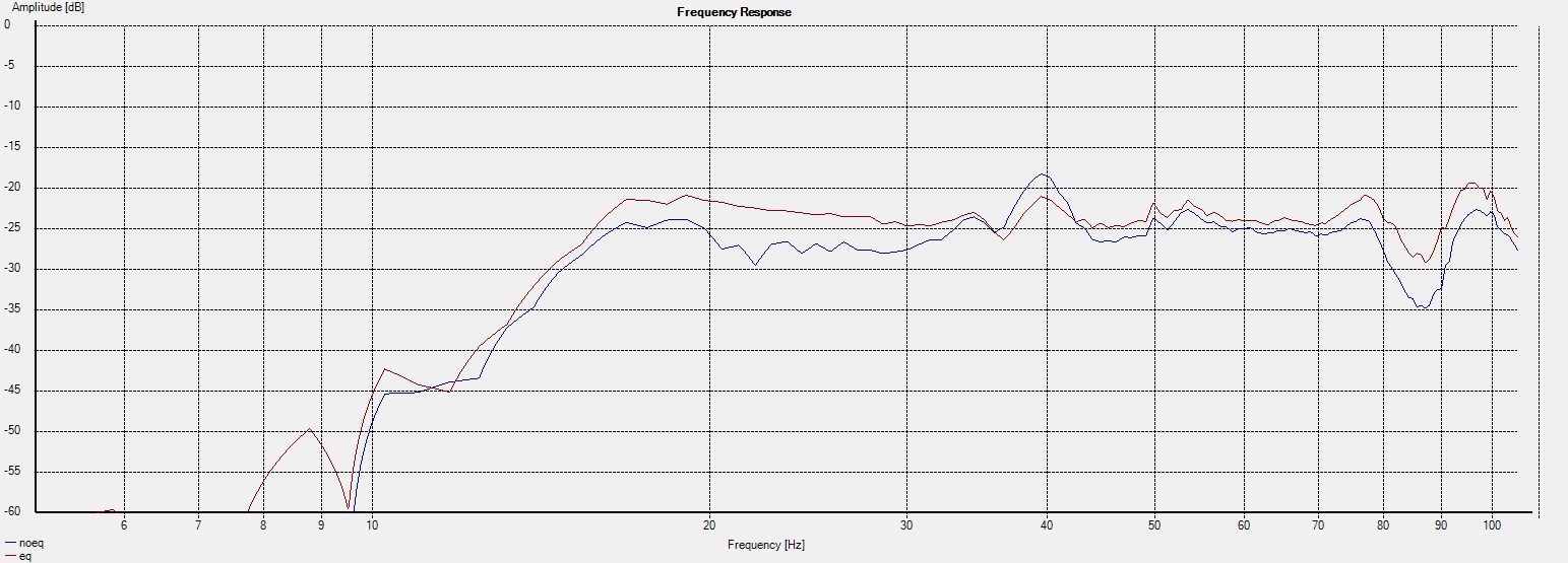

My room is about 4,5x3,5 meters, listening position is about 1,4 meters from the back wall. If you run the numbers, the first axial mode is right at ~39 Hz. The null at ~45 Hz seems to be the second axial mode. And all these peaks and nulls have been here with any speaker setups 🙂

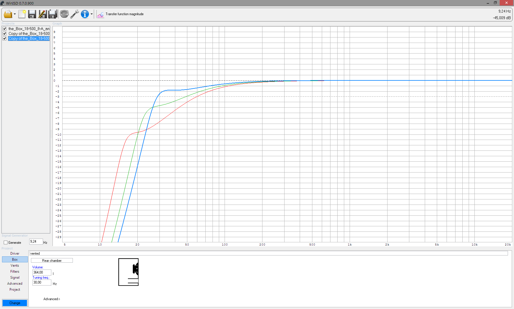

Here's a plot for different box tunings (~19 Hz as built, 25 Hz and 30 Hz), 30 Hz is optimal for maximum total SPL view, but, like all things in audio, it's about what compromises you are willing to make. I also added comparison between EQ-d and non-EQ-d response at listening position:

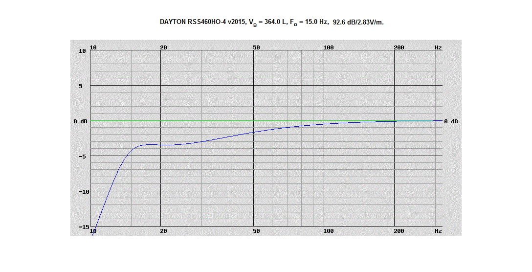

Dayton Audio RSS460HO-4 18" Reference HO Subwoofer 4 Ohm
Taking the driver/CABINET SIZE/port to your spec, 364L/Vb (calibrated) u have (below). Have fun😀
(1) with (4x) port 10.3 cm (diam.), 14.0 Hz
Surface : 333.29 cm2 - length 126.26 cm
(2) with (3x) port 10.3 cm (diam.), 14.0 Hz
Surface : 249.97 cm2 - length 92.70 cm
(3) with (3x) port 10.3 cm (diam.), 15.0 Hz
Surface : 249.97 cm2 - length 79.18 cm (port resonance 217 Hz)
F-6 dB/F3 in room: 13.8 Hz
SPL 1m/1 speaker (60.54 V/812.4 W): 119.2 dB with thermal attenuation 114.5 dB.
