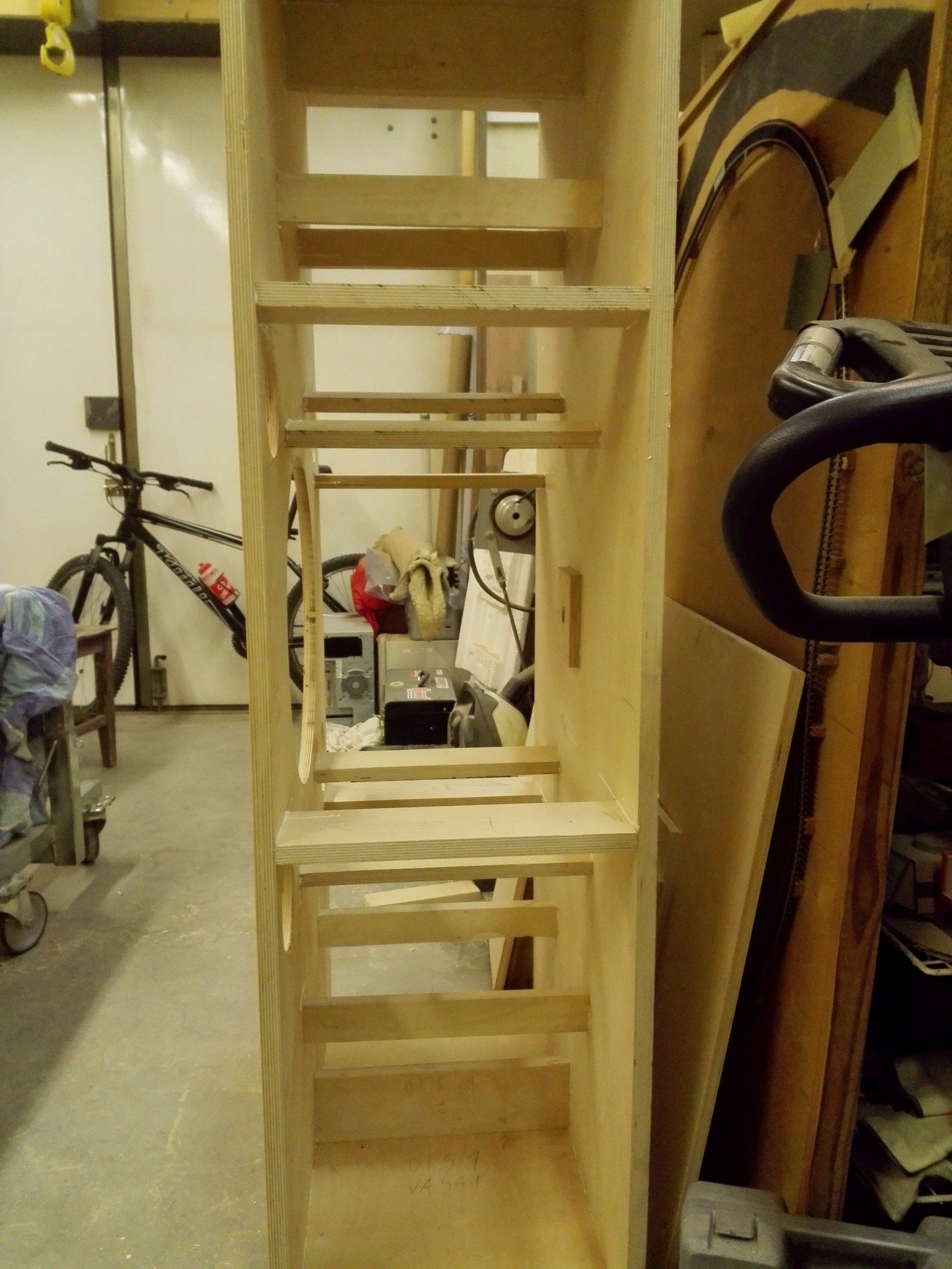

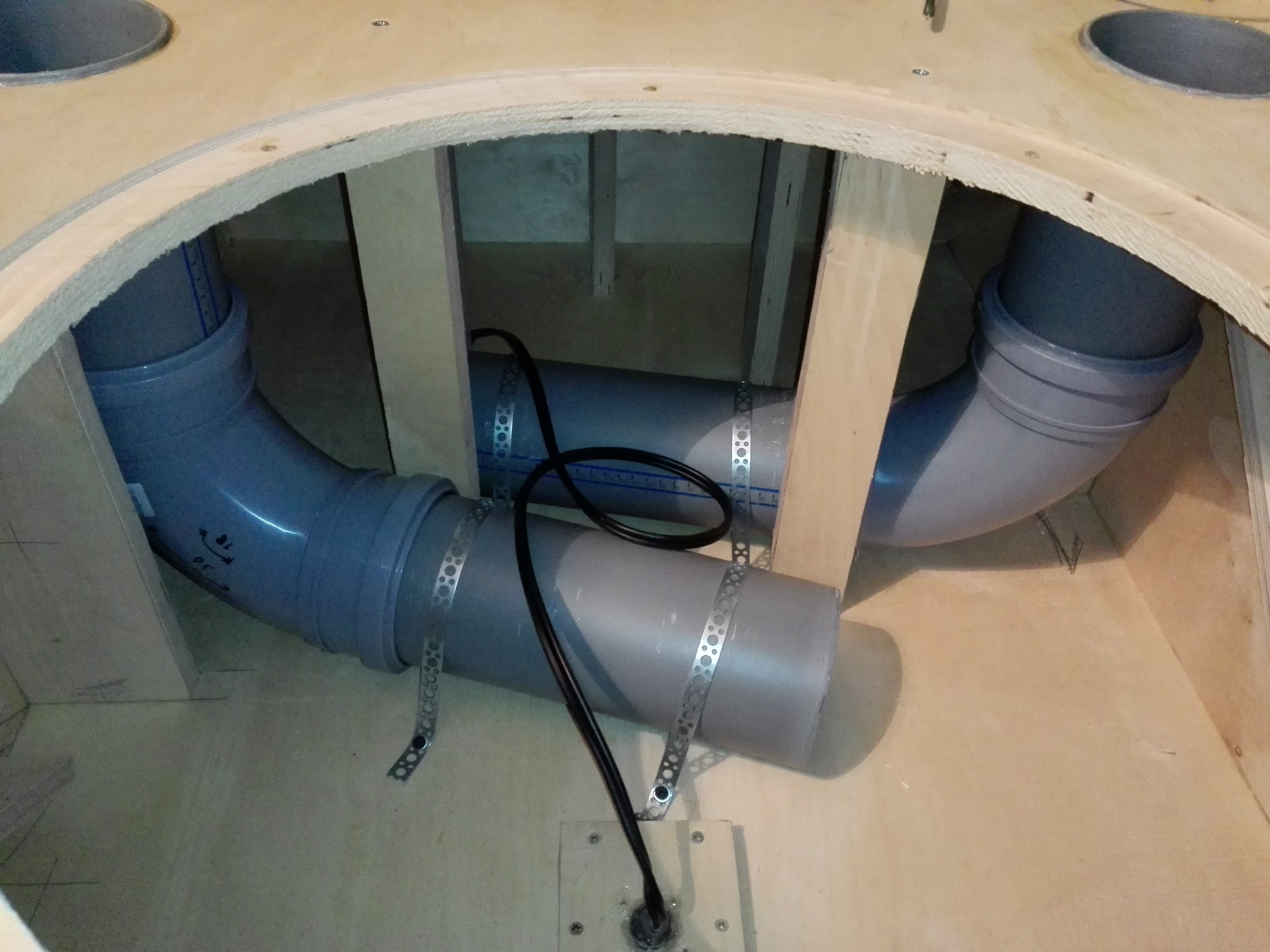

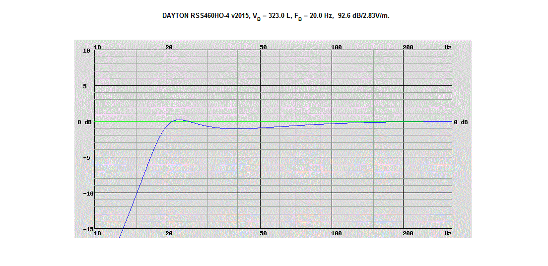

18" DAYTON RSS460HO-4 v2015The box is 364 liters internal, 488 external, dimensions are chosen so it can fit on two 1525 x 1525 mm plywood boards with minimal waste - front and back are from one board cut in half, the rest is fitted on the other board. Ports are four 110 mm PVC pipes, 750 mm long including 90° bend.
Fs Hz, VAS L, Qts, Xmax mm
18.80, 272.00, 0.322, ± 12.8
Ports: 110 mm PVC pipes (internal?)
length + bend = lower freq (?) (how much total length?)
A cylindrical shape that has a diameter of 12 centimeters and a depth of 75 centimeters has a volume of: = 8.5 liters
4x ports = 34L (+/-)
"18" driver occupies 6.5/7 litres" (+/-)
364L - 41L = 323L (net)
Alignment DAYTON RSS460HO-4, VB = 323.0 L, FB = 20.0 Hz

364 is the net volume (driver, ports and bracing subtracted). Ports are 110 mm external (103 internal), sorry for mixup, I posted that while tired of a day full of woodwork. I aim for 18 Hz Fb.

And bends will add length, yes? (75+ cm)
No, 750 mm includes bends, too. Most likely I need to do some trial and error with port lengths to get the desired Fb.

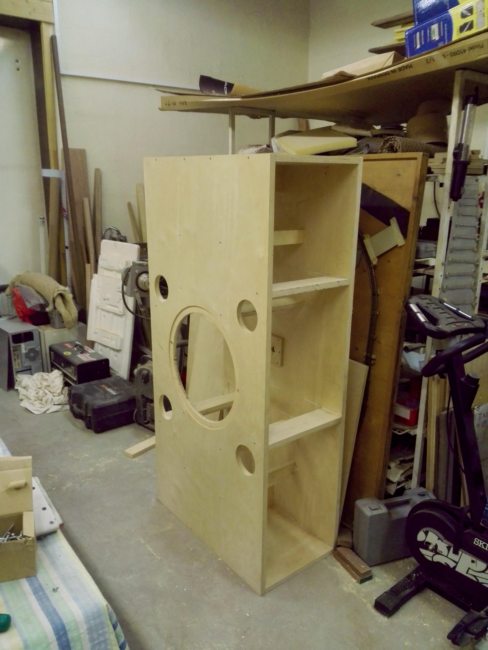

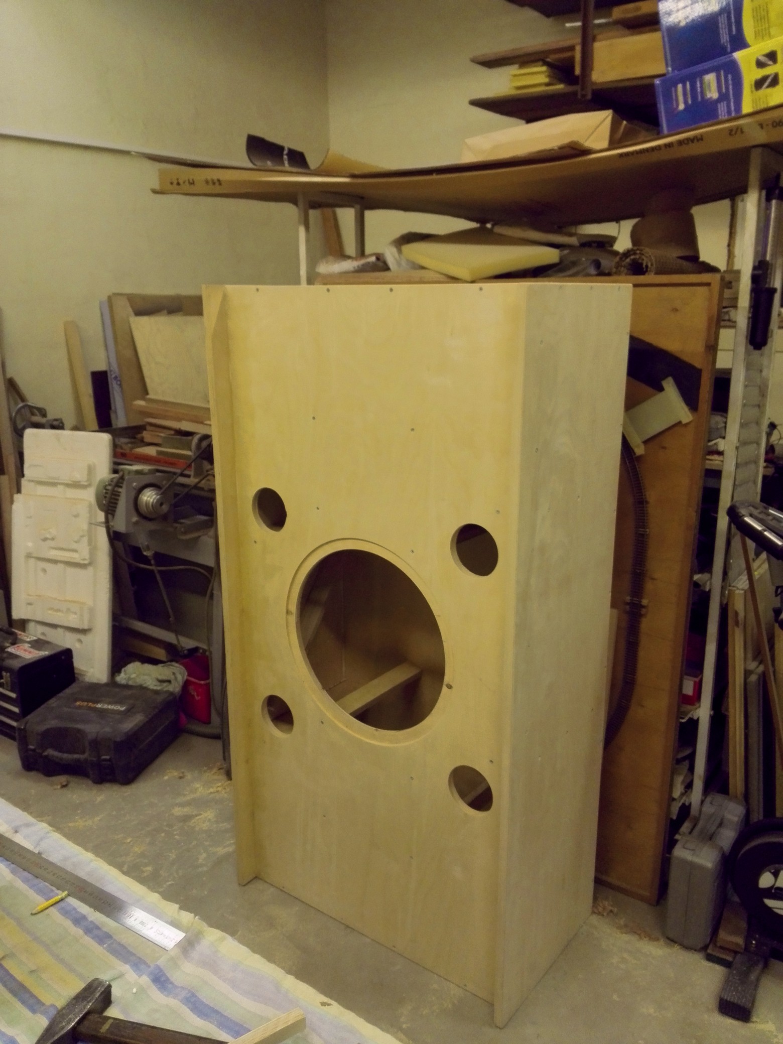

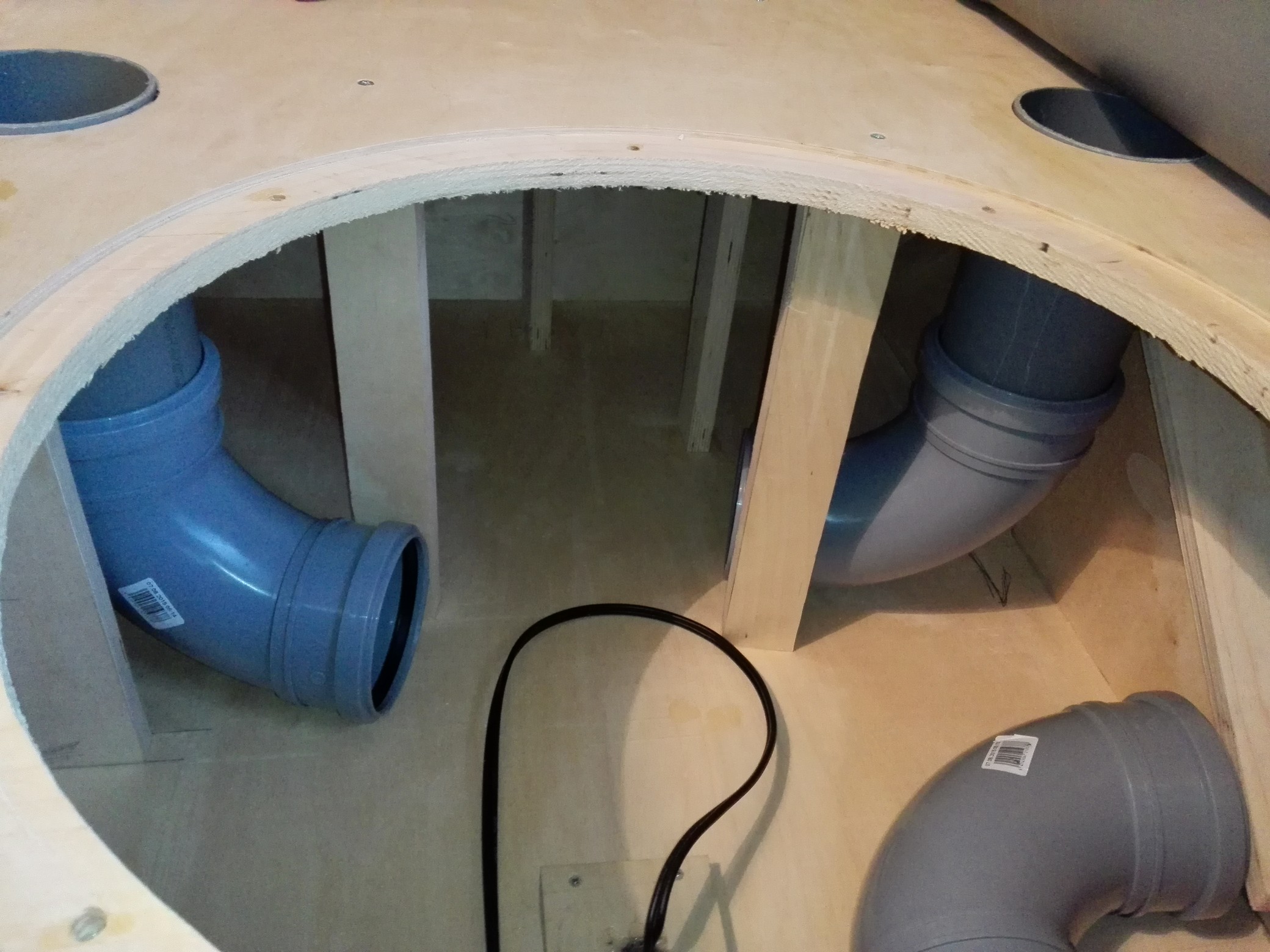

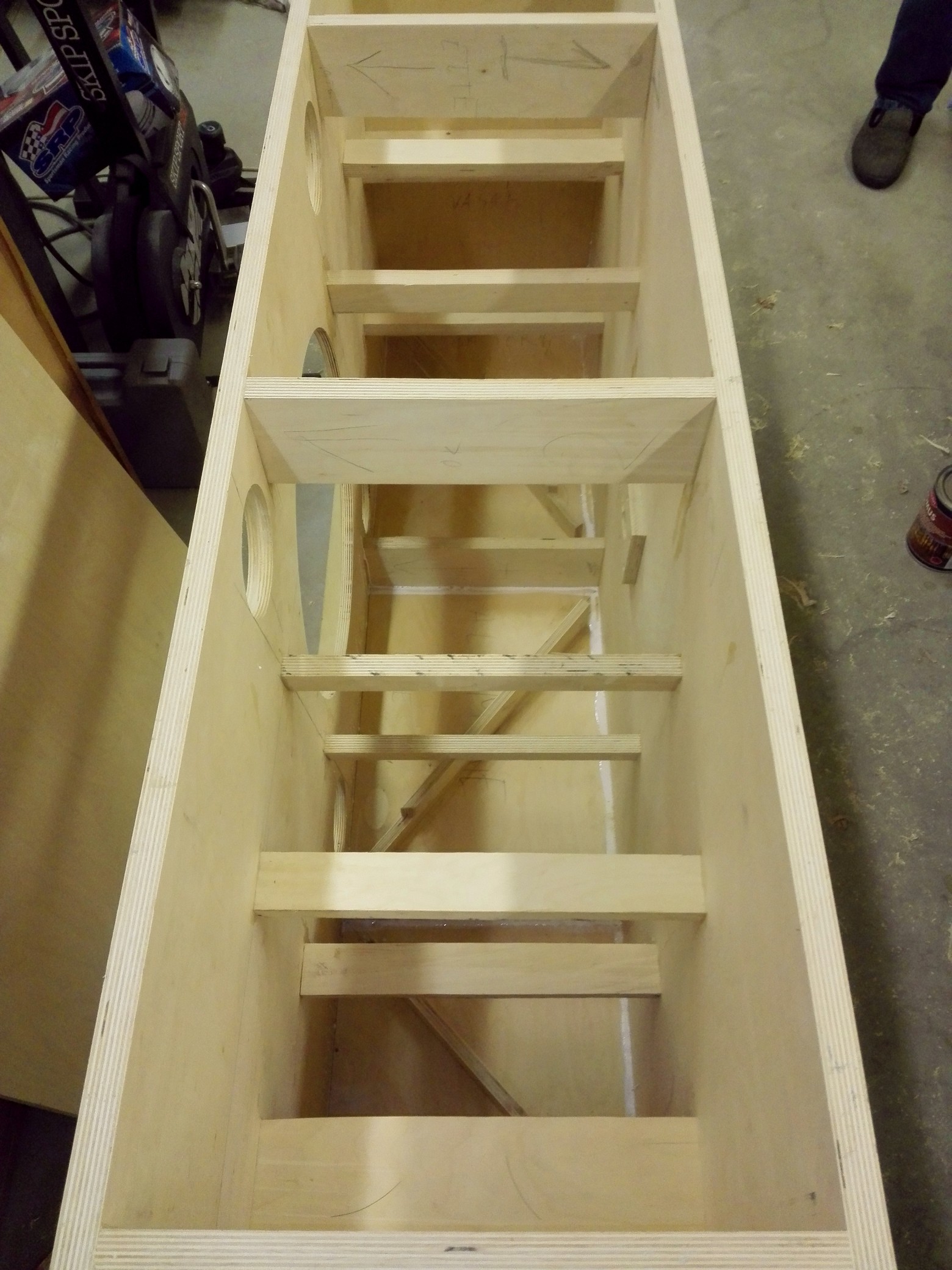

Today's progress - four sides plus bracing glued and screwed. Building to be continued Monday🙂

Yes, its big, about the same size as real cinema subwoofers. You have to have a big box for these kind of frequencies if you don't wat to use massive EQ and power amps to get any reasonable SPL. But then, it's only 450 mm deep, so the footprint is about the same as your average large 15"...18" sealed sub. Behind the screen or built into (false) wall is certainly a possibility, or behind the sofa for nearfield back massage😛

Well, I simmed bandpass enclosures before deciding on the box type, and they turned out to be bigger...

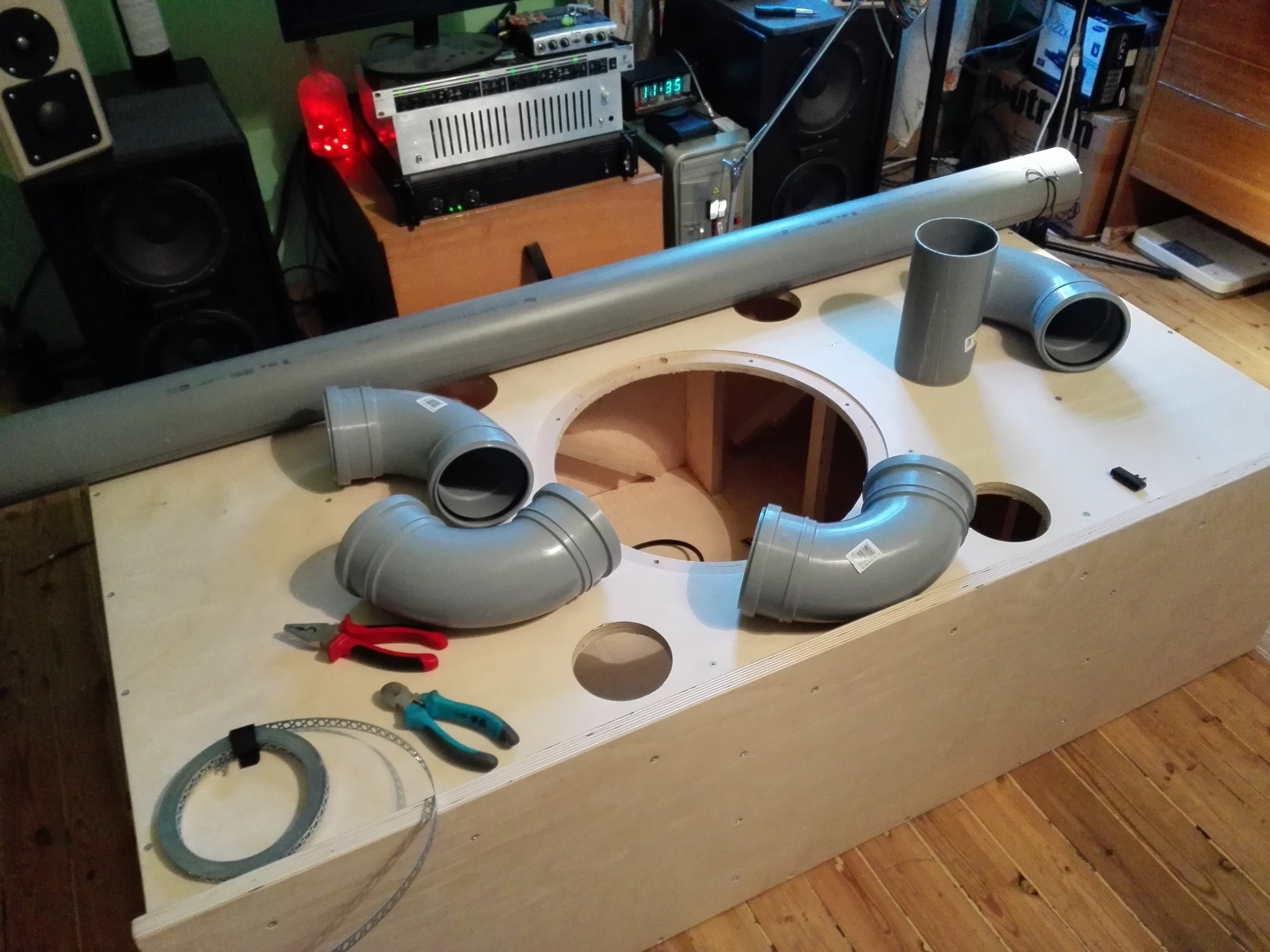

Anyway, it's almost done, only ports are left to be installed - will do it in the weekend

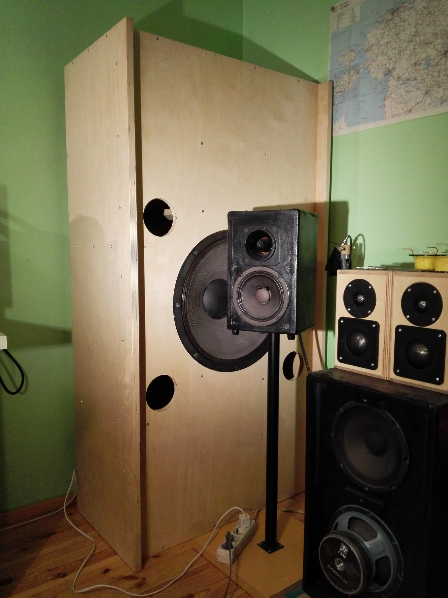

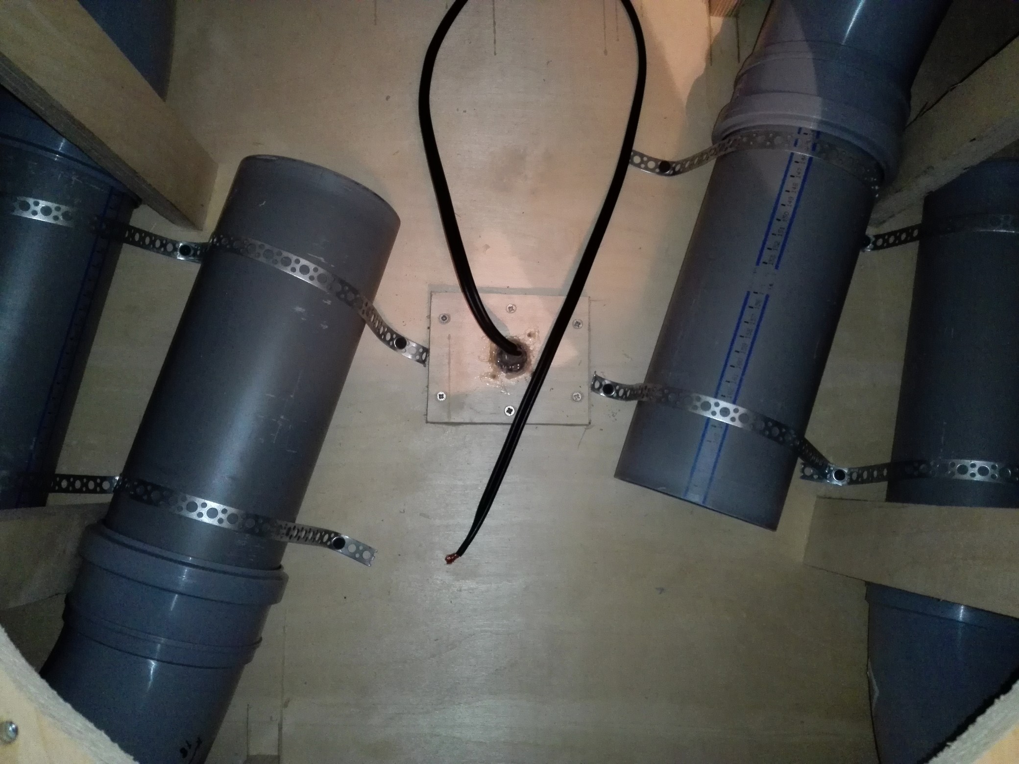

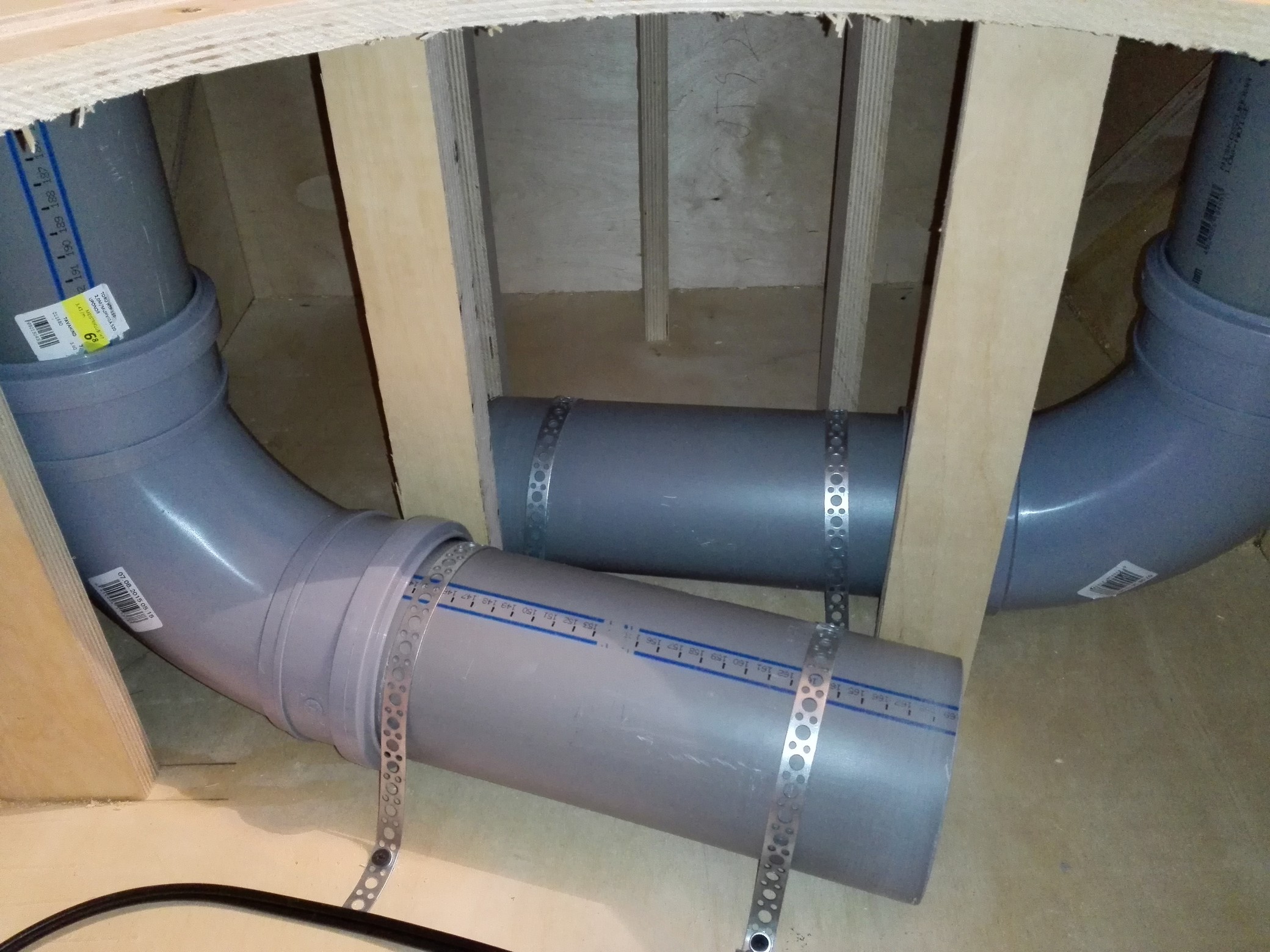

Finally got the vents installed
A quick test with sine wave generator and good old pair of ears confirms frequency response from 18 Hz up at room-rattling SPL (using one channel of my ~120 W/ch stereo amp). So I'd call the endeavour a success🙂 Still haven't got the proper amplifier, though, and last news were it's put on a backorder, so it's taking a while till I can set up the thing properly.
I've read somewhere that symmetrical port placement is beneficial at high power levels -- supposedly had to do something about equal pressure around the driver. I don't know how true that is and I'm certainly not going to abuse the driver with double the RMS rating amplifier playing low crest factor program hours on end, but I like symmetry, get a bit of OCD with that, even 🙂

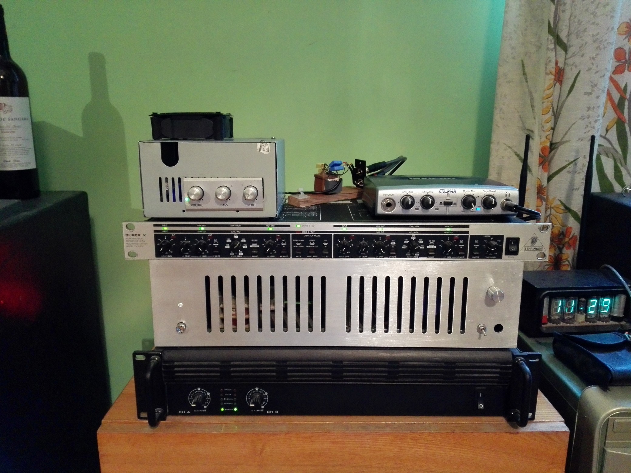

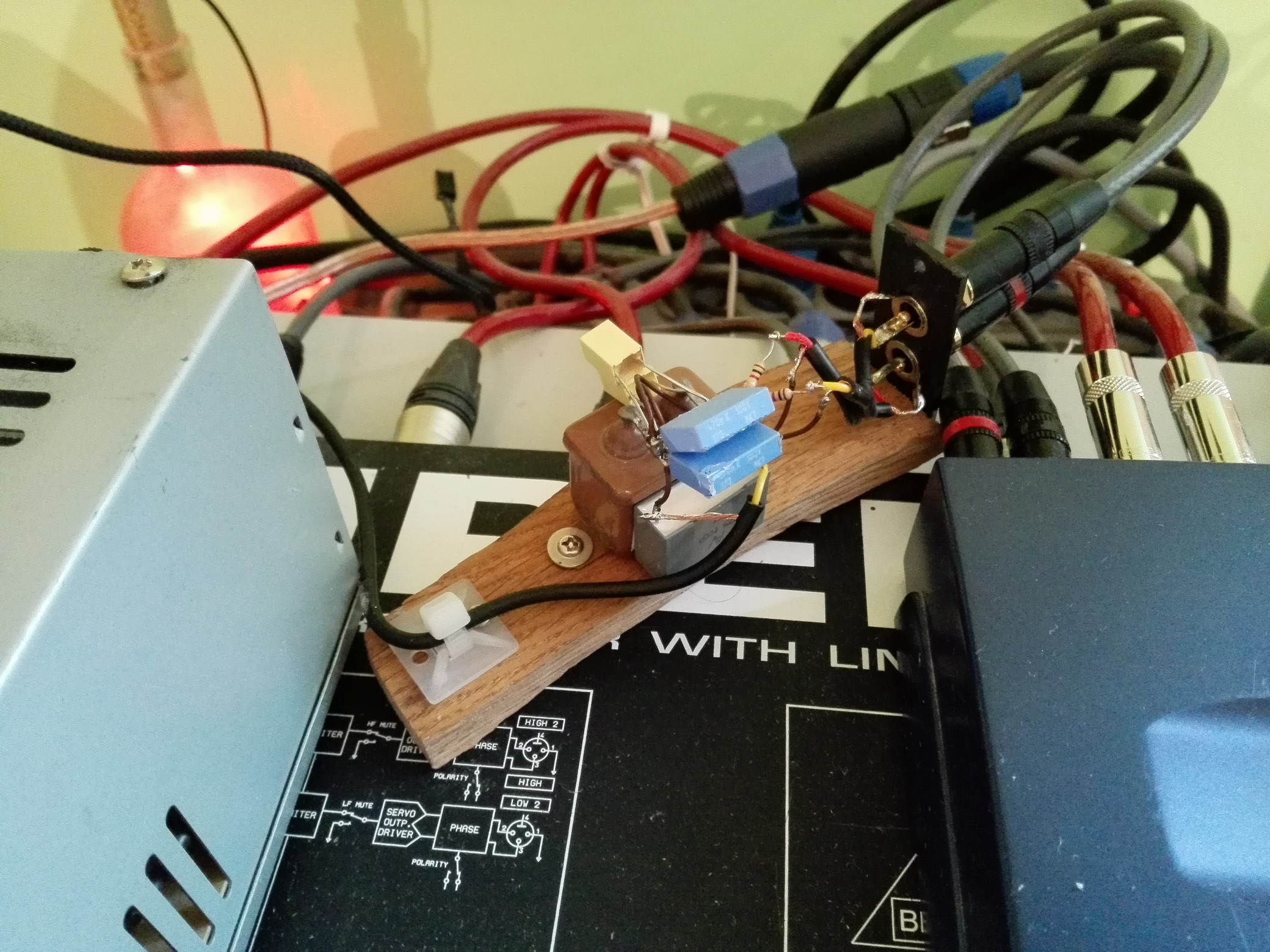

Meanwhile, I cobbled together a passive line level crossover and wired my small "lab amp" - a BTL STA540SA ripped out from some cheap PC speakers and fitted with a leftover 18,5 V power supply from my long-dead laptop, yielding around 18 W at 8 ohms - to drive the sub. Sounds good and plenty loud even with that minuscule amp.
