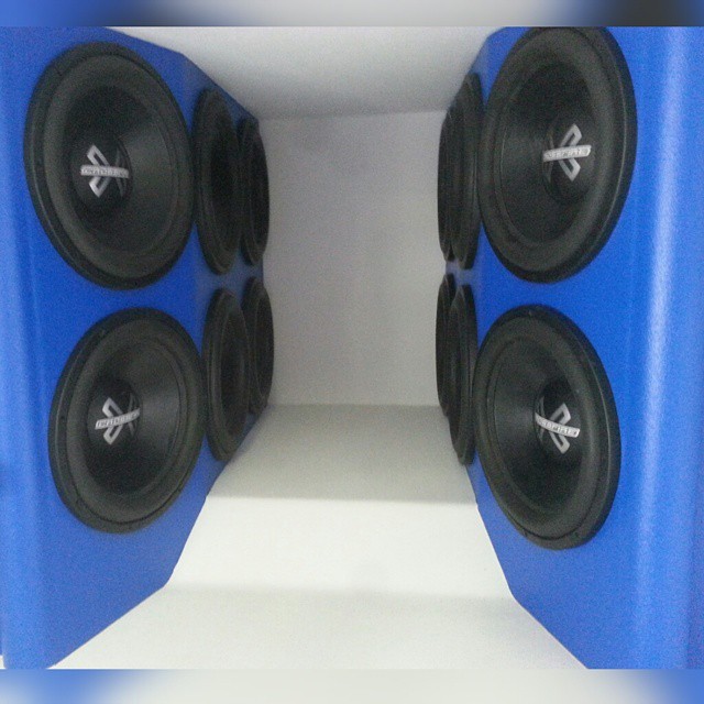

I've read somewhere that symmetrical port placement is beneficial at high power levels -- supposedly had to do something about equal pressure around the driver. I don't know how true that is and I'm certainly not going to abuse the driver with double the RMS rating amplifier playing low crest factor program hours on end, but I like symmetry, get a bit of OCD with that, even 🙂

That is something car audio guys figured out a long time ago and it is VERY true! Under high power levels, the sub closer to the port in a asymmetrical arrangement will bottom out much faster.

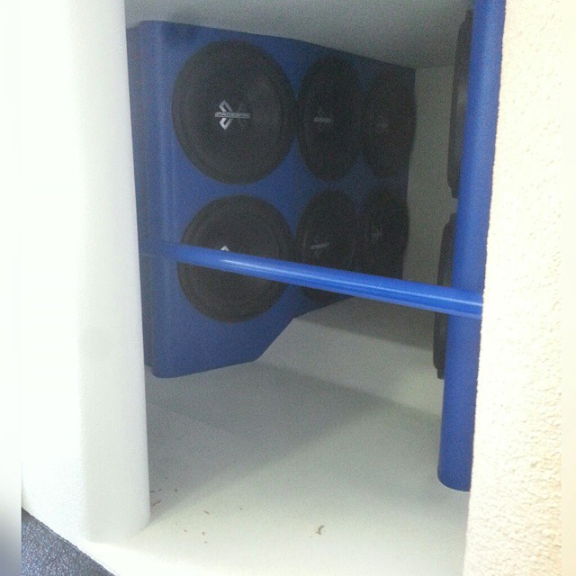

Def not popular myth lol. I've seen it happen too many times in real world installs. Guys have ripped down walls with hundreds of hours into labor to fix the isue. Guys doing big power installs learned it through trial and error. Tends to be the worst with installs with high port area relative to box size and cone area. Woofers furthest from the port will be fine, whereas the closer ones are audibly under distress. JBL tends to favor symmetrical ports too and they are big on science and experimentation for best real world world results.
As to the why I'm not sure, something with how the port and subwoofers load off each other I'm sure. How you'd model it, if you even can I'm not sure.

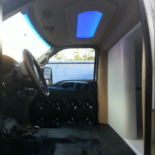

Define small boxes? I'm talking about guys with 8 15's in a 30+ cubic foot wall with a port big enough to climb into. Can't imagine too many homes with bigger boxes, or more power per sub. The rule of thumb on setups like that is to always use a symmetrical port, or get the subs aligned in such a way that they are equal distance from the port. If not, under high power when playing music, the subs closer to port unload first.

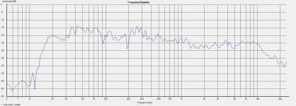

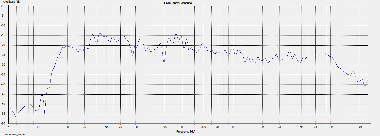

Here's a total system measurement from listening position. No EQ, 1/12 octave smoothing. PLLXO and aforementioned small amp for the sub.
Rare to see a more perfect "house" curve. Even with EQ. At least to my taste.

120 full range destroys hearing pretty fast too. I've been at some loud, very well setup shows and in some very loud cars. They are both fun albeit very different experiences. With today's gear in cars 160 plus is now considered big time numbers for playing music in a car. Pro audio mids an horns, Generally not setup very well though
