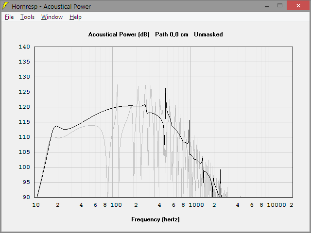

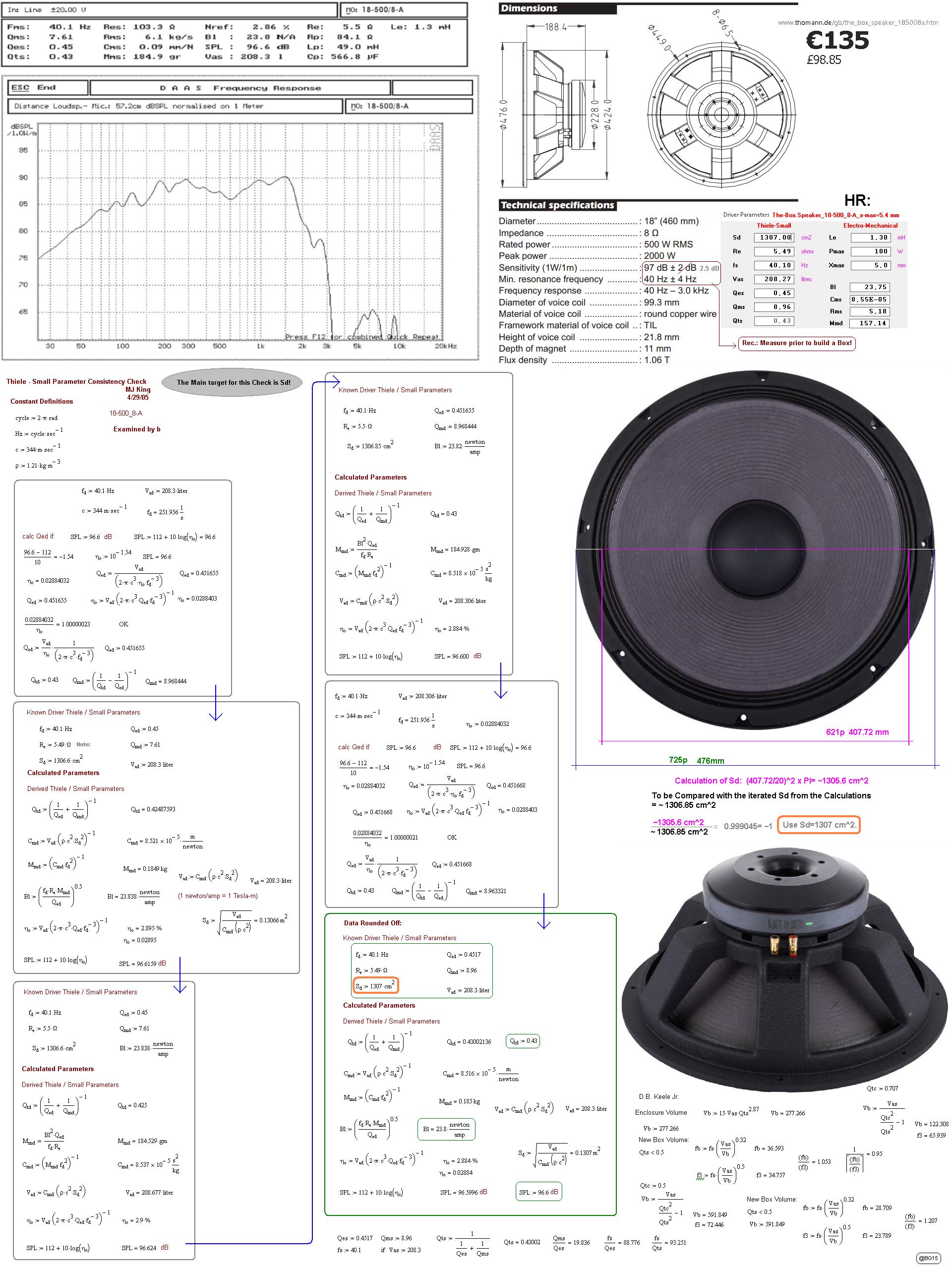

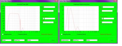

Your sim doesn't look right.
The best I can get with THE BOX SPEAKERS 18-500/8-A is -8dB's@20Hz for a BR, with an extended alignment of VB = 360.0 L, FB = 22.0 Hz.
https://images.static-thomann.de/pics/atg/atgdata/document/manual/193265_bda_185008a_uk_screen.pdf

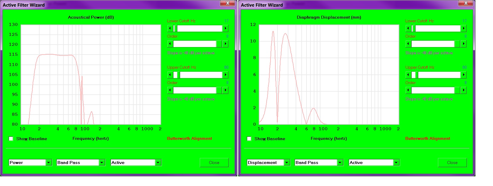

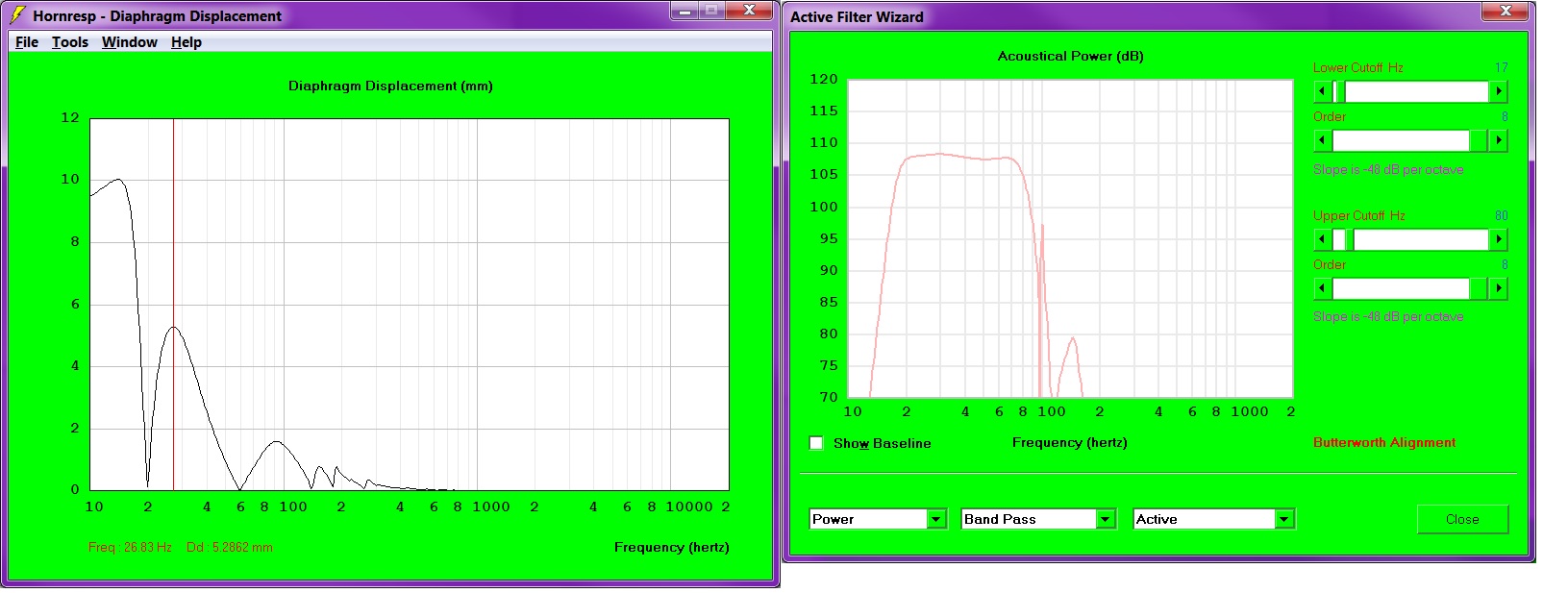

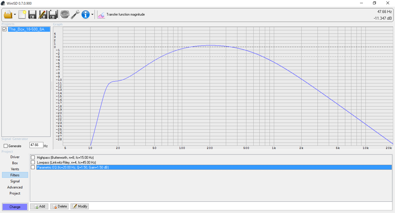

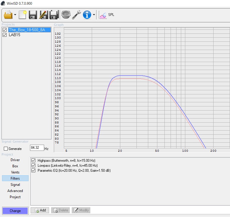

Hi Inductor,
This plot is with all the processing involved - like I said, I trade HUGE amount of efficiency/SPL for extension, EQ is necessary to flatten the response. This is also the case with modern small sealed subs.
Basically, 4th order L-R HP filter at 45 Hz flattens the response and gives F6 at around 60 Hz. Then, if room gain doesn't take care of the rest, small amount (1...1,5 dB) of boost around 20 Hz should do the trick.
Of course, one could choose a driver with heavy cone, low Fs and sensitivity and yield the same result, but these kind of drivers are expensive (e.g RSS460HO-4 - Dayton audio reference 18" Reference HO Subwoofer - Europe audio or Eminence LAB 15 - Thomann UK), need a powerful, more expensive amp and I'm on a budget here🙂
Here is the raw response (looks awful, right? But I still have 86 dB of sensitivity at 20 Hz):

Thanks, Djim - these seem to be agreeable with the data sheet downloadable from Thomann (and also supplied with the driver).

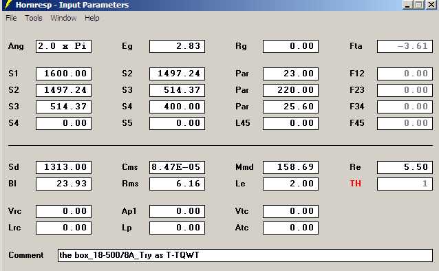

Yes, I've contemplated almost every cheap(ish) driver out there, even wacky stuff like eight 8" drivers in one box. That 12" sure is a looker (Qms 20! Nice basket, too), but I already have the 18" one.

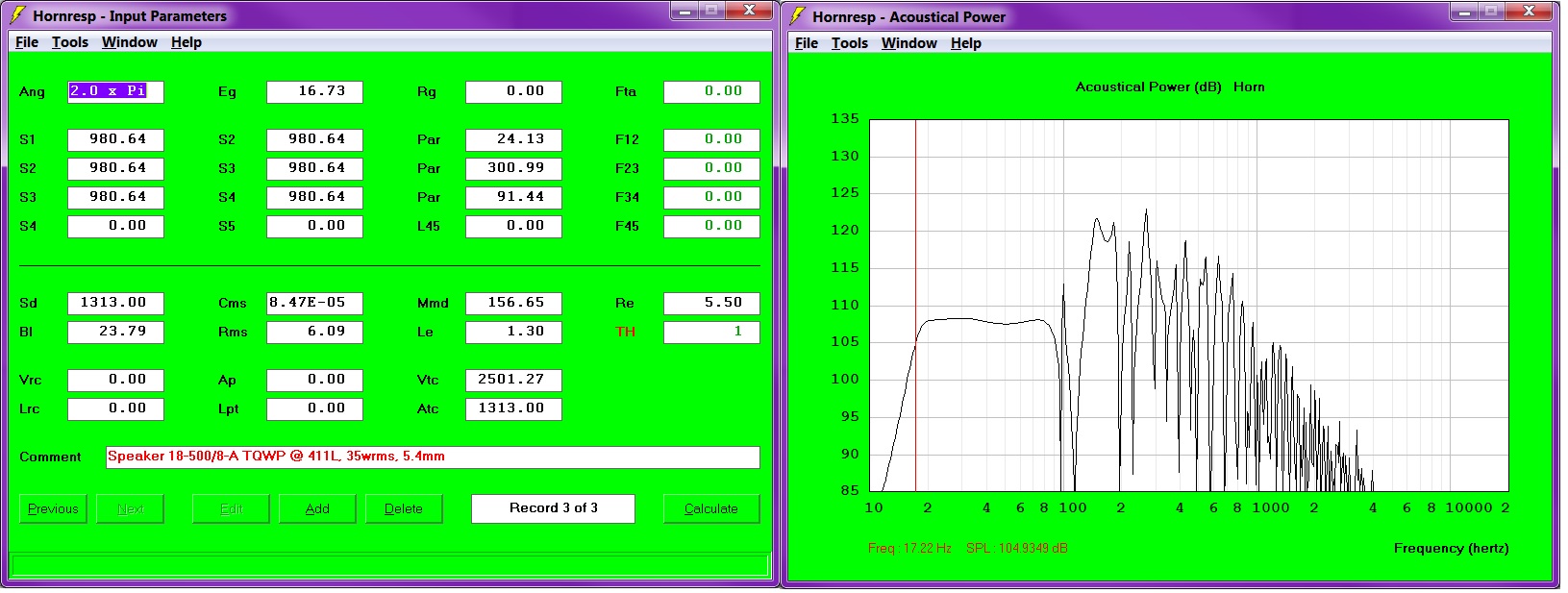

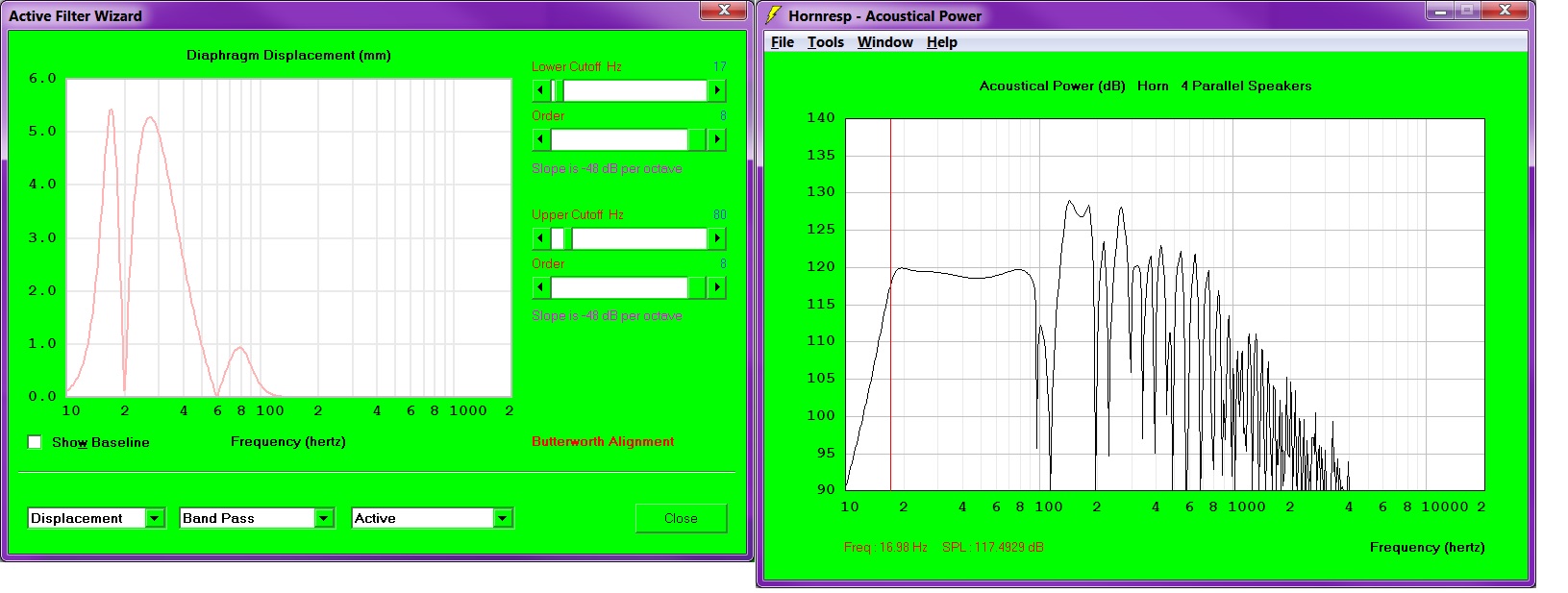

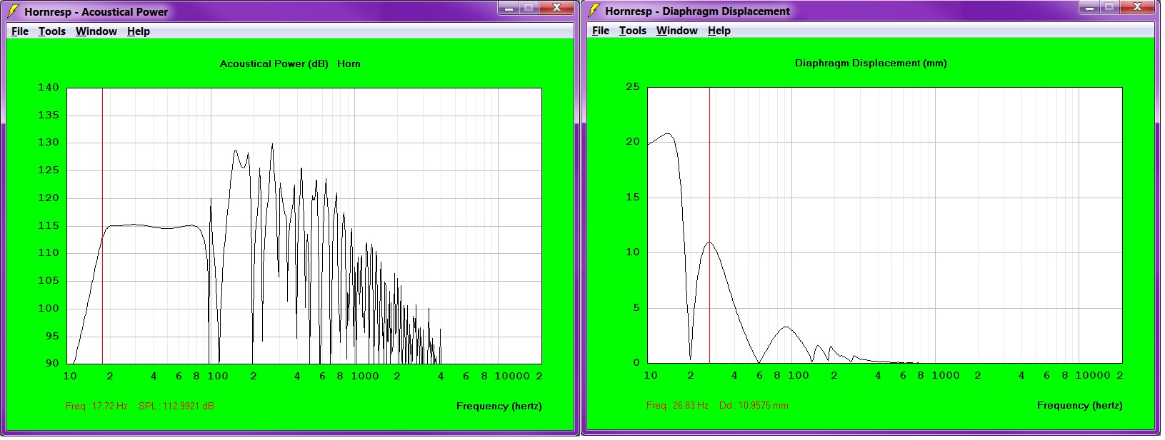

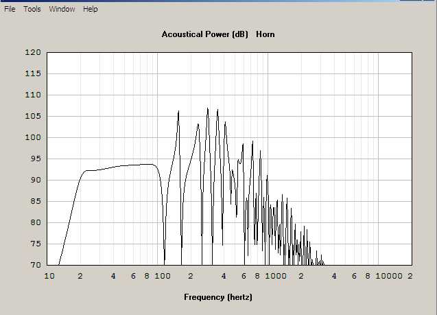

On T-TQWT note, my sanity check shows no real advantage in a similar total volume box. Funny thing, Hornresp shows around 3 dB more output for vented box at excursion limit (but Hornresp isn't be-all-end-all program. No simulator is). A tapped horn is on my bucket list, though, maybe with some 10...12" drivers. As for now I'm also running a parallel build of some 3-way speakers using Scan-speak, ACR and Seas metal cone and dome drivers, so my hands are pretty full

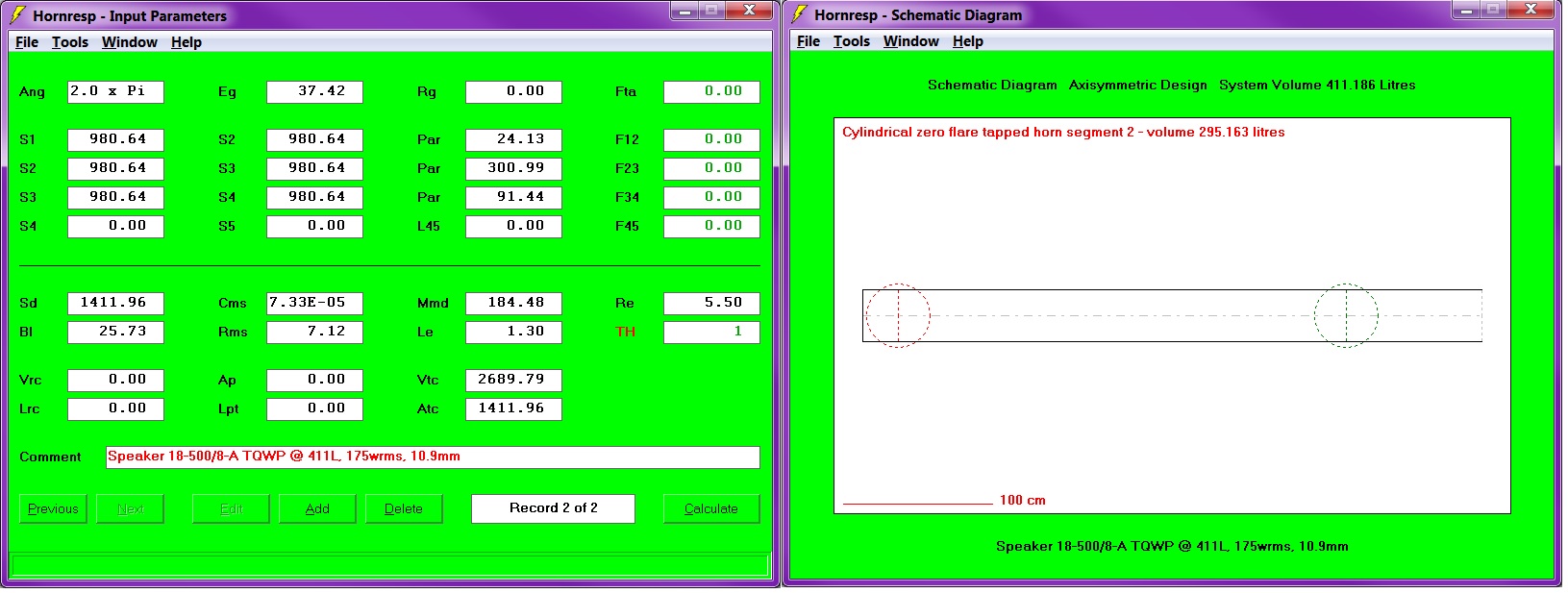

I used the cutout diameter as the Sd since I didn't see it on the data sheet. I let HR calculate the rest of the speaker parameters. This is a Tapped Quarter Wave Pipe (TQWP) or straight flare tapped horn.

A tapped pipe of approximately the same total net Vb [cab + vent] as the 360 L BR OTOH showed enough extra gain above ~40 Hz for transient bursts to warrant using it instead IF a < 80-100 Hz XO is used.

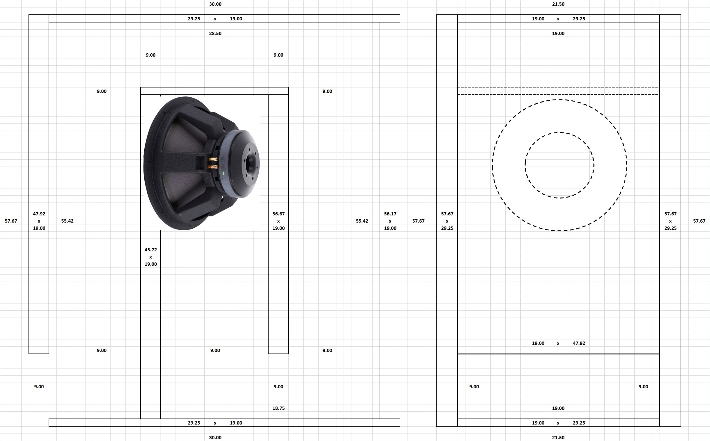

Today's progress - front panel ready and braces glued to two side panels. If all goes well I should be able to assemble tomorrow. I hope to get the amplifier (Behringer NU1000DSP) next week.
The box is 364 liters internal, 488 external, dimensions are chosen so it can fit on two 1525 x 1525 mm plywood boards with minimal waste - front and back are from one board cut in half, the rest is fitted on the other board. Ports are four 110 mm PVC pipes, 750 mm long including 90° bend.
Its not as much the total volume as depth and width - around 450 mm depth and 1500 width are maximum, I could go higher than 800 mm that is the height of my box being built. But it would be difficult to find room for a 700 x 700 x 700 mm cube that seems to be a popular format for large subwoofers.
I kind of agree, 40 Hz is a really low tone and 35 Hz is gut-wrenching low, especially for people who're used to 50...60 Hz low end extension of cheap micro systems and home-theater-in-a-box. Plenty of people have asked me to play "that one song which has really awesome bass for subwoofer" and I'm "meh, it's just open E on bass guitar, really". But then there are songs that go 30 Hz and below, and that can be exhilarating.
