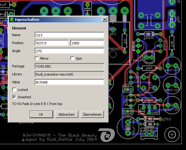

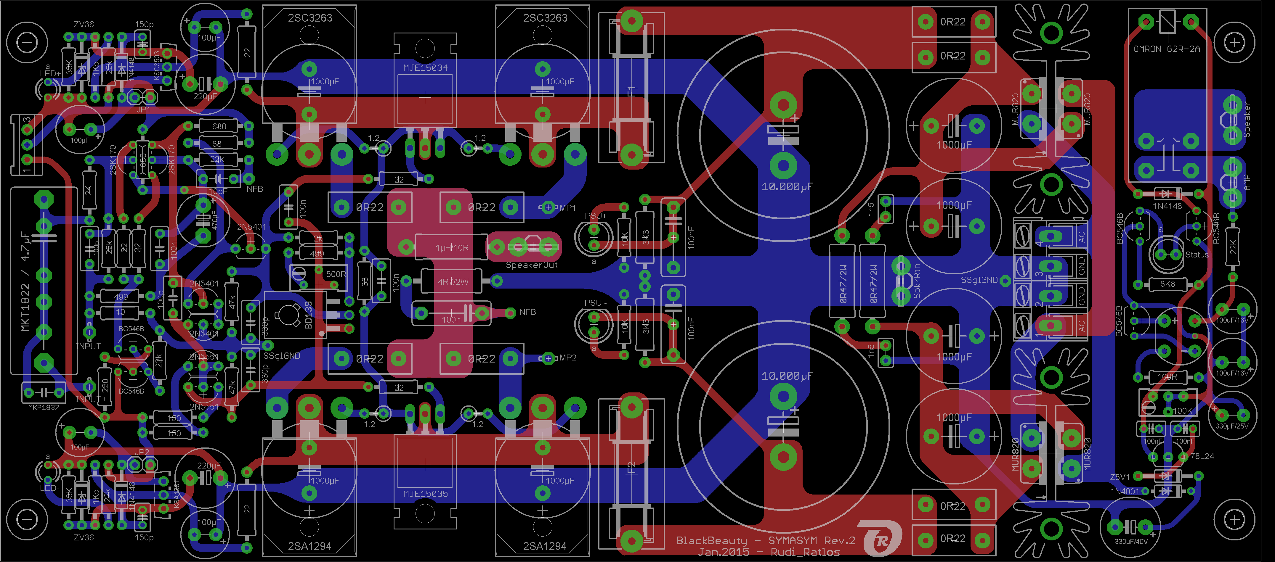

Jean-Pierre reported on an error in my BlackBeauty - SYMASYM Layout.
My EAGLE software shows a pinout of EBC for the two BC546B transistors, which are used in the speaker-protection.
In reality these transistors are CBE - types.
Please flip these 2 transistors by 180°.
Best regards - Rudi

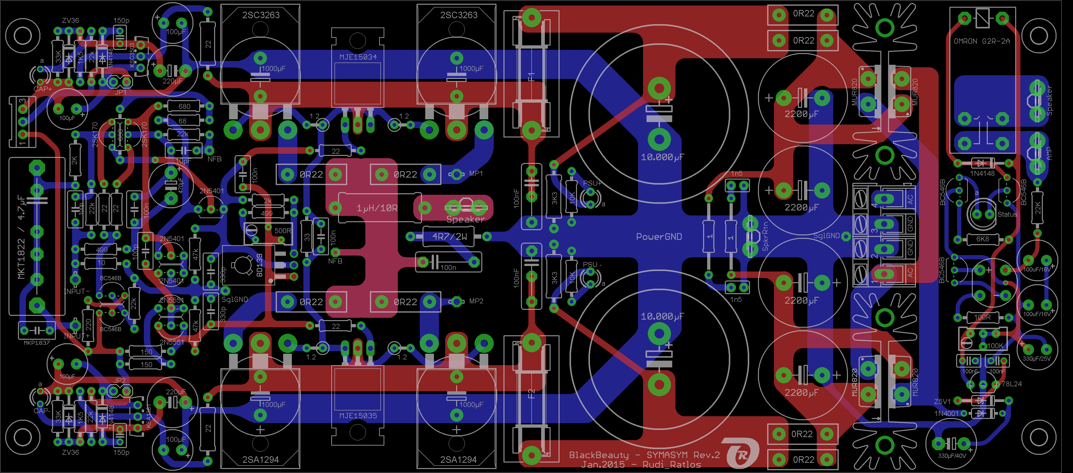

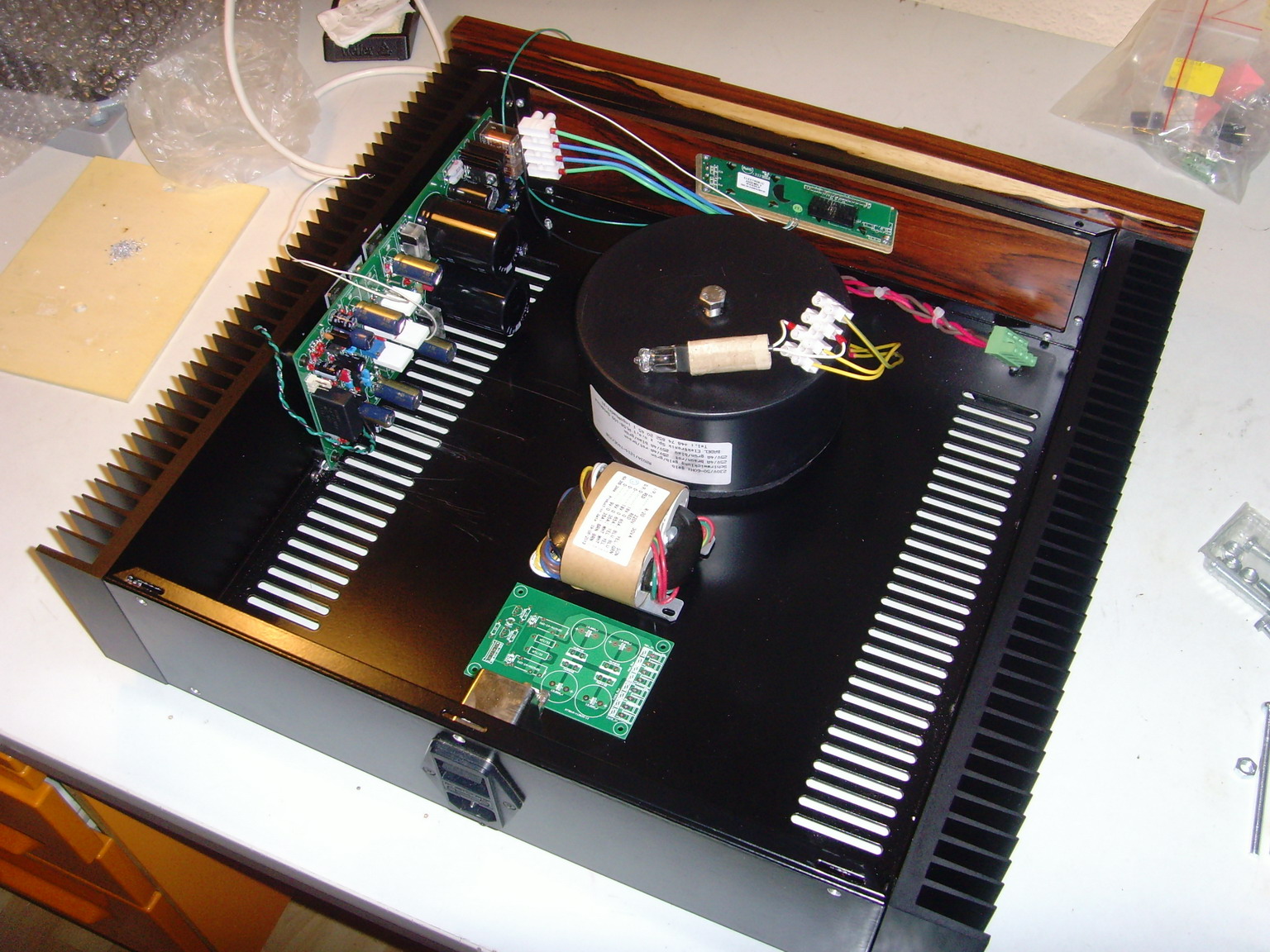

Gentlemen, from time to time I am asked, if I have any of my SYMASYM - PCBs left.
No - I do not have, I am sorry, they have all been sold, but ...
I have layouted a Rev.2 of the "BlackBeauty - SYMASYM" (see image 2) and together with 2 of my German DIY-friends I have populated the prototype - PCBs.
They work - of course, why not!
You can either use TO3-P or TO-264 transistor-pairs - as you like.
The size of the Rev.2 - PCB is 211 x 94mm.
So it fits perfectly into my DIY-carpenter Gerhard' s wooden case (which uses 100mm long heatsinks - see image 1).

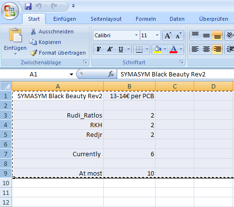

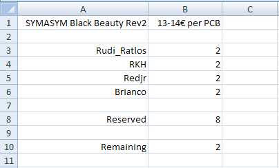

Started a Group Buy Yet?
Rudi,
Have you started a group buy for the Black Beauty PCBs? Where do I sign up? I'd be interested in 2 PCBs and the BOM - hopefully for Mouser. 🙂 How much for 2 PCBs USD. Your plans for 2015 look very interesting. Maybe by the time I get done with the VCPre, I'll be ready to tackle the Multi-Media Amp. Great stuff!
BTW, will these relays work in the VCPre?
PS. I mean Rev 2 of the SYSASM. 🙂
-Rick
Rick, Ryan,
I will order 10 PCBs of the one shown in the image below on this weekend.
This is where my SYMASYM-journey has come to an end.
I have the feeling that I can't do it better.
As my old friend EVETTE told me: You are really coming into your own now.
I will not offer any SYMASYM-PCBs in the future anymore but will concentrate myself on an "Amplifier's Surrounding".
For example: a LDR-based attenuation is the best that I have ever listened to.
But even this one can be (theoretically only?) improved by a digitally controlled potentiometer (based upon MCP4151) being followed by a VCCS.
I have been an IBM - software-engineer for more than 35 years of my life.
So I will go on with this SYMASYM, a digitally controlled attenuation and RASPBERRY PI B+ INTERNET / WLAN connectivity and DAC for music-streaming and will exhaust my digital brain.
You are happlily invited to follow my digital intentions.
Best regards - Rudi

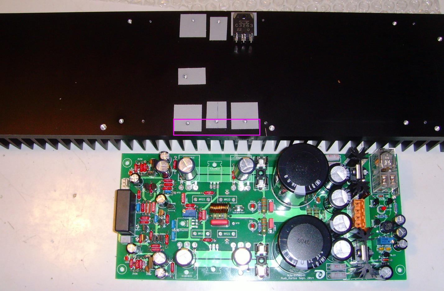

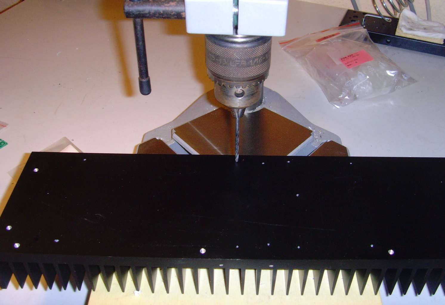

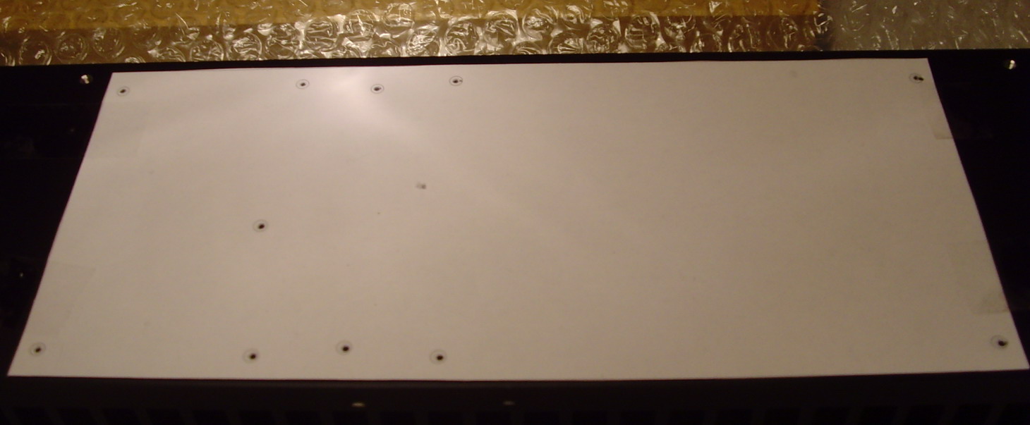

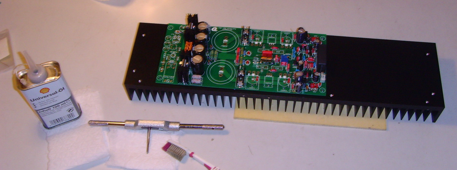

I have just started drilling (with a 2.5mm drill) and tapping the needed holes (with a 3mm tap) for the SYMASYM BB-Rev.2 left channel a minute ago.
Best regards - Rudi_Ratlos
