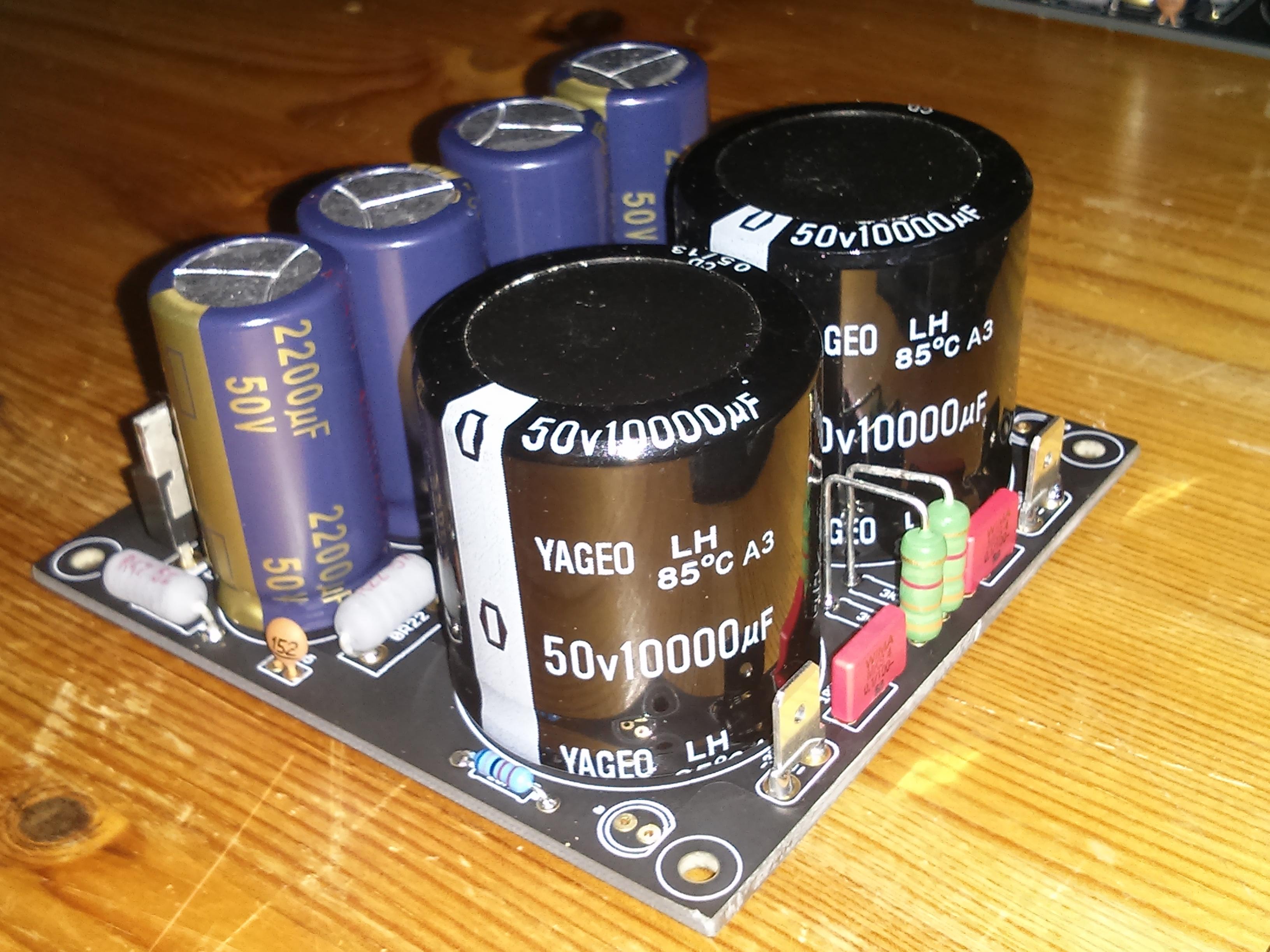

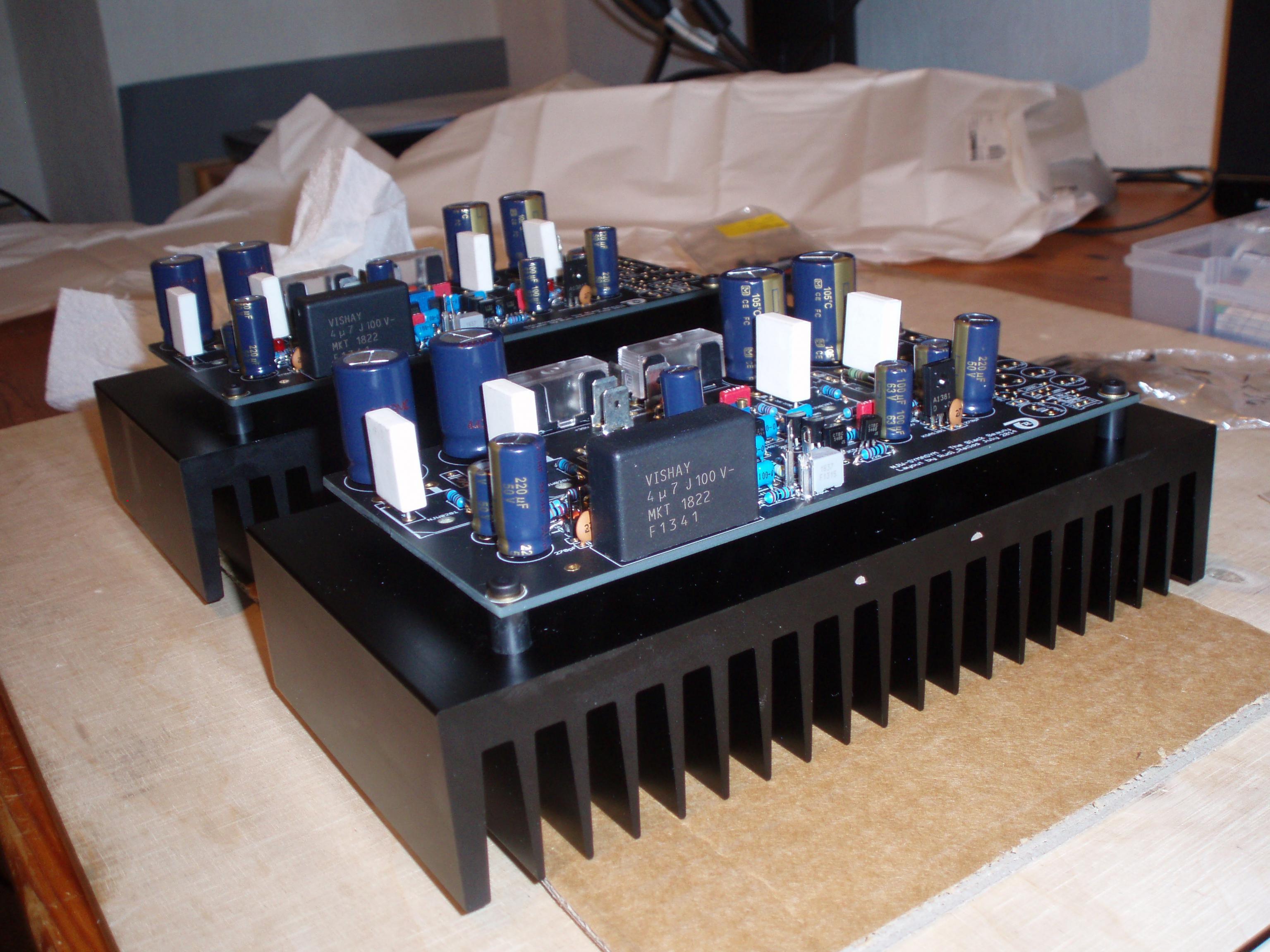

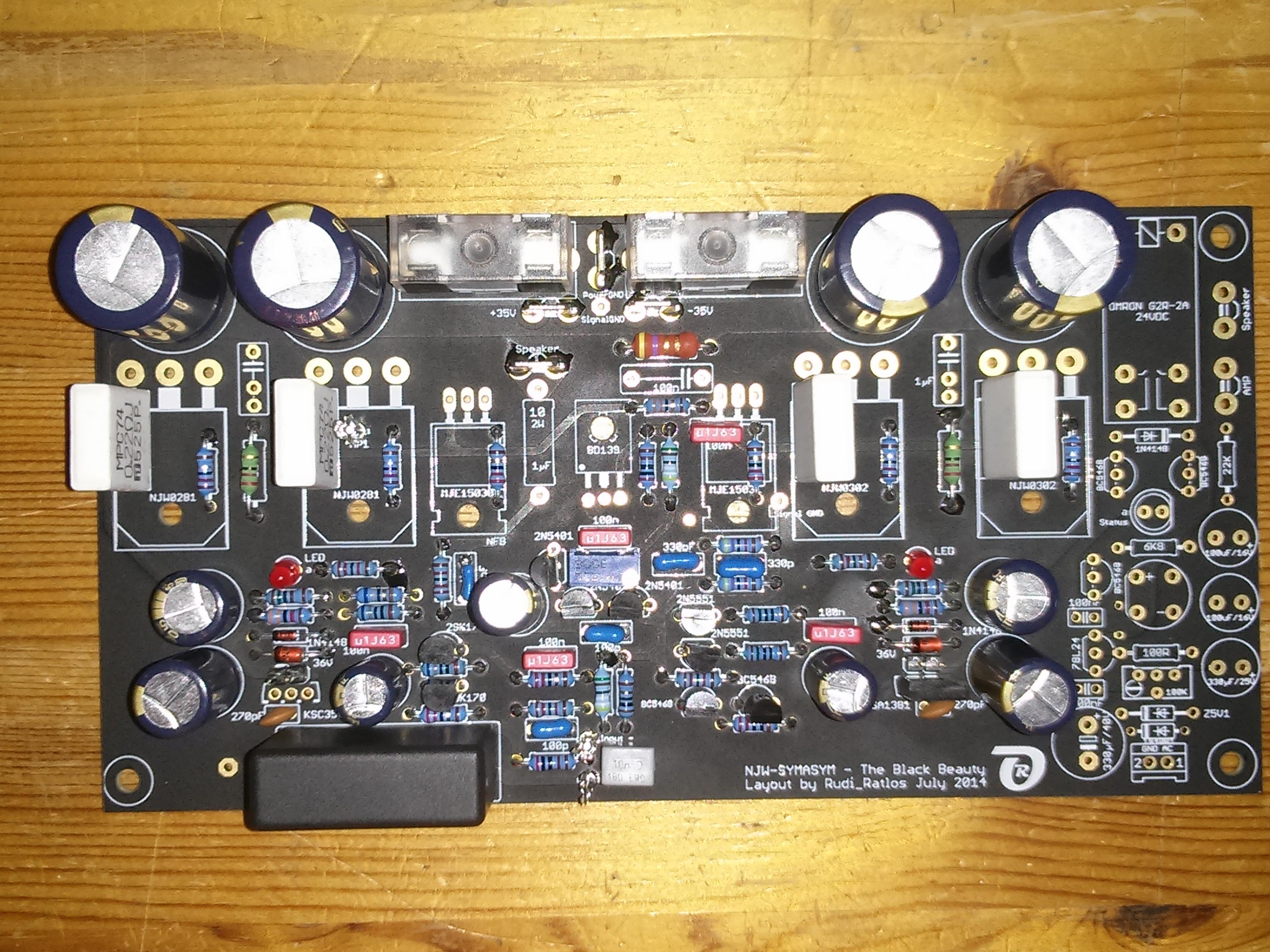

Hello Rudi,
First images of the black beauties, I have to wait for the heat sinks, and some missing parts.
Reaching this state for one set of boards, 2 x PSU back-end and 2 x NJW Symasym boards took me about 6 hours.
It is again a real pleasure to stuff these boards, thanks again Rudi to make these available.
Grtz
Bert

Bert: your build looks good! Do not forget to solder a wire between the PAD labelled SignalGND (this is the "Small-Signal-GND" of the Frontend) near the MJE15031-driver and its counterpart near the Power-GND connector.
Capacitors C18 and C19 are not mandatory (especially not, if you use the onboard CAP-multiplier - which I really recommend to use!).
Either take a X7R-2,5 100N from Reichelt or a 1µF MKT.
Take care, when you insert the output-transistors, the drivers and the TEMPCO BD139!
Drill the holes into the heatsink and tap them; cover the holes with silicone insulating foil, bend the 7 transistors' legs accordingly and insert them from beneath the PCB.
Fix the transistors slightly with metal screws and use your distance sleeves to obtain the correct height of the PCB. Then fix the transistors tightly.
Measure the resistance all of the 7 transistor's legs with respect to the heatsink. There may not be any resistance!
Then fix the transistors with some solder-points on the PCB's component-side, unscrew them all and solder them from the PCB's solder-side.
Maybe that I am repeating myself.
I myself - when I built the prototype - have not done it as written before, and the result has been a very small, nearly unvisible gap between the drivers and the BD139 and the heatsink.
I have had a lot of problems thereafter during the quiescent-current adjustment phase (thermal runaway problems!), until I finally saw my problem.
So: do it slowly!

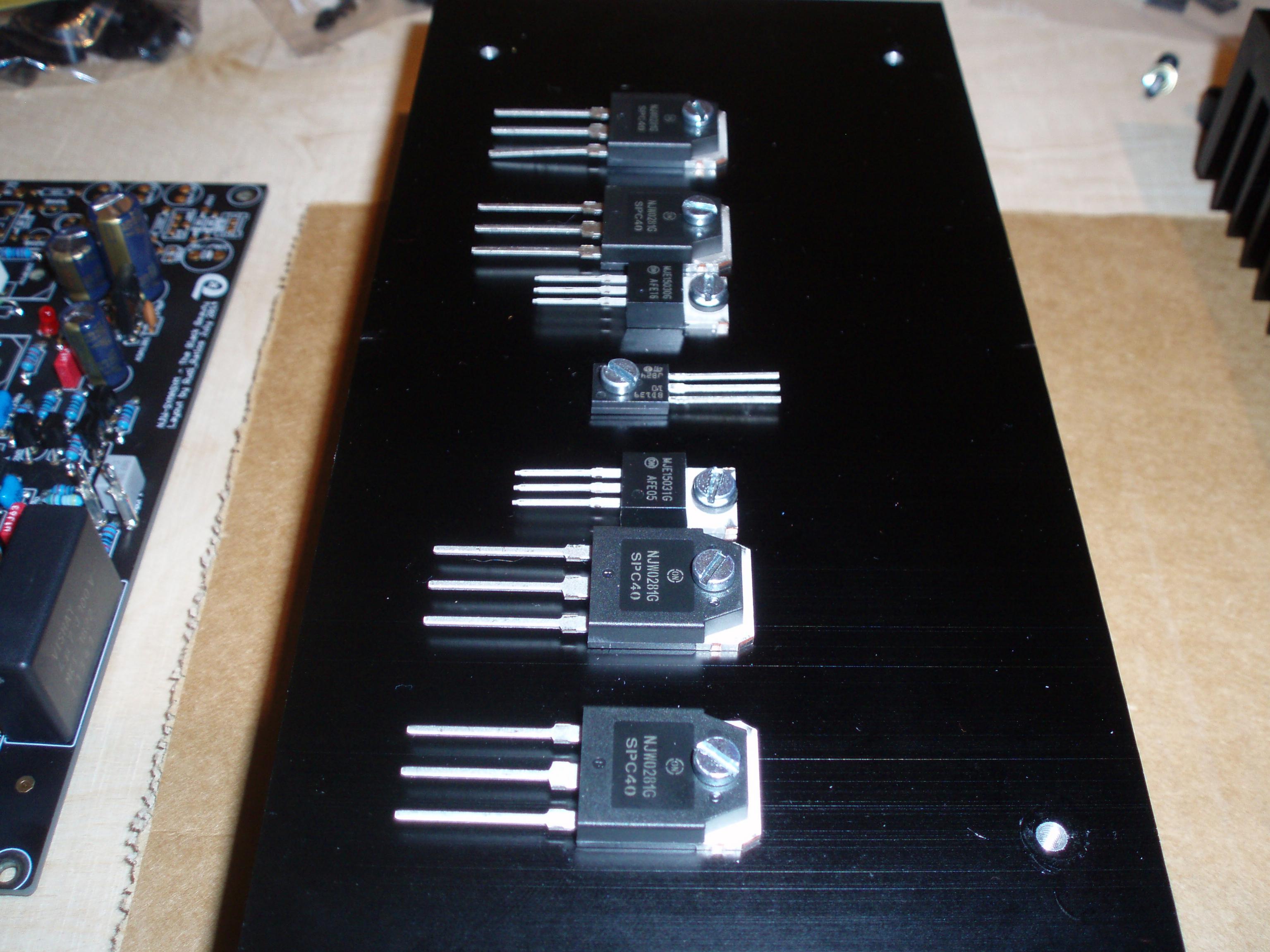

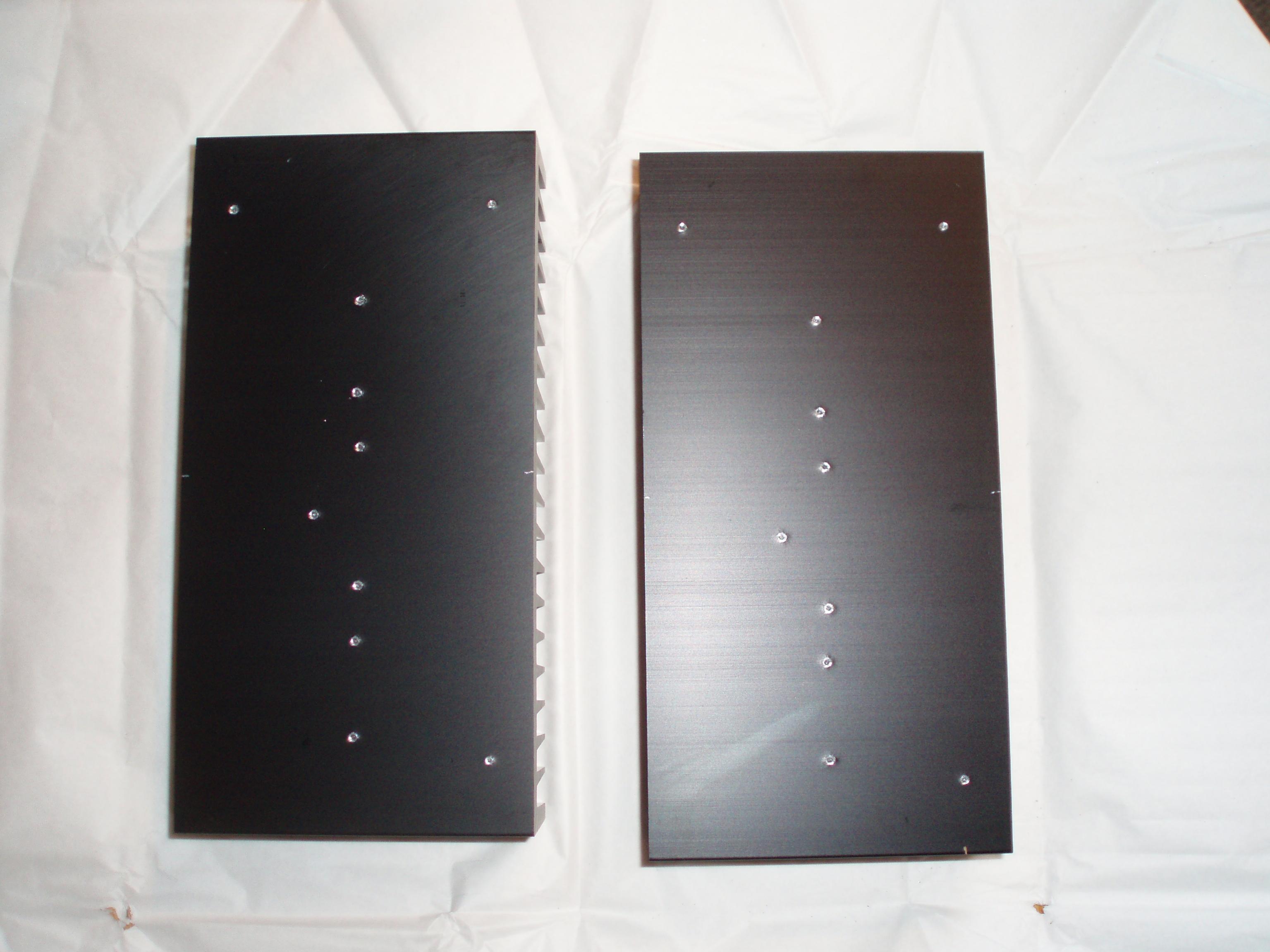

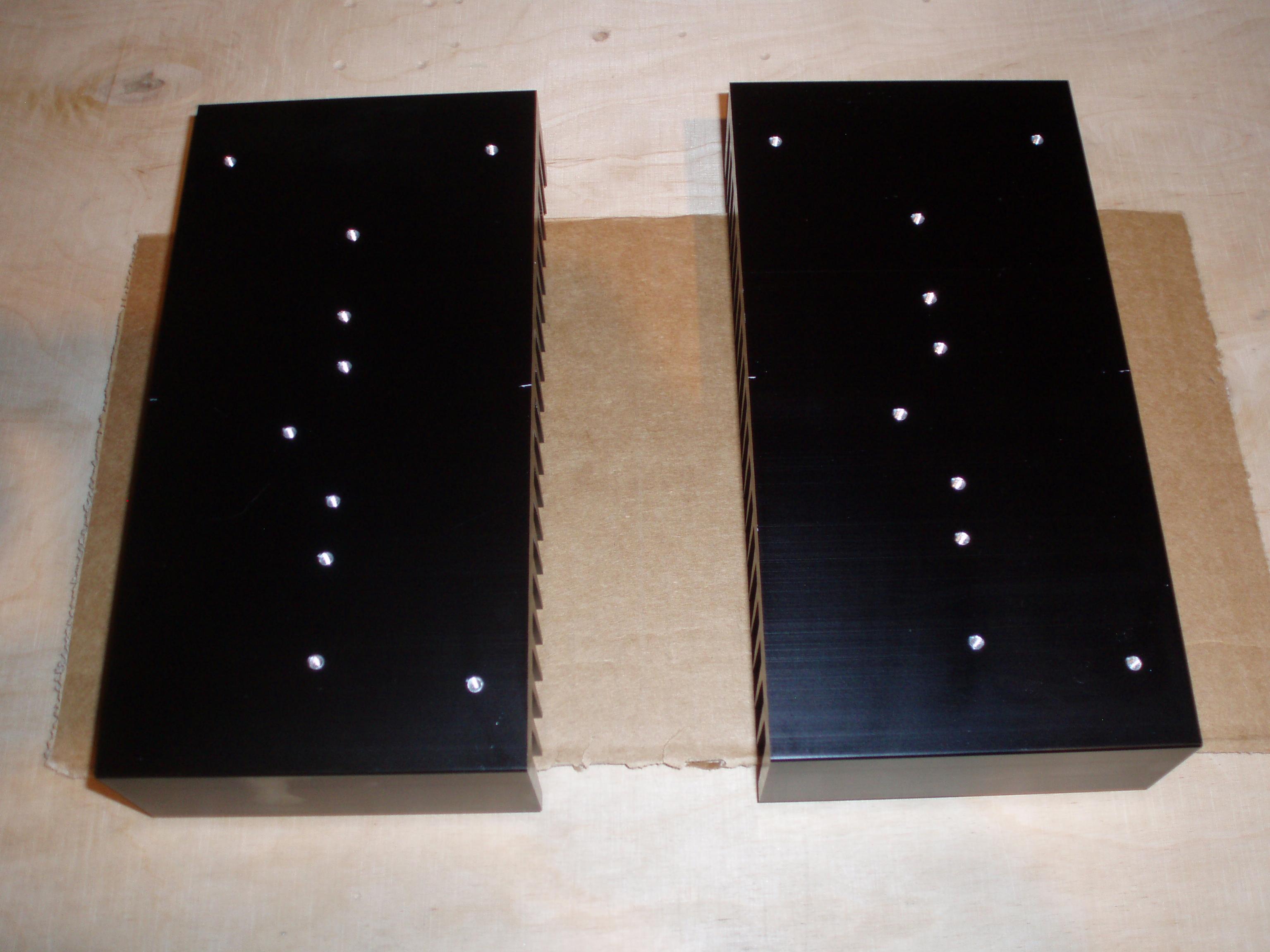

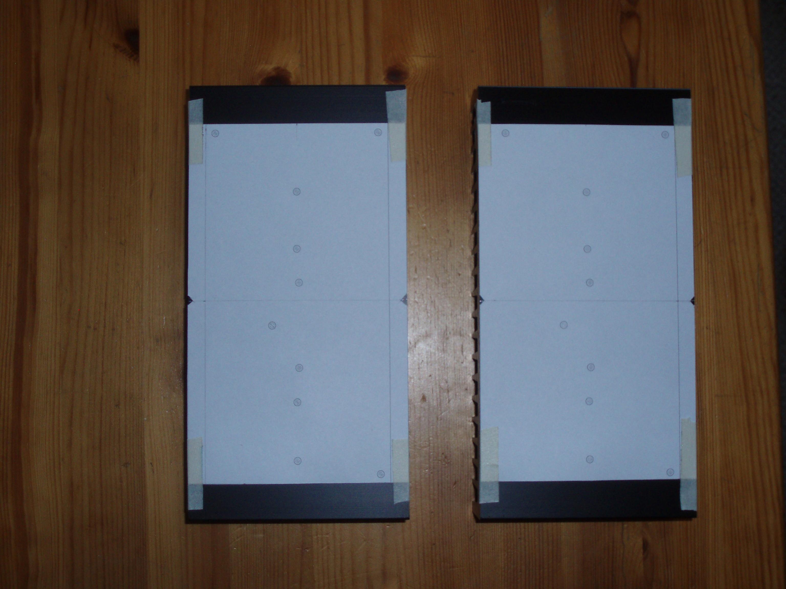

Drilling and tapping day
Hi, today was drilling and tapping day.
about 4,5 hours to reach the state shown in the pictures.
1, drill template.
2, punched.
3, drilled and tapped.
4, PCB mounted, no transistors.
5, transistors mounted.
On the last picture the 15030/15031 might be reversed, I will need to check this tomorrow.
Yes I know, there is no insolation foil between the transistors and the heat sinks, that will be done on the final mount.
Also some zoomers might notice that not all transistors have the insulation washers installed, will also be done on final mount.
In this state, I did want to check if it all fits, yes it does, however be aware to use flathead screws to mount the transistors, using allen / inbus (GER) screws does not work, these are too high.
Thanks for the drill template Rudi, this little pease of paper saves a lot of time.
When time permits, tomorrow could be the first listening test
Grtz
Bert

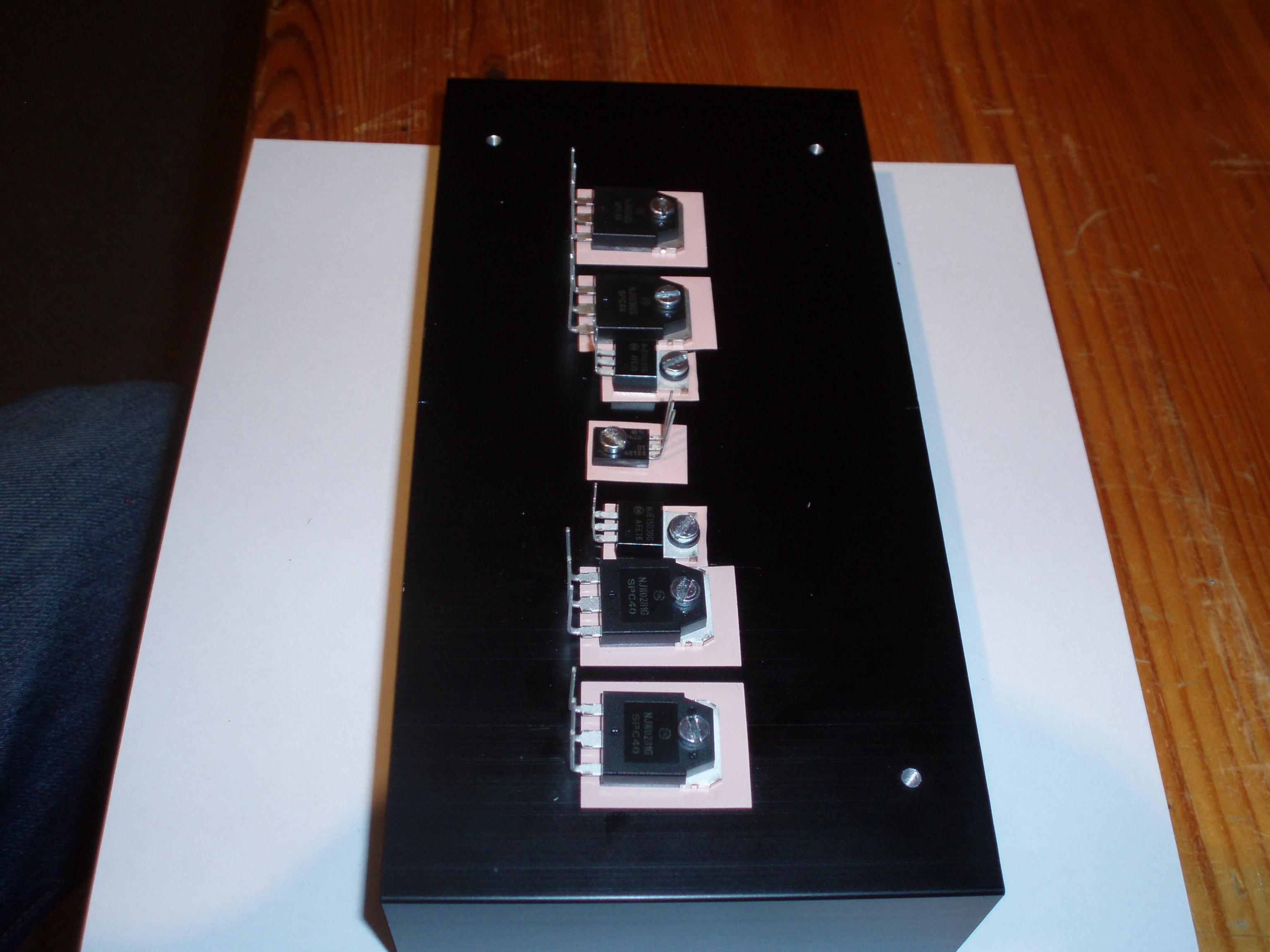

No sound today
I just found out (too late for one channel), by re-checking the transistor positions on the heat sink, that I messed up the positions of the NJW transistors, for one channel. (I did not pay attention to how Rudi packed the matched transistors, ( I do have two sets, my mistake ))
I was all discovered before putting power on anything, so no harm done.
But it means I have to desolder the transistors for one channel, and that will take some time.
Mounting the board on the transistors is very doable, it did remember me of playing the micado game as Rudi wrote before, be patient.
Please ignore the last picture in my previous post, that one is completely wrong.
Grtz
Bert

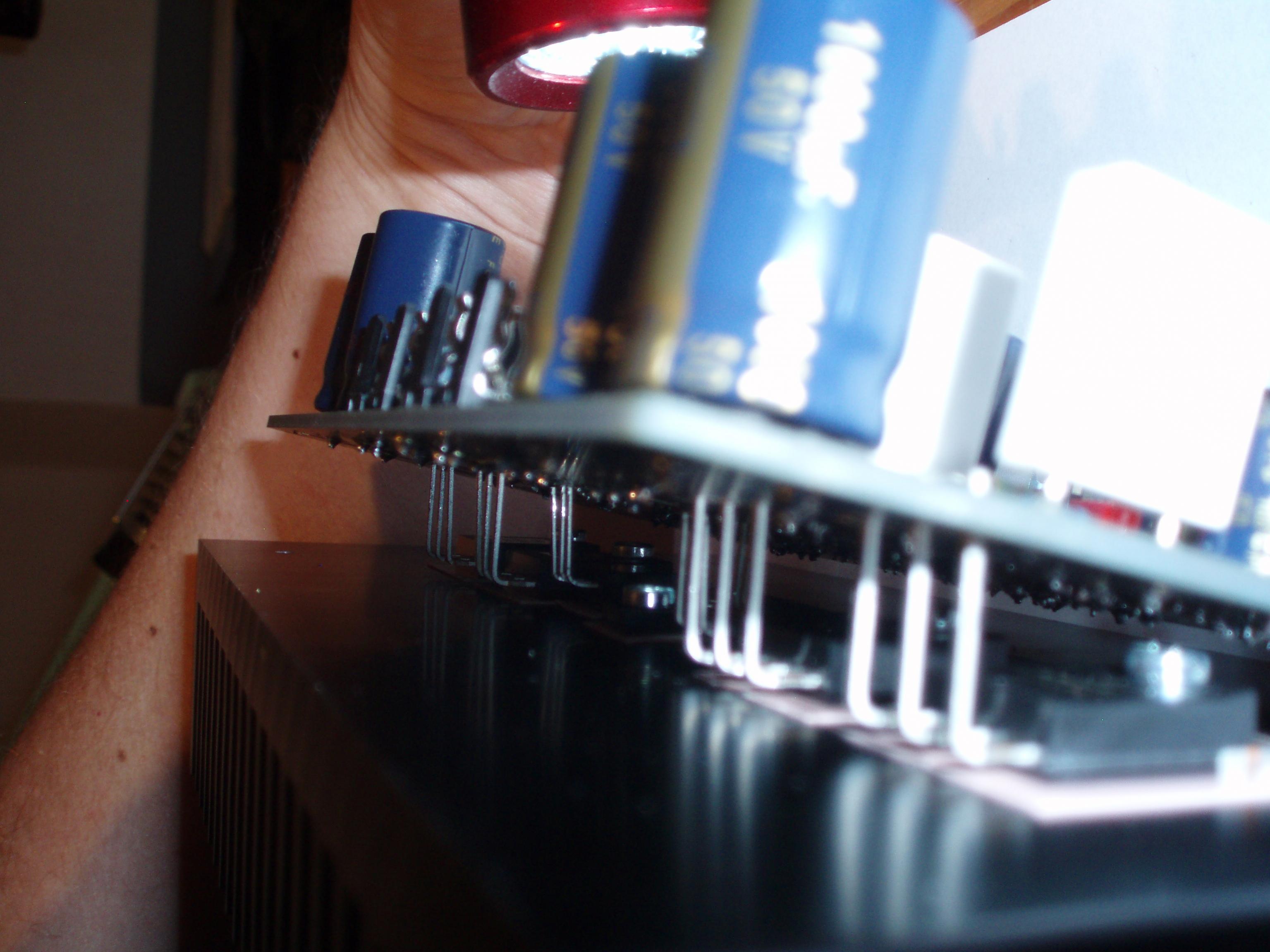

some micado tricks
Hello again,
De soldering was not possible, so I had to butcher (cut off the leads) the transistors, after that, with a desoldering pump and some desoldering wick, the PCB was clean to start mounting the second set of transistors.
To build the second set I have to wait until the NJW become available again, first quarter 2015 according to Mouser.
From the pictures you can see I have used kerafoil, to insulate the transistors from the heat sink.
Two little trick's to make mounting the PCB on the transistors easy:
1. Place the heat sink on the side with the legs of the BD139 nearest to the work surface, start by placing the PCB on the BD139 transistor legs first, then place the PCB over the NJW transistor legs.
2. Get your self a LED pocket torch (taschenlampe (GER)), and illuminate the PCB from the component side near the holes of the MJE transistors, the light will shine through the holes of the MJE transistors, and will make positioning the legs a peace of cake.
I tried to illustrate this with the third picture.
No sound today, after yesterday setback I became a little more careful, and I will wire up next weekend.
happy buliding
Bert
