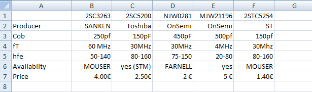

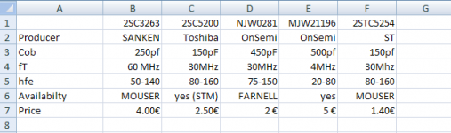

The devices in columns B, C & D are much closer in parameters when you look at the datasheet plots.
The Sanken is NOT twice as fast as the Tosh/Onsemi.
It might be 10% faster if the plots are true representations of typical devices.

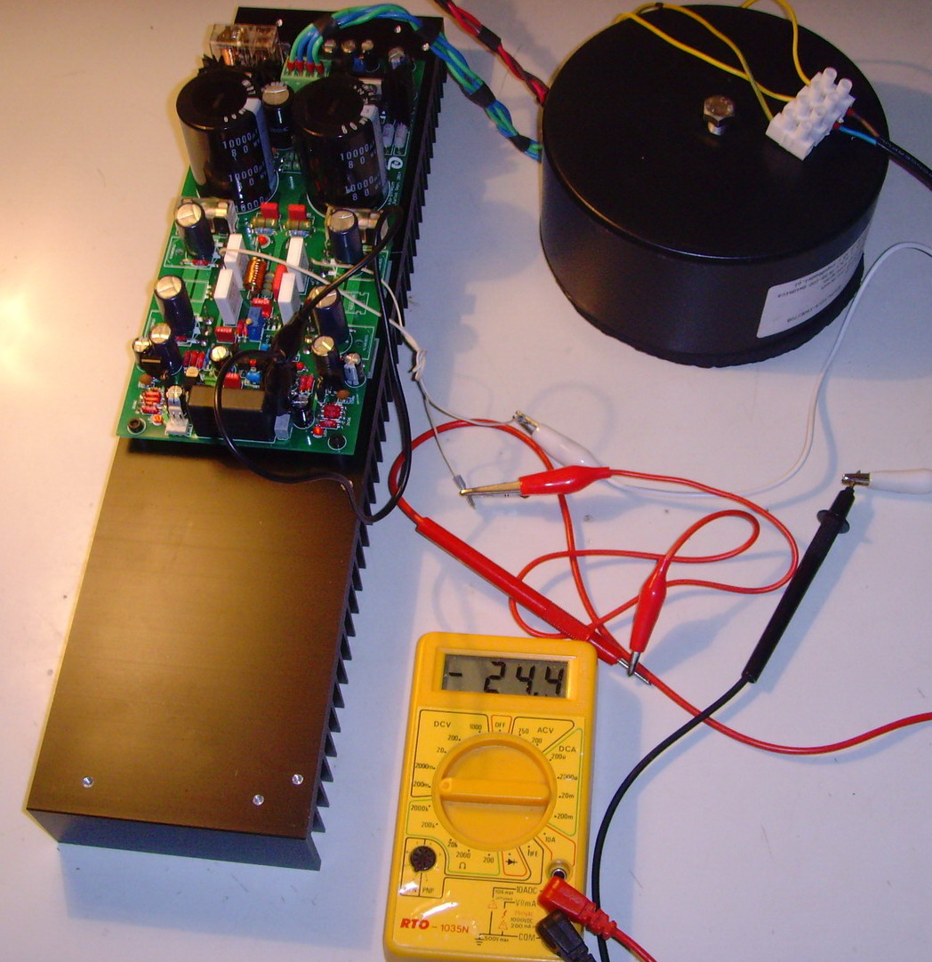

Today is a sad day. I have just ruined my newly built SYMASYM.
I have adjusted it (see my post #1082), connected it to a "substitute - speaker (6R8 at 50W)", looked at its output (sine- and square-wave) on my oscilloscope, found no oscillation, listened to it
(the small TO3-P Sanken sound beautifully), and then turned the music louder.
By some reason or other (maybe I have been distracted) I have only inserted 1.3A fuses into the PCBs' fuse-holders (allthough my transformer is able to provide 4A per secondary).
After some time of playing loud music 2 little clouds of white smoke appeared, then a short bang.
I found out that both fuses have blown.
I am currently not able to re-animate the SYMASYM.

I started trouble-shooting my blown SYMASYM today.
The 1st thing I did: I cut through the collector legs of the 4 output-transistors, fitted the light bulb and powered on.
Result: the backend- and frontend - PSU-leds are shining again 😀 and there is only very, very little current flowing (the light bulb kept unlit).
Next thing I will try is to play a test-signal and measure the driver's bases and emitters.
Best regards - Rudi_Ratlos

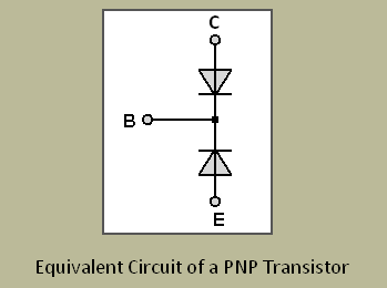

Dear SYMASYM - friends,
regarding my post #1093:
It would have been better to cut through the legs of the Emitter and the Base of each output-transistor to do some sincere transistor measurements.
Please keep in mind the equivalent of a PNP - transistor (for example - see attached image)
Use the diode-test function of your DMM to measure the voltage-drop across the "transistor's diodes" and use the resistance scale (>20K) to measure the leakage current.
But even with my "quick and dirty" procedure as described in post #1093 I found out that one of the two 2SA1294 Sanken PNP-transistors has blown.
I skipped trouble-shooting step #2 (testing the frontend), re-soldered the collector-legs of the other 3 transistors and powered on again.
I am now able again to adjust the quiescent current! 😀
I was lucky things didn't turn out worse, and I am confident to get my SYMASYM playing again.

just lift one end of the base stopper. far cheaper to replace than a damaged transistor.
I suspect sustained oscillation took out the transistor.
Find and cure the oscillation and ripple/overshoot on a sqw.
Then you can go back to testing into reactive loads and then you can connect a speaker.

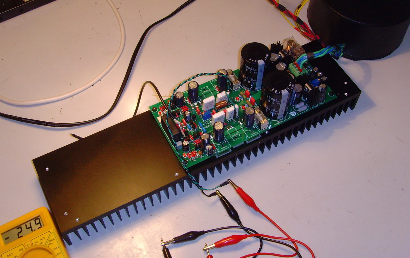

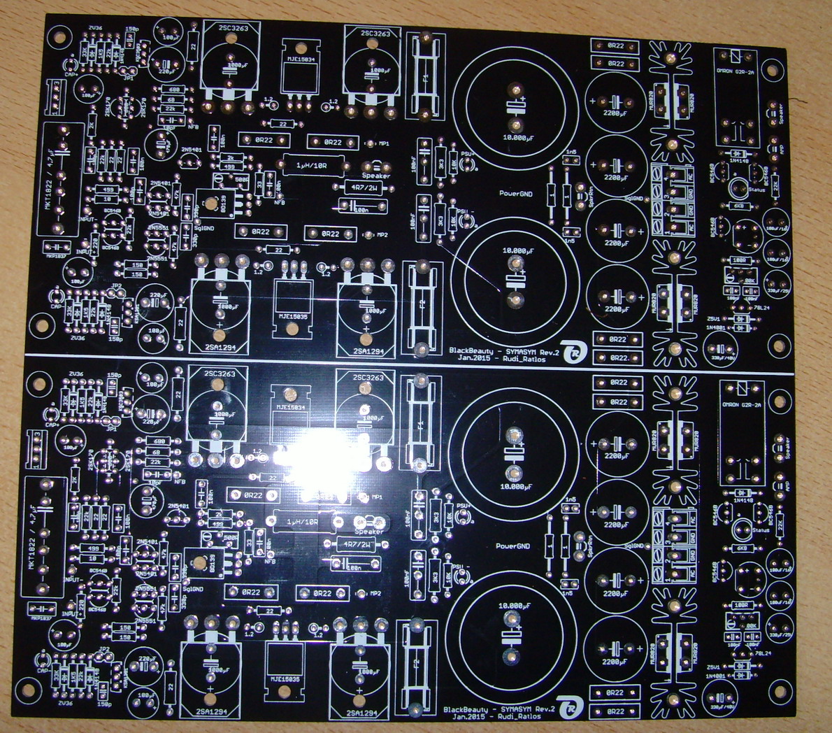

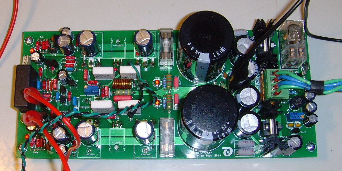

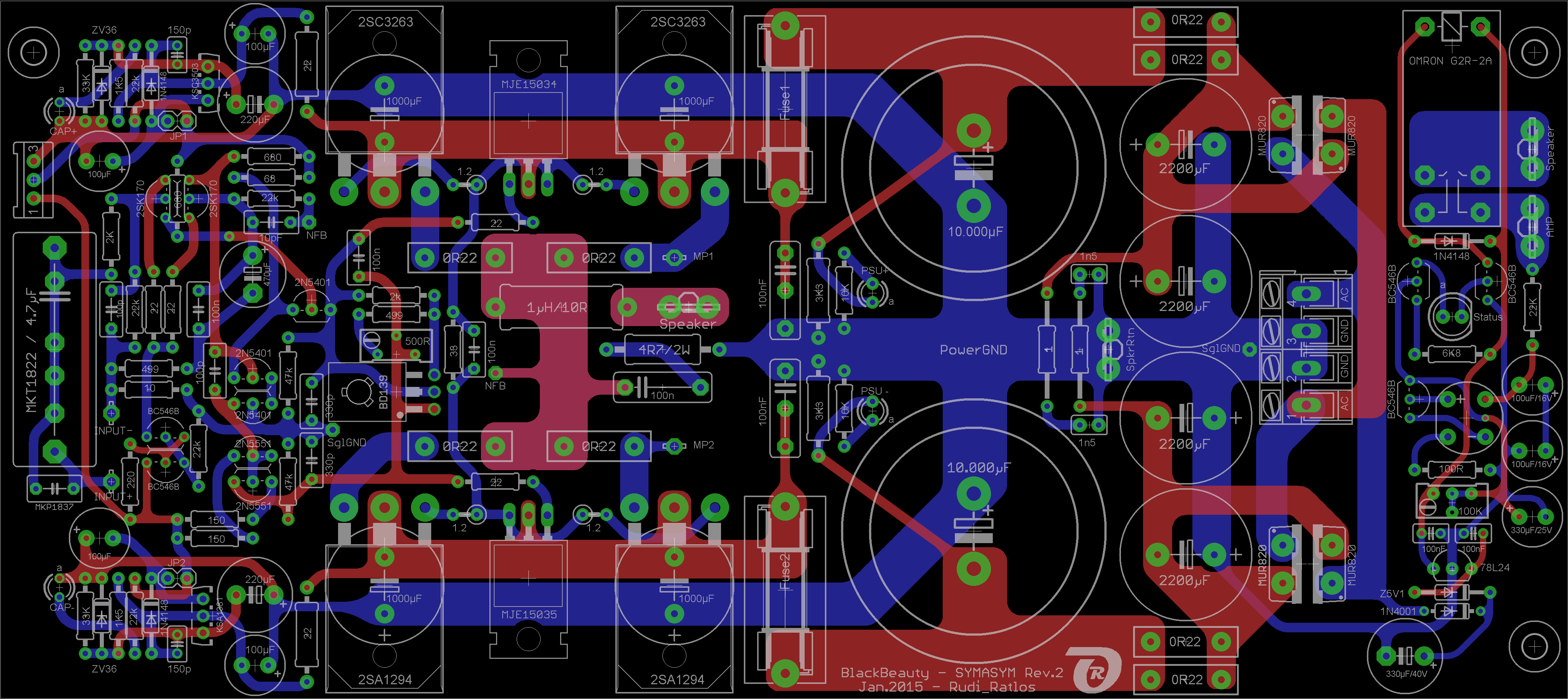

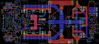

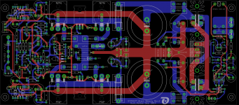

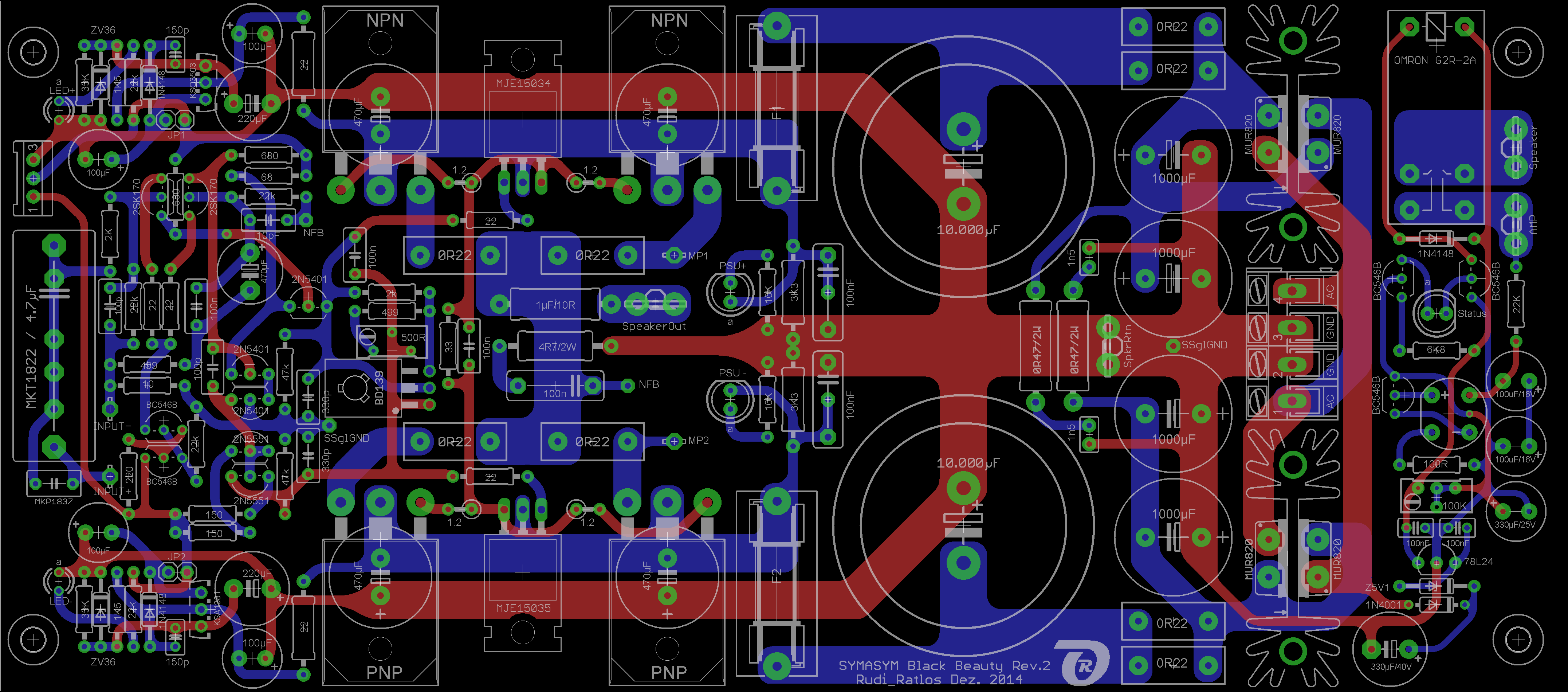

Gentlemen, I have received a couple of requests for my current SYMASYM_BlackBeauty_Rev.2 - PCBs in the past, have ordered the PCBs and received them today (image 1).
I will now ask my German DIY-friend Peter to cut them.
The PCBs' color is black, and the PCBs' quality is very, very good.
I have reservations for 10 of these lovely PCBs (its layout is shown in image 2), and I have 10 spare PCBs.
The PCB's size is 211x94mm, and it will fit on a 100mm long heatsink (image 3).
I won't offer any "hard-to-get - components" (for example: matched input differential pair of transistors (2SK170), matched output-transistors, ...) except for the MPC74 - 0R22 Emitter resistors - if you like to have.

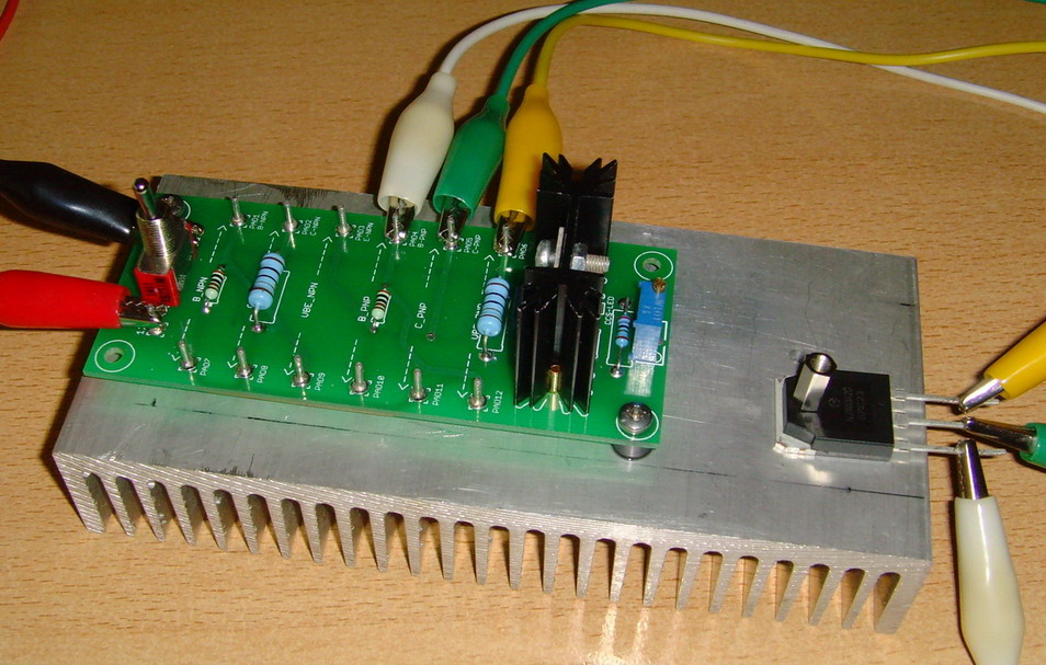

But: I will add a small PCB to match BJT-output - transistors (image 4).
As output-transistors you can use: any ONS TO3-P (f.e. NJW0...) , TO264 (NJW4...), small SANKEN (2SC3263, 2SA1294), ...- I won't recommend to use the TOSHIBA - transistors, .... (have a look at ANDREW.T's posts!).
If you are interested in having a pair of these beautiful SYMASYM - PCBs (including the Builder's Guide, MOUSER BoM, Drill Template, ...):
A pair of these PCBs including the BJT - matching PCB will cost you 29€ (worldwide shipping incl.)
