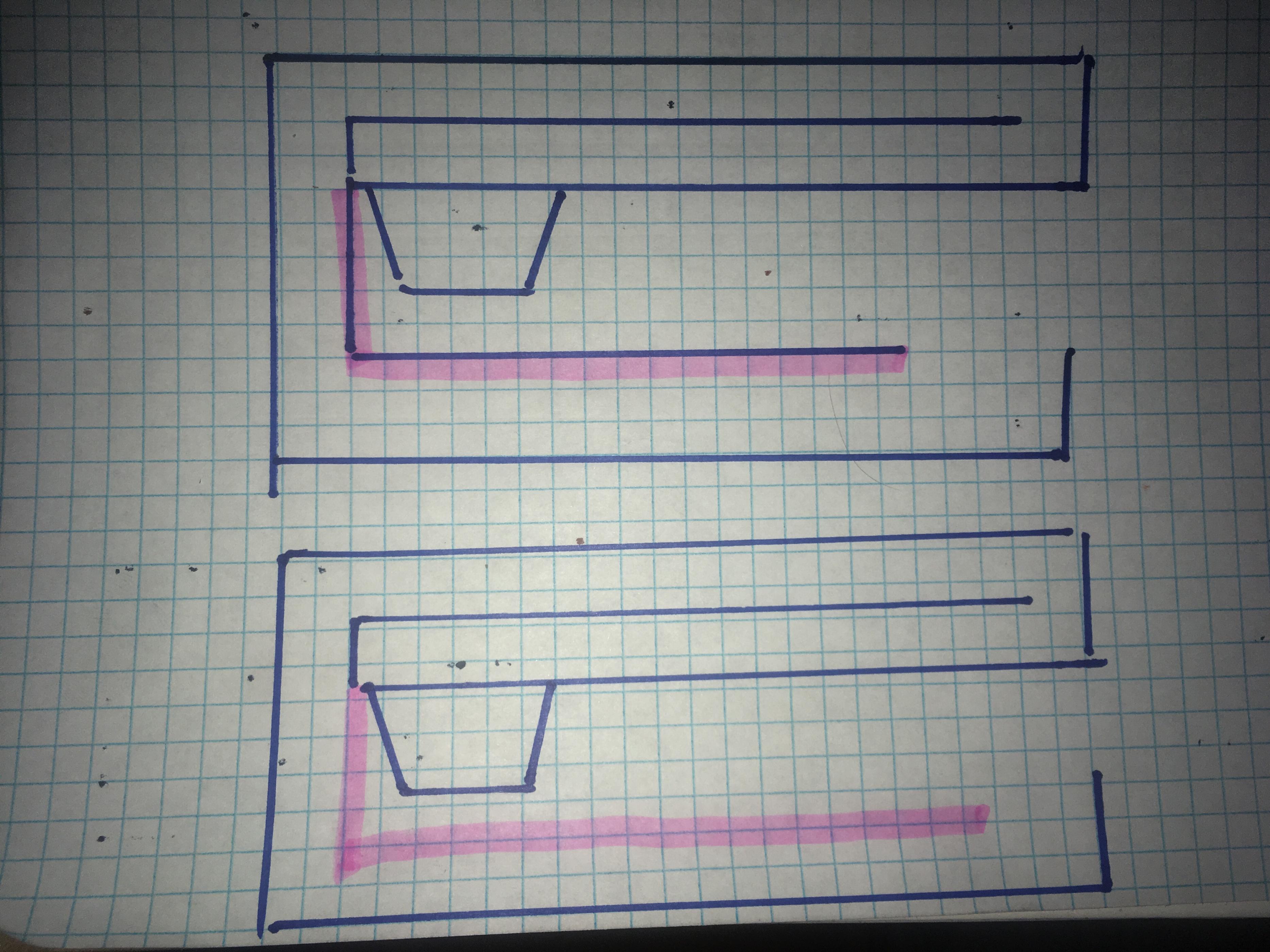

Good sketch to show the principle difference (or similarity of you like) in an easy to understand way between the approaches, there are of course other important differences but that is in the details (lengths and area relations, driver orientation etc.)
Main thing is where the summation occurs, and what happens after that consider also the wave shaping properties (for lack of a better word) that is granted by a driver oriented symmetrically in the same direction as a resonator, I believe there is alot of interesting things going on to shape the end result, most of which are more or less hidden by the relative simplicity of the layouts the selves.

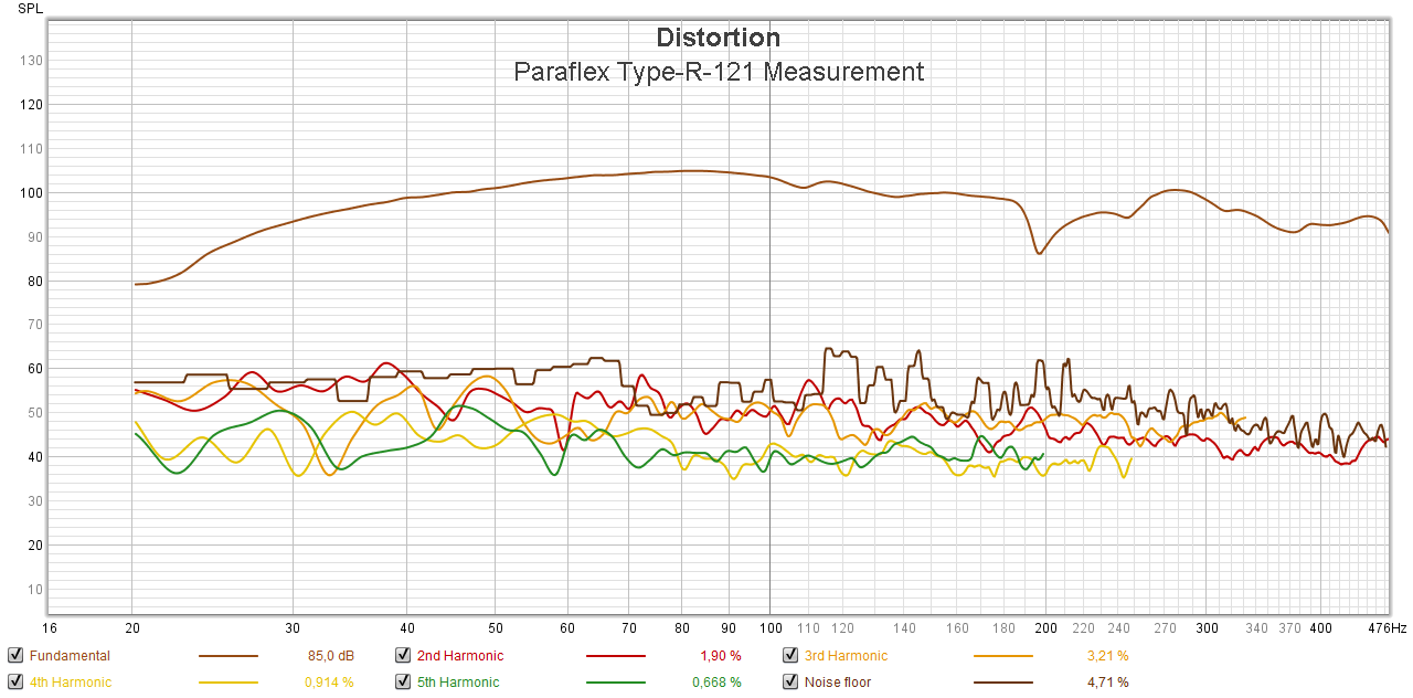

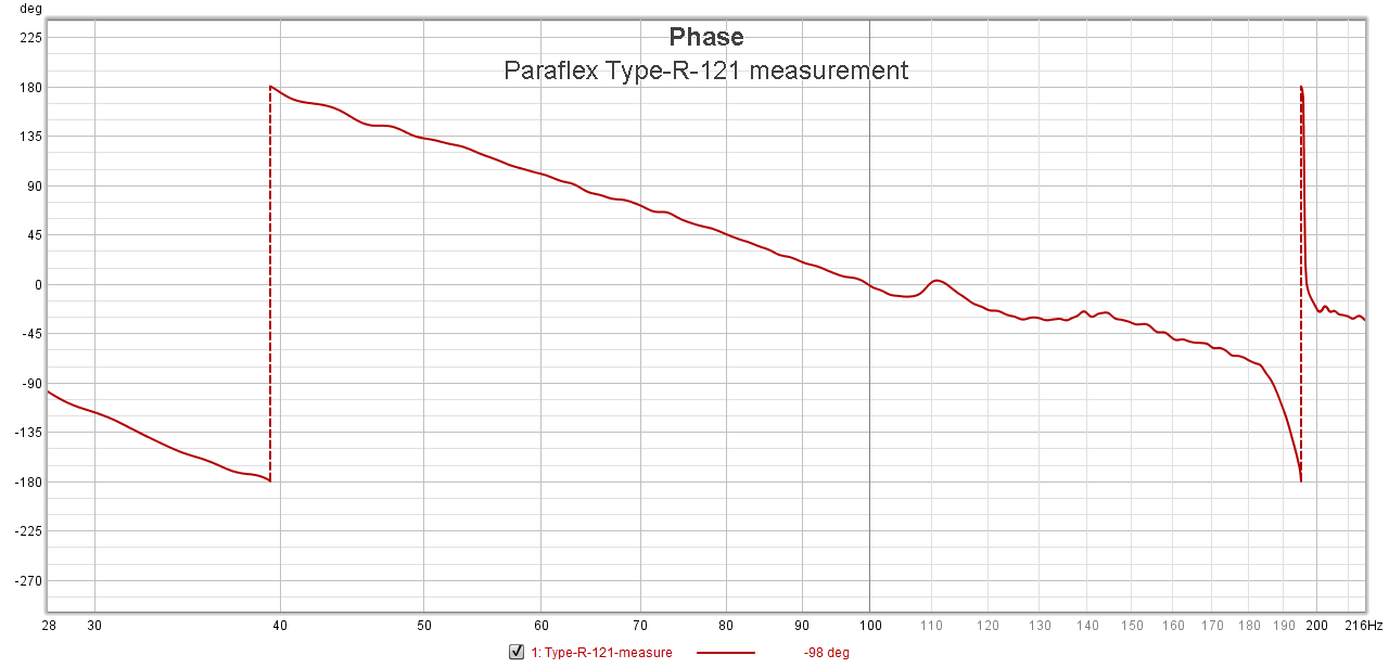

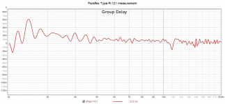

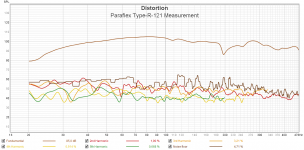

Are these 1m/2,83V groundplane? depending on the maximum dimension of the box the measurement could be made at 2m and then compendated back, hence the question.
Are these calibrated measurements (accurate with regards to sensitivity)?

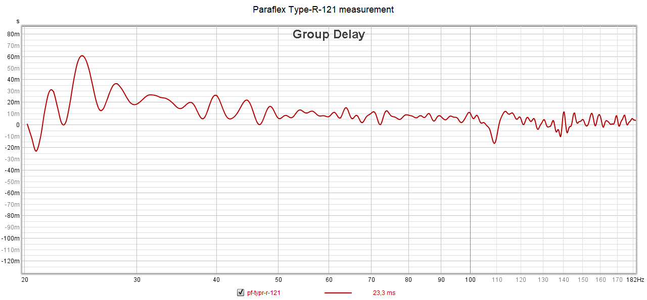

Thanks for sharing, looks good, I tend think we may put to much emphasis on GD, to me phase and HD up to 3rd or perhaps 5th order is more interesting as that tells you more about the what the bandwidth is made up of and how to process them for best result, not to take anything away from what you shared here, great stuff, thanks.
these are 2v/1m since its a 4 ohm driver. mic is calibrated using calibrator, spl meter also calibrated using calibrator. amp voltage output calibrated using TRMS meter.

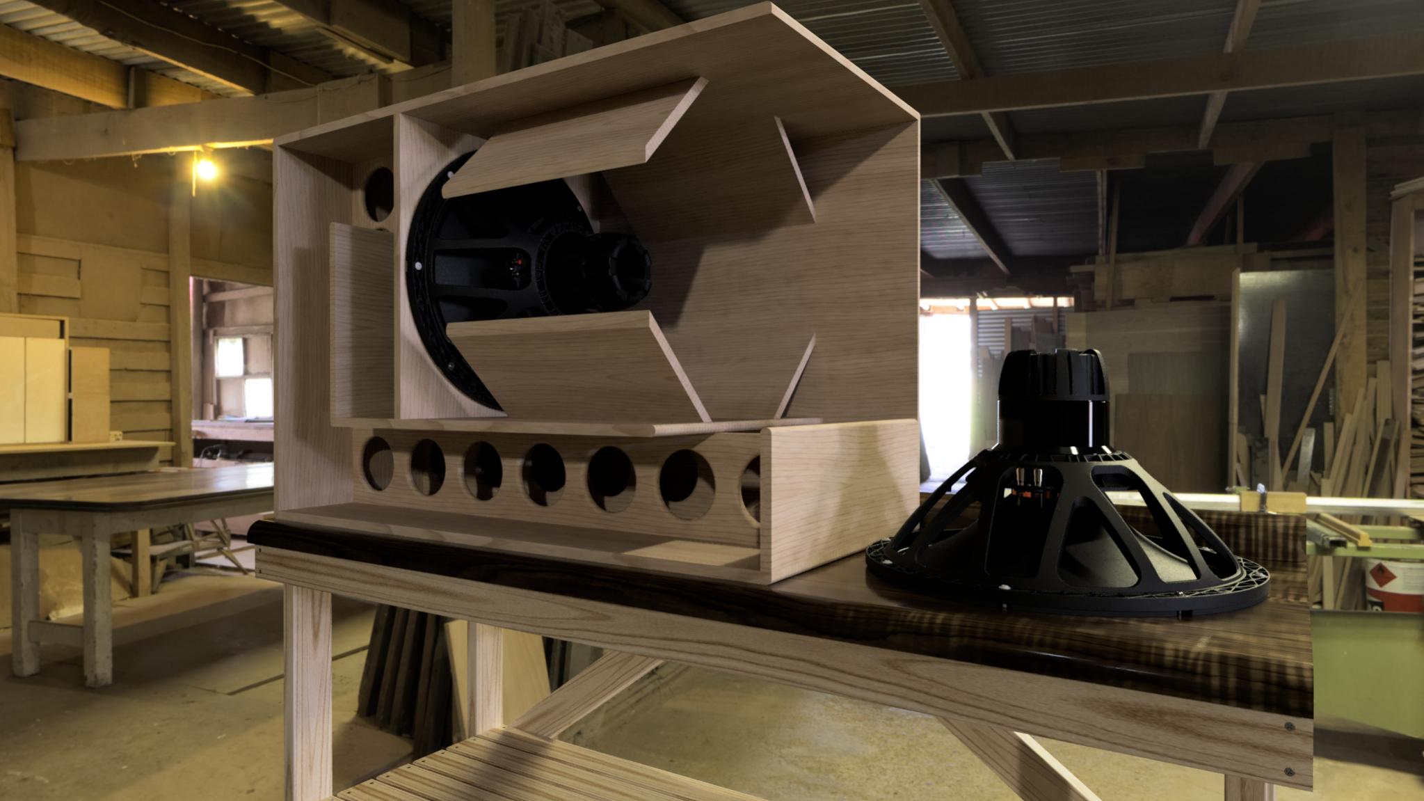

The front of the Type-R is relative small. since its modal is more depth than width. Here is a 3D image of the initial design by Ty Cention.
Great! It sometimes pay to ask since measuring correctly is a great deal harder to do, or to even be able to do, than simply just measure as I have done in the past, indoors, using an rta, at the aperture, which can be misleading when comparing results.
I normally think that as long as one describes exactly how one measures and what equipment was used as well as the state of that equipment then it is never a wasted effort, but measuring for comparative purposes requires alot more, which is what you have done, thanks, impressive!

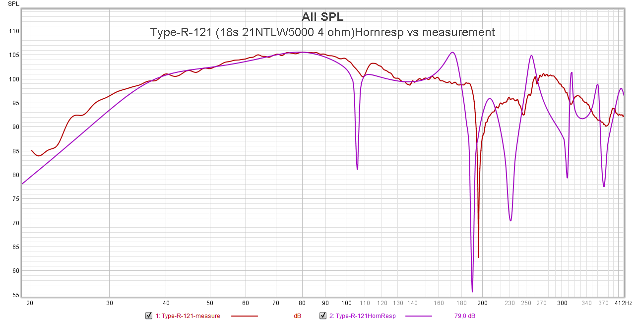

The low end increase in the measurement of the Type-R-121 over the Hornresp simulation in post #27 is interesting, as is the upper extension.
1) Could you post the measurement with no smoothing?

Art the first image HR vs Measure is the unsmoothed response.

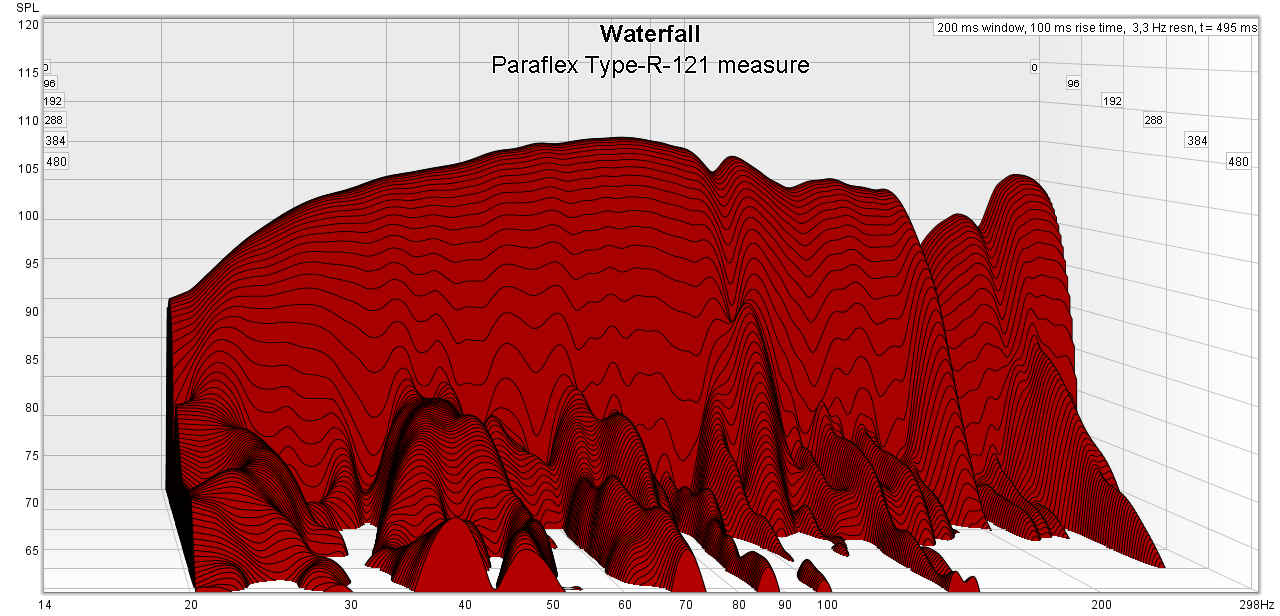

Here is the waterfall... also unsmoothed
