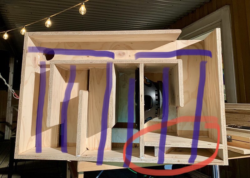

Hope to get the side panel on tomorrow. Can't wait to measure and listen to what it sounds like 🙂

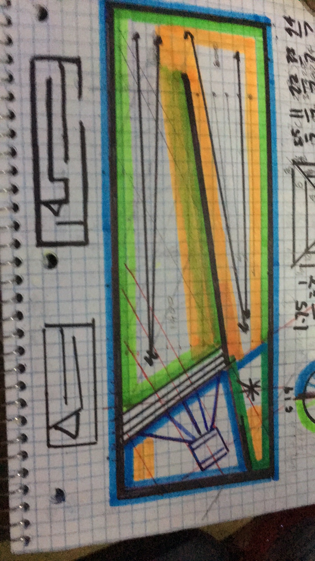

Without the red panel you’ve got a nice 6:2 (3:1) ratio in lengths and volume.
Yea, I thought of that too when I first started with the design in HornResp. I never got it to simulate well like that and chose to go for a slightly shorter high tuned resonator instead, based on the response in HornResp and my own preferences at the time. We will soon see, or hear, how it will turn out. The last panel is now glued. 🙂

Nice! That chamber/path area ‘stuffed’ looks very potent in lots of sims .( S6-s7, or better S7-S8/9). A lot of good things too from an abbreviated version of parallel to series exit with a short rear vented part in Superlow/wide instead of ‘high output’ gains with low Fs, heavy MMS drivers(like a Dayton Ultimax?) work too.
I keep messing with a variety of things with 4 4” drivers and 40 hz in compound pipes lately or 4 12 @ 30. and it’s sure nice to have the PH mode to look at timing of the ‘bounce’ of a pressure wave from the closed ends or assumed fold. The Roar and HRoar are very exciting too. seems to want a little more room to exploit the big csa but definitely a beast too(especially in PH sims).

Very well done! I like the design, bandwidth and simplicity a lot. Bet you could get rid of the hick-up by adjusting the path length a few cm. An other itetation though.
Thank you Petter for those kind words. Means a lot to me 🙂
Next itteration will have an adjustable path length in the high tuned resonator. 😀

To be able to deal with the cooperation problem between long and short resonator I made the bottom in the short resonator adjustable. I cut the bottom board just proud so it is possible to jam it in place at and hight. By that I have the possibility to find out the exactly right length. I still got some work to do before I have gotten it filed in perfect (or as good as it can be).
