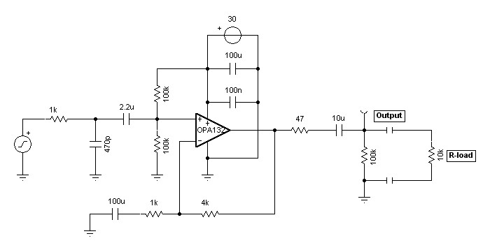

I will cancel the 35+
and going to take from main supply and build like this
you think mooly the schema in the last post will be ok ?
The one in post #38 you mean ? Yes its fine. So is the power supply.

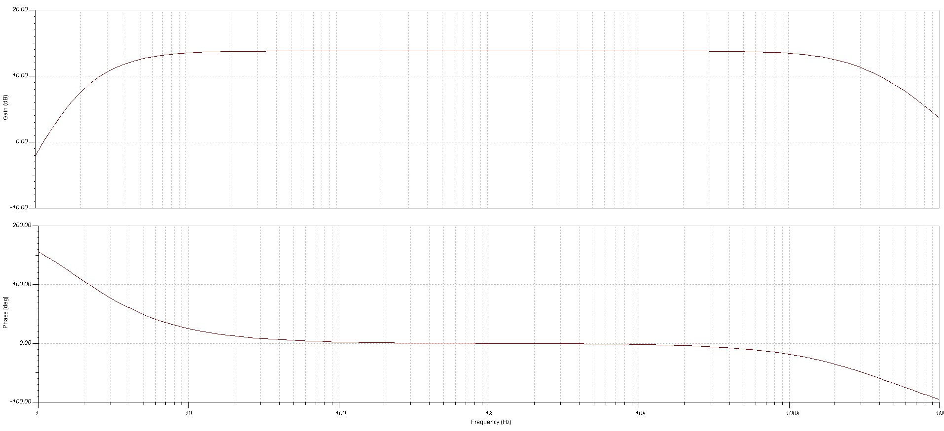

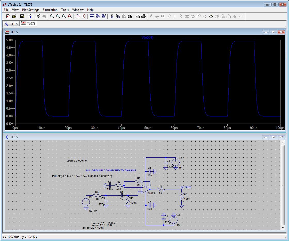

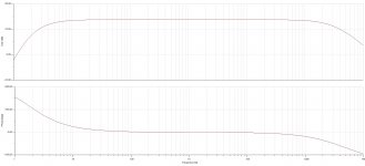

Yep. You'll find it better in simulation if you link the coupling and feedback caps out. Notice how the output is from 0 to plus 5 volts rather than symmetrical about ground.
5uF on the output would be enough for driving a 10kohm or higher load. I'd drop the input R2 from 150K down to 50K to possibly reduce noise. I'd scale R1 and R3 down to half their values to reduce noise. If you make R1 20Kohms, then I'd put a cap across it to roll off the high end above 100kHZ. That cap would have a value of 80pF. Anything close to that value is fine (I think 82p is a standard value). I'd put 0.1uF ceramic caps from each power supply to ground, within an inch of the chip. Also, put a 200ohm R in series with the output to reduce any reactive effects of the load. This will effectively improve the phase margin of the circuit (less likely to oscillate at a supersonic frequency). A passive Rf filter at the input would be a good idea too. A 1K in series, with a 2200pF cap to ground will roll you off at 72kHZ, assuming a zero ohm source impedance. Most sources are pretty close to zero ohms. You don't want to be asking the opamp to handle energies that it can't handle well.

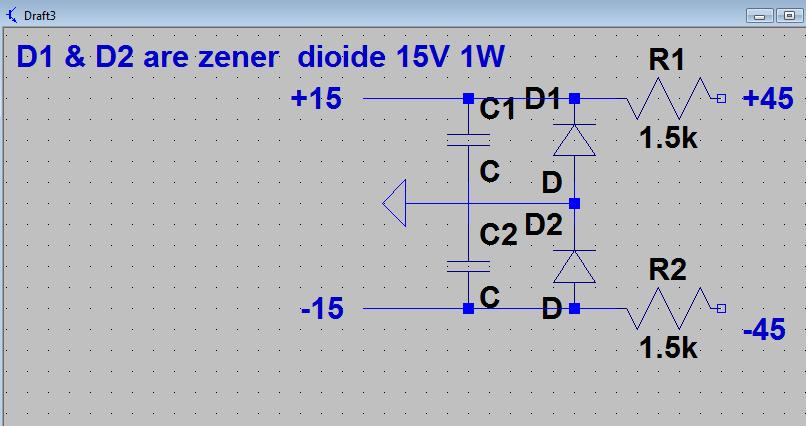

the voltage must be 30+ or it can be 15+ ?If you need a single rail version as Mooly says, this will work.
Mike
The NE5534 can operate on +/-5V to +/-22V, or 10v to 44v max on a single rail. It will operate on 15V but with a gain of 5 there could be problems with output headroom. So if the single rail power supply is less than about 36V or so (to leave some margin for mains voltage fluctuation) you could power it directly from there, or you can use voltage regulation if it's too high.
