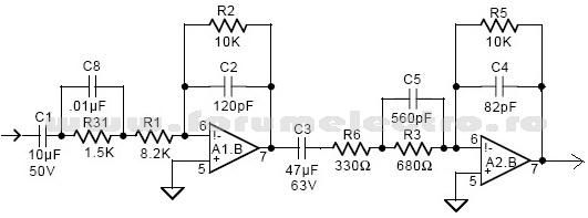

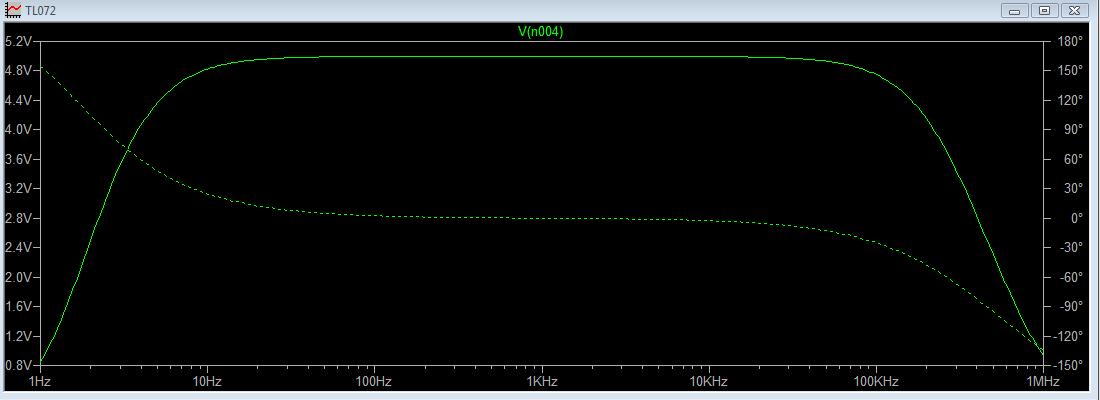

you mean like that ?
That looks OK. 1k and 330pf gives a -3db point of nearly 340kHz. Decoupling caps can be as low 0.1uf and added close to the power pins of the IC. Adding a single cap across the pins (4 and 8) can be just as effective at suppressing instability and has the advantage that no rail noise is injected into the signal grounds.

What is the function of C5 and C8 ?
You could still decrease R1 and R3 as Andrew suggested earlier, this can improve noise performance. I'd also decrease the input impedance 100k resistor to some like 22-33k and increase the coupling cap as required.
The output coupling cap may not be required at all but if it is bear in mind that a subsequent stage might be well under 100k input impedance and so your bass performance would suffer. Spec this cap according to the next stage input impedance, if in doubt make it large, but in theory it isn't needed at all.

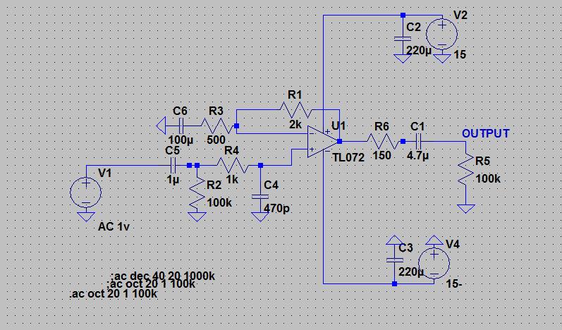

Your circuit in post #20 is fine. You could usefully add a small series resistor between the opamp output and C1 (to isolate the opamp from external capacitance). Use something between around 39 and 82 ohm. C1 could also be increased a little depending on the impedance the opamp is working into. There's noting wrong with using an electroylitic either, fit the polarity according to the measured voltage across the cap... it could be either way depending on the opamp used.

is this will be ok ?

Basic circuit is fine. Read what I said about C1 earlier.
(I haven't looked at the Marantz circuit but it was pointed out that its single rail... so this circuit of yours won't work as it stands running on a single supply although it can easily be modified to do so)

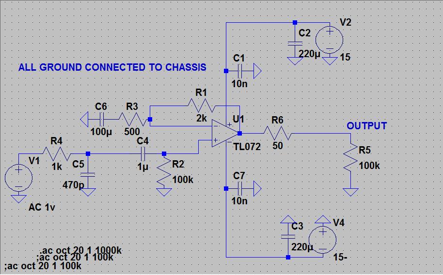

In order of importance:
You don't show proper power supply decoupling, there needs to be a 10nF or greater ceramic type cap on each supply rail right at the op amp supply pins to a low impedance ground.
R4 and C4 should be mounted on the input jack for greatest effect, and C4 should be grounded to chassis.
R6 would be better around 47 to 100 ohms.
C1 output cap is probably not necessary, but if you need it, make it more like 10uF so that when you connect a normal load like 10k ohm the bass won't suffer.

That looks OK. When you put it together keep loop areas small, i.e. mount the bypass caps close to the chip as mentioned before, the feed back resistor should also be close to the chip. Connections for input, output and power should be twisted pairs/triples.
I just noticed that the f3 of your feed back network is a little high-ish (3.2 Hz), so you might want to increase C6 to something like 220uF. Or you could just double the value of the feed back resistors with only a VERY small increase in noise and accomplish the same thing.

because it is old amplifier all ground connected to chassis .

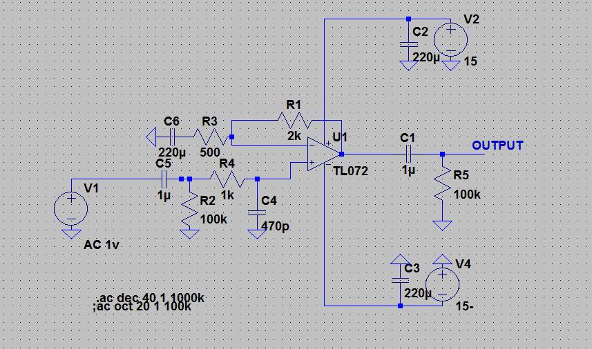

what do you think now ? thanks 🙂
How are you going to power this seeing as the amp is single rail ? Do you understand the difference ?
(as I mentioned earlier, you can easily make this a single rail design if you want)
