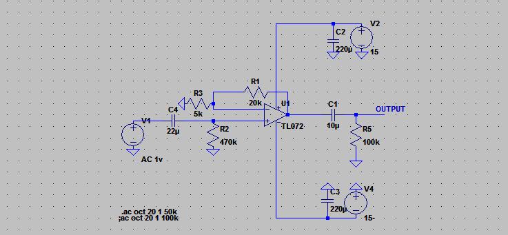

i was thinking of building preamp like this with IC socket
you think i should change something ?
where should be the capacitor in the feedback resistors ?

For your circuit, a 5532 or 4562 is about as good as it gets. You probably don't need any compensation caps if your layout is good. As ever, test on a scope and look at the transient and squarewave response. A simple RC input filter might be a good idea too. particularly as these are bjt opamps and consequently can be affected by hf hash at the input.

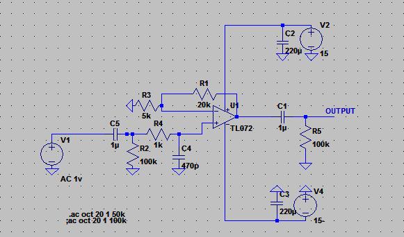

thanks for the advices what do you think of this circut now ?

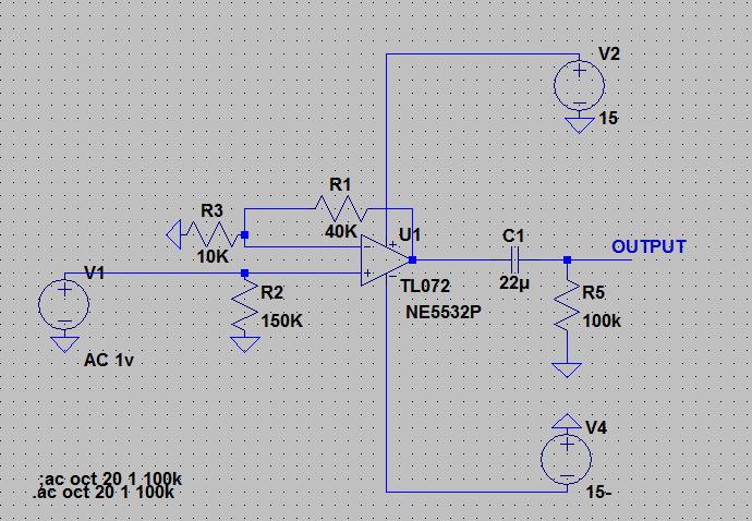

thats why I ask for your opinion , I want to build a circut with IC socket and to put there recommened op amp .
I will start with the NE5532 and buy another opamp one soon .
I think I will give up the tL072 .

Is this an audio processing circuit?
The input is F-3dB @ 0.015Hz
The output is F-3dB @ 0.16Hz
Audio stops at ~ 20Hz.
Power amps deliver sufficient low bass with F-3dB ~ 1Hz to 4Hz.
Pre-amps set to one octave lower will deliver all the bass your system could ever reproduce.
Still no RF attenuation.
Still no HF decoupling.
R1 & 3 could be halved again, or even lower. What about 2k:510r?
RF:
add 1k0 and 330pF to 1nF
HF decoupling:
add 100nF x7r
try preamp with input filters: High Pass of 0.5Hz to 2Hz and Low Pass of 200kHz to 500kHz.
and an output filter : High Pass of 0.5Hz to 2Hz.
