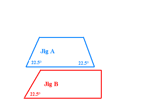

B) Is this the clay jig that your wife made for you? If so, does it have a provision to cut the pipe at 22.5° from the second end? If not, I wonder why no mention is made if turning the pipe 180°, or thereabouts. If you can cut from only one end, and you are not rotating the pipe 180°, things are going to be off.
Does the jig you have resembe the double-sided Jig A or the single sided Jig B?
MSPaint picture below.

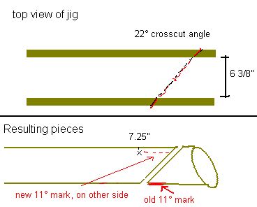

I said it wrong.
In step 6, there should be a 180° turn in between "I find the 11° mark" and the new measurement. The 11° mark still functions as the centerline for the segment, and is the basis for the 180° turn for the 7.25" measurement (my margin of error is almost 1/16th of an inch, so I figured to go by 8th inches).
You'll see on the pic that I mark the 7.25" on the 180 from the old 11 (small dash), then move it -11 (x marks the spot).
Lemme know if this makes sense. Need sleep.

All better now. See anything odd with that pic? Otherwise, it's the way I'm going.

7 1/8" is even better. 7 3/32" exactly is obviously unobtainable.
The only reason I made a big deal about the outside dimensions and cuts is that before you built this jig, you were measuring the The Long Side and the The Short Side, and cutting between them. In other words, you were going by the outside measurements, and using them to create your angle.
You were going by The Short Side dimensions that were off. They would not create the necessary 22.5° angle, so the octagon was not going to end up correctly.
However, now the jig cuts the angle correctly, so a little bit extra here or there is not critical.
Of course, I could be a wise guy and say that if you, as a graduate student, are having these problems, then you're the best argument for going (ugh!) Metric I 've come across lately. 😀 😀
I have a confession. Until last night, I didn't realize that once you get past the end piece, each cut you make is the second cut for one piece and the first cut for the next piece. You are not making two cuts per piece. Once you make the first cut in the 8 foot long PVC pipe, you are then making one cut per piece.
So, by twisting 180° in the jig, you are using 11 cuts to create 10 pieces. Clever.
Therefore, what you are doing is moving the 11° offset line over as you move down the line. Every cut must be offset 11° from the previous cut, and you move down the 8 foot PVC piece in that fashion, turning the PVC pipe approximately 180° each time.
I would say that your setup is fine. One thing-you did check to make sure the jig gives a 22.5° cut, correct? If that angle is correct, then your setup is fine.
