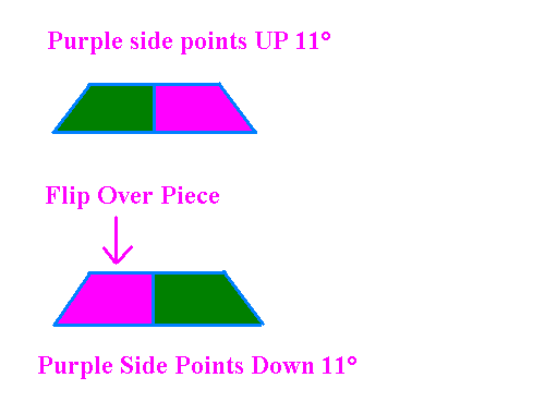

Since the second enclosure will have the pipes winding upward to the left, (as opposed to the first speaker winding upward to the right), I think this illustrates why the 11° line must be on the opposite side of the centerline when you cut the pieces for the second speaker.
Faustian pointed this out in post # 166.
yes, I can independently confirm that. That's what I was talking about, and my suspicions, for once, were correct.
That is, if we mean the same thing when I say "-11° for one and +11° for the other."

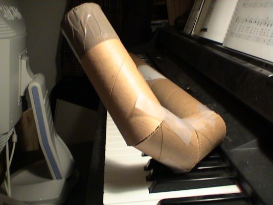

ready for a pic? It's cut with my brand spanking-new jig out of a telescoping mailing tube I found. The rotation is of an indeterminate angle, but is always positive, that is, rotated away from me on my jig.

Sch3mat1c said:Woot! It's taking shape! 😀 😀
- What kind of piano is that...?
Tim
Yamaha Clavinova, the 2nd tier model from 1997.
Yes, that cardboard tubing represents a great victory to come!
Dave

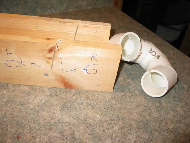

I cut a piece of pipe just to check. the jig will work as I propose.. it will produce pieces that will work for left or right spirals, The jig cuts a 22 degree angle to one plane and 5.5 degree at 90 degrees to that plane (the 5.5 degree cut is plus 5.5 degree for right spiral and minus 5.5 degrees for left spiral. The two diagnols need to be cut with the pipe roated 180 degrees.
I made a small jig for 1.5 inch pipe and cut some segments to test the principle. I'll try to include photo..

Correct. The cut in the jig is angled at 5.5 degrees from vertical. Plus 5.5 degrees produces a right spiral. a slope of minus 5.5 degrees produces a 'left' spiral. I cut 6 segments.. didn't bother to measure for length.. also during assembally I simplly matched up the cuts... no twisting..no measuring.. just fit the pieces together so they matched up as best I could.
In order to make that 180 degree twist I suggest that you mark 2 lines down the length of your pipe.. one on each side (180 degrees from each other) ... mark a center line on a brace.. (on top of the jig)... this will make it easier to set up the pipe to make your cut.

I put up a drawing on Post # 173 to illustrate the position of the 11° rotated angle to the centerline. Centerline is in red, 11° cut line is in green.

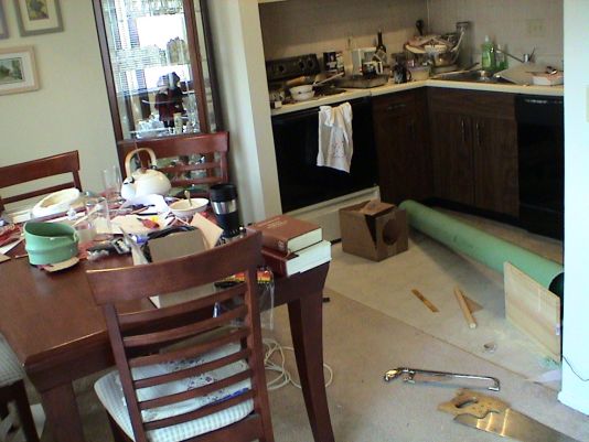

GREAT NEWS!!!
I mentioned my project in order to entertain a lady I know, and she says, very cheerfully, "Bring it over this afternoon. My husband has all sorts of power saws for silly projects like this."
Sure enough, the guy has a 12" Bandsaw, among others. YES!
I'll definitely post back with pics later this (Sunday) evening. In the meantime, I have a very messy apartment to clean.
My workshop is (was) outdoors, and since it's like Canada around here (32°F highs), my workshop is now on the kitchen floor. In short, you can imagine the mess. I have only four hours to clean it.
I'll test the angling in full with the tubing, now that I have a giant powered band saw to play with.
Dave
