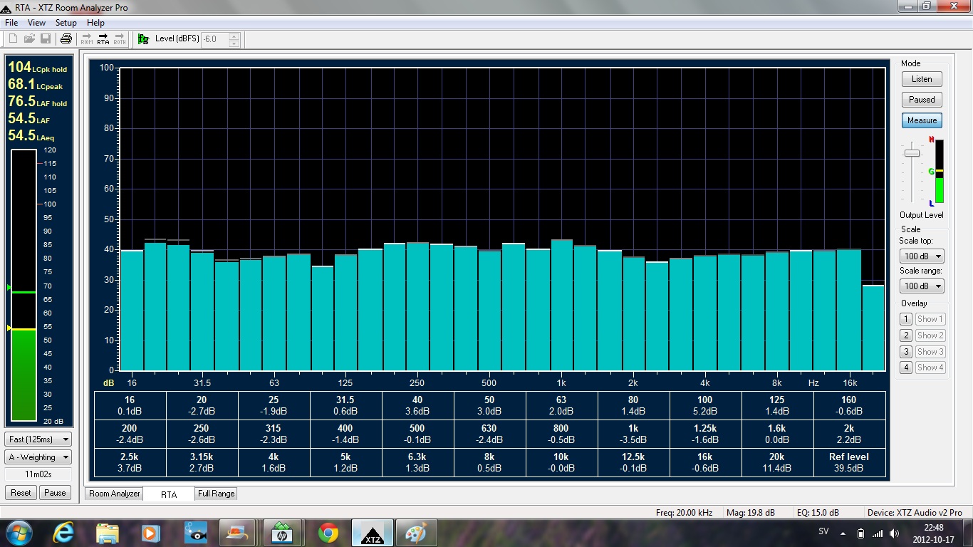

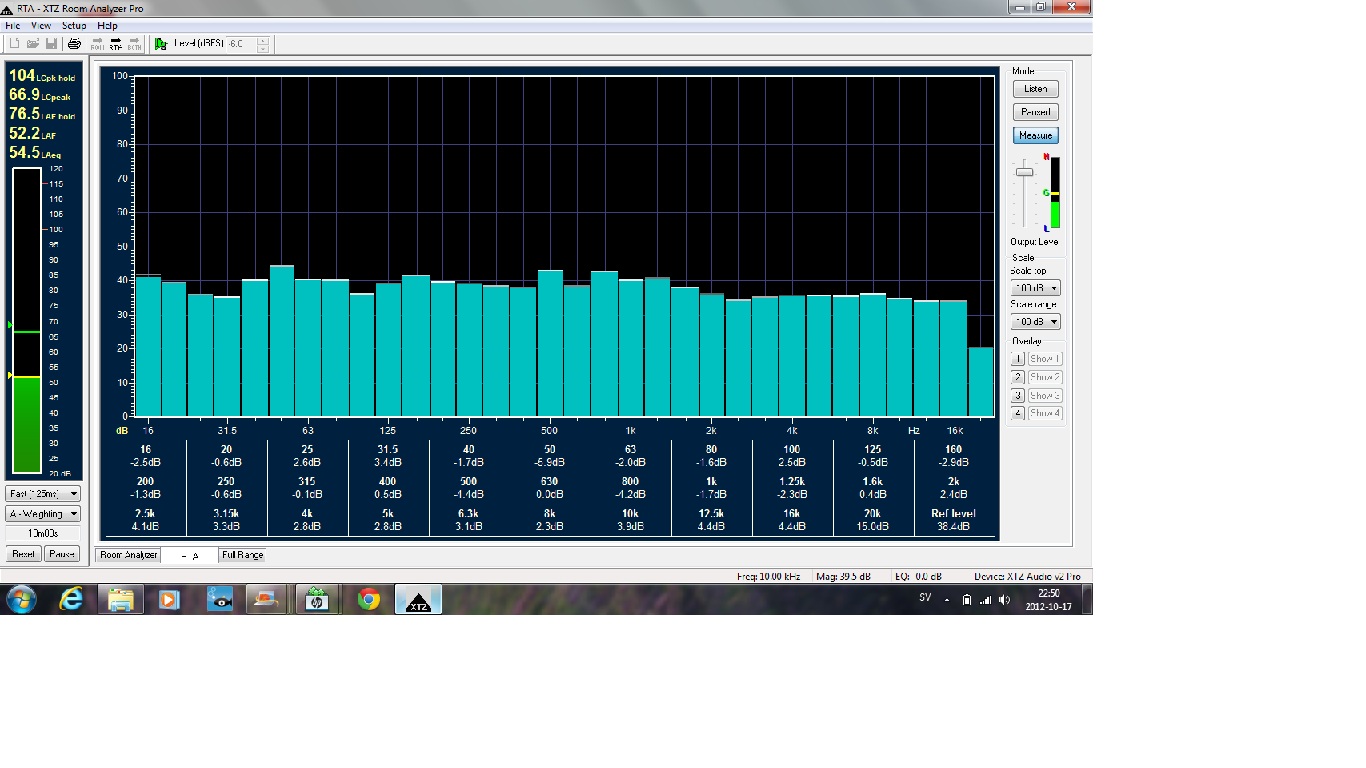

I did two measurings at listening position and in front of one speaker at about 1 metre with both speakers playing white noise. It looks like it is mostly the room since at 500Hz it is first a little peak and then at 1 metre it is a dip.
The dip over 16kHz I do not know why it is like that since I have measured before and did not have such a big dip.
16kHz, hmm very easy to move the mic, catch some destructive interference, toe in if in stereo, things like that. It beams there and the room absorbs easily. Since you got it before you gonna catch it again.
Well it was not that Salas, I found out that when using a borrowed computer it looked just fine and now using a new one I just bought it dips over 16kHz like that! Strange, this computer use windows 7 and the other borrowed one use windows XP which is recommended from the software makers although it is said to work with 7 or XP, and it should be fast enough according to program. No idea if it is that which is making the difference, I have to email them to get an answer I guess.

I sent an email to XTZ about it. Since it use an external sound card and it works perfect with one computer it must be something with my computer that is not as it should, thanks anyway Salas but I will see what answer I get from XTZ. I think maybe my computer is too slow after all, it shows the same level whatever I do with the mic. Anyway, the problem with the "shouting" is the room I am rather sure of now so I have been thinking of maybe trying to move the speakers from that wall and use them on the long side of the room instead. It is 3.80 metres wide so maybe that works. The speakers are probably not to blame here and that is good news. Sorry if I gave the impression of something else.
I have got an answer from XTZ and according to them it can be a setting in Windows that needs changing, I will try that tonight.
It was a setting in windows audio that needed changing, everything is working now.
Had to rise quality to "DVD standard".
