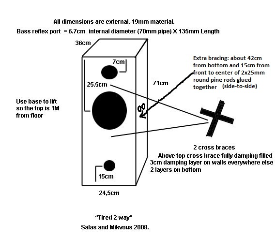

I was not quite satisfied with the extra bracing (still some panel distorsion) so I put in another 25mm round rod and glued it together with the first one from side to side. This made all the difference, it is now almost completely dead, could this be heard when listening? You bet! Midrange detail is much better! I really recommend anyone to carefully listen to side panels on speakers to be sure it is not making any sound, it makes a big difference! Even the bass seem a little more detailed.

Sorry I have none, but I can explain where it is. If you look at the woofer from the front, the bracing is in line with the two bottom screws of it (one step up from the single screw 6 o´clock so to speak), that would be four and eight o´clock. It is about 2cm from the magnet of the woofer in depth, almost at the middle of the panel. the 2 rods are placed behind eachother seen from the woofer into the cabinet.
This worked for my cabinet, but depending on where the other 2 braces are placed, just put it where it makes the sides as stiff as possible, you can knock on the panel and listen where it is best placed.

You could draw a quick and dirty sketch of your total bracing as it is now, so others possibly interested in making a copy speaker won't have to rediscover America.
Yes, I had to cut the rods in two with a little angle to the cut to be able to get it in place and remove a little damping material to get to the wood of the side panels. The lower bracing was a bit lower in my speakers than your drawing, Salas, so the extra bracing is probably even more effective in my case.

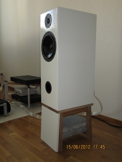

I found a stone plate that fits and bought 4 of them today. I will use this on the lower part of the stands to make them heavier. My stands are rather stiff but has low weight, so this might help. Reporting later with a picture and how it sounds!

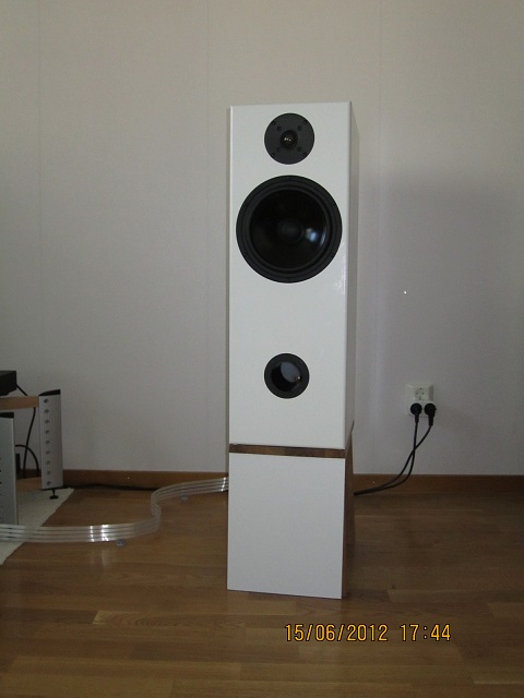

Adding some weight to the stands and the bass is very different: faster, tighter and deeper and cleaner. Some of the "fleshy" sound is gone and now more tight and fast. Probably a more "correct" bass. Sounds promising!
I can still hear a few side panel sounds I would like to get rid of, but how to do that is nothing I master at the moment. That might be the last bit of the puzzle to get it right. Anyhow the bass is transformed, hopefully I like it in the long run.
The stone plates are 175x350x5 mm. I added a small front panel making the stones invisible from listening position, not very good looking 😀.
