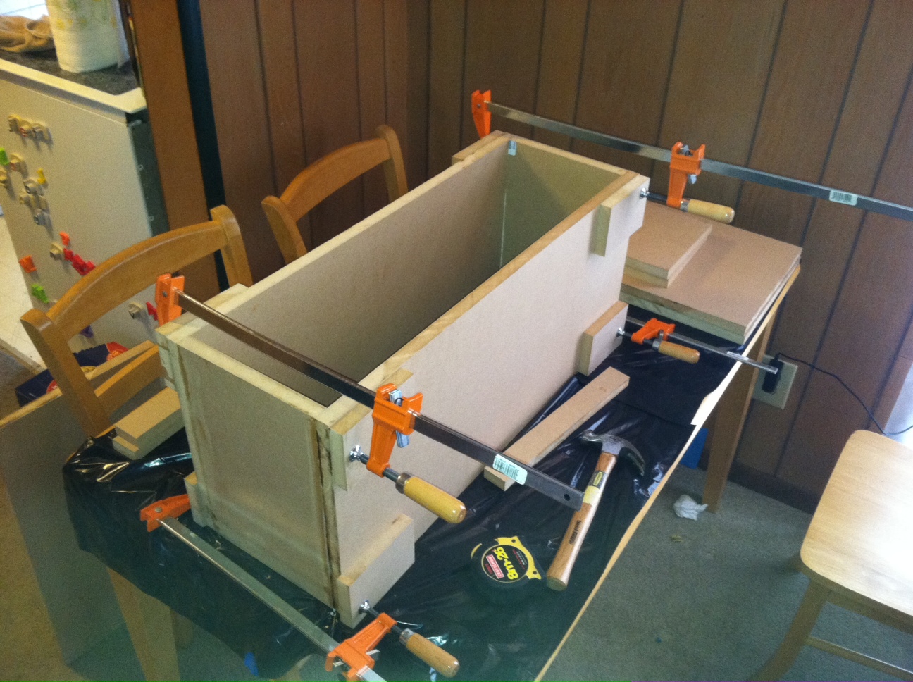

I have some progress today, on building my own pair of tired 2 ways. This is my first speaker build.
For anyone thinking of doing this, I was able to get all material out of one 4' x 8' sheet of 3/4" MDF. I know that HomeDepot will not cut as precise as I needed, so I got them in sizes larger, so that I could cut them to exact spec myself. I got 4 pieces 10" x 16", 4 pieces 12" x 30", and 4 pieces 16" x 30". It barely fit, and it may have been a touch smaller... but the HomeDepot guy got it to all fit on one sheet of wood, and all 12 pieces easily fit in my small car.
I was worried, because my fence can only be put about 61cm (24 inches) away from the blade (the table on the saw isn't wide enough). Today, I had to build a makeshift table, set it next to my table-saw, and clamp a fence to it to get the long length 71cm. With the help of my wife, to stand on the feet of the table, so it didn't move, we managed to keep it square, and even more importantly all 4 front/back panels and all 4 side panels are exactly the same length. 😛
I will be stalled in my progress, because rather than buy my own router, my friend who has one can help me with the circles on front baffle. He's out of town for a few weeks though.
I can tell you that getting glue on all the pieces, then getting them to stand on end, square up to the edges, and clamp them…. It helps to have another set of hands. Tomorrow we’ll put glue sides and top of the other cabinet, and clamp that one up for a day as well.
I was thinking to rabbit and daddo the top to the sides, but I changed my mind, as it was seeming too easy to make an error for a novice like me. I just butted them like you did Stare.
Did you use screws as well, or just glue??

I used dowels to keep it in place since I have only 2 hands, lol. Then I only glued it no screws. Looking good, I would recommend to place the bracings exactly as in Salas drawing, I did it a little different with the lower bracing but I think that was not better so stick to the original.
