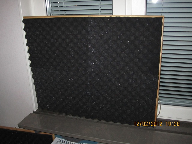

Here is my side panel to dampen/diffuse side reflex from glass window:
If you use the formula T= 1/f and then s = vT you can see what wave lenght different frequencies gives. The "bumps" on my panel are perhaps too small and uniform to be perfect but it makes a difference to the better when you listen.
Nice. Some strech a porous enough cloth of mild color or some painting print over to enhance its aestetic blending in a daily use room.
Yes Salas, I have been thinking like that, it is too black lol. It is glued on some ordinary card board with a wooden frame on it, very simple.
