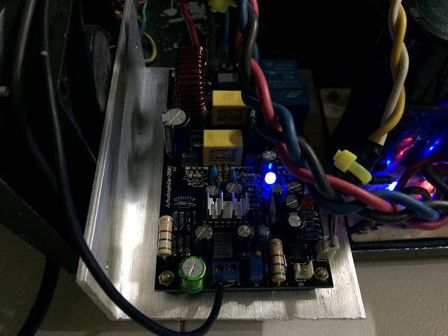

Got exactly the same result with the temperature of IRS2092.
I am using DIP version of IRS2092 driving IRFB4227 directly.
Voltage rails +/-87VDC.
Gate resistors are 4.7R.
250kHz is good without buffer for IRFB4227, if you go lower, the inductor temperature will rise.
Because of high temperature of IRS2092, and inductor heating when using IRFB4227, I cannot suggest it. I'm getting 10W power consumption at idle.
Just use IRFB4615. IRS2092 DIP can drive it with ease. You can achieve 500W @ 2ohms with +/-60VDC rails, just provide good heatsinking for output mosfets.
If you really want the IRFB4227 use totem pole buffer.
For 1 pair IRFB4227, use transistors with low Vce Saturation Voltage, DC Collector Current of 2A or higher and dissipation of 1W or higher.

Do not use IRS2092S SMD ic, there are lot of fakes out there and will blow up at +/-80VDC. Use AUIRS2092S from reputable electronics store if you're planning SMD+buffer.

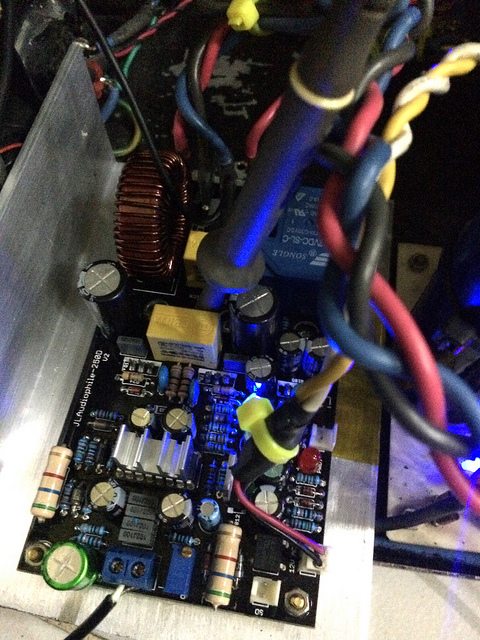

Hi Markus,
I overlooked this important detail, I reduced VCC to 11.7 volts and now the IRS2092 chip is now significantly cooler 🙂
Thanks!
With my current setup I'm getting 1KW @ 2ohms dummy resistor (5 seconds) +/-85V DC
Though I don't like any heat specially on IRS2092. Not suitable for active speaker systems.

Hi Markus,
With my current set up I'm getting 1KW @ 2ohms dummy resistor (5 seconds) +/-85V DC
4227 is a tough one, nevertheless a single pair of 4227 will have a life on the edge with this and survive just because fs drops towards larger signals.
Detailed measurements and analysis of worst case switching losses and calculation of die temperature would tell you that you are brave man. 🙂
Please keep us tuned about your reliability experiences of this set up.
