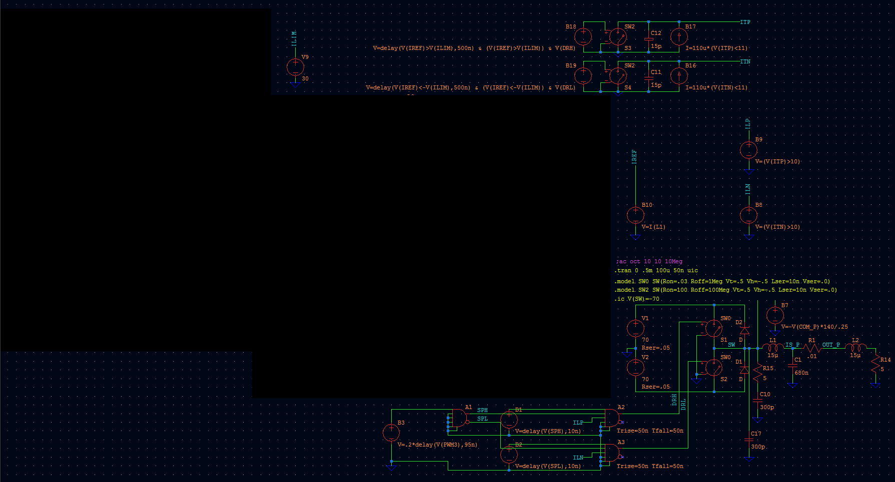

Going forward, does anybody have a LTspice library for the IRS20954/955/957? I'd like to try a few options in the simulator with a (semi)discrete frontend to get rid of the (somewhat) noisy OTA on the IRS2092.
I can show the LTspice simulation circuit that I use for IRS20957 and IRFB4615 output stage, it is intended for quickly simulating the stuff that matters (propagation delay, dead time), not as an ultra-accurate model taking hours to run. Actually, main purpose of this circuit is modulator simulation and fine tuning, since designing around the IRS20957 is quite straightforward.
It also includes current limiting to analyze possible interaction with output filter and the whole amplifier loop. Current limiting OFF period depends on capacitance attached to CSD pin, the value modeled (15pf) represents some IC capacitance plus some PCB capacitance from a 10 mil trace similar in length to the IC itself plus some collector C from a small BJT. Hard to get lower figures in practice. Too long period can excite output filter close to resonance, without the modulator being able to control it, as obviously current limiting overrides PWM input.
The modulator has been "censored" because this is part of a commercial design, I cannot show it all.

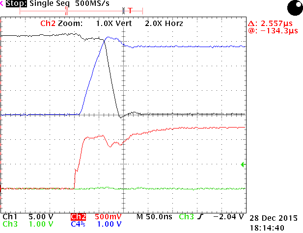

This thread so far covers the input stage and gate drive, but misses out the power stage.
When going for power, especially with MosFet that can handle more than 150V, then it is worth to look into the halfbridge configuration.

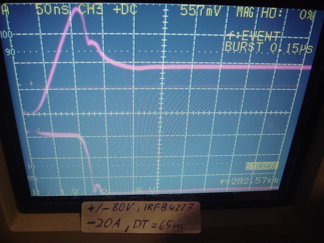

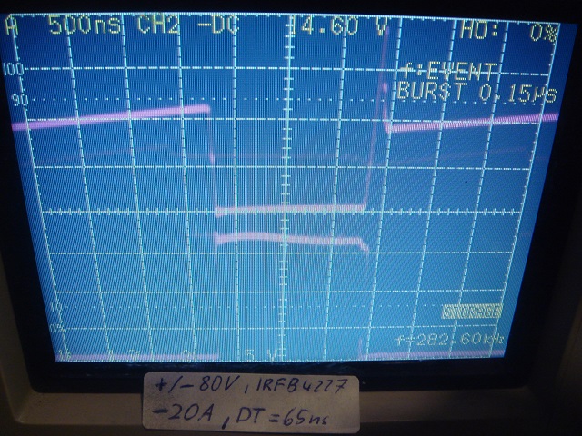

In order to show why I am attaching some measurements with the IRFB4227 running from +/-80V and handling 20A load current at the same time.
This is the most demanding situation for the low side MosFet at large signals during the negative half wave of the output signal.

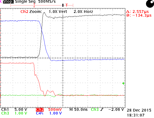

First picture shows the entire HF period.
Second picture shows a zoom of the turning on with 50ns/div.
Third picture shows a zoom of the turning off with 50ns/div.
The upper trace always is the drain current of the low side MosFet. Scale: 10A/div.
The lower trace always is the drain source voltage of the low side MosFet. Scale: 50V/div
The heavy current peak upt to 38A during turning on is not a shoot through, it is caused by the Qrr of the body diode of the opposite MosFet.
The related losses are high. During the time which is need to take over the load current (ramp from 0-20A) and for the first part of the removal of Qrr (ramping from 20A-38) the Vds remains almost at full rail-rail level. Switching losses at 280kHz plus conductive losses sum up to 100W if you would apply this as a continuous DC load situation. Fortunately this happens to each MosFet only during a short time of each audio signal period. Also the self oscillating designs reduce fs at large signals, last but not least audio signals usually come with high crest factor. Over all it will work for audio if sufficient cooling is provided. But from perspective of power electronics design it is a poor solution.

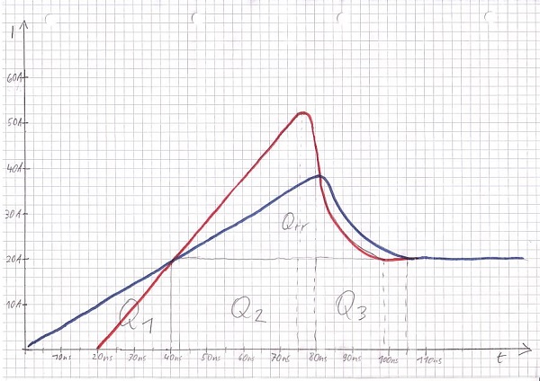

total reverse recovery losses (body diode plus opposite FET) are reduced as di/dt is increased. This can be pushed to the point where the body diodes latch up, less some reliability margin. Of course layout requirements increase. I think the well known FETs currently available up to 200V d-s are OK without any extra diodes...
I wish you would have said the total turn on losses are reduced as di/dt increases.
But regarding Qrr things definitely do not get better with increasing di/dt.
Lets focus on the switch which has to remove the Qrr, because this switch is seeing the massive overlap of current and voltage, while across the diode the voltage remains comparably moderate during most of the time when it is carrying current.
In the attached drawing I have put two situations.
First the drain current as shown in the screen shot of my previous posting with very moderate di/dt of 500A/us, showing the current in the switch which is being turned on hard.
Second - the situation with double di/dt.
Q1 is the amount of charge until the switch has taken over the load current.
Q1 decreases with increasing di/dt. That's fortunate.
But after Q1, still the body diode of the other switch is flooded with its Qrr.
During the time of Qrr the switch has to carry the load current plus the reverse recovery current peak. Q2 which simply results from trr and the load current does get moderately less, but just moderately, because trr decreases just moderately with higher di/dt. Qrr unfortunately increases with larger di/dt.
Q3 starts earlier and ends earlier at higher di/dt, so not much of a change.
In sum the reduction is mostly related to Q1 which is not the T.rex of the show (except when operating at very low di/dt).
With devices like the IRFB4227 reasonable di/dt are in the range 500A/us...1000A/us.
But already at 1000A/us without fully optimized dead time you are buying a small reduction of losses by a remarkable current peak and the related increase of EMI.
