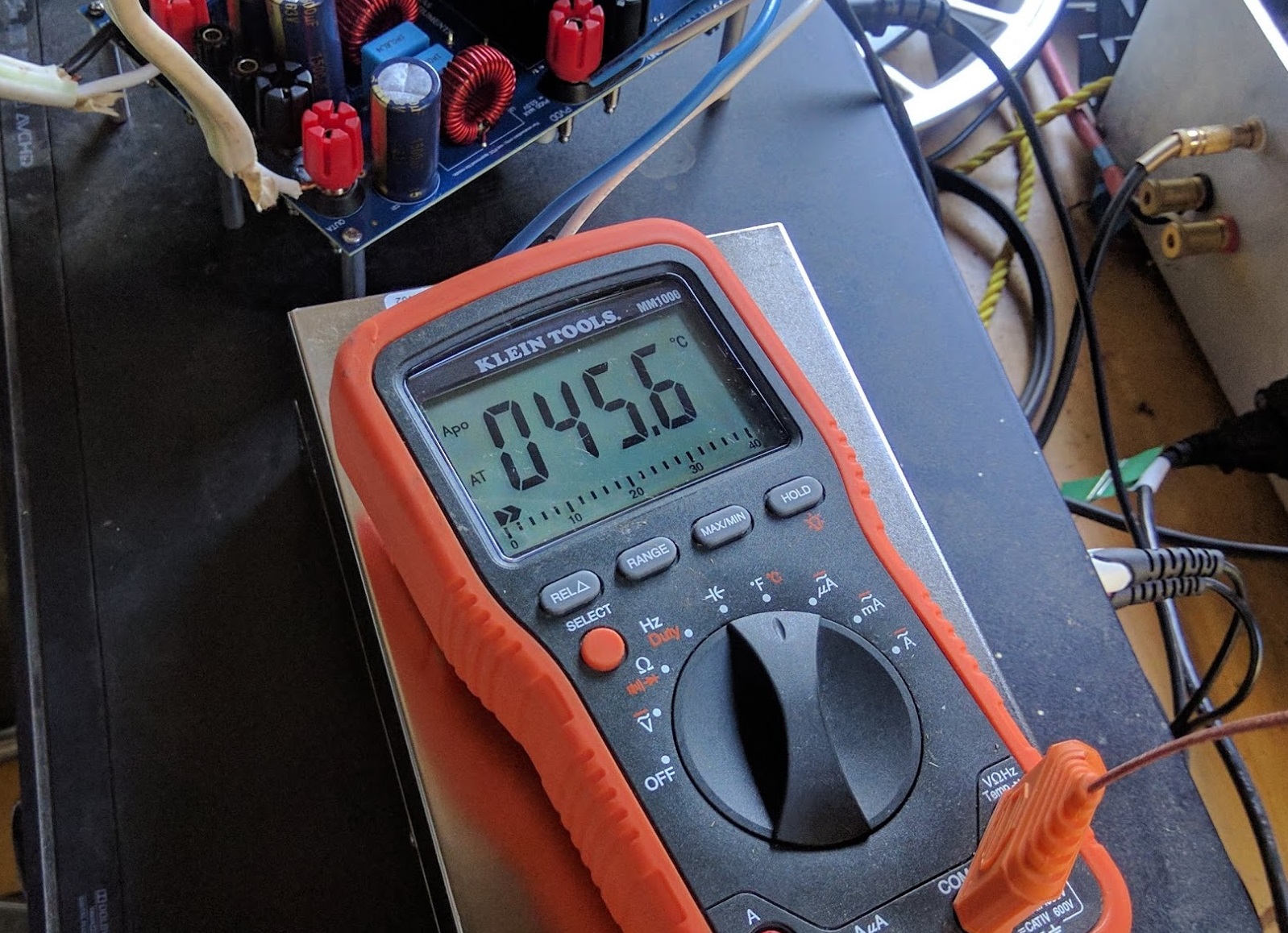

I got a Meanwell SE-600-48 PSU for this EVB. I didn't realize the fan runs all the time. I unplugged the fan and ran it hard for two hours, the internal heatsink reached about 45°C.

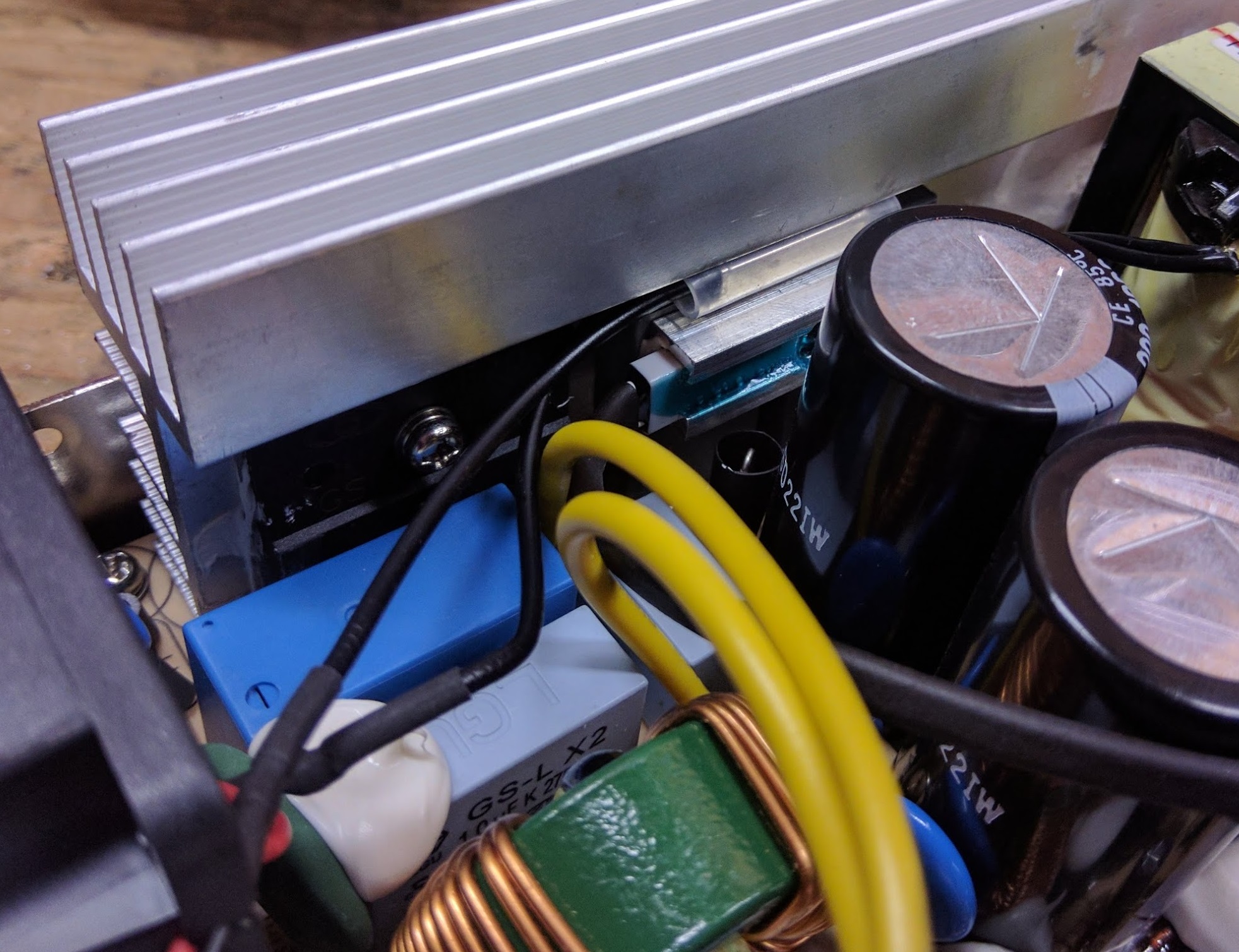

I bought some thermal switches and put one inline with the fan. I then tucked it in next to the stock over temp cut off switch. This particular switch isn't isolated from the case, it comes with a silicone tube that goes over it, otherwise I would have slid it into the same channel the existing switch is in. On other Meanwell supplies, the fan kicks in at 50°C and off at 40°C, so 45 seemed right, no clue what the hysteresis might be.
Now the fan doesn't run unless you're listening very loud, in which case the fan can't be heard. 😀

That’s probably an advantage of getting the 600w PSU. Most of the time it’s just loafing, and it probably has a bigger heatsink too.
I suspect the fan will never turn on, but it gives lots of peace of mind having that switch just in case!

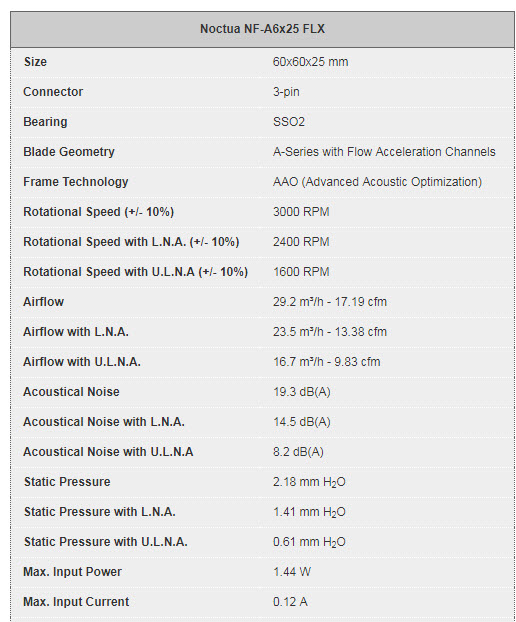

I saw that vid. Even with resistors dropping voltage it is still loud. It's just a crappy fan. I swapped in the noctua and it is close to silent. Well worth the $15, just a few dollars more than the fan controller.
The Noctua does 3000 RPM at 19dB. I don't know what the stock (Sunon) rpm is. Surely, the 3000 rpm should suffice for our purposes.

I installed the Noctua 60mm in the MW SE-600-48. The fan was not as loud as the stock fan but it was little louder than I thought. So I installed the noise adapter along with the fan. That has reduced the speed of the fan and also silenced the fan a bit. The noise is more from the airflow than the fan itself. The stock fan itself was louddddd.
