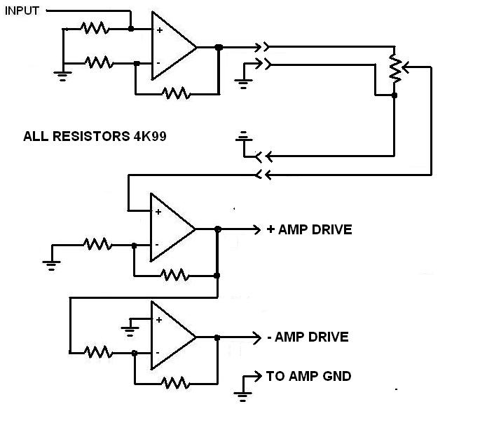

Okay...dumb questions...
Is that a se to differential buffer with volume control?
I assume two would be needed?
Mike
Mike
One circuit for each bridged channel, yes. You obviously wouldn't need the lowest opamp if you're driving a single ended channel.
