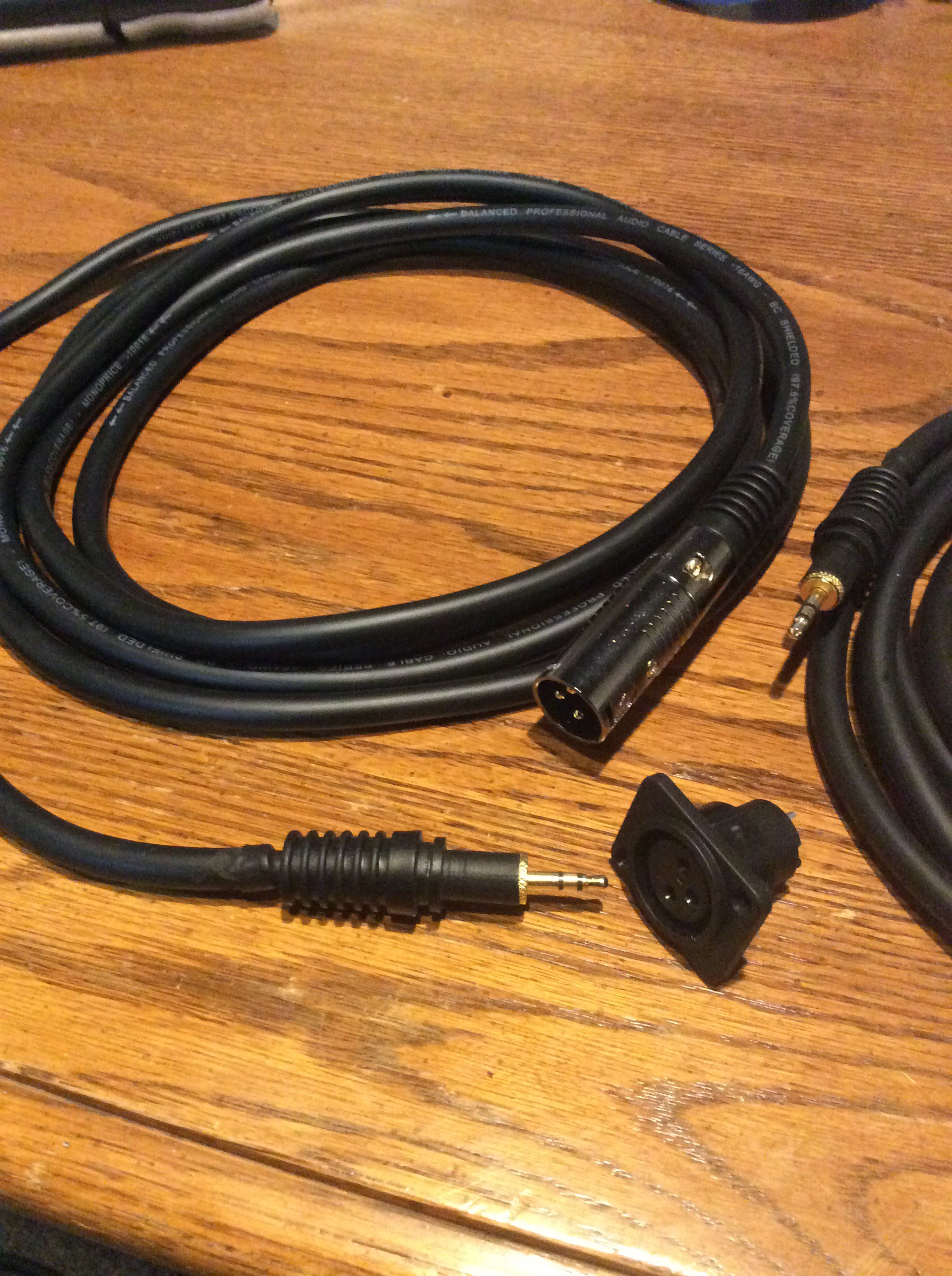

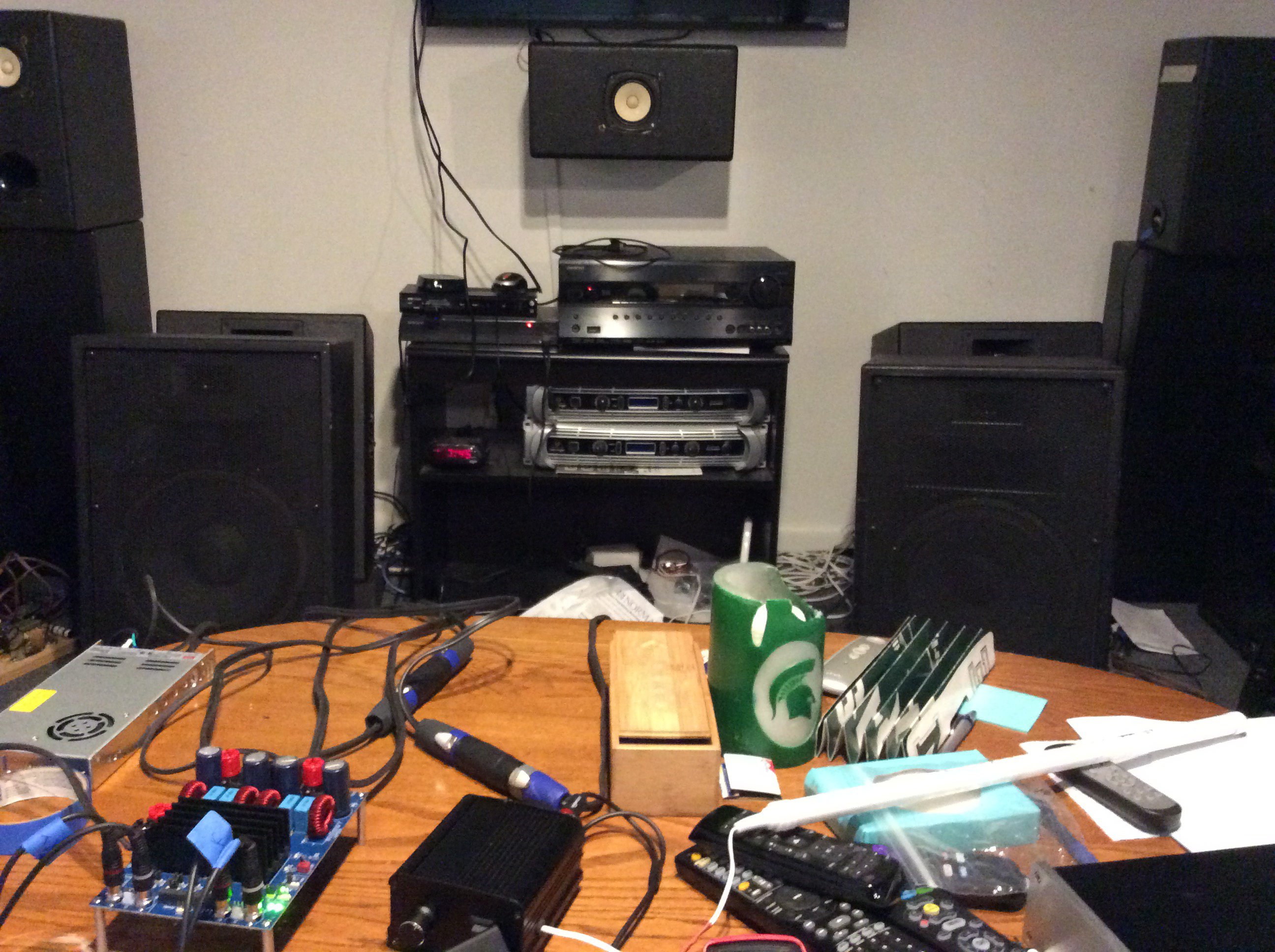

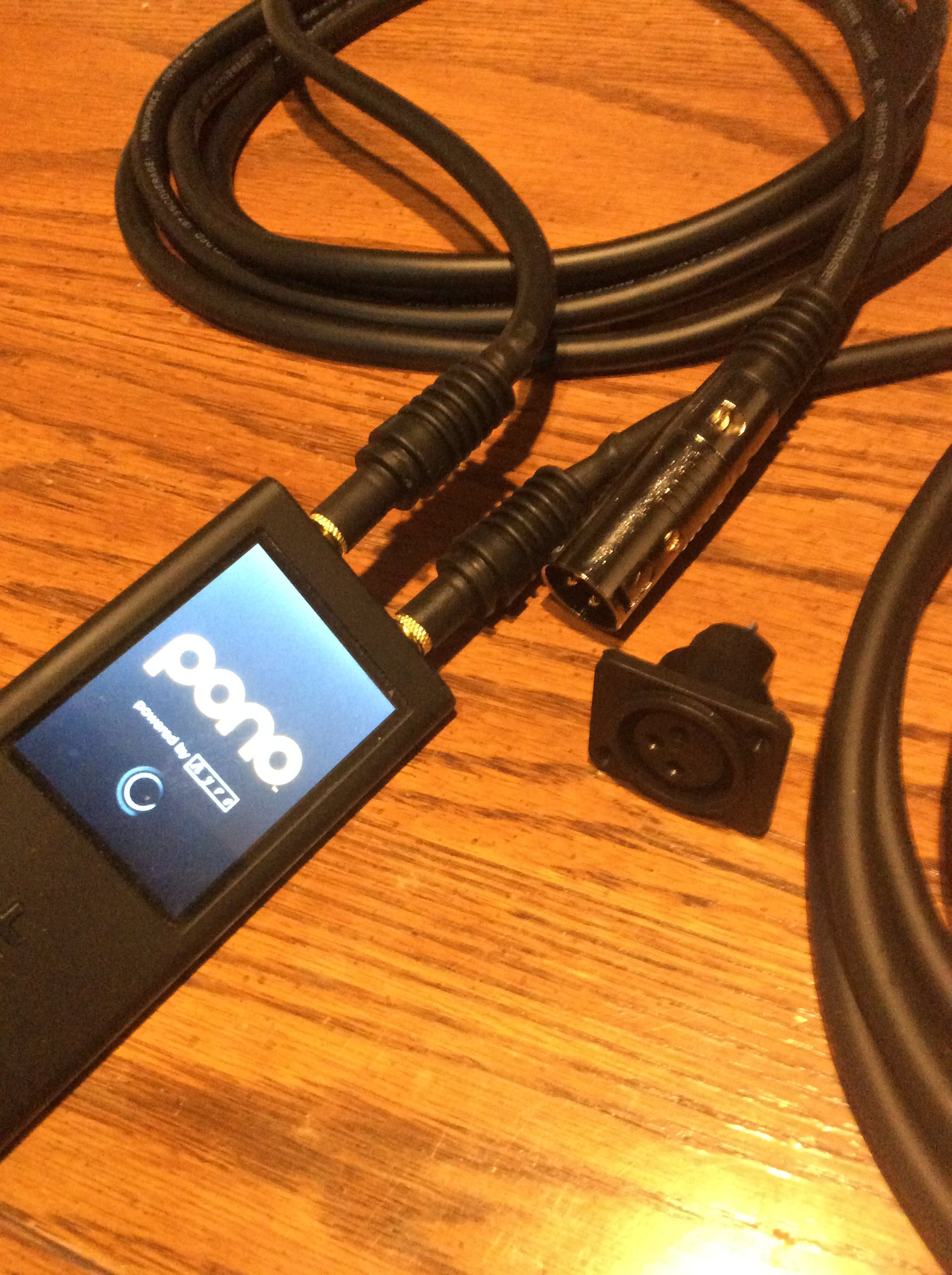

To utilize the balanced capabilities of the 3255EVM and a Pono player, I bought some Monoprice XLR cables and replaced the female connectors with TRS plugs. When I put the board in a case, I want to avoid the RCA connectors.
The Monoprice XLR cable appears to be well constructed and yet is quite flexible. I can't test it until I put the board in a case, which has been ordered, but has not yet arrived.

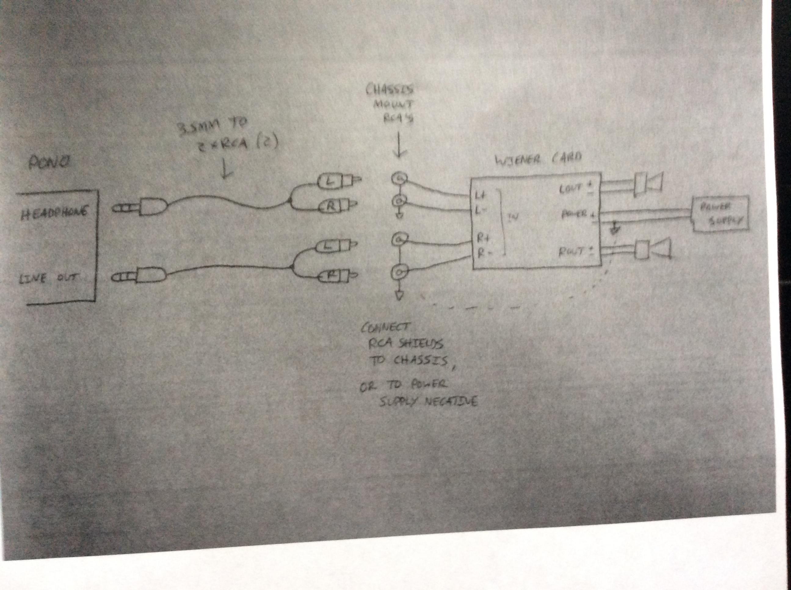

I have a DAC with balanced ouputs, via 3-pin XLR connectors, but I'm having some difficulty wrapping my head around the XLR to dual RCA wiring scheme needed to implement the connection. I'm aware of the 3-pin molex connection that is also available, but it's the 3 into 4 for the RCA connectors that is hurting my brain.
I have the same issue, especially after the Pono technical bulletin emphatically warned against using RCA terminals under any circumstances. Fortunately, gmarsh, the designer/builder of the excellent “Wiener” TPA3118 board, sent me the attached schematic.
I must keep reminding myself that the tip of one Pono TRS plug is the +, while the ring is the - of one channel of the balanced outputs. The sleeve is connected to the shield. Two shielded cables with RCA connectors are needed to connect the + with the center pin of one RCA and the - the center pin of the other RCA. That takes care of one channel. Duplicate all that for the second channel.
The three prong Molex connectors (one for each channel) are used to the bypass the RCA connectors. The center prong is the shield, another prong the +, and the remaining prong the -. Before converting from RCA to Molex, which leads are then connected to female XLR panel connectors, I used a DVM to confirm, by continuity, which of the prongs was connected to the center connector of which RCA terminal.
I think what is confusing to me is the need to step away from the typical SE connection of L, R, ground to achieve two discrete channels, to embrace the DIFF requirement of discrete + and - connections for each channel, in addition to the separate shield connection, as illustrated by gmarsh’s diagram. Does any of this make sense?
Not really. 😉 But thanks.
The diagram unfortunately shows a single line connecting the TRS connector to two RCAs, but the written description suggests three connections (+, -, and shield) for each channel. There are better graphical representations available, from Jensen among others, and I have seen them, but have not implemented them.
Not to worry, however. Mike (mboxler) sent me a couple of molex fan connectors with wiring, and I've wired them to Neutrik female xlr panel connectors situated close to the amp. I'm using standard (Monoprice, in fact) xlr cabling from the DAC (with dual ESS 9018 chips in differential mode) to the amp. No RCAs in the picture.
