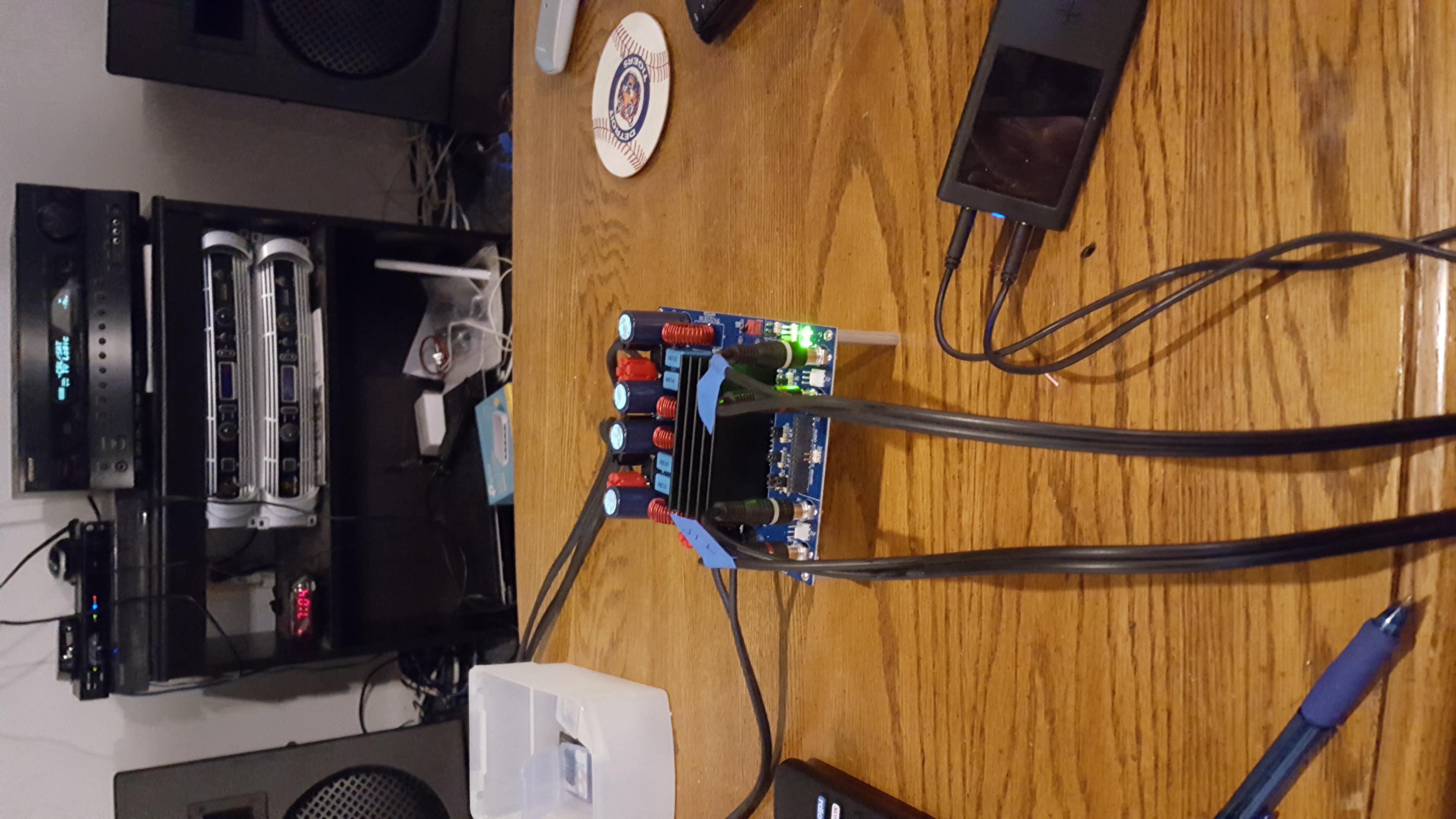

TI TPA3255EVM
BTL for the sub and Se for the mid/tweeter. One channel not used.
Plug in filters. HP for the mid/tweeter, BP for the sub.
Had to use TPA3255 because of 40V supply.
My own board though...a little off topic, sorry.
Can you elaborate on this?
The three pcb's plugged in to the main board are a 4 pole high pass filter for the mid/tweeter set (passive crossover built in to the Sony tower) and a band pass ( high pass and low pass) filter for the woofer.

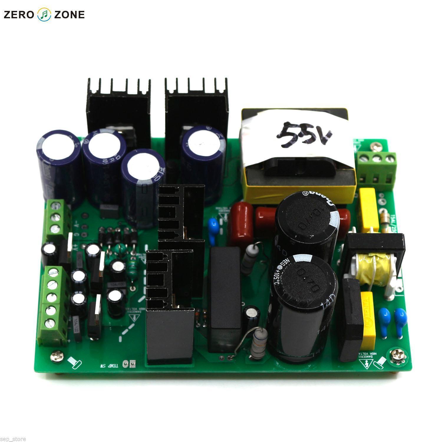

My TPA3255EVM just arrived and I'm looking at PSUs. It looks like a 48V Mean Well supply is a good choice, but is there any reason that the 45V or 50V version of this wouldn't work? I like the idea of using the auxilliary 12V 0.5A and 15V 1A supplies to power something else. Potentially a DAC or preamp?
500W amplifier switching power supply board dual-voltage PSU +/-55V | eBay
In the meantime, I'll be using a 24V 5A laptop brick.
You would only be using one side of the supply, and I wonder if that would cut the available current in half??? If you could get a +/- 25 volt supply, I think you would then be able to connect to the - and + to get 50 volts, but that doesn't seem to be a choice.

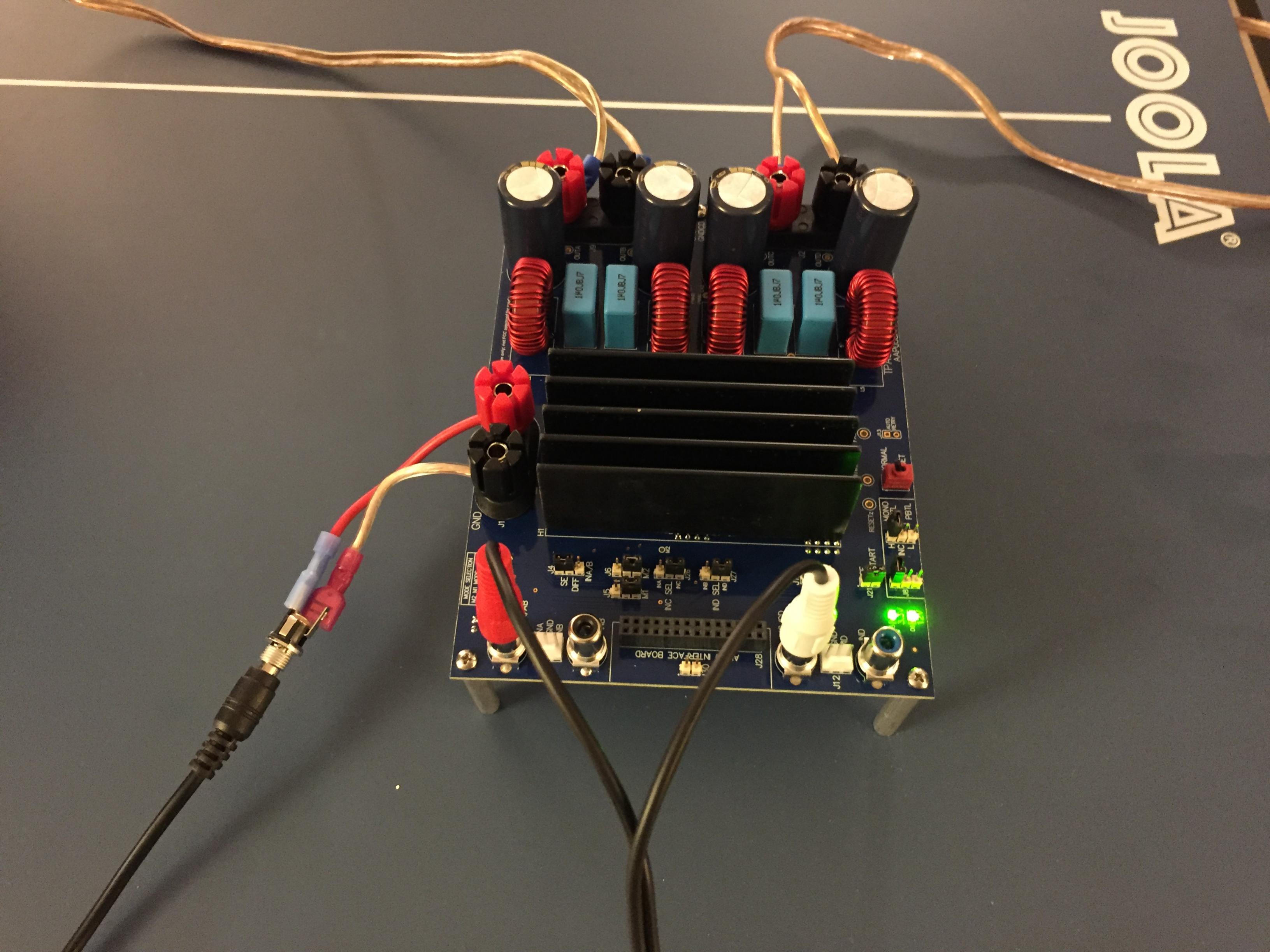

I now have the TPA3255EVM running from a 24V 6A laptop brick and have to say that I like what I'm hearing. It seems to drive the 4-ohm Elac Uni-Fi UB5's effortlessly. Looking forward to hearing it with some more power behind it.
