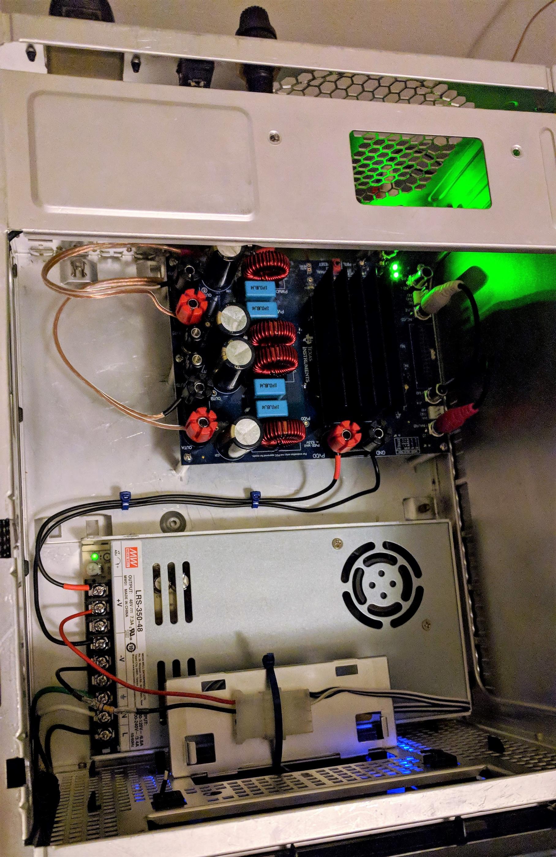

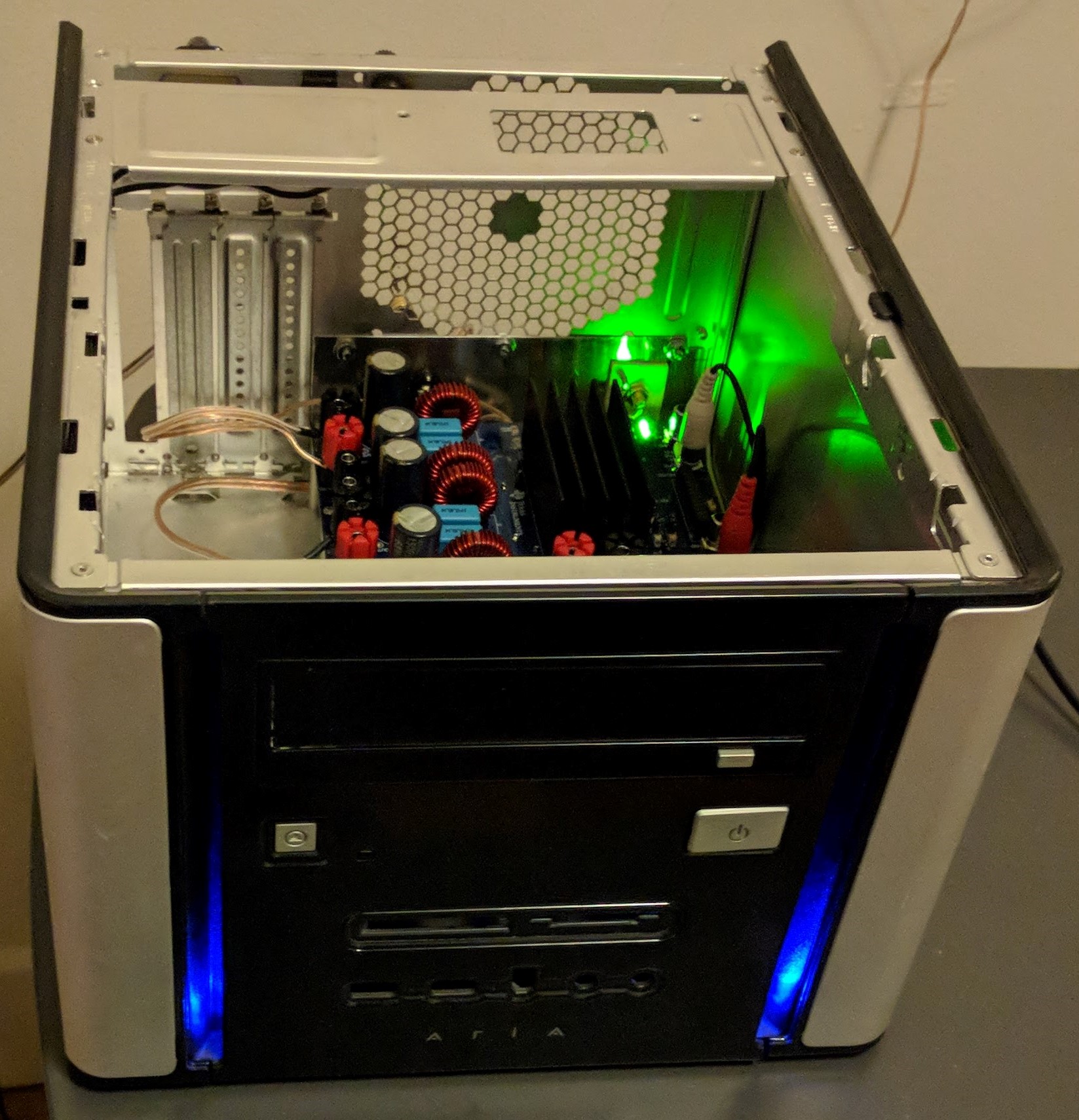

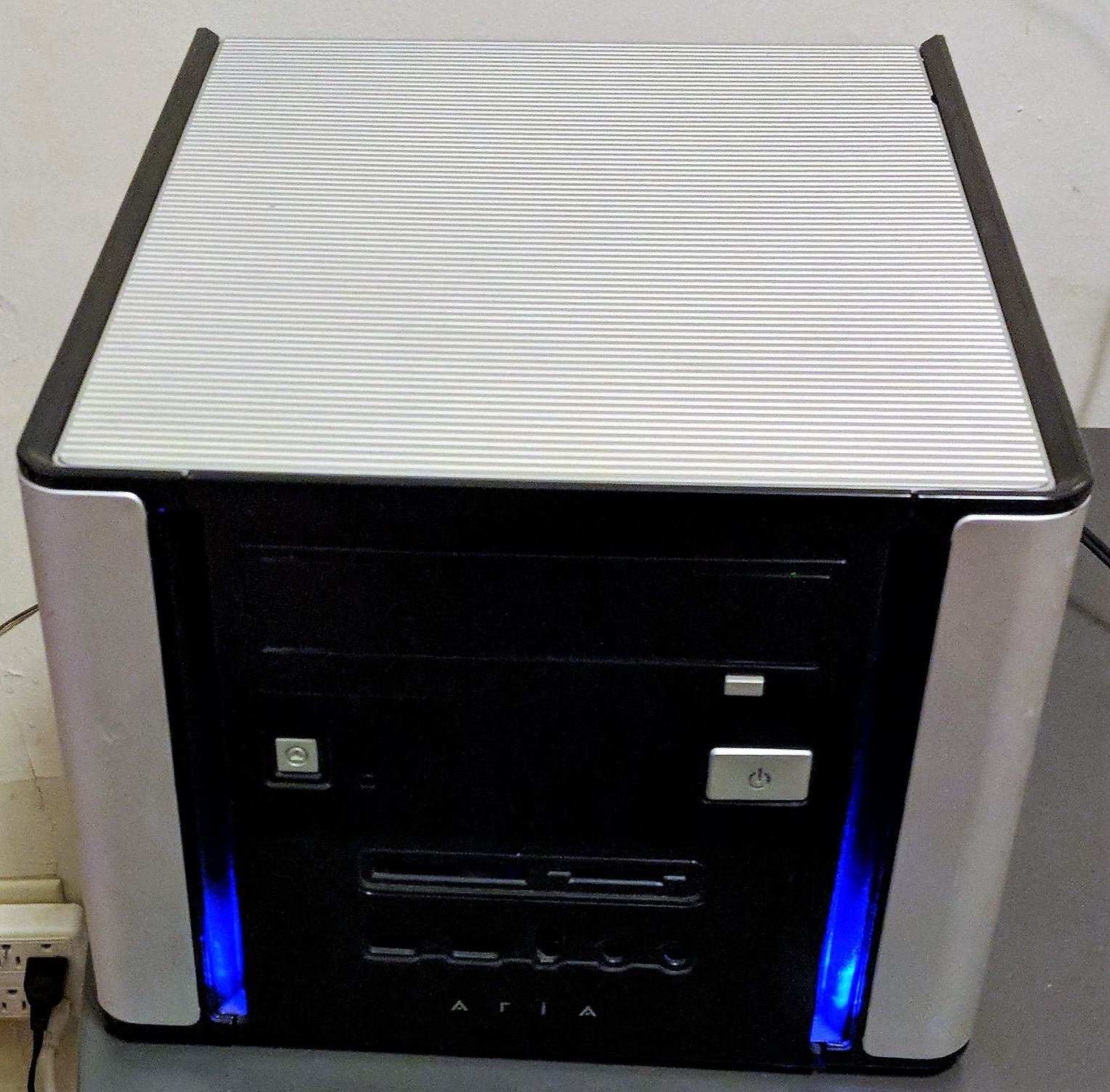

EVM3255 and 48 volt Mean Well PS in old Antec Aria computer case. The case's plastics are brittle, with some tabs broken off, so I gave up on the idea of trying to do anything with the power button on the front of the case. I put a toggle switch and fuse holder in the rear metal panel, next to the existing IEC module.
I finally rigged up my board two days ago and have been listened to it for a few hours. Really like the sound. Waiting for my MW power supply and the case that I bought. Once everything arrived, both the board and the PSU will be housed inside the case.

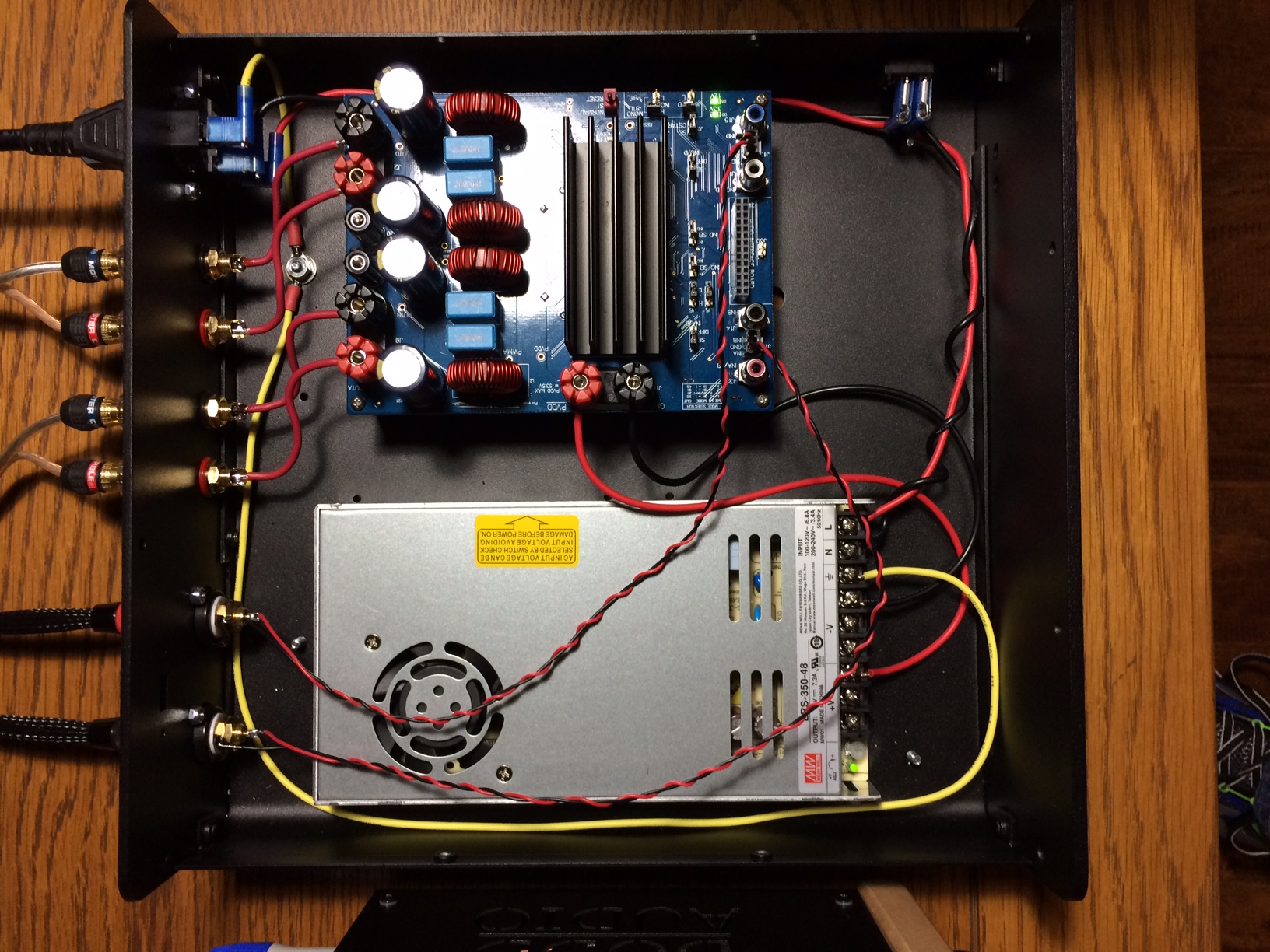

Getting close! My OCD forced me to remove one of the three molex wires and move the red/black to match + and - pins on the board.
That's a nice, clean build! I have a touch of OCD, too. Would you mind telling what case you used?
