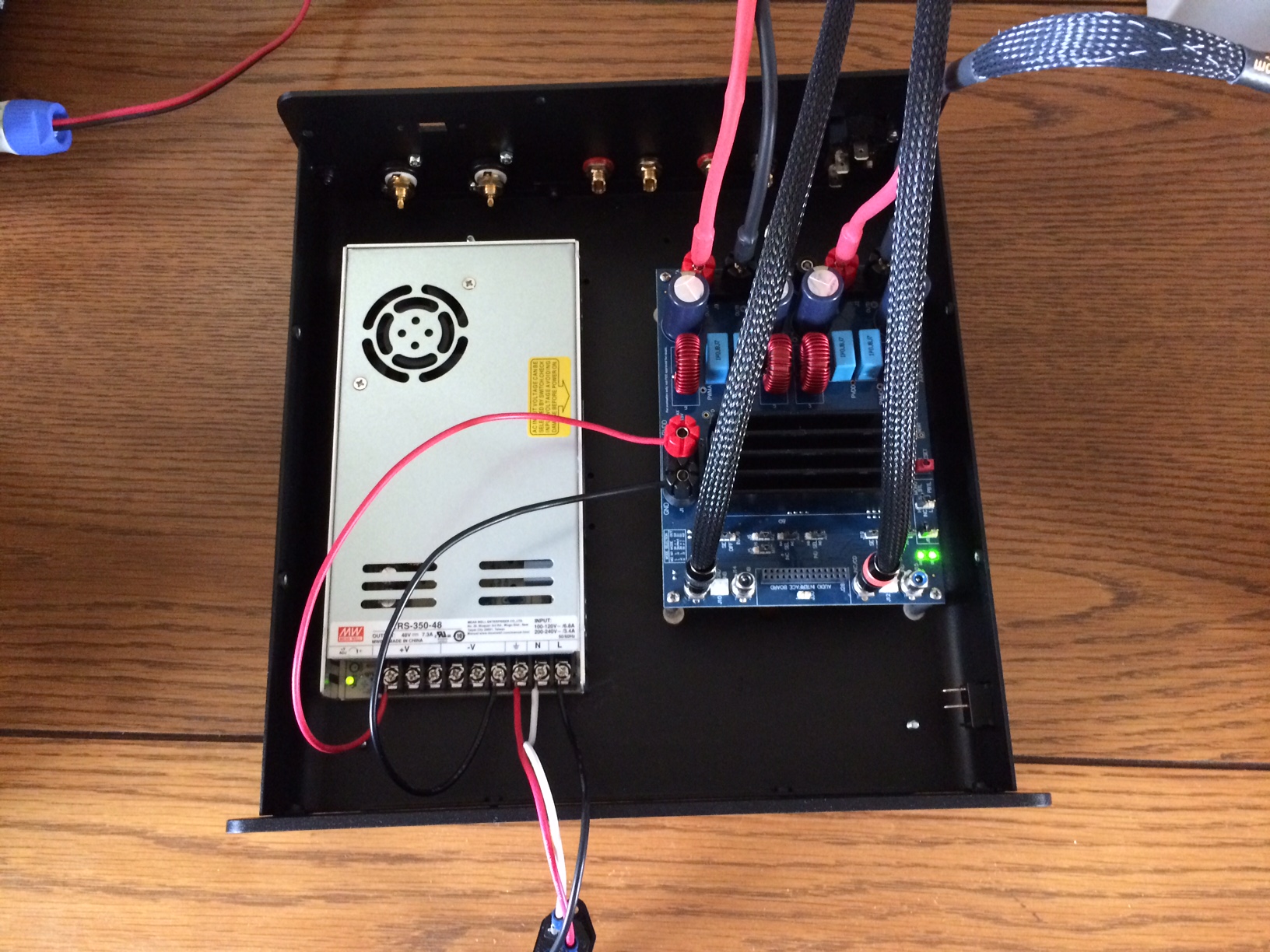

I added the Altec Peerless 15335A transformers, some Neutrik RCA connectors, some Molex connectors for the differential inputs and some Duelund DCA20GA hook-up wire.
Nice little setup, Rich. Would you happen to have the part number for the Molex connectors? TIA - Pat
The amp has about 60 hours on it now and it went from sounding good on the overly mellow speakers to sounding mellow on the same speakers. So the mids and treble definitely smoothed out while it was getting hours on it.
Installed on the upstairs system with more neutral speakers the TPA3255 is better than the unmodified TPA3116 that was being used. The 3255 is clearer in the mids and treble (less grain) and has more texture in the bass. It's a cleaner, clearer window into the music.
It's similar to other class d amps in that it's somewhat solid state sounding with a touch of something like triode magic going on. It's hard to describe but the handful of class d amps that have gone through here seem to have that sonic signature. The difference with this amp is it doesn't seem to grate on me after a few hours. It doesn't seem to be as clinical sounding if that helps describe it. Most of the class d amps sound good at first and then something just doesn't sit well. This may happen here, too, but a few long listening sessions haven't made me turn the amp off. It might just be my bias in having a new amp in the system so that'll take some time to sort out.
The one oddity is that the amp seems to effect wifi and tv reception. It's definitely messing with some TV channels and slowing down the wifi. I put a large metal pan over it to see if it made any difference but it seemed to have no effect. Shut off the amp and turn off the power supply and all is well.

Testing mine as well! Will make permanent connections to chassis soon.
