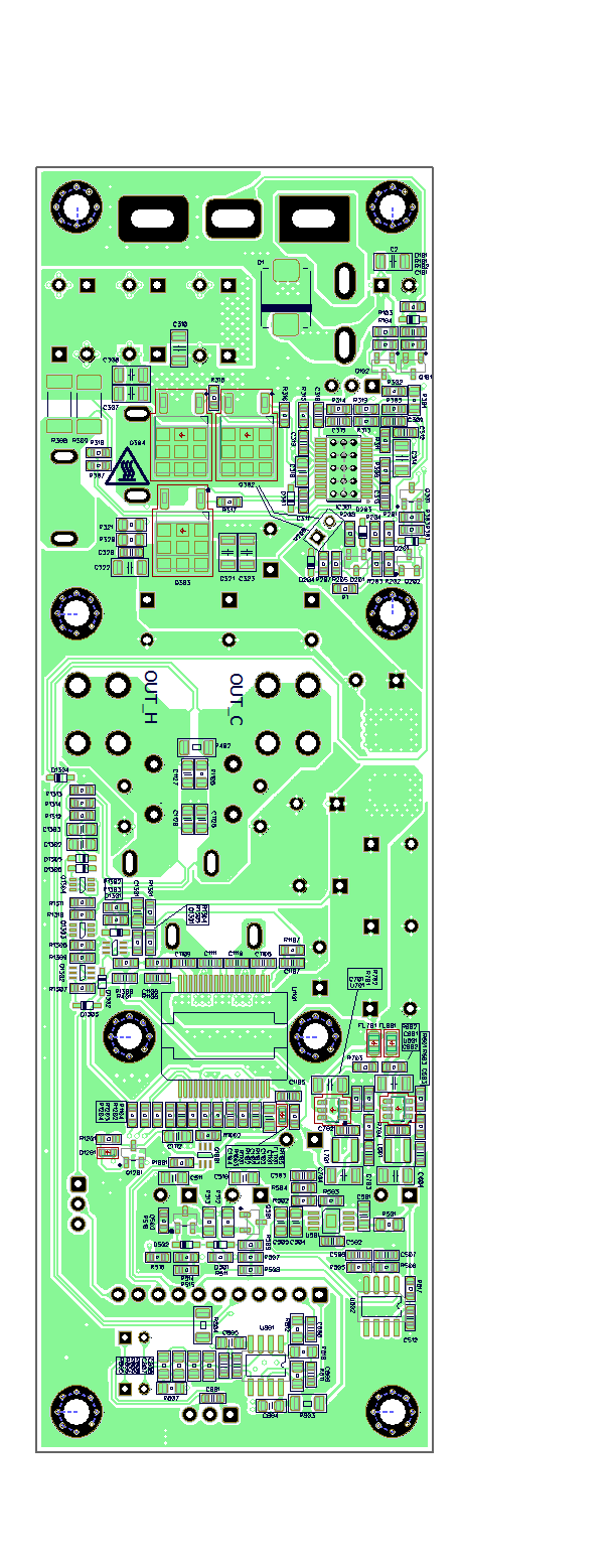

TI power stage for selfoscillating amplifier

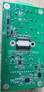

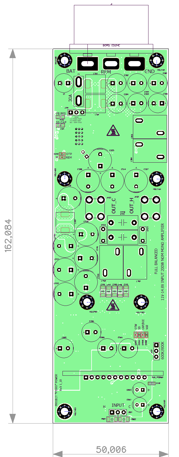

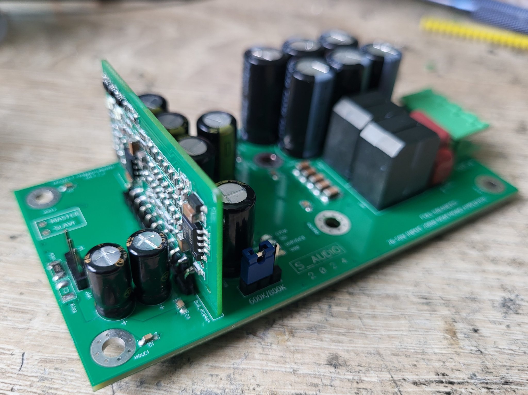

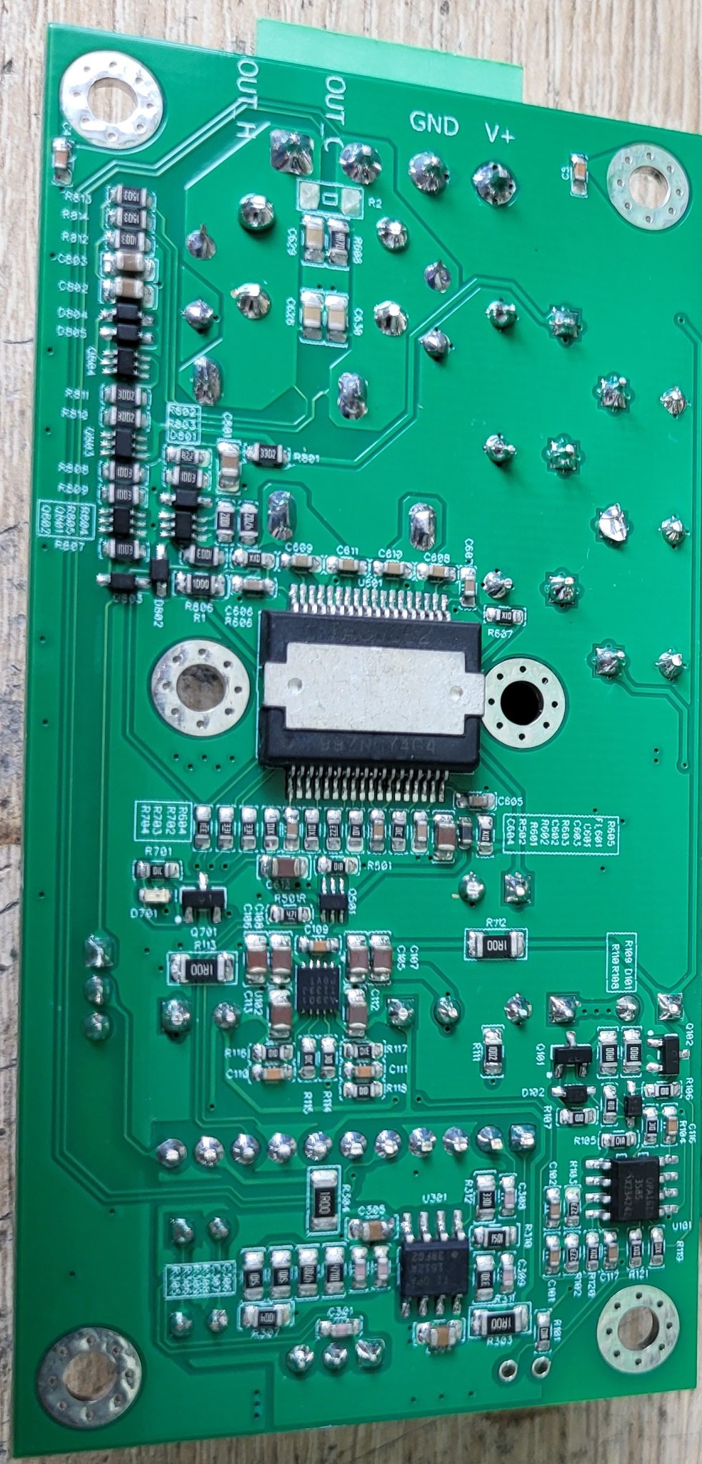

Tested the boards with a chip change to the TAS5162.
In BTL stereo version there is power increase only at 8ohm - 130W RMS, (135W@4Ohm OCP)
In the PBTL variant it was possible to 250W@4ohm. No-load consumption in this variant is about 8W
Ptero power mono
TAS5162 PBTL, 280W@4Ohm

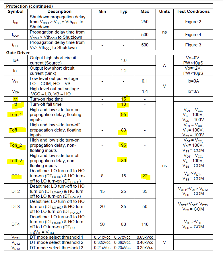

- 600-640kHz I cannot seem to get an IRS20957 (due an already internal 350ns delay + 10ns comp delay) using an NCORE modulator to go that high, not without 100p/220p lead/lag networks, I don't like 10^-9 pico farad values in loops they seem to be sensitive to finger touching drift.
IRS20957 latency is about 140ns with switches and comparator.
Sorry I had some doubts on the figure you supplied, where did you get 140ns? I had a look at the datasheet for the IRS20957 and here are the exact figures.
Updated for Minimum, Typical and Maximum.

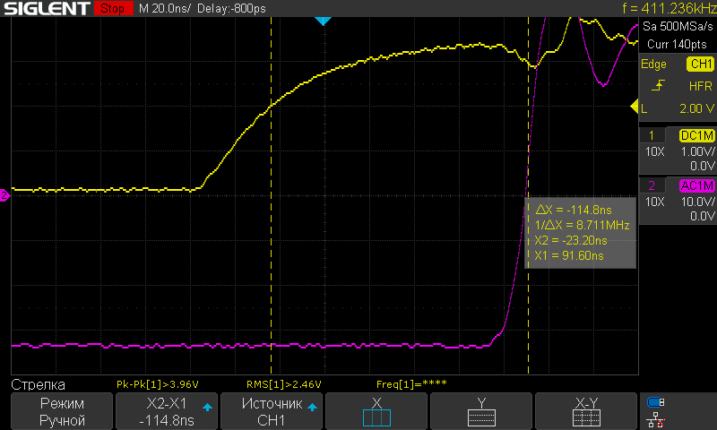

Hi sous can I ask you for a huge favor please, could you post a measurement from one of your kits using the IRS20957 and show the scope delta measurement of the IC delay as you seem confident, its not that I don't trust you, I'm curious is this data a result of a part sourced from china that differs from the datasheet.
sorry if the thread is going off the point of the TAS5342 work you which is pretty impressive, might I say.
I have a prototype on chip YD7127 (copy of IRS20955).
Reference point on the PWM input, voltage transition through the level of 2V.
Delay of 152ns until the signal at the half-bridge midpoint passes through zero.
I.e. the delays in the chip and output transistors are taken into account here. YD7127 is also slower than IRS20957.
yes, origin 20957
my amp module 2_061, yellow - PWM, purple D-S (inductor)
purple without gnd connection
PS Yes, there's also an additional transistor stage at the output of the 20957 on the complementary pair ss8550/ss8050 also adds a few nanoseconds.
