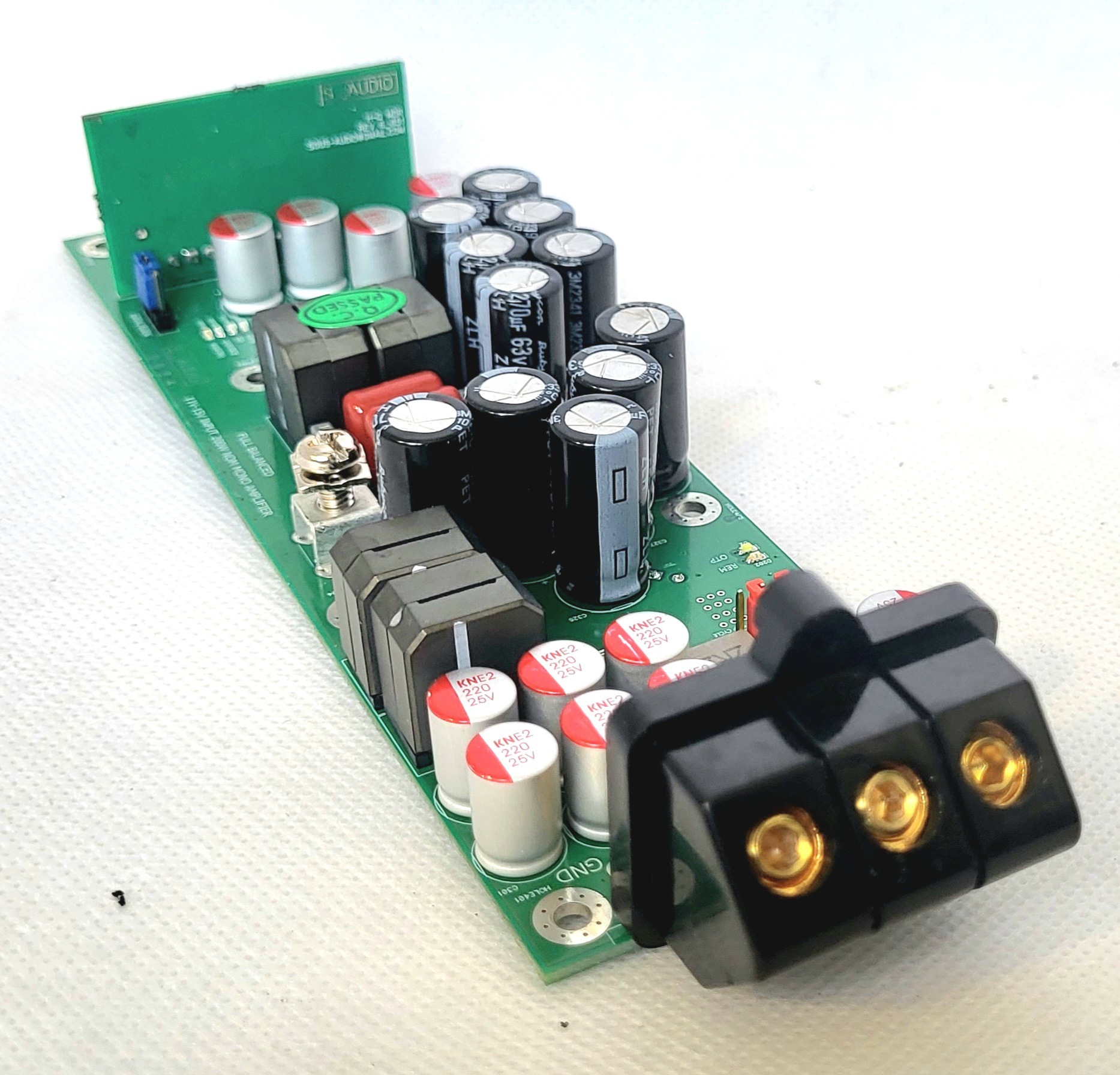

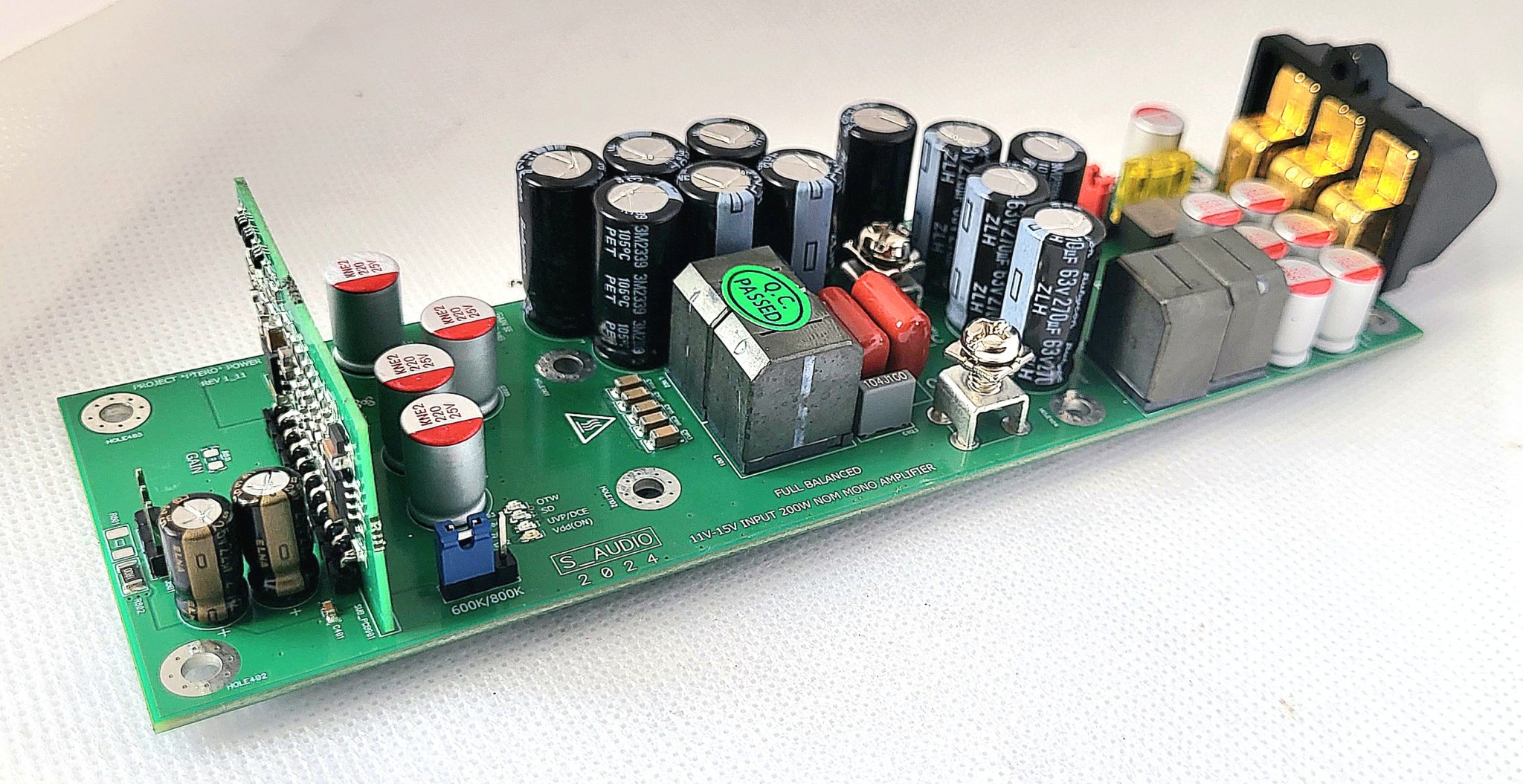

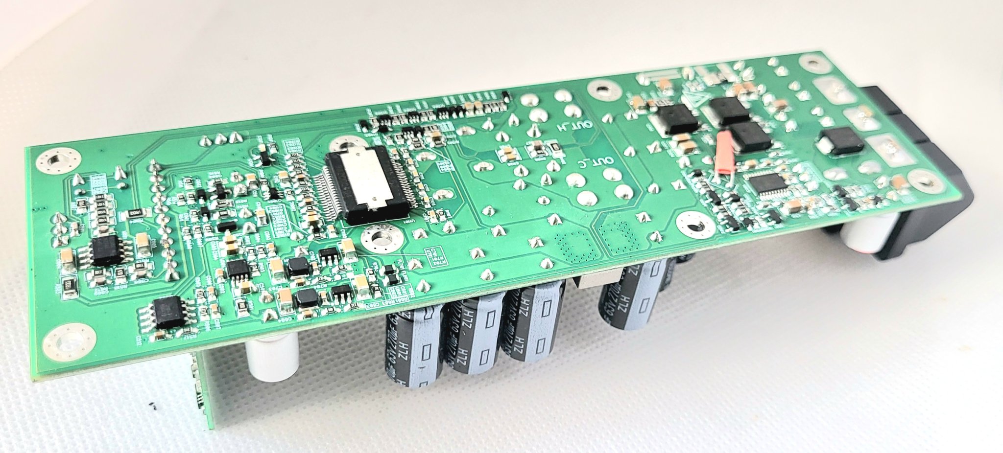

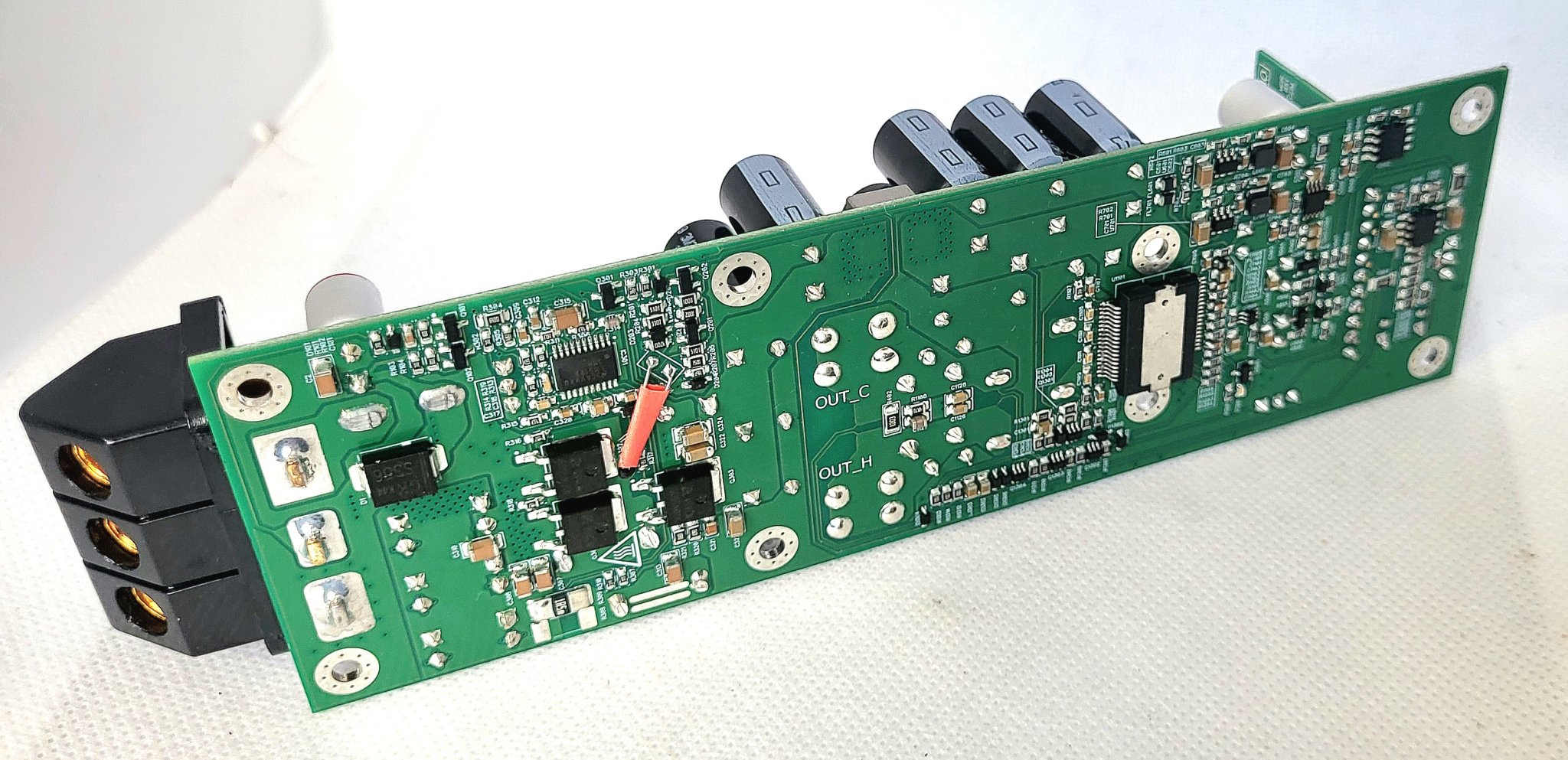

Too much functionality for the 494.
First of all I use a synchronous rectifier, secondly FORCE PWM mode will be used for small loads, because otherwise the boost generates disturbances noticeable for a high quality amplifier.
Besides, in the multichannel version I am going to use a biphase interleaved boost converter, so I will use this board also for testing.
Ptero for caraudio
