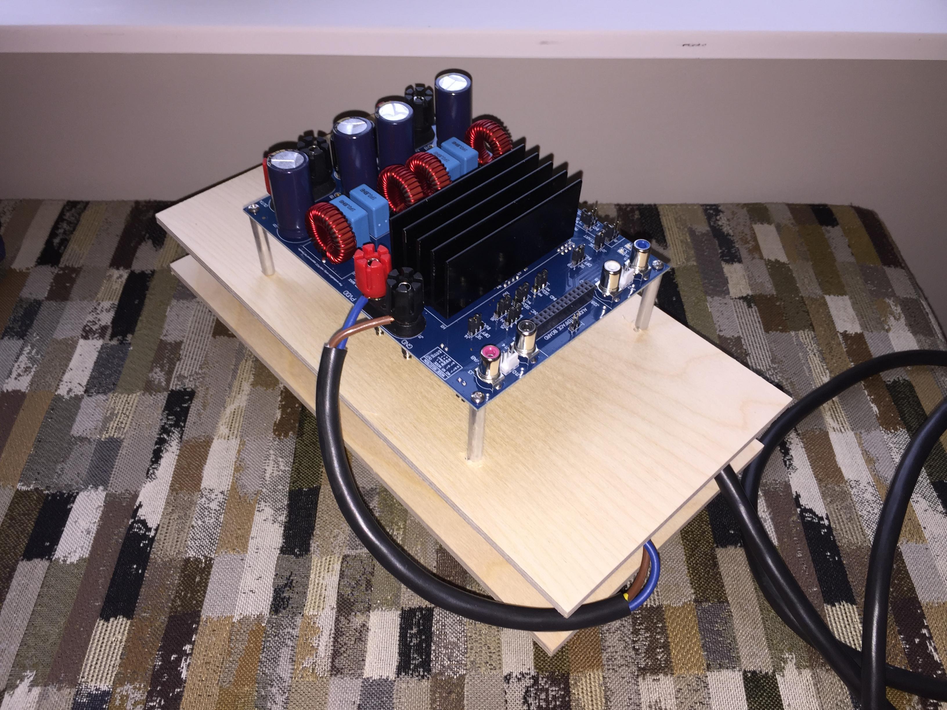

Well I hooked up the TI TPA3255EVM to my system with the Audio Research LS7 tube line stage driving the TPA3255EVM, which in turn, drives my pair of KEF LS50 monitors. Wow! My wife remarked that this is the best she's heard from the KEF monitors. I thought they were quite lively with my Wiener 2.0 PBTL amp and Dynakit Stereo 35, but I have to admit these speakers match up very well with the TI amp. With the greater clarity and dynamic range, I hear more detail and attack and decay in the notes. The bass notes are better defined and have more weight than before--really no surprise here. What's nice is the warm, holographic presentation coming through very nicely.
Right now I have the amp on one piece of Birch plywood and the Mean Well supply on another identical size piece. I have to get some 2-3 inch high standoffs to properly stack the components to look a bit like this. For now, they are sitting side by side in my console cabinet.
I have to listen to this amp some more, but I can certainly see why TI claims the TPA3255 to be an improvement over the TPA311x series. For the $105+ I shelled out for the amp module and Mean Well LRS-350-48, this is quite a bargain. :up:

Rhing, Did you notice and turn on/off noise with this board ?
None at all. I start my power-on sequence and work my my from source to power amp. I make sure the RESET switch is engaged before I turn on the Mean Well power supply connected to the TPA3255EVM. Then I disengage the RESET switch. This is explained within the TPA3255EVM manual.
When I power-down, I engage the RESET switch first before turning off the Mean Well power supply. From there, I power off my line stage preamp, and then the sources. I do not physically connect or disconnect anything during power-up or power-down, or while everything is on.
Based on what others have said, I expected some kind of click or pop, but nothing. In fact, this amp is very quiet and it stays cool during operation. The heat sink is barely warm. I haven't heard the fan on the Mean Well turn on yet.
