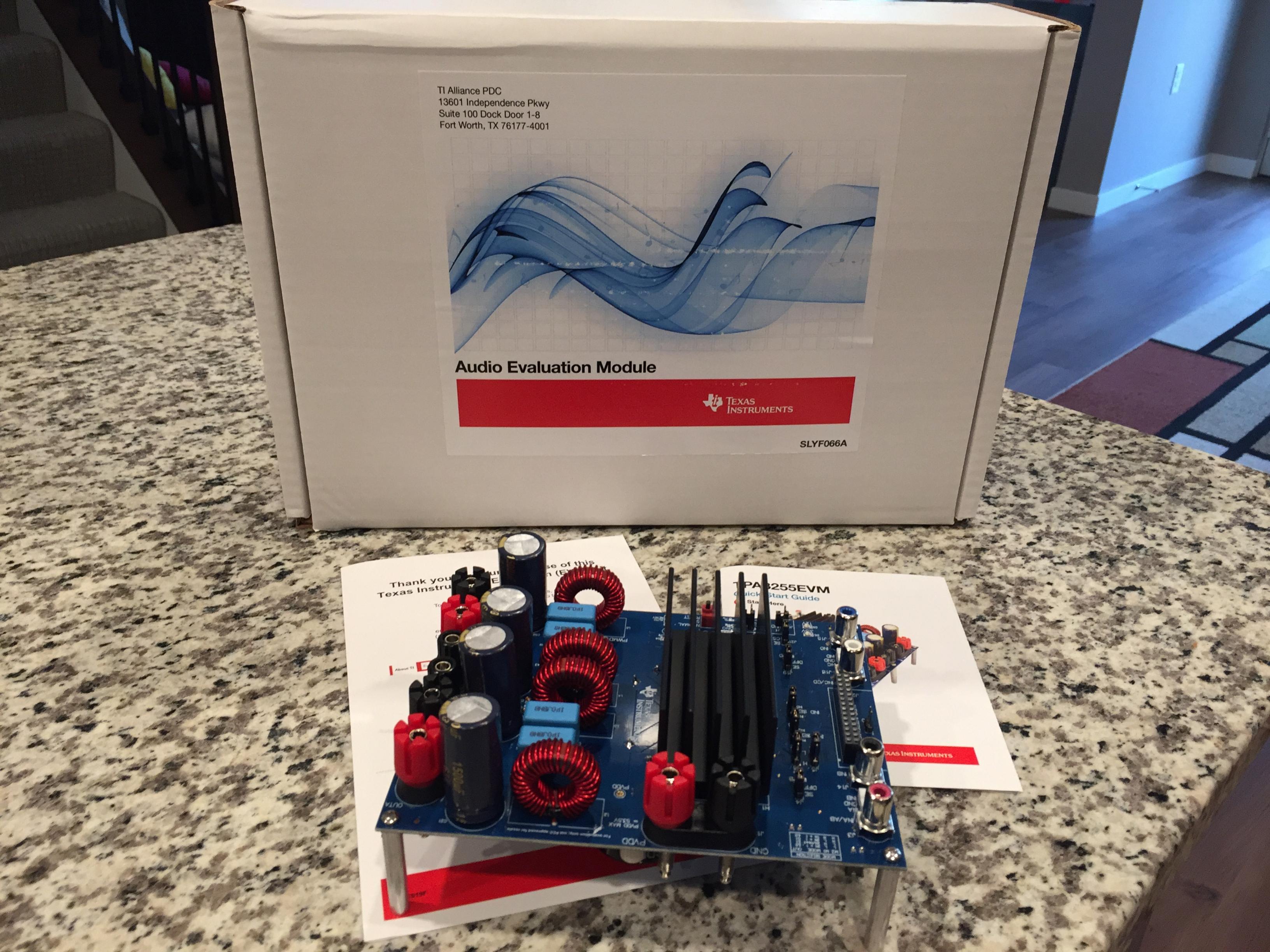

I placed my order for the TPA3255EVM last Friday, and just received the amp today. The amp was double boxed and packaged very nicely. It is larger than I realized: 5 in. wide x 6.5 in. long x 3 in. high. It appears to be well constructed with quality components. I just ordered a Mean Well LRS-350-48 switching power supply from Arrow for $31.10 including free Federal Express Next Day shipping. I just need to get some wire, some lugs, and an IEC AC connector and I'll hook it up in my system. I'll add some input transformers later on.

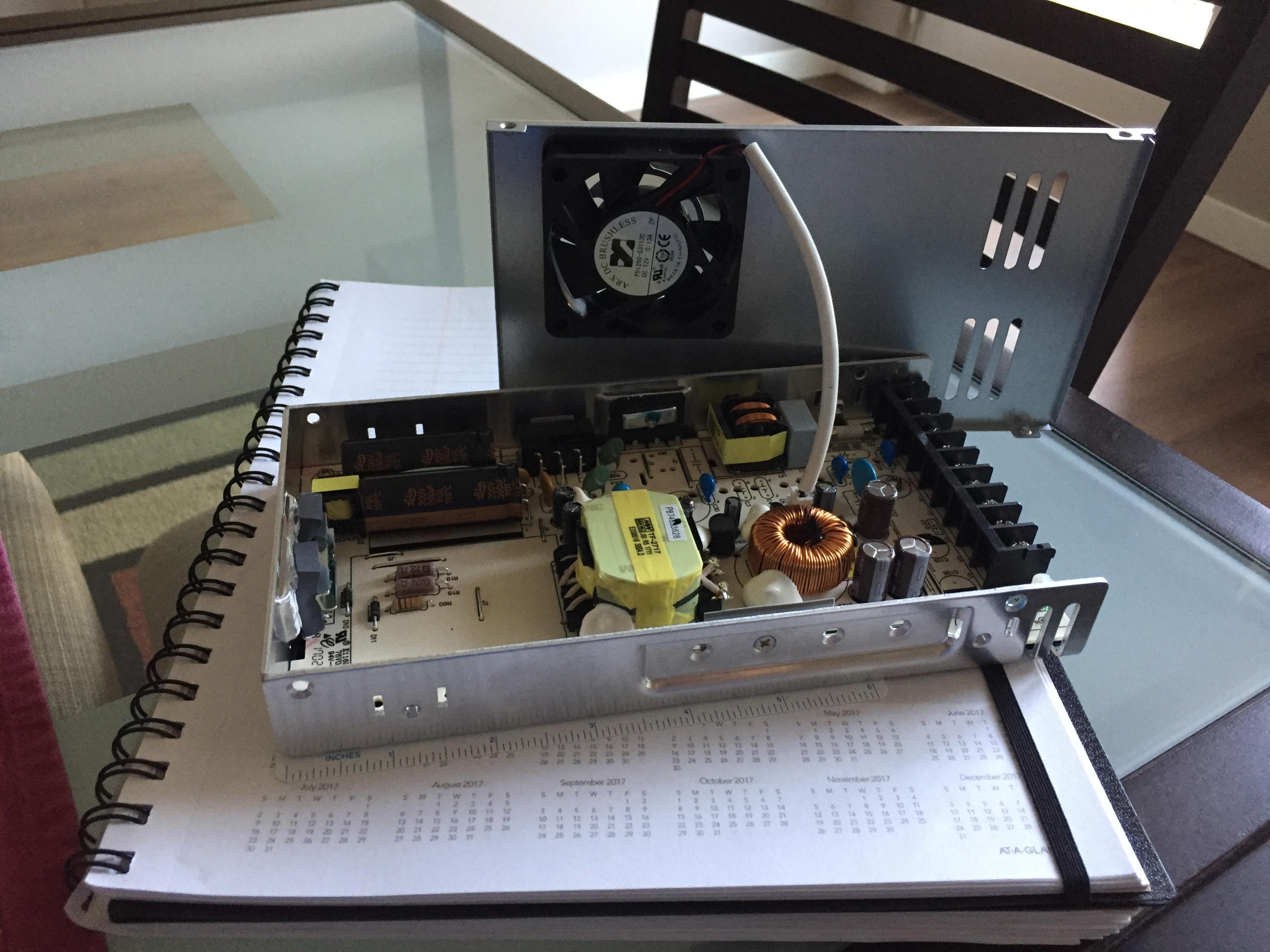

I just received my Mean Well LRS-350-48 switching power supply. It looks larger in photos than is the case. I still have to get a few parts and some wire to get the TPA3255EVM powered up and working in my system.
