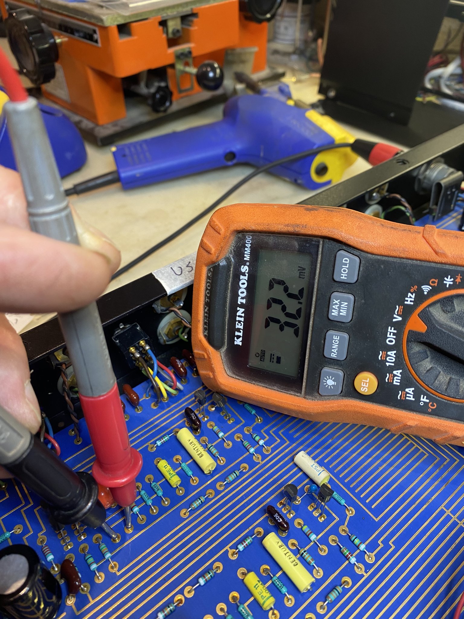

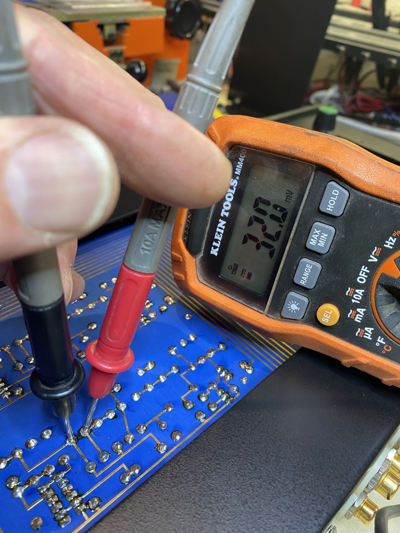

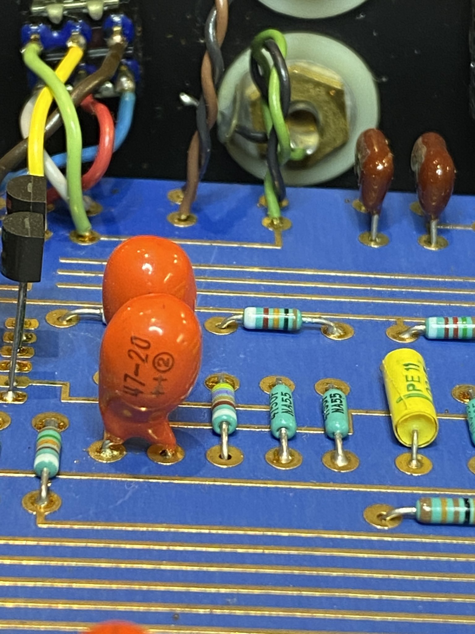

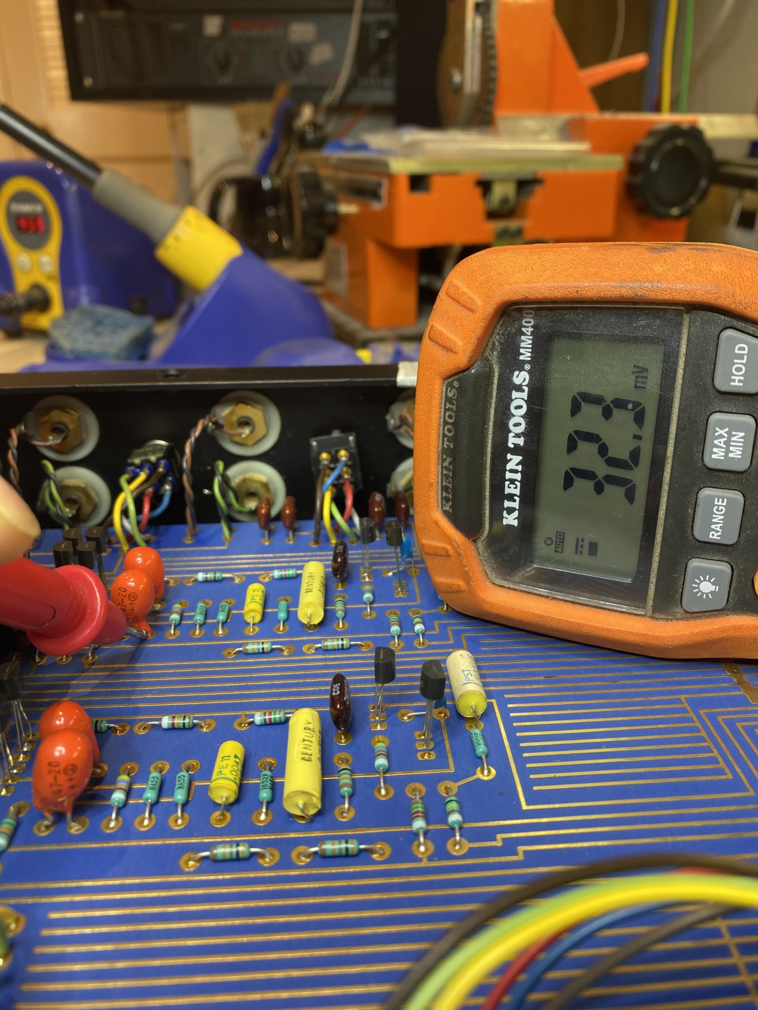

Am I doing this right?
Cap in question seemed to be installed "backwards". I have a woking SL-10 and we have the picture above to compare. I decided to test the polarity on the board of the known working SL-10 and the pictures shows what I got.
The tantalum capacitor is clearly labeled. I tested both the top and bottom of the board as it has traces on both sides (I don't think any layers). I tested with the cap in and out.
I did switch the cap in that location on the other SL-10 and put it on a variac. It works fine, I tested everything.
Am I not measuring Correctly? (Yes, leads are installed correctly on the DVM)
Something that bothers me anytime that I see them are 'empty holes' where component leads go. Then they are soley reliant on the through hole connection on the board to be perfect. Especially when a component is removed and then put back in place, it creates a place for Murpheys law to get a foot in the door. You won't see it because it is where you can't. I am seeing several of these on your board, even the resistor right next to the cap in question.
