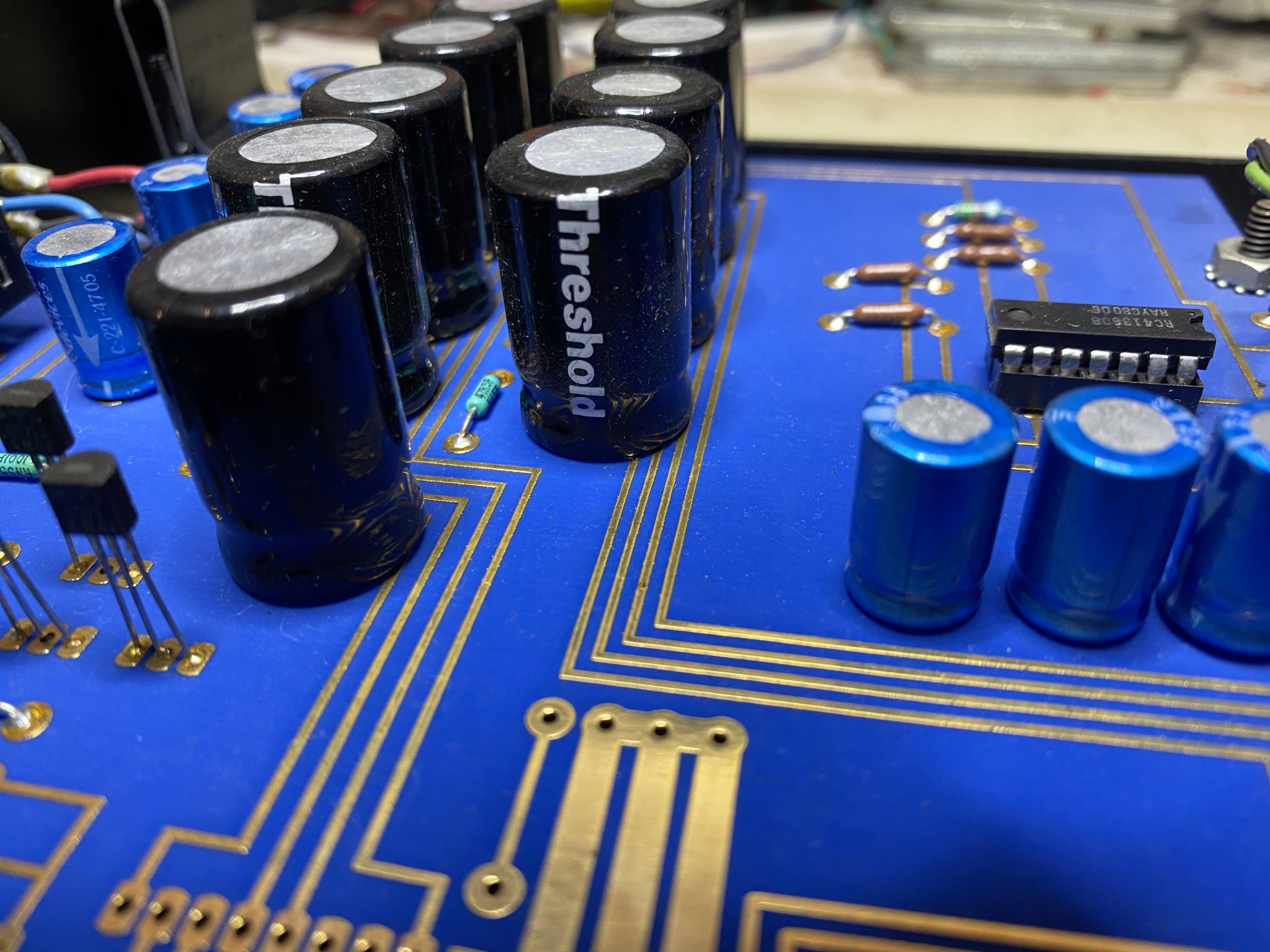

Threshold SL-10 Recap.What's the Polarity of the 470 uF Black Threshold Caps??

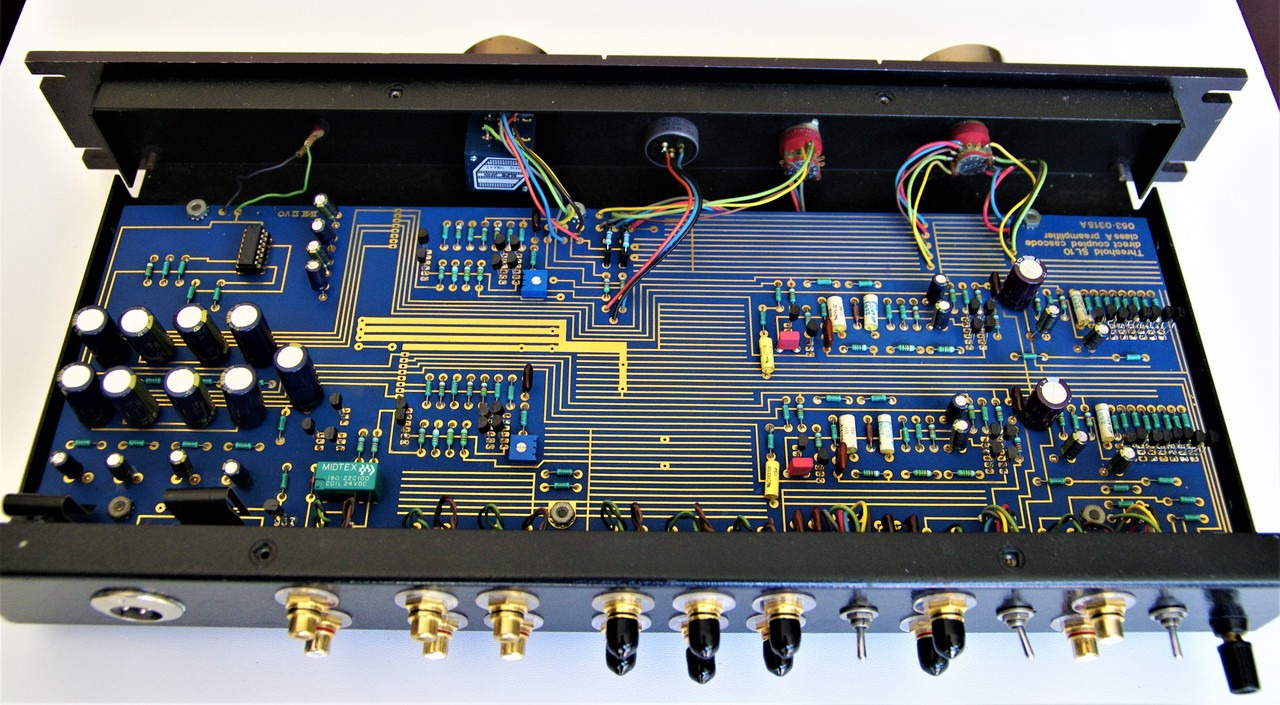

The first picture I found of an SL-10 has caps showing their polarity:
Thanks Andersonix,
And there we have it. The Threshold strip on the wrap indicates the positive side just like the Instrument Device caps in the SL10. I did notice one Instrument Device cap that was installed incorrectly, soo, maybe the red or black dot on the bottom is still a possibility. When I do this, I'll make sure to test several caps (including the one suspected of incorrect installation) and report back.
I promise, I will do both!
It's just nice to have a few confirmed ways of identifying.
For all you "Test it" folks out there, remember, I did find one that was installed backwards. I confirmed that by looking at a second SL-10 I had and the picture posted. All the testing in the world would not have told me it was backwards. :headbash:

Cap in question seemed to be installed "backwards". I have a woking SL-10 and we have the picture above to compare. I decided to test the polarity on the board of the known working SL-10 and the pictures shows what I got.
The tantalum capacitor is clearly labeled. I tested both the top and bottom of the board as it has traces on both sides (I don't think any layers). I tested with the cap in and out.
I did switch the cap in that location on the other SL-10 and put it on a variac. It works fine, I tested everything.
Am I not measuring Correctly? (Yes, leads are installed correctly on the DVM)
