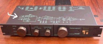

The SL10 is the best looking of Nelson Pass's preamp's, no doubt about that fact😀 Any chance to see a pic??

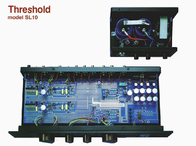

Direct coupled +15 -15 rails with a 6 foot power cable (switchcraft mic?) It looks almost as good as the NS-10; at $560 off eBay, a bargain.
-Mal
Here is a snip from the brochure.

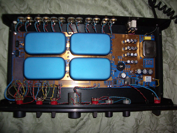

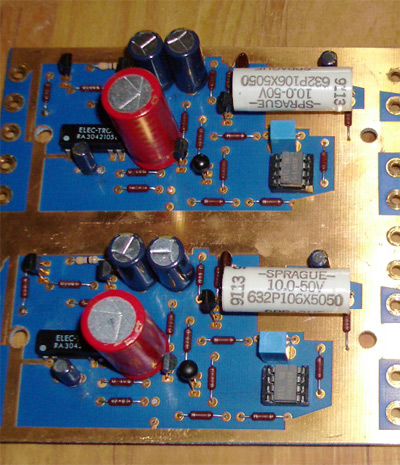

steenoe said:BTW did you notice an improvement soundwise, when you changed the cap's in your NS10?
Subtle, though notably- less attenuated/flater bass response below 40hz, and atleast as uncolored/transparent as pre mod so i'm happy.
As you can see I didn't use axial caps in the power supply. all pana FC.
