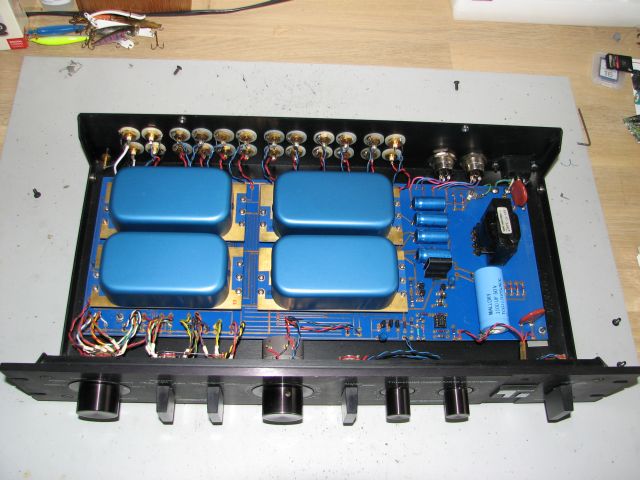

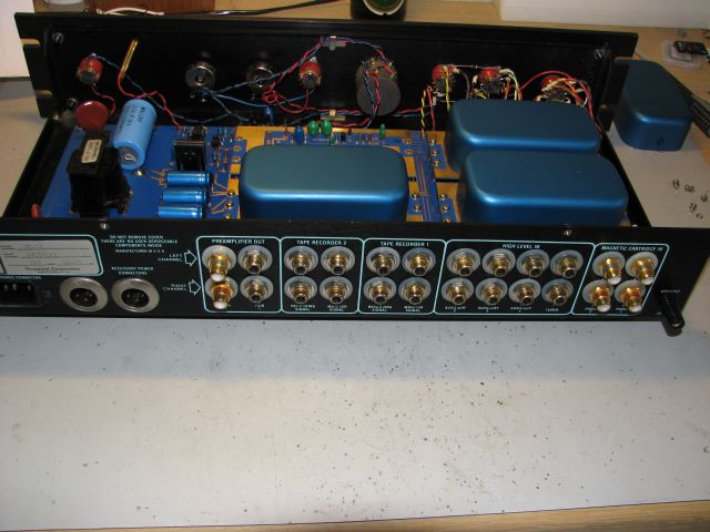

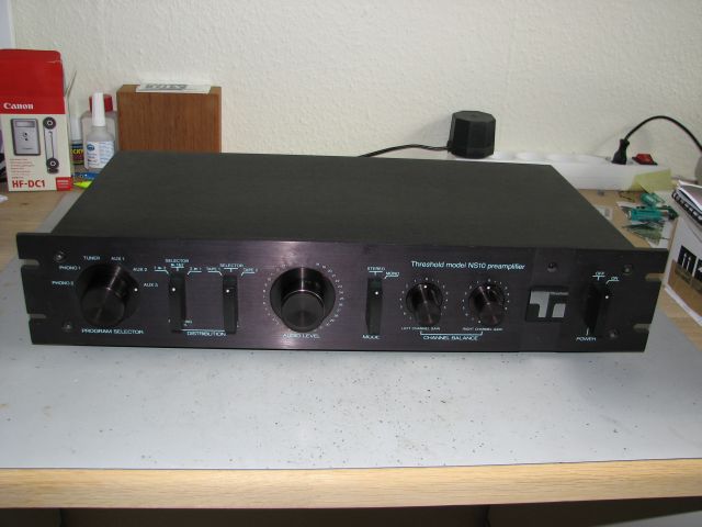

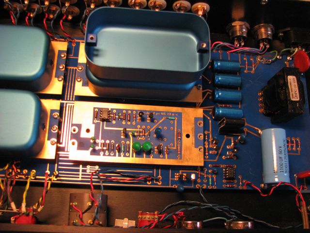

With the summer comming to an end, DIY is once again interesting😉 I thought that I would keep this thread going when refurbishing my Threshold NS10 preamp😉 Hope its OK with Apassgear? Here is a few pic's of it, its in an amazingly good condition, considering the age. The former owner is an old friend of mine and I know that he really cares about his things! He also has a Threshold Stasis 2, but doesnt want to part with it.
More to follow😉
Steen😎

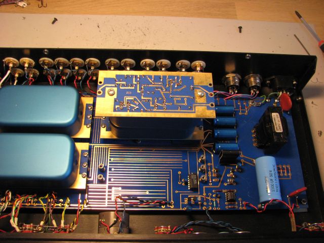

My plan so far is to change all the electrolytic's and the signalwiring. I have some Rifa's in mind together with some OFC silverplated and Teflon insulated wire. Furthermore I am gonna change all the RCA sockets with new quality ones.

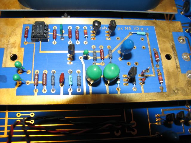

What I really want to know is, if I should replace the Tantalums?
As you can see on the pics, the preamp is full of them. Normally they are not too well regarded, but I know that the leakage is very low. Should I change them or should I not? If yes, with what?
Comments are more than welcome.
Steen😎
Hi Steen,
Yes, I would most definitely replace the tantalums with aluminums.

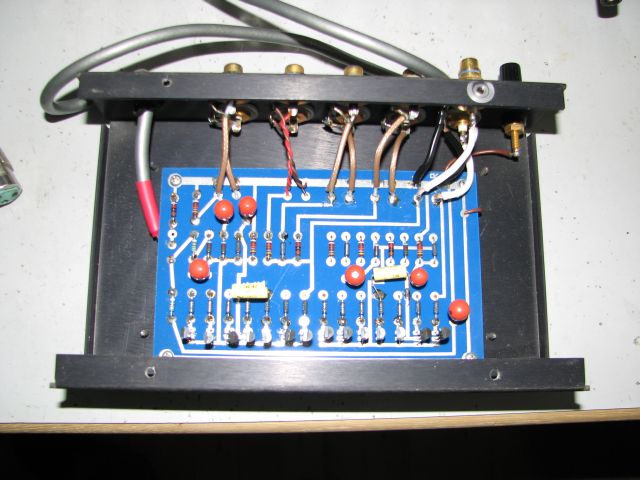

I noticed that the photo you labeled as the open riaa appears to be the associated MC head amp unit (the MC10 IIRC) - not the internal riaa circuit of the NS-10.
Enjoy.
Graeme
Hi Graeme. Thanks for the reply🙂 Yep i thought of changing the the Tantalums, but someone warned me about replacing them in a particular circuit because of their very low leakage. (as opposed to electrolytic's)
Yep, you'r right about the RIAA circuit, the box is a Moving coil preamp allright. Sorry about that mistake. Inside the preamp itself the 4 can's are 2 linestage's and 2 MM phonostages.
The box has several impedance matching input's.
Any suggestions of what should replace the Tantalum's?? My initial idea is Panasonic FC's. I have had good result's with those.
But I want only the best parts for the NS10!
Steen

are you ready to make one reverse eng%^&* tour hrough NS to see where tantalums are located?
I guess tthat they are placed primary for local decoupling
btw-have you ESR meter?
Hi Steen,
I don't think there are any concerns regarding ESR or whatever here. If it was me I'd just replace all the tantalums. I discovered on my own in the '70's just how big a difference these make to the sound. In fact at first I didn't believe what my ears were telling me. I mean how could a reputedly better technology and a much more expensive part sound so much worse?
I typically use FC's or FM's. But there are also good parts from Nichicon and Rubycon. I'm sure lots of folks will chime in here.
Graeme

That was what I thought indeed🙂 I hope that a replacement of the cap's will make the NS10 sound a bit brighter. The topend is a bit dull at this point. (Compared to my twisted BosoZ)
Ofcourse the supply caps are very old, so changing them to these caps will propably help a great deal: I couldnt link you to them, but its Rifa PEG 124's I have in mind🙂
Yep, I am ready🙂 Those drop's are not so hard to spot. I guess?
I have a Fluke 87 V, I guess that would do??
