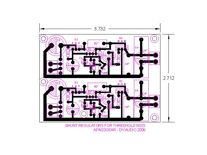

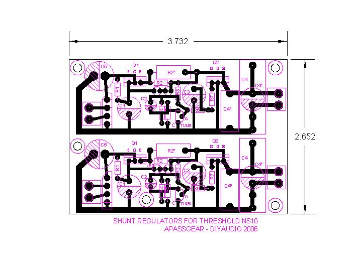

Now we have a PSU layout which is somewhat flexible so some fine tuning can be done.
I have done a double shunt reg for someone wanting one reg per channel or just use one reg for both channels. Even a double mono is possible adding another trafo if you decide to go full bore.
The whole reg is capable of up to 1 Amp regarding parts rating but for this application I don’t see more than some 200 ma even if only one reg is used for both channels.
I have added C5 at the front which is the first smoothing cap before the reg, this part was not shown on the schematic. I think a single 2,200u will do.
R2 has three alternative foot prints. I guess this resistor will be dissipating around 1W for this application so we could use a 3W part, one of those blue things we have come accustom too.
On the output we also have some alternatives regarding caps, a single 1uf film or a 220uf lytic that could also be bypassed with a small film cap, something like 0.22uf.
I have selected a diode bridge, compact and easy to work with, the foot print is for RS105, nothing fancy to it though.

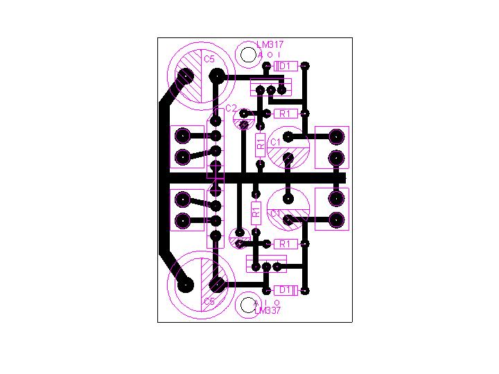

Regarding the PSU for the opamp I will do a LM317/337 affair which could mount on the same main PSU board.

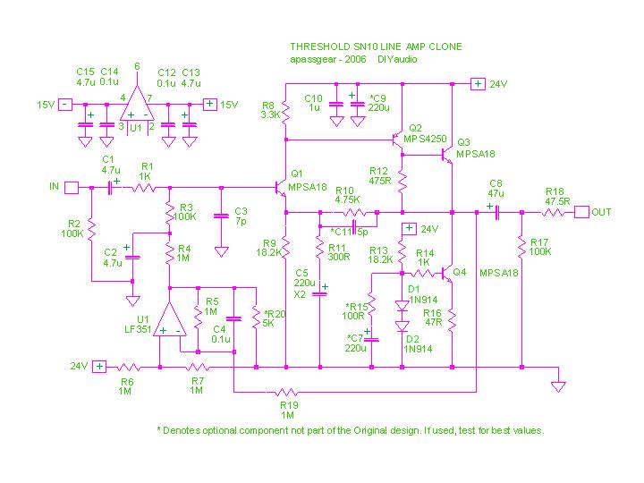

I found what I believe is really the original NS10 schematics, thanks to my brother-in-law, who had a folder with quite a lot of stuff!
If versions of the NS10 exists I do not know. Nelson probably will know!
I think this is basically identical to the one I posted some time ago, but that schematics was probably something I hand copied from this one now attached!
Rolv-Karsten
R-K
Wow, thanks again, excellent contribution, Rolv. We now have both line and RIAA stages.
As you say, I guess the previous schematic (RIAA one) was drawn from this one taking in consideration the notes appearing on this schematic. So I would venture to say that both are correct.
So now we are headed to the real thing having all the values correct!!!!
:cool: :cool: :cool: :wiz: :cheers: :worship: :emoticon: :cloud9: :lickface:
For clarity I have redrawn the schematic which is a guide also for the PCB with numbered components.
I have also marked components with a “*” that are not part of the original design. These values, if used, should be tested for best performance.
