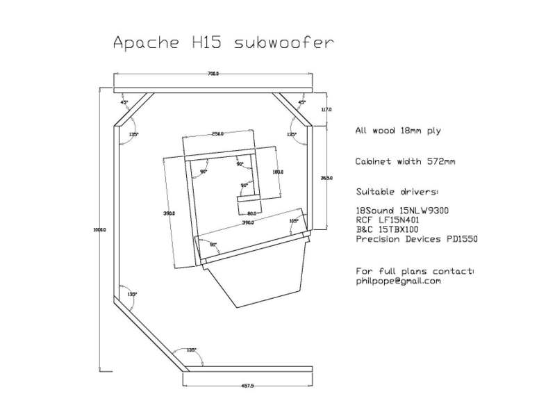

However, there is a similar design that exists known as the TH-115 designed by Phil Pope over at speakerplans, and a few more over there as well in that form factor.
aubergine said:However, there is a similar design that exists known as the TH-115 designed by Phil Pope over at speakerplans, and a few more over there as well in that form factor.

The horn by Phil Pope is the 'Apache H15', I have attached the plan.
Users djk and snowflake have been churning out quality tapped horn designs since.
I maintain that bill's design will not perform as well in a single as the TH-115.
There is great controversy surrounding his plots on PSW if you dig deeper.
