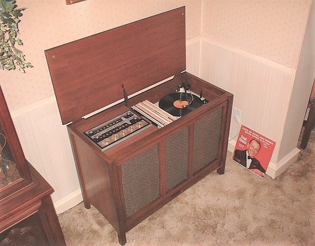

We all grew up with something like that. Our console had speakers facing sides as well. Placed in the middle of living room was quite ok.

Those side-facing-speaker consoles were a Magnavox trademark, and I've heard and serviced the best of them.I am curious what thread starter will come up next, new, what was not tried, and will surpass anything so far...
Ahh, thank you lord for sparing me of your "box" experience.
Including the expensive TOTL "Concert Grand" model.
But my smallish (40 inch) restored/modified RCA Victor would out-do the best of them.
Hidden tweeters firing off the rear wall behind it gives it an expansive soundstage.
And even at room-shaking volume - absolutely no annoying feedback from the turntable, thanks to Rob Elliot's wonderful sub-sonic Sallen-Key filter.
Even house guests of the "audiophile crowd" gave it surprisingly high marks.
