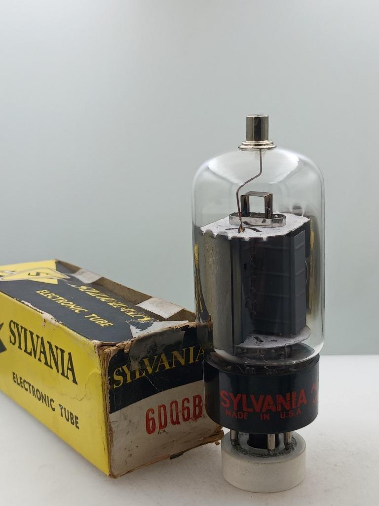

Flash forward 55 years. At ye olde thrifte store, for all of four dollars, I ran across a small diathermy device from the sixties. A piece of medical equipment used for physical therapy by deep-heating with a low-RF transducer. Molecular vibration, same physics principle as a microwave oven, except at the upper end of the audio spectrum. A spiky waveform with its rise and fall time in the megahertz range was what I think did the actual heating. It was called "shortwave" diathermy even though but its fundamental frequency was relatively low.
Opened up said device, and along with the power supply transformer, oscillator board, etc., therein sat a pristine, virginal-looking 6DQ6. The horizontal output tube of choice for countless 21" black & white TVs from the Twilight Zone era. It evoked a certain kind of nostalgia - specifically the odor of human flesh being burnt at 15.75 KHz. The "skin effect" starts somewhere around that frequency, so when you accidentally brush the plate cap with the back of your hand, (they were often uninsulated back then) along with the weird, nasty jolt, a a tiny bit of you gets cremated. It's a smell you never forget.

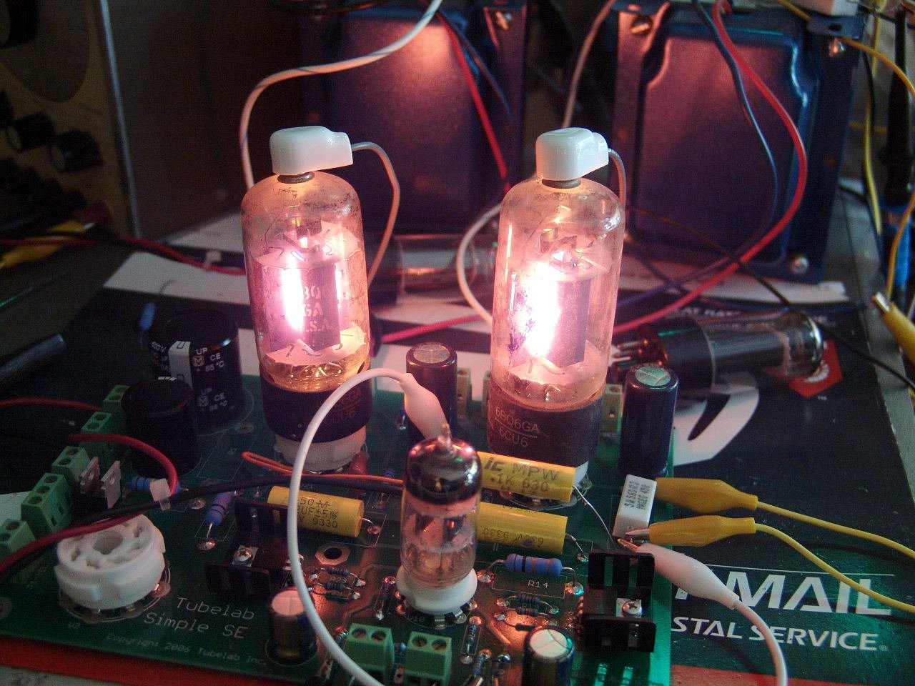

I recently fetched the box of 6AV5's for a requested "blast from the past" involving UNSET in SE. I did a quick push pull experiment that made 68 watts before a funny smell killed the fun. It turned out to be my old Fluke 407D power supply. I never planned to test P-P so I didn't use the big supply. I'll get back to it sometime soon. See post #563 and those that follow here:
OK, It took a bit of digging and soldering but overall this was an easy test with minimal effort. I dug up an old UNSET board, rewired the jumpers to suit a pair of 6AV5's, plugged in the first pair of Sylvanias that I found that looked the same internally, flipped the switch and both channels sprang to life with nearly equal performance. I set the power supply on 300 volts and the idle current at 65 mA per tube. This burns about 20 watts in each tube / mosfet pair. I let it cook at this level for about 20 minutes, then killed all the room light. Nothing is glowing except the heaters and...
There are many extreme experiments scattered throughout the "Tube Sale At AES" thread. Understand that these happened about 16 years ago when I had a little less knowledge and a lot less restraint. How many tubes can one guy blow up in a lifetime?

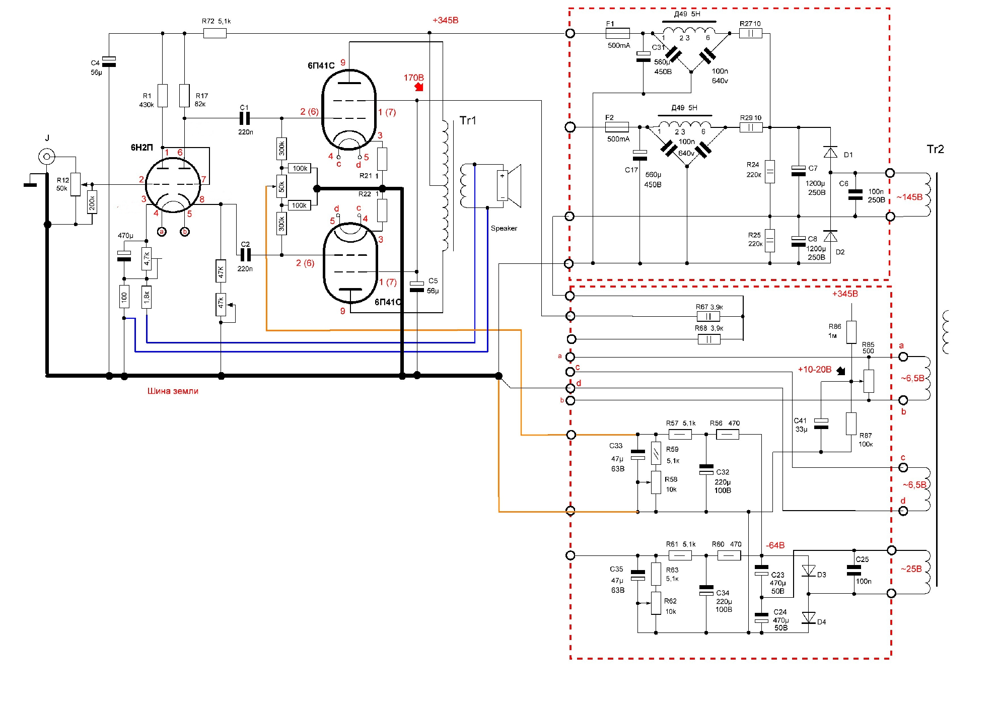

https://www.nadotornado.com.ua/foru...-lampovyj-usilitel-khronologiya-izgotovleniya
20 Watts in Class A
fine tuning - using a spectrum analyzer
the entire process of creating and setting up an amplifier is shown without hiding anything
instead of output tubes 6p41s you can use
6p36s
6p42s
6p44s
GU50
changes are minimal - the main thing is fine-tuning and selection of tubes according to parameters
output audio transformer - TOroidal - with an overall power of 80 or more Watts
all this so that at a volume of 5 Watts the distortion was at 1000 Hz at a level of 0.028% with a feedback depth of no more than 4 dB
