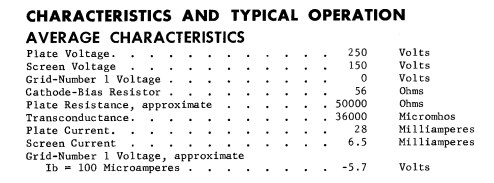

However, look at the values for Rk. Very similar operating points (Vp = 250V, Vg2 = 150V, Ip+Ig2 = 31 to 34mA) but Rk for 12GN7A is 56 ohms, while Rk for 12HL7 is 122 ohms.
In my little (triode) headphone amp, Rk = 62 ohms, Vp+g2 = 155V.
I think if I want to make this circuit work with 12HL7-triode, I'd need to increase the value of Rk, perhaps to 82 ohms or maybe 100 ohms.
Or leave it with 12GN7A-triode in there. It seems to be working well that way.

The 12HL7 may have it's max DC current level up around 36 mA. Of course, one should de-rate from that some for reliable operation. The "small" RCA 12HL7 however may have it's max DC level just above the 25 mA suggested level.
Originally, I tried to estimate a 12HL7 tube max DC current level from the 6BQ5/6GK6 tube datasheet ratings, which DO give a max DC current rating of 65 mA, using a 0.76 Amp Htr versus 0.6 Amp Htr equiv. for the 12HL7. That ratio gave 50 mA estimated for 12HL7. However, it is apparent now that that is still too high an estimate.
Looking at the 6HB6 tube, which is essentially just a 6BQ5 with a fine mesh grid1, for getting gm up to 20,000, the 6HB6 suggested operating current drops to 40 mA from the 48 mA for the 6BQ5. The finer grid mesh limits current some. The 12HL7 is at a similar 21000 gm with a frame grid. Combining Htr and grid1 mesh effects gets expected max DC current for the 12HL7 down to 40 mA. There is still some additional in-efficiency of a smaller Htr due to the same heat loss from wire supports etc, so it will be a little below the 40 mA max for the 12HL7. Maybe 38 mA then.
An alternative approach is to look at the 6BQ5 max DC current versus suggested operating point. At 65ma/48mA = 1.354 so that gives 1.354 x 25 mA for the 12HL7 or 33.85 mA max DC current for the 12HL7. Another data point.
And another approach is to look at the plate curves for suggested Vg2. 6BQ5 has the top knee at 140 mA and 12HL7 has the top knee at 97 mA. 97/140 = .6928 so that times the 65ma max for the 6BQ5 gives 45 mA max, but we still need to take into account the finer grid mesh. So 40/48 = 0.83 so dropping that 45mA to 37.5 mA max DC. Another data point.
Averaging the 3 data points gives around 36 mA max DC current for the 12HL7. Good enough I think. They were cheap when I bought them.
Still a good idea to de-rate some for reliability. Usually the data book recommends 70% derating. Hmmm, 0.7 x 36 mA gives 25 mA, the suggested 12HL7 operating point!! So they knew what they were doing.... ( OK, so I figured out what they were doing. )
So 36 mA if you bought them at $1 each and have a box of them. ( the Flash-Bang threshold? )
And 25 mA if you have to buy them still.
